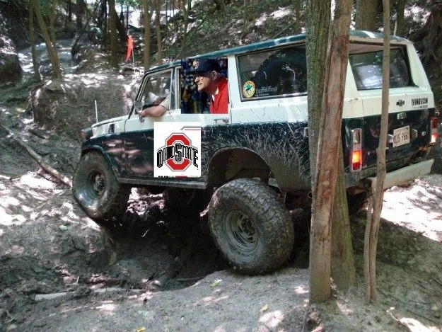

Damn who's that riding with you Gumby !!!! 18 days til show time !!!

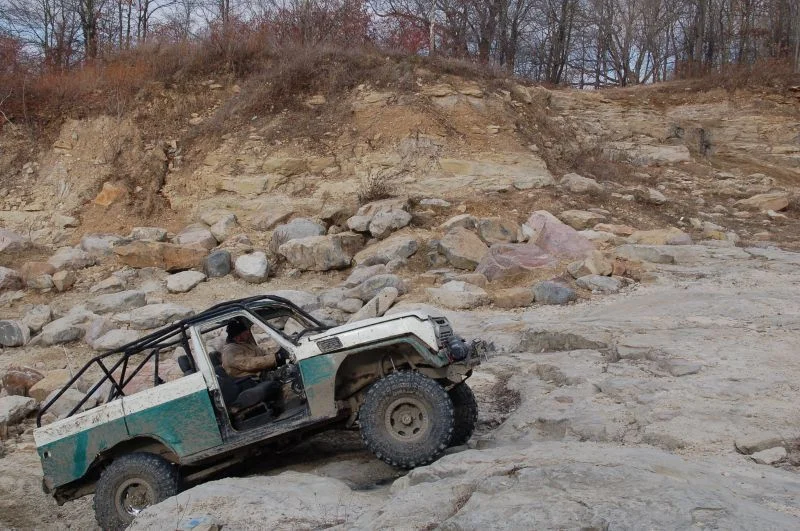

Fresh pics.
I added some little fenders back on to give it some more "pigness"
Contemplating bobbing it back another 24" or so and losing the back seat

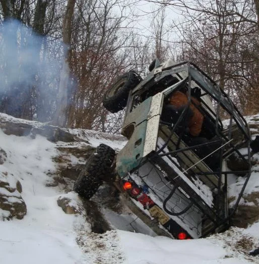

Last ride of the War Pig.

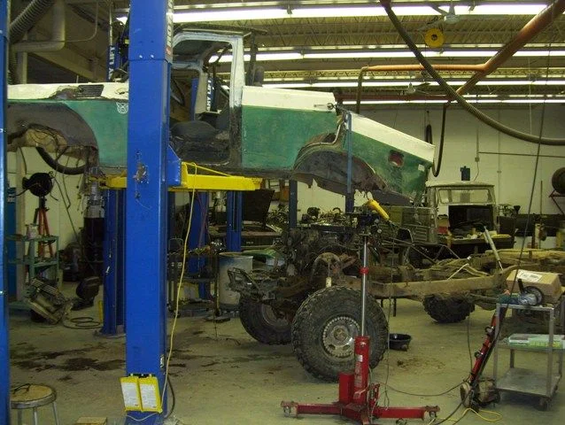

No more War Pig has the power
:Tony Iommi rif:
Hand of Gum has struck the hour

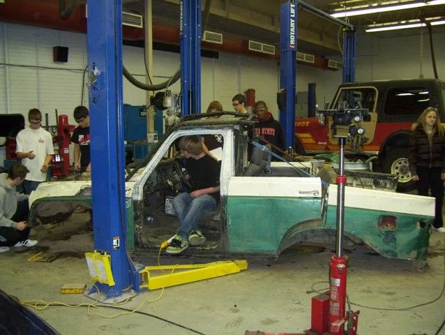

Not two minutes after we lowered it down on the sliders to begin stripping it "Low Rider" by War came on the radio. Followed immediately by Beck's "loser"
Cruiser Karma?

<Minor hijack>
What's the low down on the LV in the background? Looks like it's stripped, ready for paint. Keep yer sawzalls away from that one

Good eye.
I'm gonna chop that one up and make a FJ40 out of it.
