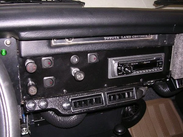

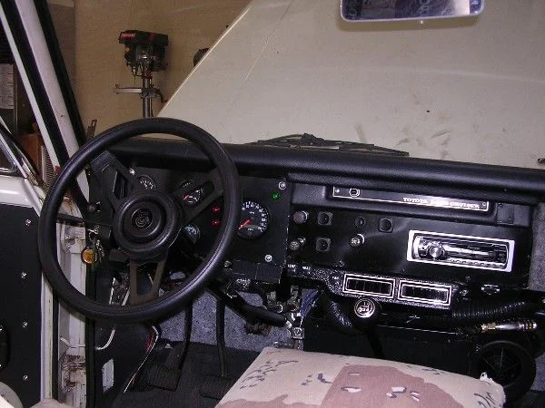

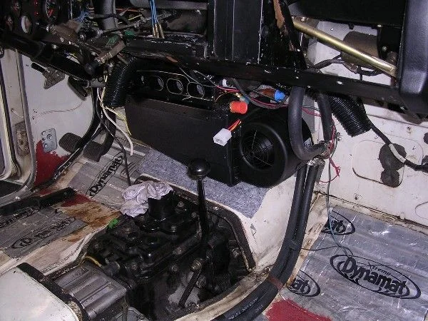

I put a Classic Auto Air a/c heater combo in. They will have the compressor mounts for v-8s, too.
Here's a couple pix. It takes up less room than the stock heater did.
I especially liked that you can pick the controls and vents you want to use. The whole system is modular. You can get cable or electronic controls.
The only things under the hood are the heater valve, the drier, the compressor and the evaporator.

The new unit really works well. Initial running of the a/c frosted up the intake line in the cab. I had to add insulation to keep someone from burning themselves on the fitting.
I think I would go with the electronic controls if I did it again, though. The cable controls routing is tough, but doable. I went with the cables for a vintage look, but I think the electronic controls would provide better air blending.
The defroster is awesome as is the heater.
