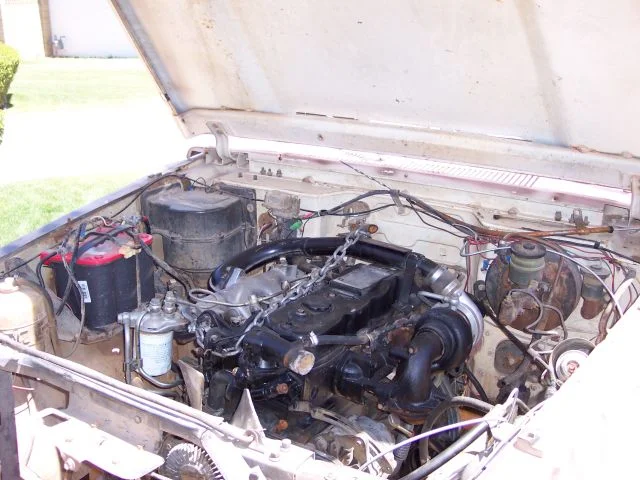

enough talk !!!
time to get busy, heres a little teaser pic.

Isuzu? IP is on the wrong side for a Cummins....

cummins is old school, dre has done it twice already !! i'm in virgin pig territory here. isuzu 4BD1T... piggy is gutted and ready, just waiting on a few more adapter parts and i'll get rockin

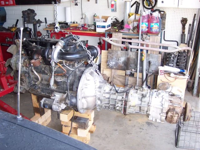

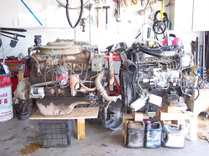

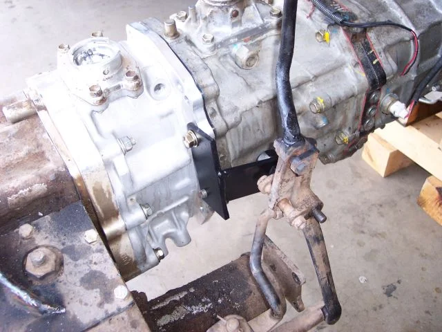

yeah i know, i'm slow but thats cause i have been waiting an unaceptably long time for parts. but i have it all now and progress will commence.
overall shot of new drivetrain:
engine, dieselswapper adapter, AAbellhousing adapter, 5 speed, 4.7 toybox, and 4 speed case.
and a shot of the bracket i made for the tcase shifter, as you can see it will come up next to the tranny shifter and the toybox shifter right behind it.

looks great...glad that thing is goin in a 55.
if i put that combo in my 40, i could use the tcase as a rear bumper, ha ha
haven't read up much on the isuzu...i assume the "T" in 4BD1T is for turbo? are you goin to toss an intercooler into the mix as well?

yeah i wanted the length, F/R driveshafts are the same length now so i can carry one spare for either end.
intercooler is not high on the list, its a solid maybe.
just for reference, the oil pan gasket is level with the bottom of the frame in that pic, the engine is now 2" higher in its permanent locale, lots more vertical room than a cummins. and before anyone asks, i'll be posting a few more detail pics shortly.
