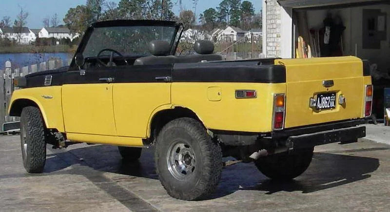

Wow, your cage looks great. I wish I had the skills / tools / shop to do a cage for mine. What would you recommend for a weekend warrior? I have a welder but no bender. Should I try to rent a bender or get pieces bent for me or ? I cannot afford a custom cage to be built/installed for it. Much more work to go. Jim C. is rebuilding the carb as we speak.
Thanks,
Chuck
Here is the current progress...

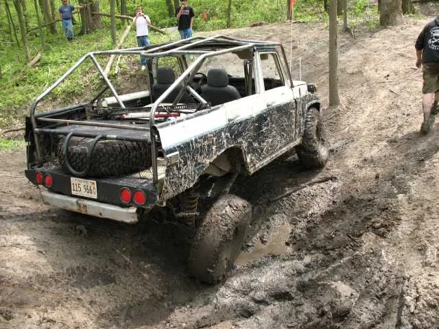

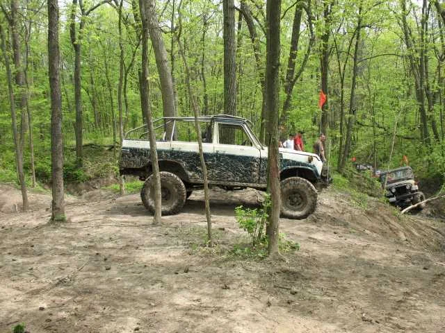

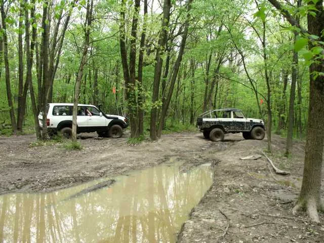

Didn't find everything, but I was pretty happy with the way it worked after a couple of little snafus.
pic 1 - pig in it's natural habitat
pic 2 - The four link flexes a wee bit
pic 3 - my son wheeled the 80 for the first time

looks great... completely natural transformation and more particularly set-up to the type of wheeling it apprears you do. Sweet swine!

What do the tubes tie into that go along the A-pillars. I see that they go through the top of the fenders. Where do they go from there? I like that concept, because it does not take up any room in the interior near the dash.

I wanted to not take up room inside, have something to slide a tree against, and not increase the width.
The A pillar bars go through the upper fenders, through the lower fender tops and then bend slightly to run straight up and down to a 2x3 rec tube that also connects the slider to the frame.
I had them up against trees a couple of times and they work great.

Did I miss what size tubing you used for the exo? It looks like 1 3/8. I was curious what people thought is the minimum size you could use for an interior cage and still be safe.
Ryan.
It's 1.5x.125 tube.

How did you get a "Historic Vehicle" license plate? In B.C. Canada they won't give me one even though my FJ55 looks totally stock. It has a turbo-diesel engine instead of the original 2F. Your truck on the other hand...
