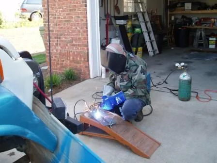

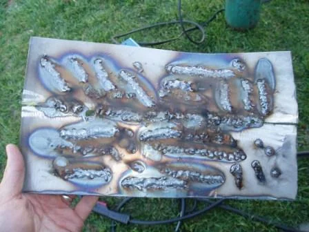

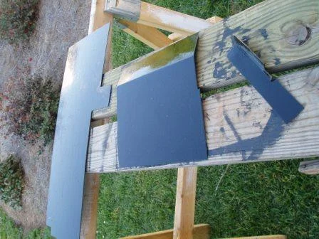

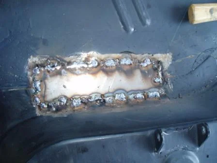

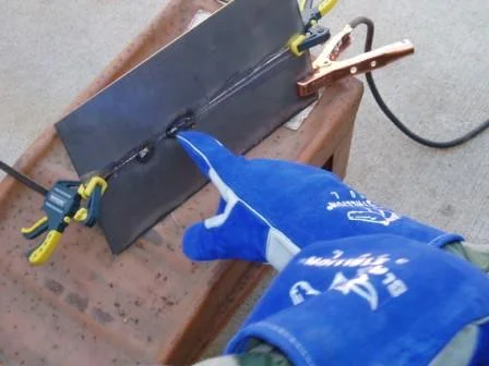

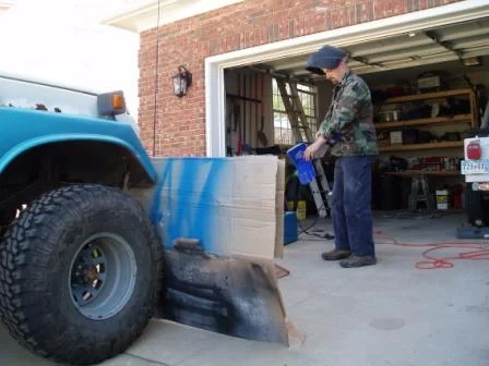

I got a couple of hours in this afternoon. I went to a local 4x4 park this morning which was pretty fun even though I had to ride since my Piggie is still resting. My big accomplishment is I welded for the first time. MIG welding is not as difficult as I thought it would be.
Pic 1) I boxed off an area to weld where my neighbors would't 'look into the light.'
Pic 2) I first practiced on some scrap.
Pic 3) First weld burnt straight through. The second weld was a little better.

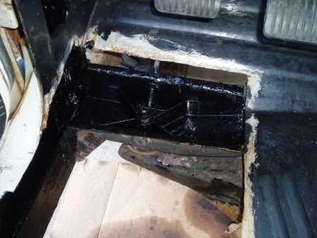

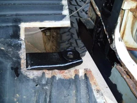

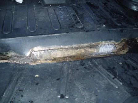

Pic 1) My practice canvas - the metal really heated up fast - I melted two rubber pads on my clamps.

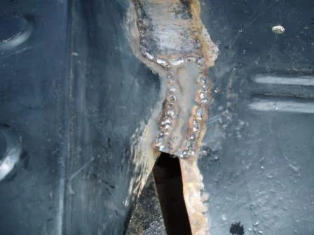

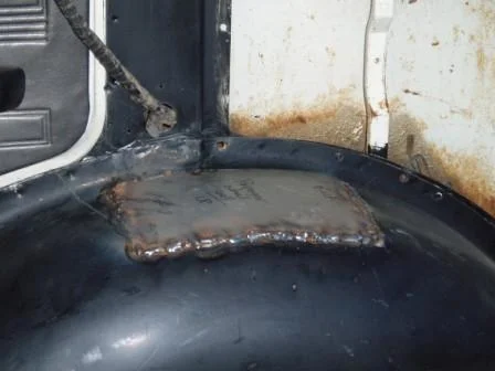

Pic 2) I moved on to welding in floorboard pieces in my Piggie. This is after about 20 minutes max of practice welding for my first time ever. I was happy enough with it.
Pic 3) Here is the same piece with some additional welds. I put a few more welds in then ground down my welds and patched a few parts.
Note to self - you will set the undercoating on fire if you do not grind it away from the bottom of your welds.
I did find out that it is easier for me to push than pull a weld. Thanks to Trollhole for letting me borrow a welding helmet. I also usually tried to push my weld too fast and too narrow.

Did some welding the past two evenings. My welding has improved much from this weekend. I can pretty much push a bead several inches. I haven't tried to go further b/c I end up setting the undercoating on my Pig on fire - I've had to grab the garden hose twice!

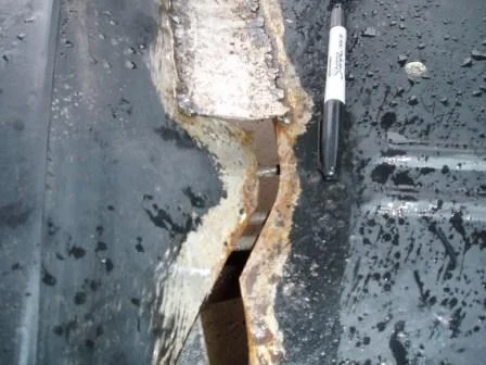

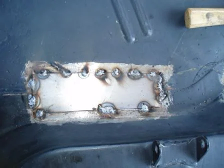

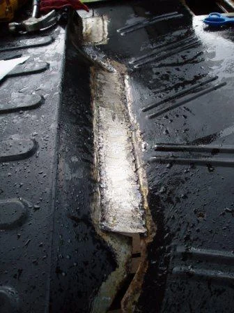

Ghetto Fab 101
I got a little work done today but rain chased me inside - and a grumbling stomach.

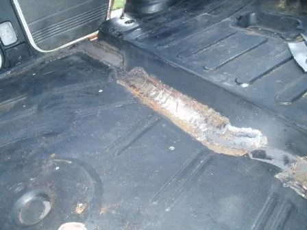

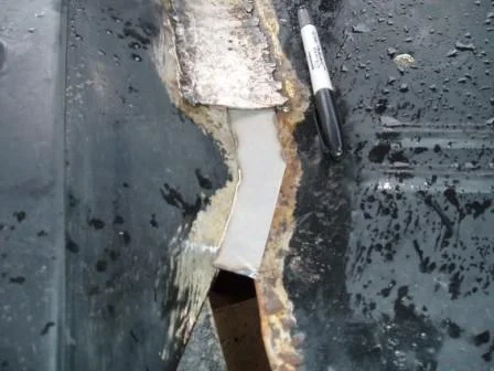

I had been contemplating how to put a curve in some metal, or some other way to bridge a gap between two pieces of metal I had or would be welding into place. The solution....a hammer! Today I was looking at the two pieces and by chance had a hammer in my hand and thought "what the heck," and it worked!
Pic 1) What I started with - long thin piece of ~16 gauge welded into place - note no curve in metal.
Pic 2) Gap I'm talking about. This is at the seam just infront of the rear bench seat. The same gap is on both sides. This is a pic on the passenger's side and I had already wacked the metal a few times to start a slight curve.
Pic 3) Piece of sheet cut and ready for welding.
Disclaimer: I just taught myself how to weld a few days ago...

Few more pics...
Pic 1) Piece of sheet from last pic above tacked into place - these were rushed b/c of the rain. I then beat the snot out of the middle piece to put a curve into it and bring it down to meet the smaller piece, then welded the two together.
Pic 2) Overview from the front.
Pic 3) Neighbor's dog - was white, then it started raining and combine a white fluffy dog with a construction site = hilarity.

I got a good bit of work in this weekend but its hard to tell! I ran out of shielding gas and the only place to get a refill on the weekend was Tractor Supply 40 mins away. I ended up cutting about half a dozen pieces of sheet to fill in my holy floorboard. I POR'd the bottom sides the sheet and will POR the top after I weld them into place. I also POR'd a body mount, underside of door sills, and pretty much anywhere that was rusty and I could reach now but won't be able to when I close up my floor.
Here are a few pics.
Pic 1) Passenger A-pillar body mount cleaned up, POR'd, and door sill and bottom of A-pillar POR'd.
Pic 2) Driver's A-pillar body mount POR'd - also POR'd underside of door sill.
Pic 3) Passenger wheel well patch.

2 more pics.
Pic 1) Seam at rear bench fully patched. Passenger side welds have not been ground. Crescent shaped patch still to be installed in front of rear wheel well has been a pain to fab. I have been using 16 gauge sheet but dropped back and punted today and bought 22 gauge when I was at Tractor Supply. It proved to be much easier to work with and I'll tackle that problem this week.
Pic 2) A shot of about half the panels I cut, fit and POR'd. I POR'd the underside and will POR the topside after I finish welding.

nice work!...regardless of your welding skills -you're getting that floor patched up and functional once again..........so you can get back in the saddle of that pig and get er out exercising. Thanks for the motivation and I look forward to viewing the progression.
