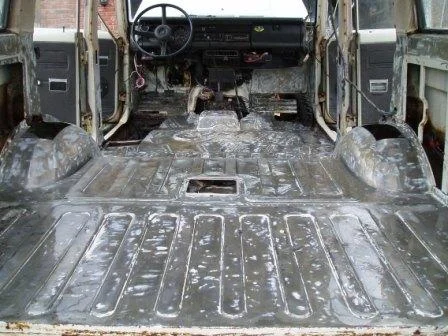

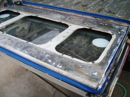

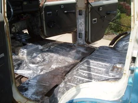

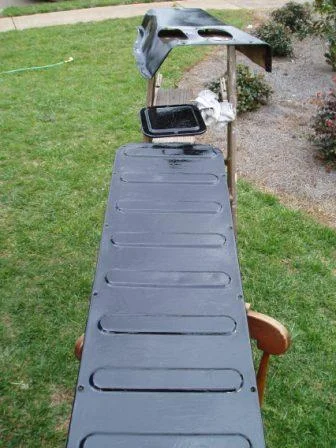

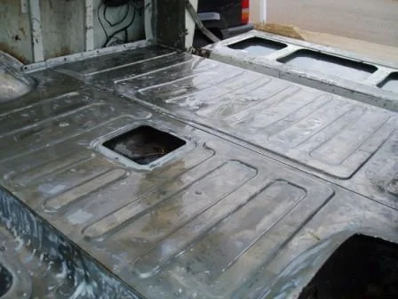

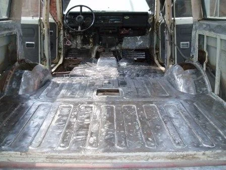

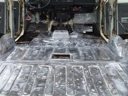

OK - so my camera download cable was supposed to be at my wife's work but low and behold there it was this morning on the kitchen counter - so enjoy the pics!
All three pics are after I have finished stripping of the majority of old paint, grind off rust, cleaning up old factory caulk, and cleaning of dust, etc.

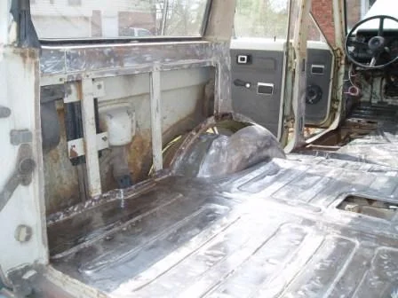

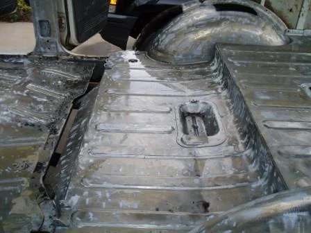

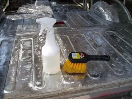

And more pics...
1) Scrub supplies - Marine Clean and scrub brush.
2) Post scrub pic.

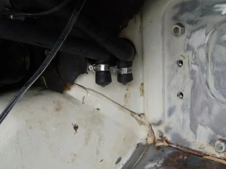

3) Rear heater caps - had to use hose clamps to stop flow of antifreeze. You will see a few drops of antifreeze still dripping from the caps - I had not cleaned up yet.

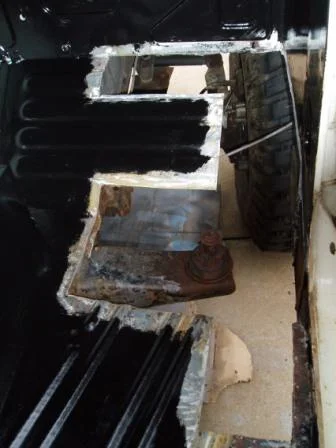

Post etch pics - used Metal Ready.

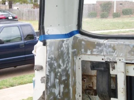

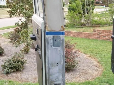

Taping after etching and pre painting.

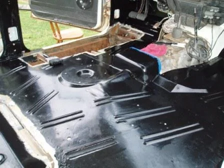

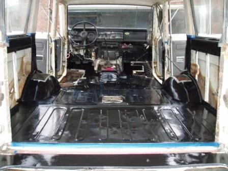

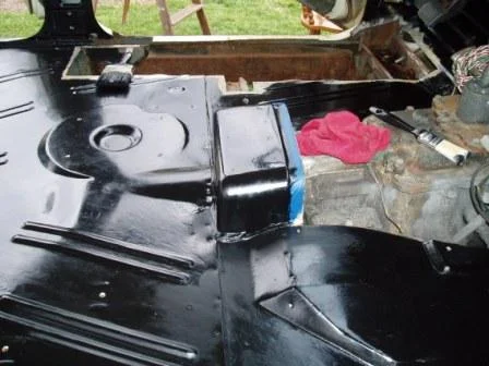

Post POR application - only one coat - I want to put one more coat on before I apply Durabak.

A few more post POR pics.

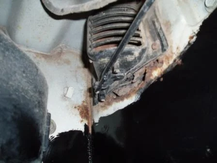

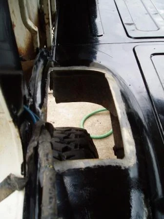

Vent at passenger side vent from fender area - same on driver's side. I'll fix this when I fix the fenders.

You're not going to POR the inside of the rear quarter panels or the doors? Or is that later?
What color bedliner are you planning?
Looks good! Nice and shiny!

POR recoat directions I believe are to rescuff with scotchbrite pad or use Tie Coat Primer they make between the coats...
Indeed the POR is very slick after curing. You probably could get away with just one coat of POR if you are going to herculiner or other over it.
but I would scotchbrite for sure, only takes a few minutes and then just blow off, damp rag and you are ready for next coat

Thanks JM. I just read up on the POR site and they said to wet sand w/ either 400 or 600 grit sandpaper (I forget which) until the gloss is gone and then reapply. I used semi-gloss and its slick but not too bad so I think a scotchbrite pad will do as you say. I'll then apply primer when the second coat of POR is tacky, let the primer cure, and apply Durabak. I'm thinking two to three coats of Durabak. - thanks.

I got a little over 2 hours in this evening. I was able to rub a scotchbrite pad over the POR I just applied yesterday. I might hit it again with something else - maybe 400 grit. I also sketched out some patterns for the sheet metal I need to cut out. I hope to finish them tomorrow and start cutting metal.
ETA: I also removed the rear reflectors - I had to drill out all four screws. I don't think I will reuse the reflectors. I'll probably shave the mounts off flush with the rest of the body.

Posts: 4,362
I'm using the Richard method - heavy sheet metal - I think 14 gauge. I don't think I could roll beads in that.

I cut 95%+ of the sheet metal out with an angle grinder. It was pretty easy. I sketched out with a sharpie where I wanted to cut and then went to town. I made sure of what was beneath where I was cutting. The sharpie lines really helped. I try to freehand a few areas and it was much more difficult. I'm cutting the replacement sheet metal w/ an angle grinder also and its taking a long time. I'm working with about 14 or 16 gauge sheet - I think 14, which matches what was already in the floors. I'm not worrying about rolling beads b/c the 14 gauge is pretty beefy but on the other hand its heavy and harder to work with. I think something thinner with a bead roller might be the ticket.
