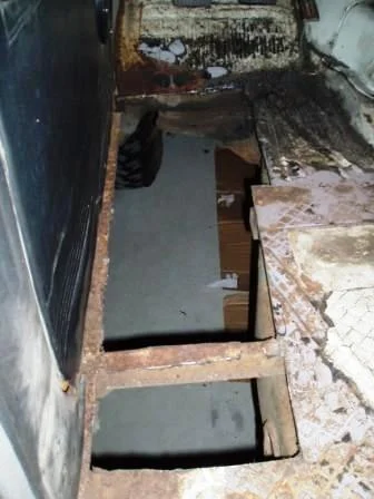

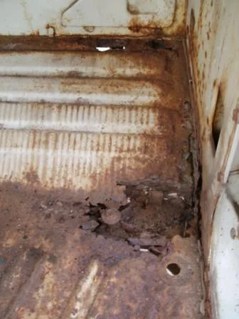

Pic 3) Cut out driver's side floorboard - still more to cut out futhur up front. Had to cut out one support - will weld in a piece of angle iron for support.

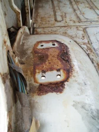

Pic 2) Body mount @ driver's side A pillar. Not in too bad of shape - plan on cutting out rust from floor, cleaning up body mount, and coating in something.
I cut out much more metal than what was probably required. I wanted to make sure I had a good surface to weld to.

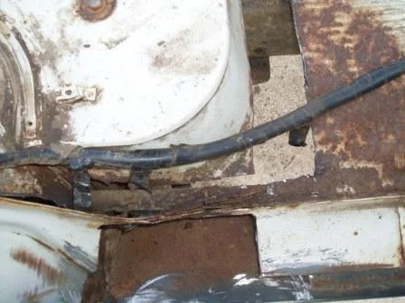

So I feel bad about not giving any text...here is a little...
I spent about 10 hours this weekend cutting out rust so I can weld in new metal, install bucket seats, and lay down a bedliner. I didn't get as far as I wanted to but I am pretty happy with my work. Some areas look better than I expected and some worse but nothing I can't deal with.

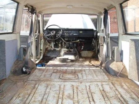

Pic 1) Shot of the inside at beginning of work this weekend. At the end of the weekend I pulled out the rear wood panels, speaker boxes, speaker wire, wheel well covers but didn't get to the heater. It will come out soon.

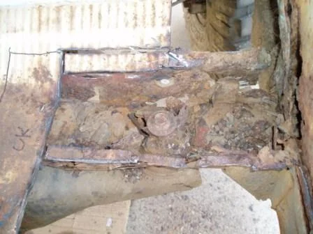

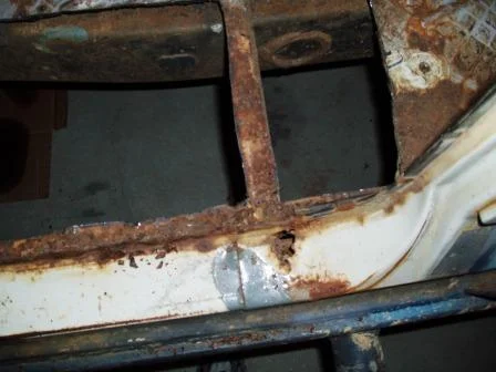

Pic 2) Before shot of rust at rear seam under rear bench. I have cut all of this out but didn't take a pic - will add later.

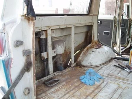

Pic 2) Rear quarter inside w/ wood panel removed and rear wheel well cover - some rust at wheel well...still to be fixed.

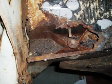

Pic 3) Passenger A pillar body mount before work started.

Pic 3) At rear passenger door - still cutting out more rust - this will be tricky to replace.

Is this underneath the rear seat? I never even looked there.
What are these? Nasty cracks.

Yup, under rear seat. It wasn't too bad. I cut out all the rust and will weld in some new metal. The only place that I am still figuring out how to fix is between the rear passenger's door and the bed hump.
Those cracks are on the old front bench mounts that I cut out. No worries though as I don't need them for anything.
