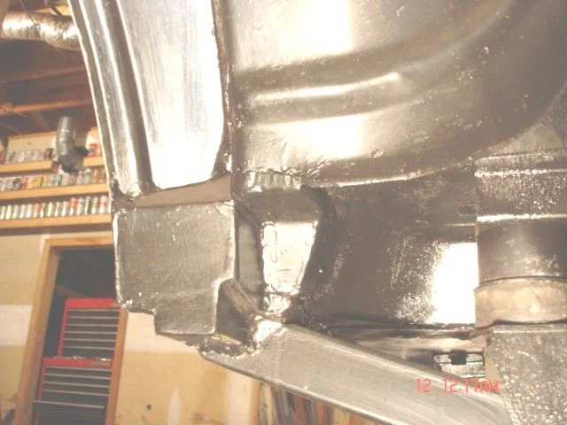

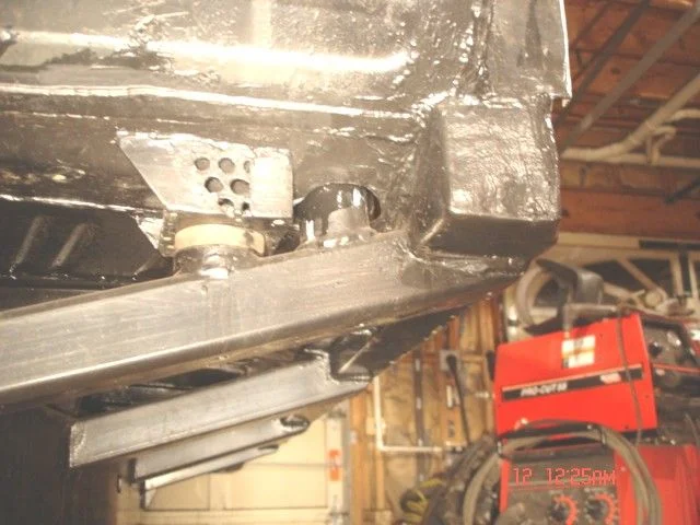

There was so much rust through, I had to cut & refab the rockers & the ends & the rail where the weather strip mounts & part of the floor. I also drilled some drainage holes in the lowest part of the rear floor. Don't forget to check the front body mounts as I had to refab those too. I still need to clean up the front a little - used a little too much POR patch. Hopefully this *may help:

That does help Chuck, thanks. One thing that I am not sure how to do is to rebuild the rusty door stops. The ridge that the weather stripping attaches to is gone on both sides. Any suggestions on that?
