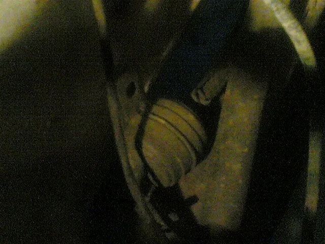

So I've run into some problems with my piggy. After my last trail run it developed a fuel delivery problem. When going up hill, under load, it would sputter, buck and kick. I could fix the problem by kicking in the toy-box to reduce the load on the engine, but then obviously I was just crawling along.
When going down hill, it was fine even under load (i.e. pushing through snow, etc). So I don't think it really is a carb issue. So finally I've gotten sick of looking at the poor pig in my driveway and despite all of the f-ing snow, I want to get it back to status quo.
So, I think either it is the fuel filter or the fuel pump that might be going south. Has anyone had to replace the fuel pump on a 2F? I think the engine is a 78 or 79. Also, does anyone recognize this fuel filter? Is it even a fuel filter? Sorry for the crappy pic, I can snap a new one during daylight if it is unrecognizable:

Sounds like a filter to me

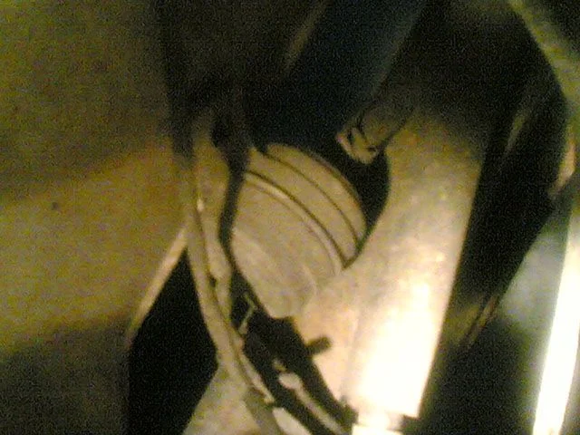

Do you recognize that filter? it is resting on the passenger frame rail near the oil filter.
Is that a part I can get from NAPA or should I go with OEM stuff? Keep in mind I want to make the fix as cheap as possible to make sure that is the problem at hand. It doesn't look like those glass or metal bottomed fuel filters I've read about in the 40/55 forum.

That's the fuel filter there in the picture.
Once when travelling, I developed fuel issues and limped it to a NAPA store. They were able to make a decent enough match to the OEM one in terms of the bends and such. I don't have the part # handy though... just bring the filter in there. After that, I was off like a rocket! Well... it ran better.
