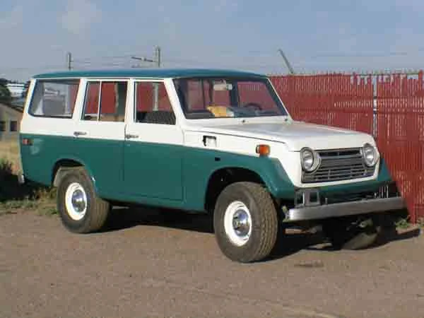

74 FJ55, Bone stock almost rust free.
Purchased from Flagstaff earlier this year, drove it home and sent it down to Lance at IPOR.
Mods being done include front disc brakes, suspension lift, new interior, new Ram Jet being installed after interior and engine bay get speed lined, and a custom designed front bumper by Lance.
Will post a few pictures from when I purchased it to where we're at today:

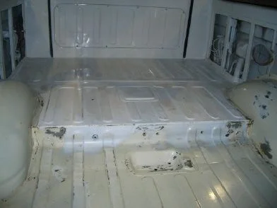

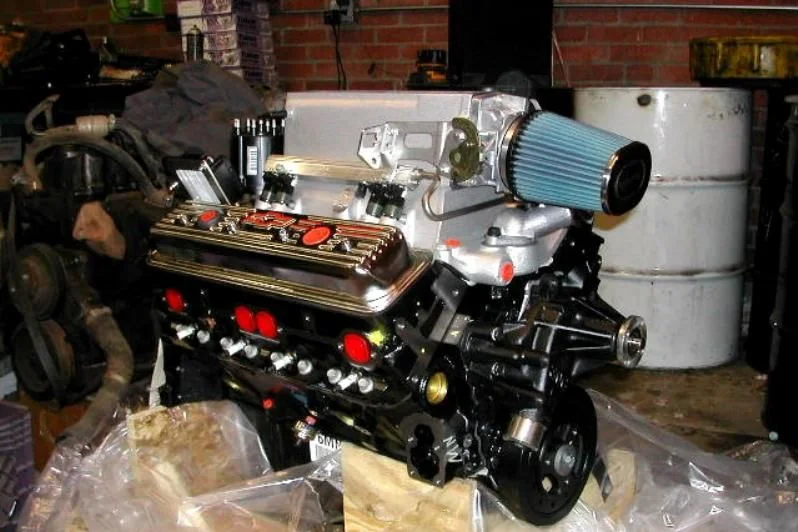

Few more Pic's
Ram Jet, Rear Seat and Door Panels

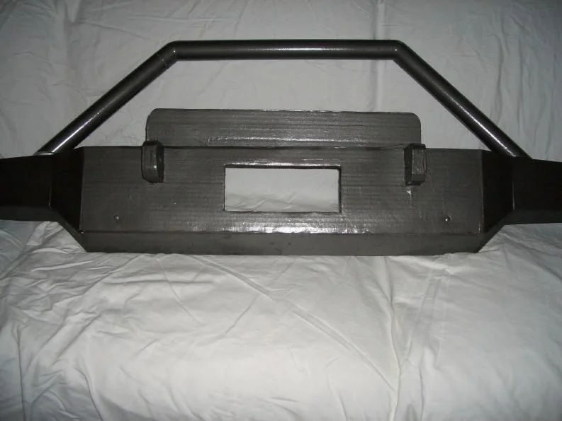

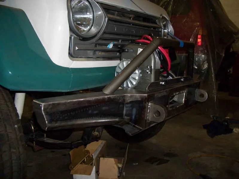

So, can we get some more detail on that bumper? I like it a lot and mine looks crappy (the whole thing, not just the bumper )

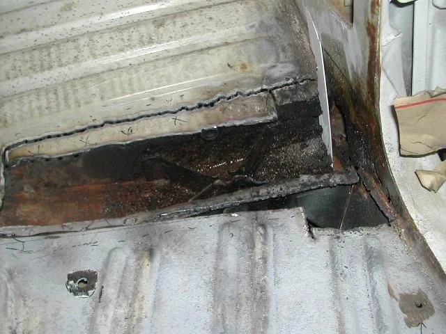

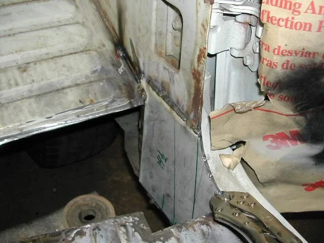

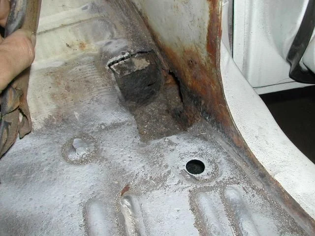

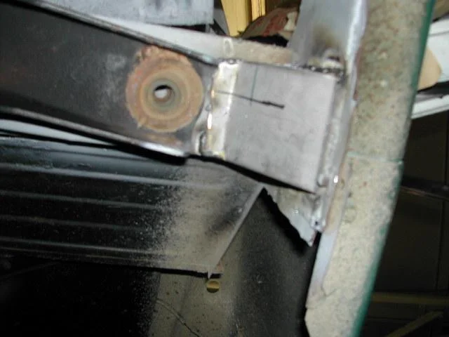

Ipor did find the right front floor support was pretty bad, so it was cut out and rebuilt otherwise nothing serious yet! But this truck has live out west and is now in Va, so I'm sure its comiing. Powersteering(toyota mini box,New H55 trans(Thanks to Seth at PVCruisers) and Vintage A/C. I mocked up the bumper full size in cardboard and we hung it on the front , it looked great so IPOR built it, its a one off, rear bumper is IPOR with a tire carrier. I believe Lance is working on a front bumper that will be Laser cut, you should call him. Thanks for the support.
Lou

toyota mini box
I would NOT recommend a "mini" box when you can use an FJ60 box or even better, a Scout box. Looks like everything has to say Toyota on this buildup, so FJ60 box it is.
I'd say that's the worst place for rust to hide in a 55, right below the front lower door hinge. Both sides of mine were eaten up badly.

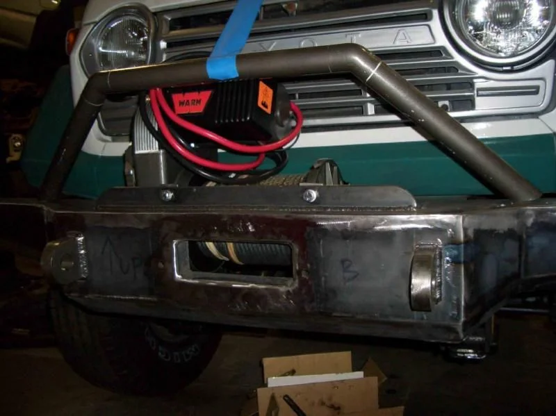

I really like the style of that bumper. It's about time somebody came up with an LC bumper that's not a piece of channel w/ a winch plate welded to the back. Nice touch!

My Bad! We are using the FJ60 box. I'll talk to Lance regarding the bumper. He liked my design wth a few changes so he may produce something similar!

The 55 is looking great! You are being too modest about the bumper. Lou brought in an excellent cardboard bumper mocked up to the 55. The guys at Ironpig did a great job duplicating it. I like the Ramjet and the H55 tranny that will be a killer combo. Love the seats. I am waiting on material so that I can get my rear seat, and interior panels recovered, bad news is there is an 8 week wait on the material from Procar.

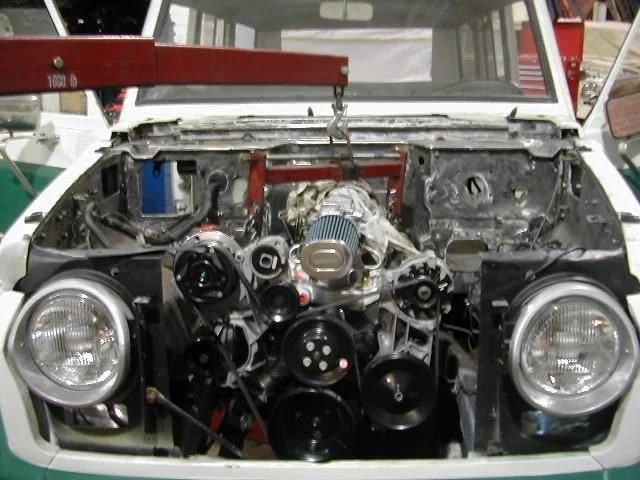

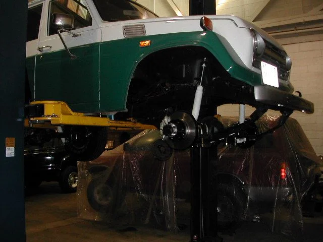

Here's the front disc, suspension and engine bay and interior ready for speedliner. Yesterday the crew at Ipor fit tested the engine and trans. The good news was the shifter placement , right through factory cut out. Lance insisted not using Mark's Adapter with the Ram Jet & H55 setup would put the shifter in the correct place.
Lou

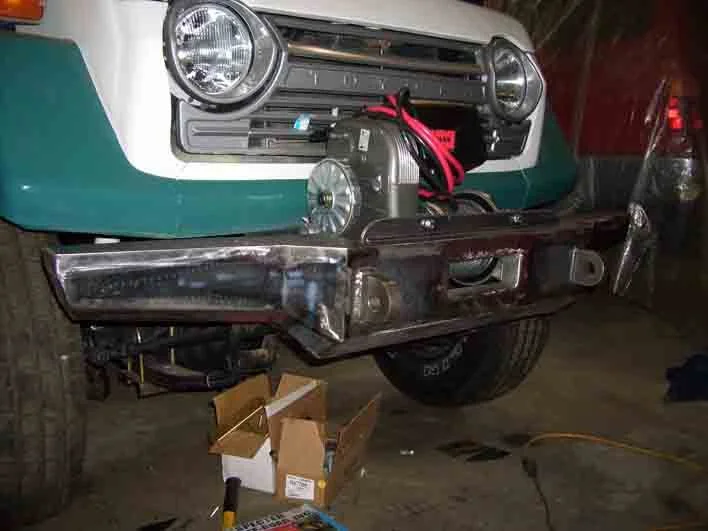

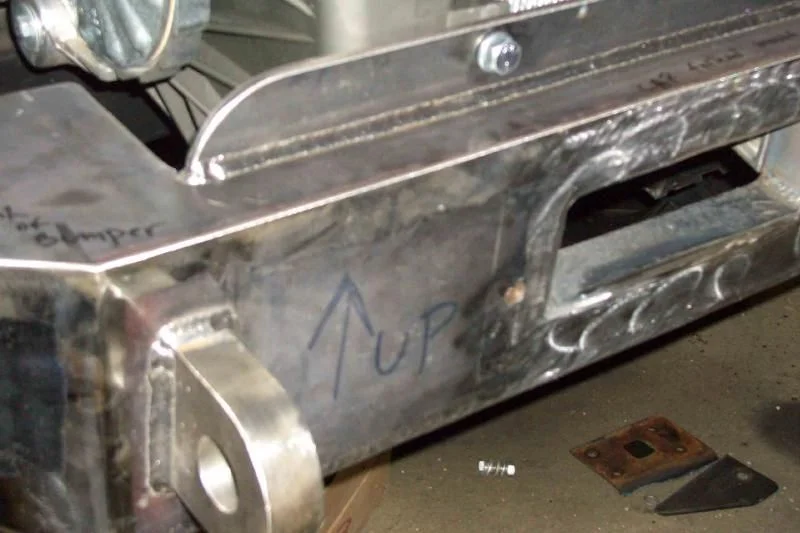

Here's the bumper mock up and the Ram Jet. A friend explained photo resizing.

Rust Repair
Here's that front floor support that was repaired

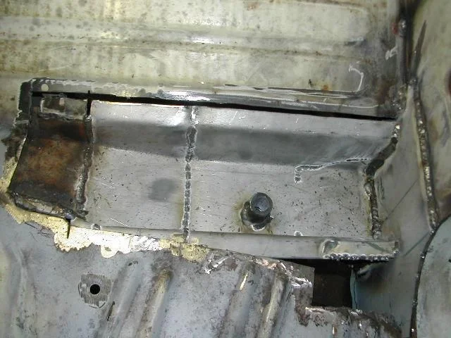

Then completed

Nice Job. I will be using those pics as a guideline for both sides on the pig project I have going.

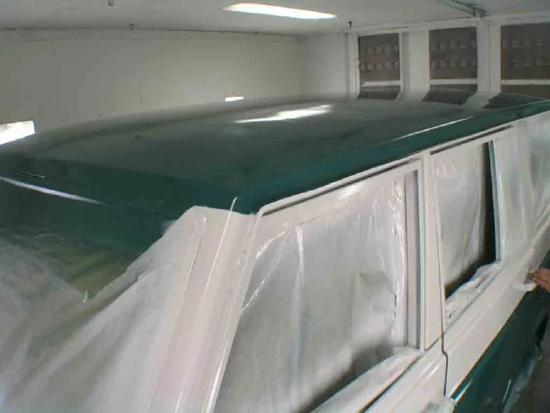

Here we Go!!

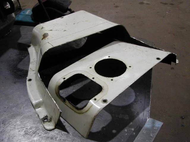

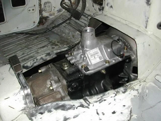

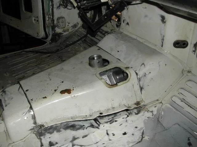

Test fitting the Ram Jet and H55, Shifter fit is perfect ,the tunnel cover had to be modified for clearance.

Cover showing shifter position!

That bumper is I am speechless, just a fine work of art and looks tough as nails.....
Boy Lance and the guys do some very very nice work...

I got to see that bumper in person a couple weeks ago. Really nice, and well thought out design. lean as hell rig too. Makes me want a 55 even more.

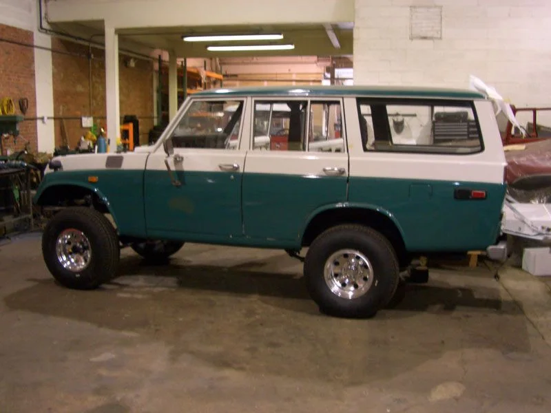

Painted Pig!!

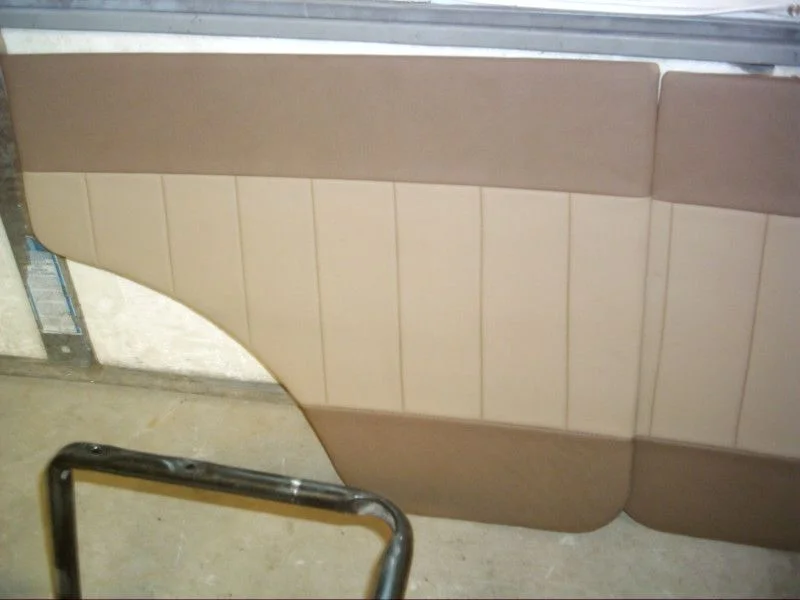

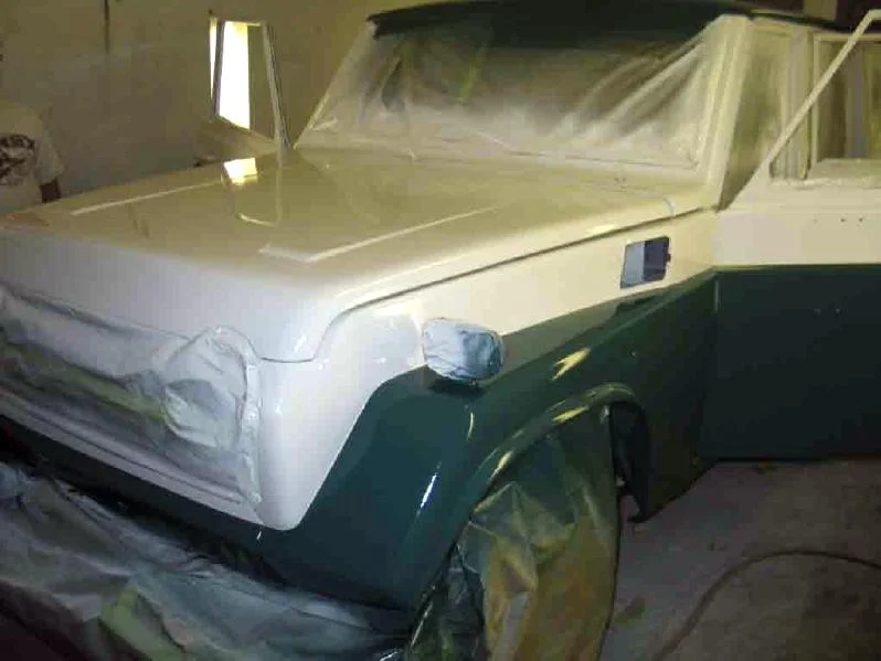

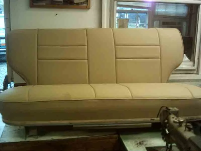

All the panels including the rear bench were done by a local company, Coachcraft in Frederickburg VA . Using my old panels as patterns they made new back boards complete with cut outs for the clips and window cranks. The panels have 1/4 inch foam and matching vinyl I purchased from Scat, the darker vinyl I got from a local craftshop they had a large selection and it was cheap. Coachcraft match the seat pattern from the Procar buckets I got from Ipor. As for the bumper when finish will have a winch protection bar appox 6 to 8 inches above the bumper Piaa driving lights then both front and rear bumper's will be powder coated grey like the factory color. This monday it gets speedlined. I'll post more pic's after thats completed and we get the engine installed. I asked Lance If could get this baby wrapped and stuffed in my chimney for Christmas!! Thanks for the support!
Lou

Thanks for posting!
Those pics of the bumper and the body mount repair are a great resource!

Posts: 870
Few more bumper shots
The winch protection bar idea. It will not extend this far from end to end , need to make room for the driving lights and not sit this high.
Thanks again
Lou
