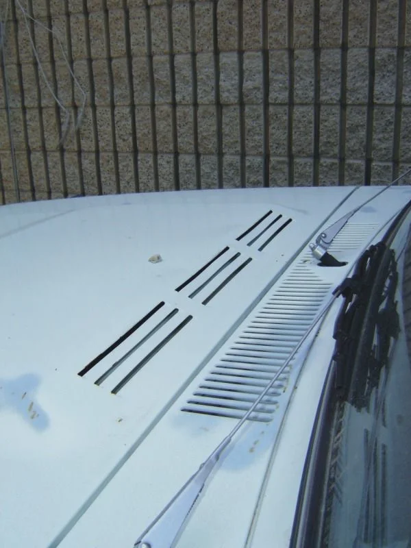

Hi Lou,
I checked through this thread and must say I am impressed with how nice she's coming along.
I was thinking, if you were willing to stamp vents into your hood, would it be possible to use a hood from a '75 (as hard as it may
be to find)?
My Pig has hood vents in stock form, and they function quite well.
Eng compartment temps are not a problem. The vents are internally channeled to keep weather out as well.
Best Regards,
George

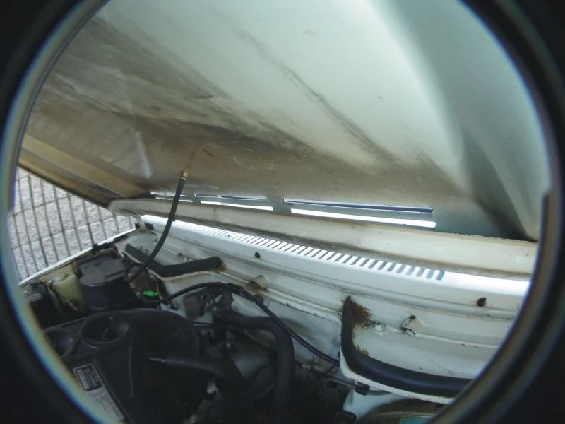

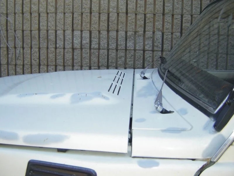

Hi Lou,
I was able to get some pics of the vents I was talking about just for reference.
The first image shows the vents toward the rear of the hood. I am not referring to the cowl vents...
...Note the hump in the center which provides the rearward slope for the vent slits...
...And note the rear bracing also acts as the channel to catch the water, letting it exit out to the sides...
...Where the water travels down the front A-pillars,
Pooling up at the front corners of the floorboards,
Causing complete rust-out and destroying the body mounts
as well...
But that's another story...
Hope this helps,
Best Regards,
George

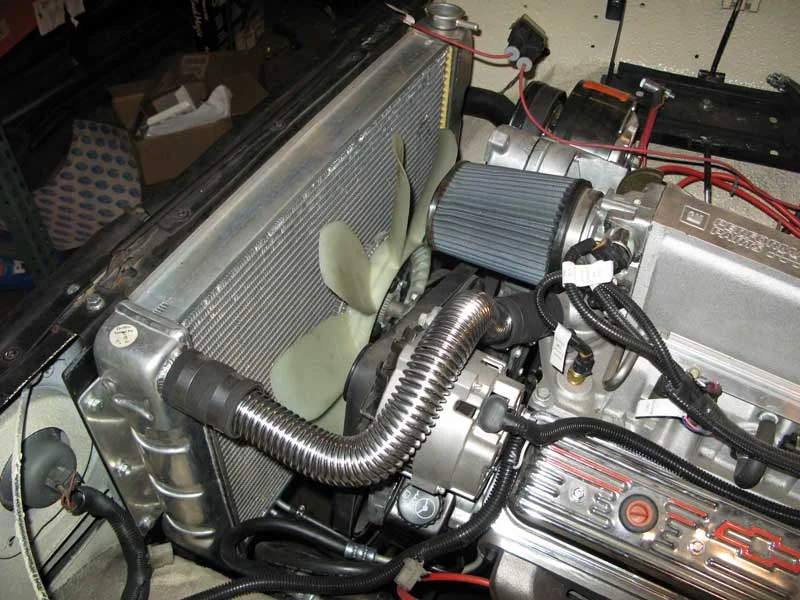

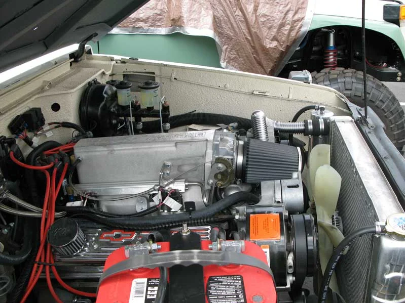

Posts: 870

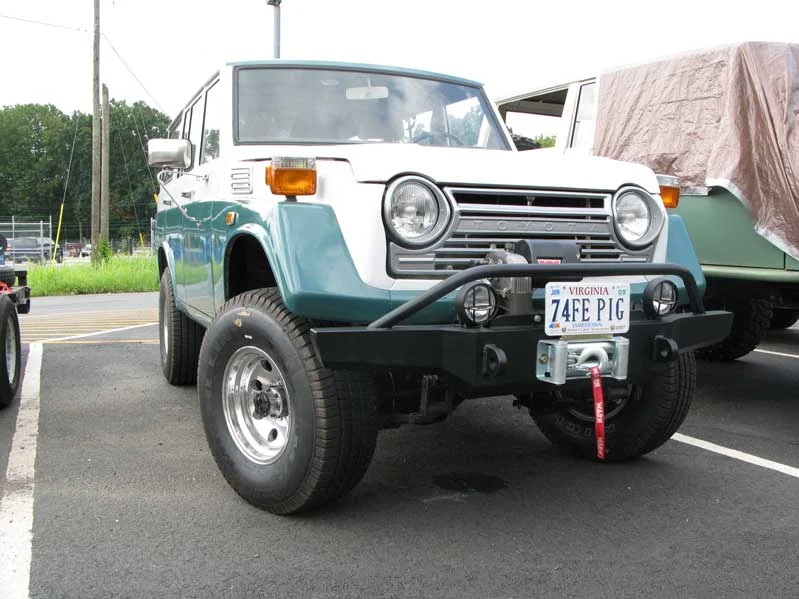

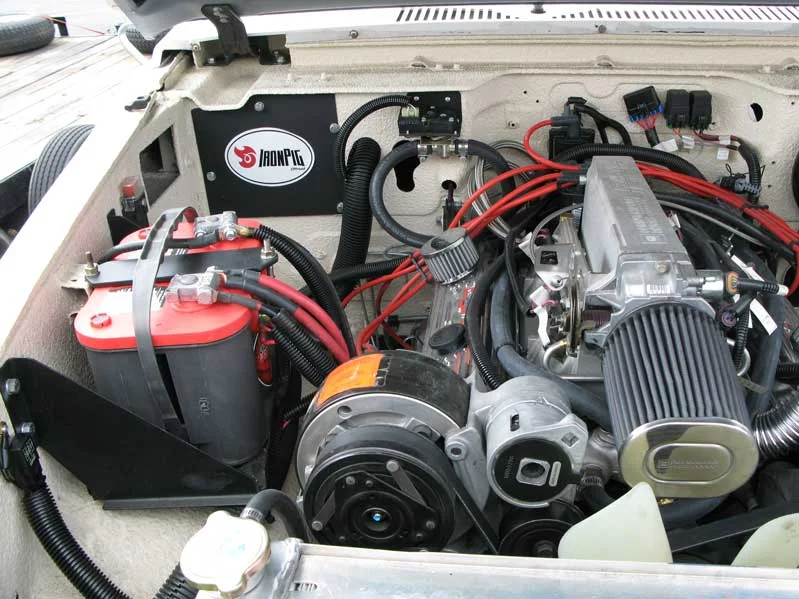

Update and Pic's

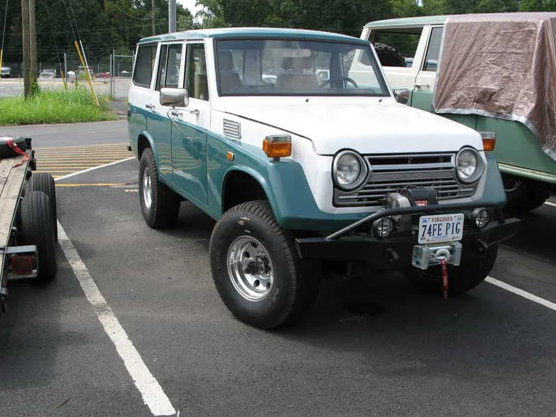

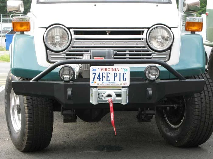

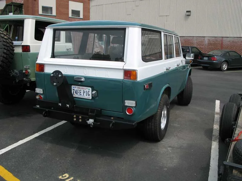

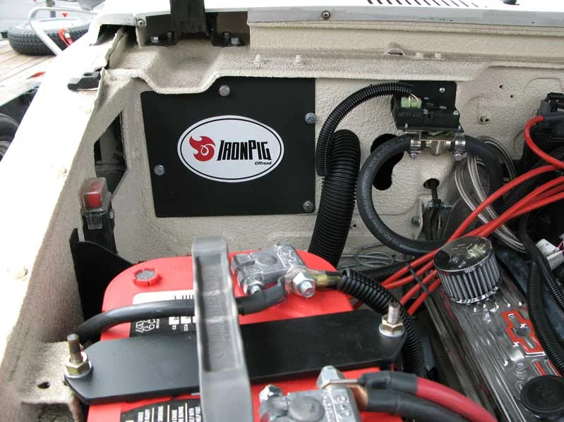

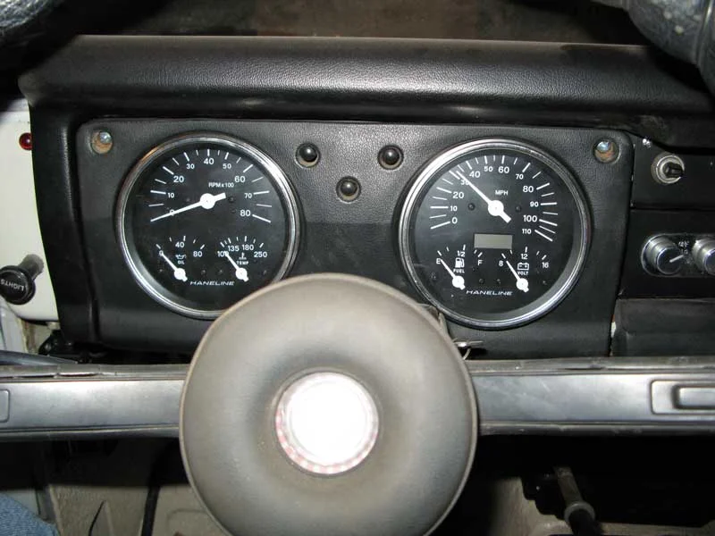

Here's the update, the boy's at IPOR have installed my Vinatage A/C, Radiator, Gauges, and fab a new center dash area, simple and clean, like nothing was change. They fab a plate that retains the two center vents and connects to the a/c unit , making it seem like one unit. It also has two side vents and defrost vents. All the gas lines are in, brake lines formed and connected. It's getting close.
Lou
__________________
__________________

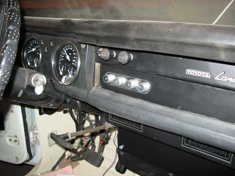

Posts: 870

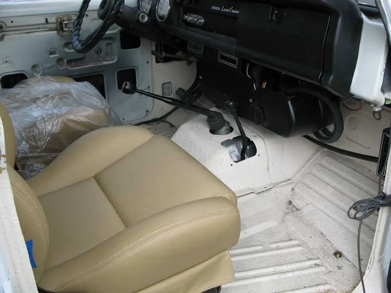

more

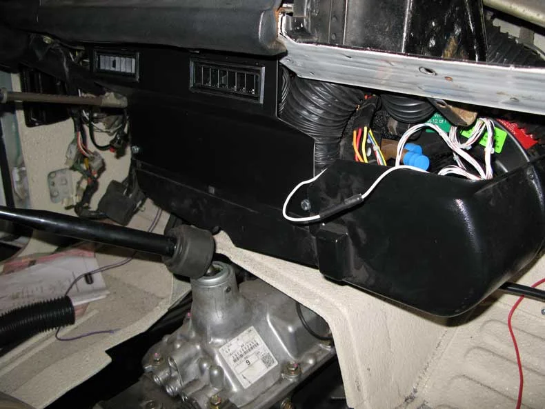

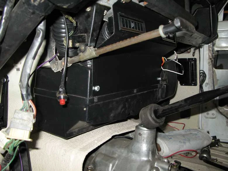

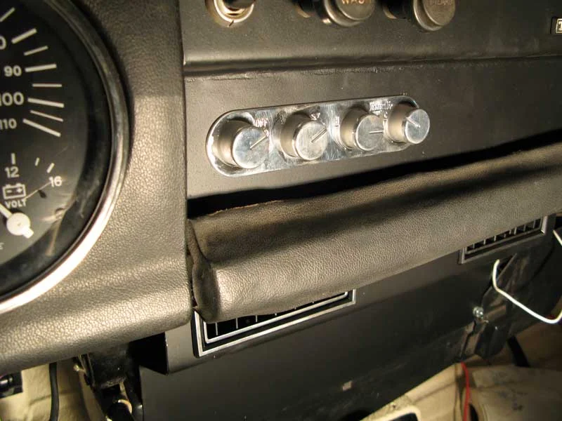

The lower dash pad is pretty crappy so I'm going to order a repo, I think Sor's has them. With this A/C , you can't really tell from the photo's but there's still lot's of room for the passengers feet.There will be another plate that covers the right side of the A/C unit.
Lou

Is the radiator a cross-flow aluminum? Can you provide the source please?
Thanks,
Gene
genesmith5720 is offline   Reply With Quote
Old 07-26-07, 07:42 PM   #133 (permalink)
250+ Club
Luke111's Avatar
Join Date: Aug 2006
Location: Northern Virginia
Posts: 870
Soon
Thanks for the reply's, It looks like it may start next week, I could make the Pig Run! I do not no the source for the radiator, If you email or call Lance at www.ironpigoffroad.com he'll have the answer.
Lou
__________________
__________________
Lou
http://forum.ih8mud.com/fj55-iron-pi...y-new-pig.html
74 FJ55 Ram Jet 350, H55 , M416 Trailer
Ironpig Offroad Built
2007 Lexus IS350
Luke111 is offline   Reply With Quote
Old 07-26-07, 07:51 PM   #134 (permalink)
250+ Club
scottryana's Avatar
Join Date: Feb 2004
Location: Alexandria, VA
Posts: 608
Lou,
I hope you don't mind, but I have been over your rig several times. It is a Griffon Radiator from Summit Racing. It is a 24x19.
Part Number: GRI-1-25202-X
Webpage:
http://store.summitracing.com/partde...5&autoview=sku
Ryan.

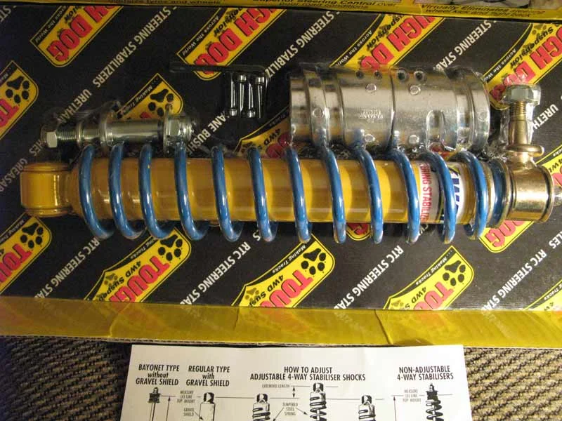

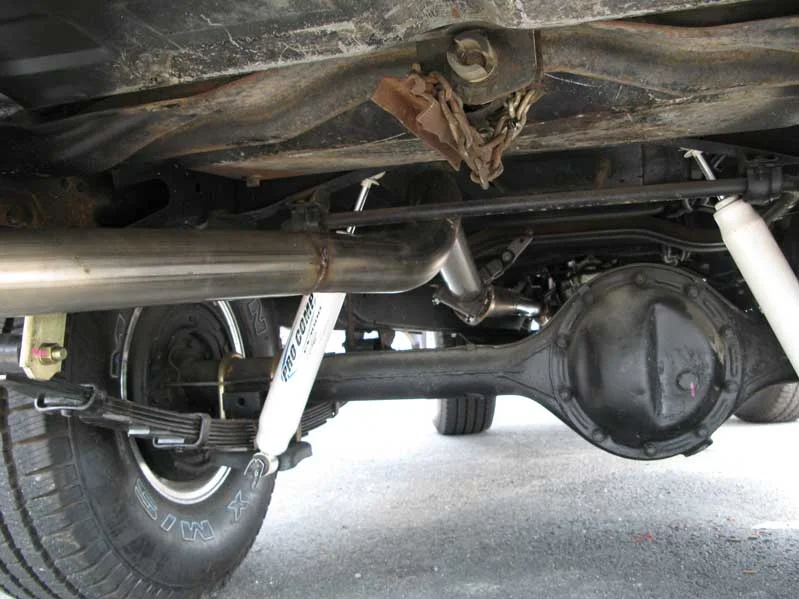

Steering Stabilizerfrom AU
Is anybody running this stabilizer? I bought it off Ebay from Company called 4WD1. Its designed for the FJ40 and FJ55. Pretty beefy. Any thoughts good or bad about running this on my 55?
Lou

I have never seen a steering stabilizer with that design, but it looks a lot like the load enhancing shocks that I have seen on several of the 55's. It will be interesting to see what you think. What led you to these? Regardless way to think out of the box.
Ryan.

Cruising Ebay, check out this site, it has a detailed write up regarding the stabalizers, www.4wd1.com, they also have an Extreme XHD for Coil over and to help control up to 44's. The owner Kirk, was great to deal with. Shipping was a bit pricey, but it arrived from AU in four days.
Lou

Almost complete
Here's my baby, bumpers, new turn signals and a few shots of the engine bay. Having issues with the fuel pump, so it's getting replaced. What's left? front seat belts and aTuffy Box and 33x12.5 MTZ . The 31x10.5 Michelin ride very nice on the road and is perfect for testing out all the new engine and drivetrain. Enjoy the pic's
Lou

more
Engine bay.

more
Exhaust,interior

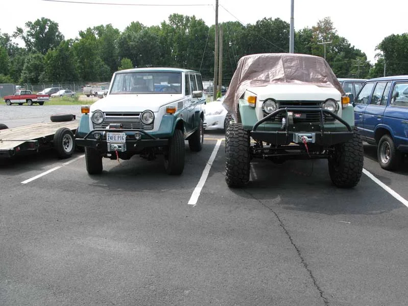

Little Piggy, Big Piggy
Next to Ryan Scott's big rig
Lou

Old 09-13-07, 02:19 PM   #147 (permalink)
Yankee Toys Prez
Sporin's Avatar
Join Date: Apr 2003
Location: Windsor, VT USA
Posts: 2,722
can I see a full pic of your exhaust routing?
