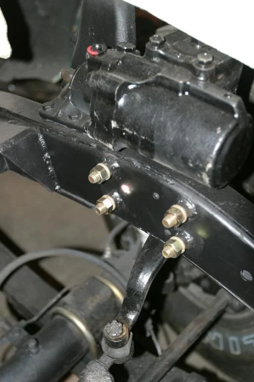

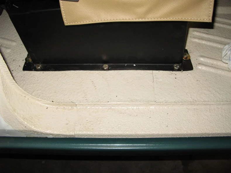

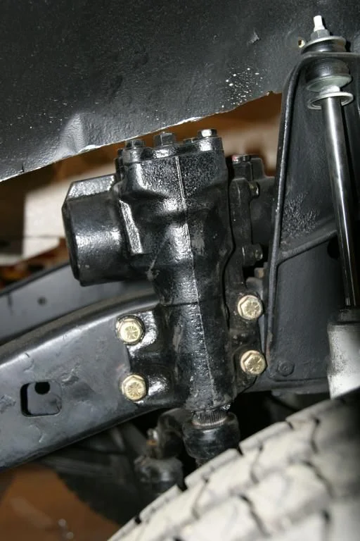

Here's the power steering

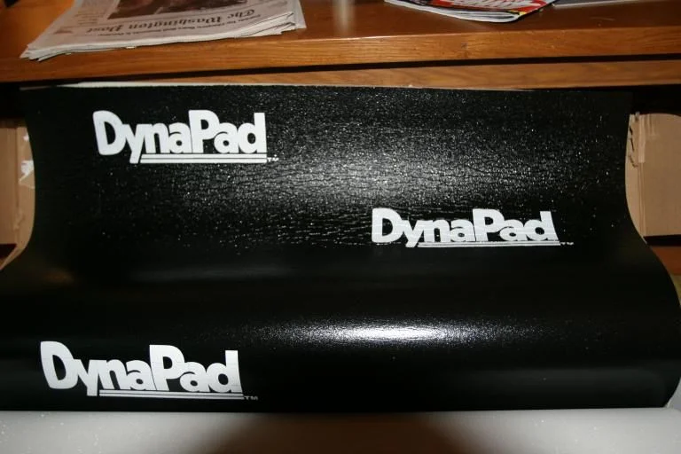

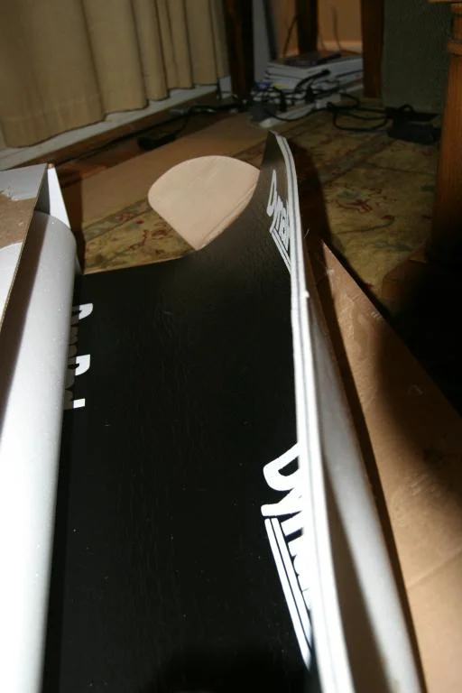

Dyna Pad
Here's the Dyna Pad, Its about 3/8 , but will compress to 1/8 . Its just foam with this Black cover an a black center layer, should work well. Cheer's Surfpig !!
Lou

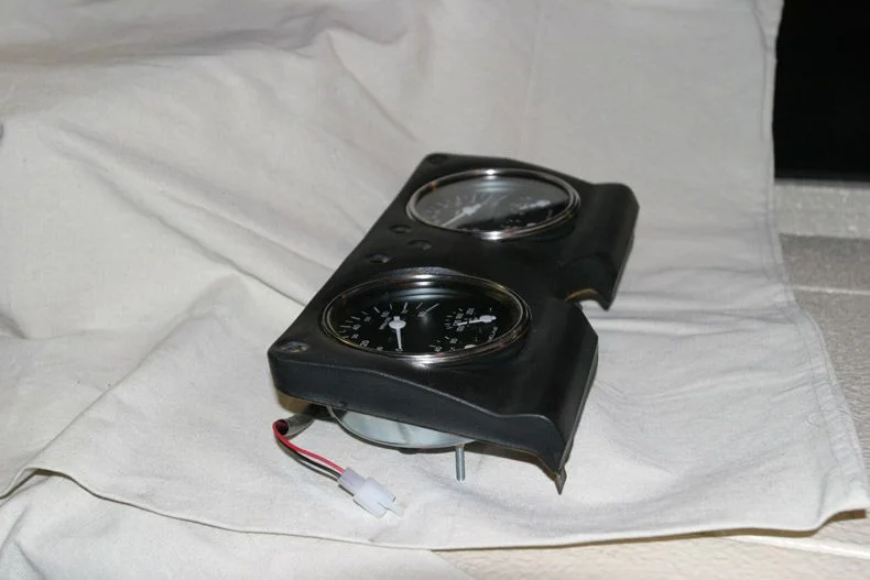

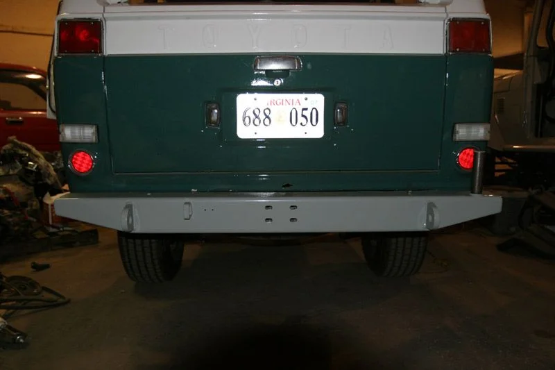

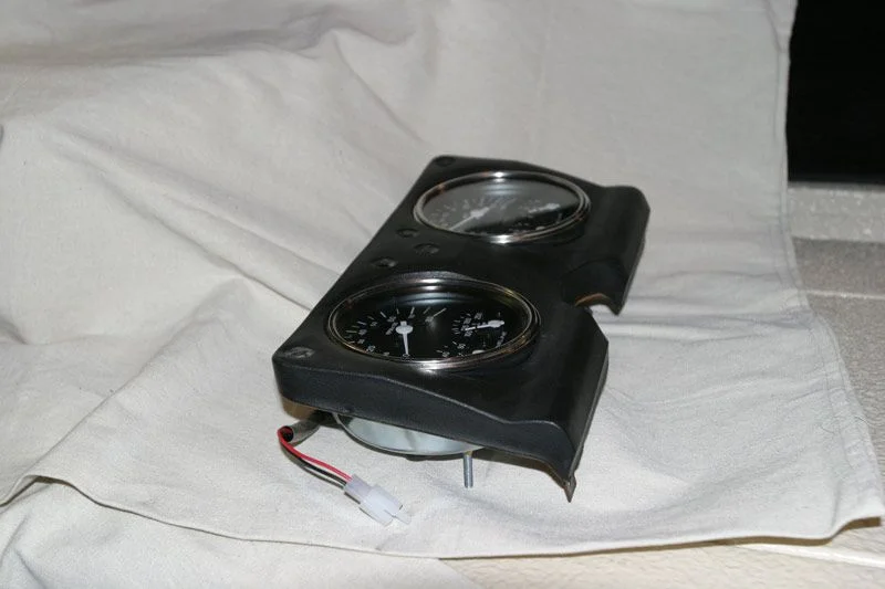

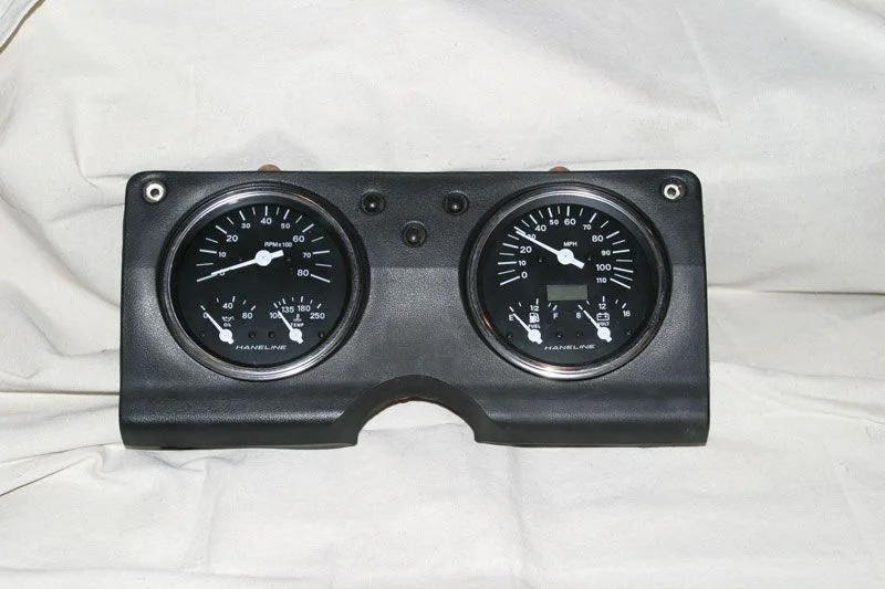

Rear Bumper, Gauges and Header Pic's

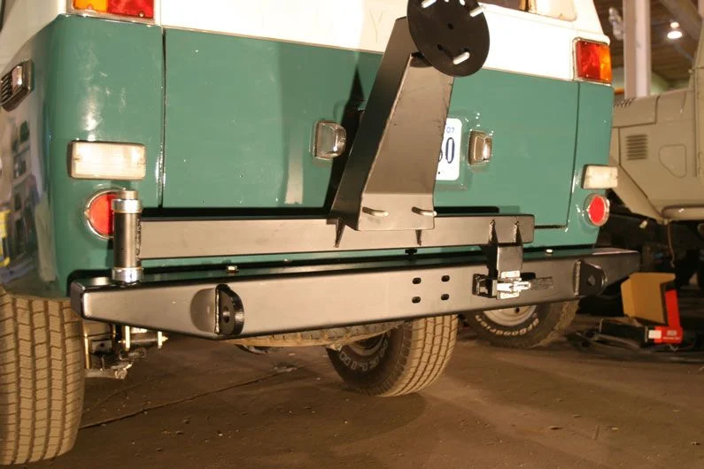

I decided to power coat my bumper gray, going for an old school look, Well , it came out looking more like high gloss primer,so it's going back and will get the Hammertone Color. I also got my gauges installed into the 55 gauge cover by triming the inside rim area. There is a metal ring under the vinyl so I had to stop at the metal and shoved the gauges in from the front, The bottom of the gauges stick out about 1/4 inch but look good. Future plan is for a custom dash using the tubed air vents from the FJ Cruiser.
Lou

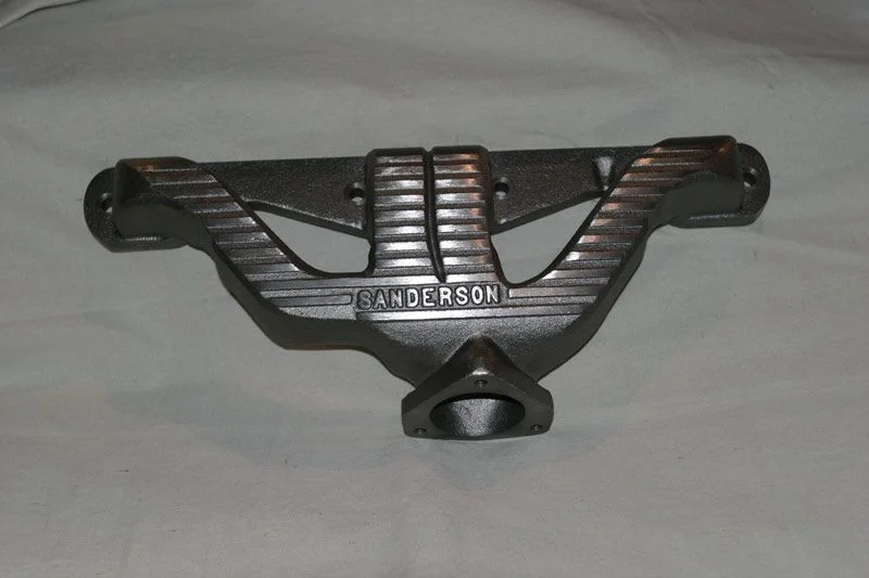

Header Pic's
These cast iron Sanderson Header's are sweet!!

Once again everything is looking very nice. I really like the gauges, they have a classic old school look. Whats the story on the headers? I can't remember if your ram jet had manifolds. Are these headers just to make routing the exhaust easier? What ever the reason they do look sweet.
Ryan.

header's
TLC recommend the Sanderson, they hug the motor I assume for that reason plus they look good. I also installed new dash pad from SOR what a pain just getting to the bolts, had to remove the glove box for to two above it. With the box out I sanded primed and painted gloss black also removed the hinge and the metal glove box door plate which I aslo painted and will bolt on a new glove box door also from SOR.

From www.Haneline.com, lots to choose from.

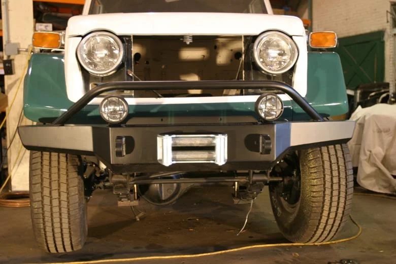

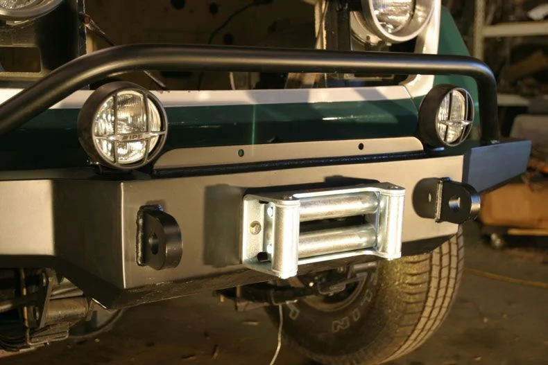

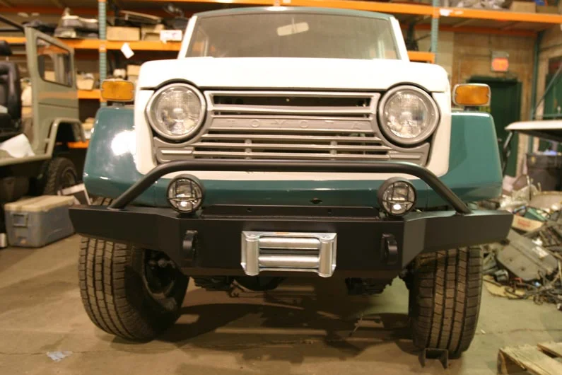

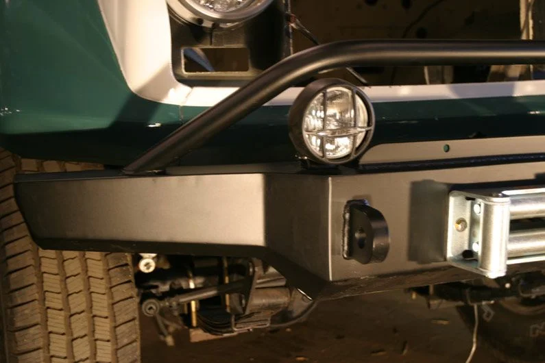

Pic's Front bumper Powder Coated
Went down to Iron Pig Offroad for a Pig Fix, the front and rear bumpers are back with fresh powder, they came out great.
Lou

Pic's Front and Rear Bumpers
Few more! Rear shot show Amber&Red Fox Fab Tail Lights, many thanks they came out great. Anybody know where I can get the weather strip that wraps the chrome trim on the tail lights??
Thanks

That looks great! I am really impressed how nice the front bumper looks. Keep up the good work. You are going to have one of the nicest 55 around.

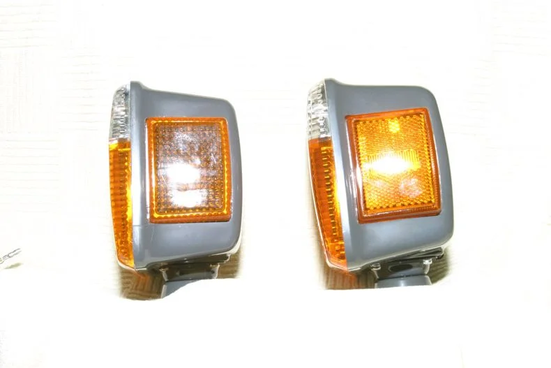

Piggy Turn Signals

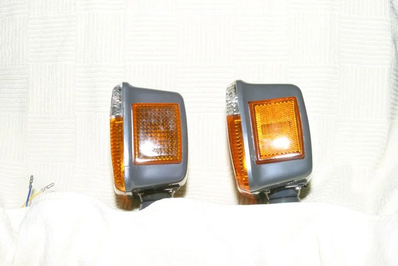

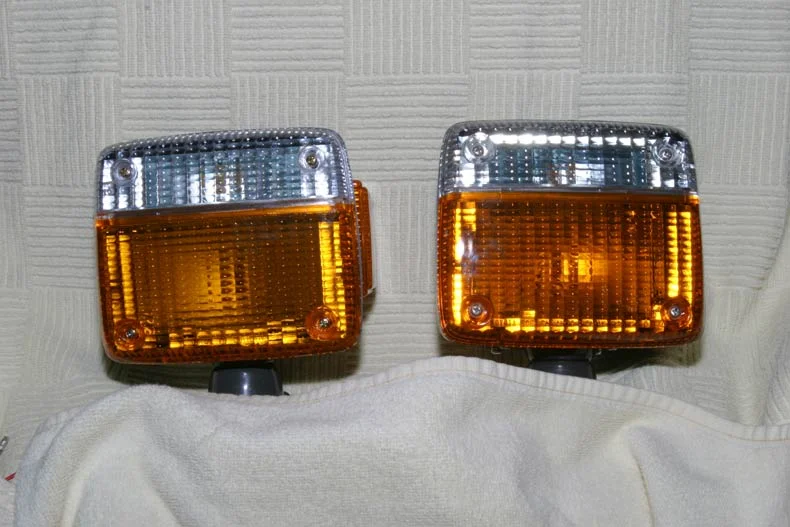

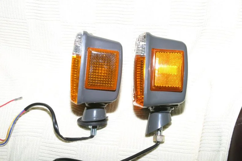

Thanks to Trollhole I just got these from CruiserParts, the one on the right is OEM 40 that I got from Toyota, the other is a aftermarket 55 with the correct angle for the 55 fender and includes the rubber gasket. Thanks Marshall you are Da Man !!!!
Lou

Turn Signals
Ok! sorry.... Here's the base angle pic.
Lou

lou, the truck is looking just awesome, wonderful job!
I really like the way you did the guages, i wanted to do the same to my 55 and was wondering how to do so. Can you post up exactly how you got them to fit? did you just trim out the inner portion of the circle to fit and push them in from the front? Also, what holds them in? just a press fit? or did you fashion something to attache them to the back of the pad? Also, what type of guages are they and where did you get them?
Thanks!

Noah I use a razor knife and trimed the inside ring of the pad down to the metal ring, trim very carefully, the ring under the pad limits the size, so the gauges stick out about 1/4 inch at the bottom. They fit tight but the plan is to fab a small bracket on the back, they clear the dash supports behind the pad. I got them here www.haneline.com . BTW your resto is looking good ......if I had the time , tools, a garage and few more dollars, I would do a frame off like yours but Lance at IPOR said he would cut off my left n...t if I get anymore idea's, so maybe next year. Here's the pic of the gauges,you can see how they stick out just a little at the bottom but from the driver's seat, front veiw you don't notice. The link to Haneline is not working so try this www.roddoors.com this works, go to products and gauges, I'm not sure what's up with Haneline's web page...
Lou

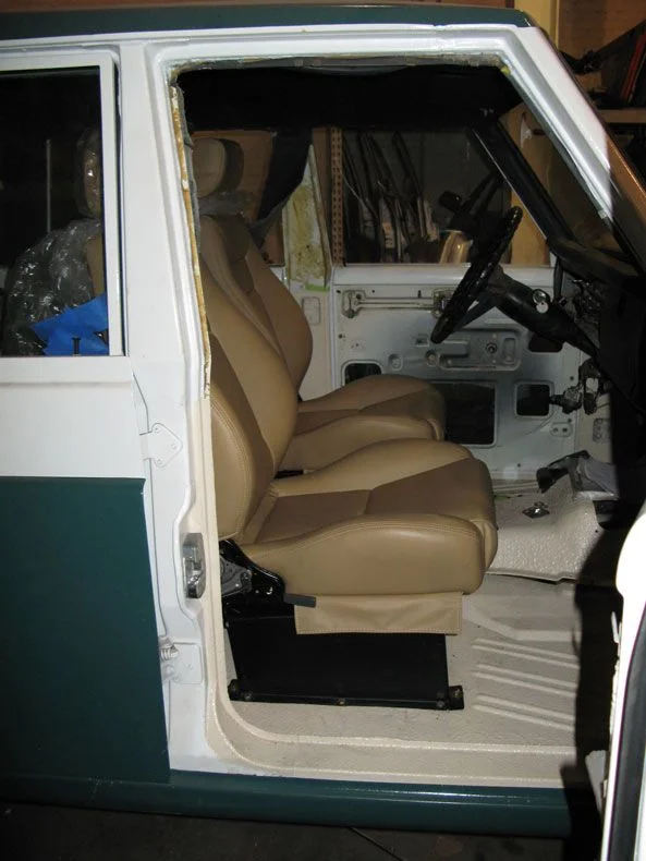

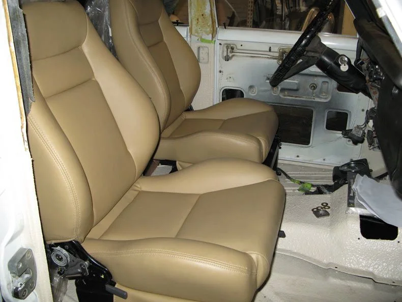

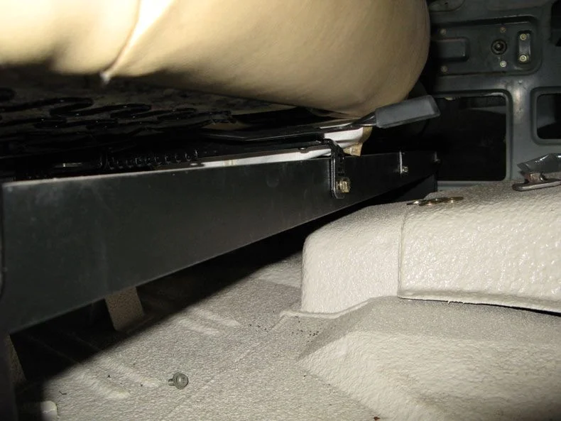

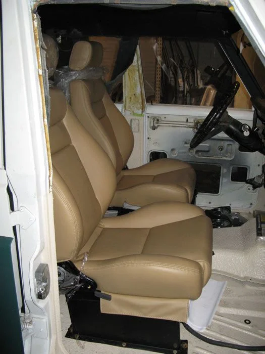

Procar Seats on IPOR bracket
Here's a few pic's of the front seat's mounted on the IPOR seat bracket.
Lou

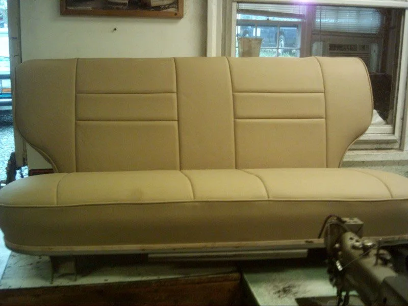

Front and Rear seat
Here's a few more pic's , I also attached the rear seat that I had recovered using matching vinyl. They did a great job matching the front seat pattern
Lou
