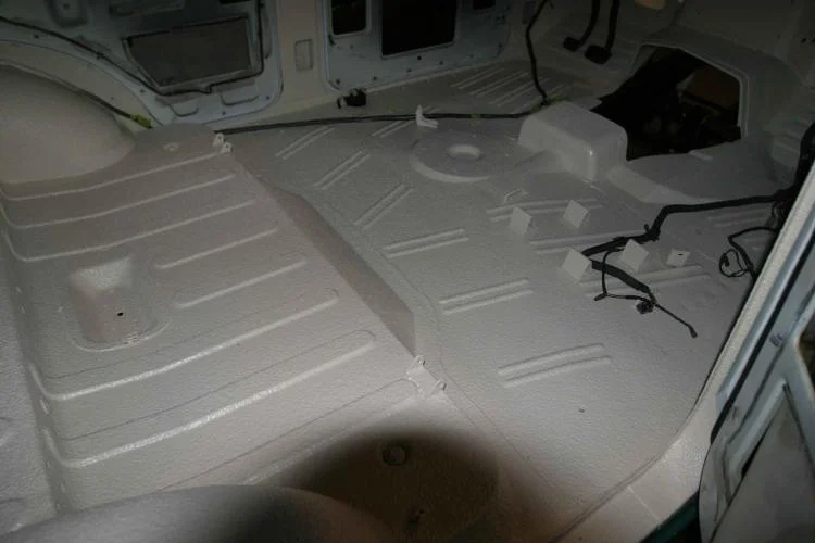

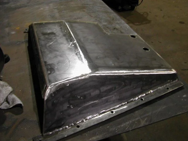

More Pic's
Here's the completed trans tunnel!

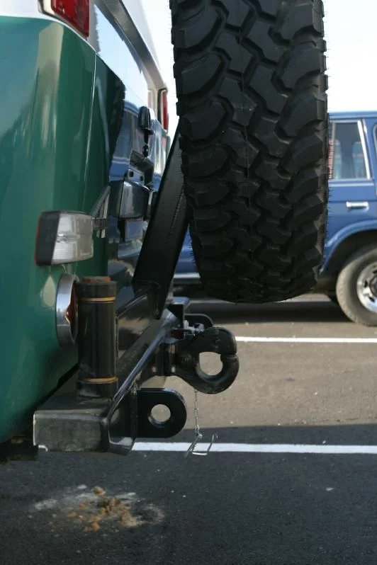

Pic's of the finish bumper
Got these pictures last night from IPOR. Lance was up late burning the midnight oil, working on my Christmas present.

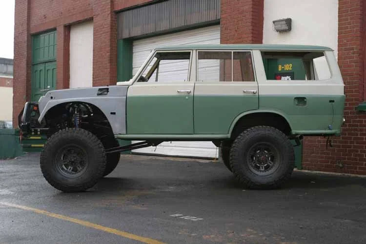

My day started off with a call from the painter that he had completed speed lining the Pig, so I drove down for a look see.. the color was horrible it came out pale yellow nothing at all like Cygnus White. The painter said he used the correct color code and then told me the Kevlar that is added as a hardening agent is tan in color and changed the color. So a warning , if you want to color match speed liner make sure you have a chance to test the color before its applied, they can add tint to correct the color, which he should have done. At this point I really do trust his ability to get it right so I told him to shoot it white. OH YEAH!!! ITS GOING TO COST MORE. But it will be one quiet Pig
Luke111 is offline   Reply With Quote

I worked out a reasonable deal with the speedliner shop, the plan is to shoot a light coat of adhesive as contact base then shoot the new speedliner. The plan is to use the cygnus paint code but increase the white tint so it should come out closer to cygnus. Should be completed this week , IPOR & COMPANY are ready with, new RAM JET & H55, Powersteering, Front Procar buckets, matching rear bench, tuffy box, Gen II vintage A/C. Custom front bumper & IPOR rear bumper with tire carrier. Dyna Pad on the floor and custom carpet. I'll keep ya posted
Lou

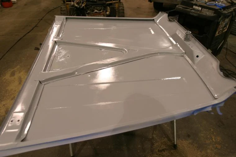

Speedliner Completed
The speedliner is completed and looking good. I had a chance to check it out this morning, the painter retinted the liner and its now Cygnus.

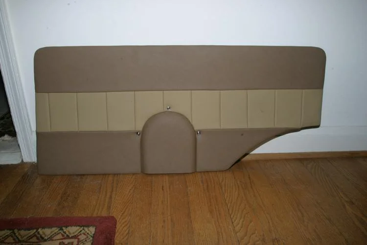

pi'c

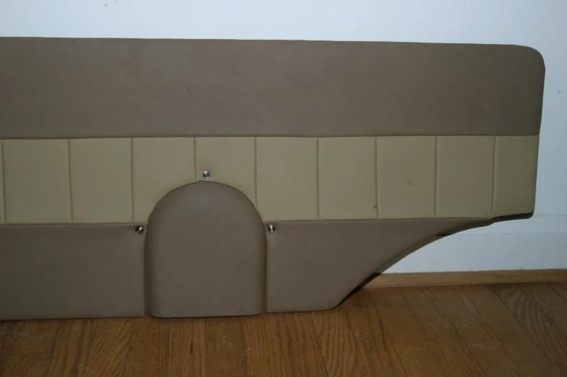

Here are the Rear Panels

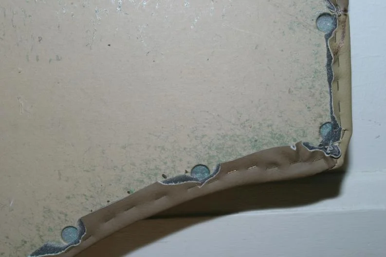

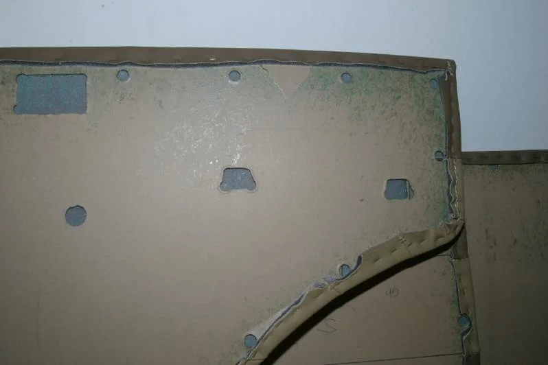

pics
And the backs, The retainer clips and plastic caps can be ordered from Toyota part#67771-20022 clips, #67772-20021 info I got thanks to Matt aka Buckroseau on his over the top LV45 build.

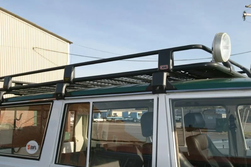

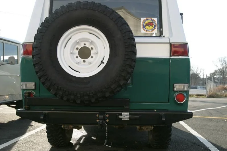

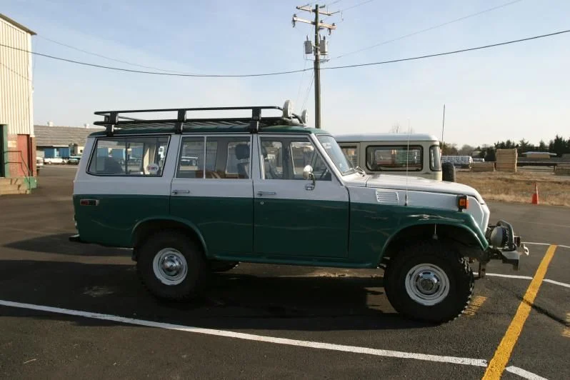

Thanks, Should be road ready in 4 to 5 weeks . Lance and his crew have two trucks to complete, Ryan Scott's 55 and another rig that's time sensitive, Everything is ready to go just waiting for front and rear bumper and skid plate to return from the powder coater and a lot of detail stuff, weather strip, Hannline three in one gauges and A/C. My only concern is rust so I might drop my headliner which I want to replace cus its gray, I have a white one i got from SOR and check the roof. If there's any rust on the ceiling I might remove the roof, Andre did his in a few hours and found all kinds of creature's crawling around. I'm planning a frame off resto in a year but if there's anything major in the roof I'd fix it now plus it would give Lance and crew a clean plate for a roll cage they could drop in. Ya'll are killing my piggy bank , I'm begging ,stop coming up with any more idea's. Lance said he would cut my internet cable if I forward any more Mud threads!! How about cutting my roof??
Lou

wow those panels are clean. Very cool!

Power Steering
Spent all day at Iron Pig Offroad, They are still getting the new shop set up, so I was able to work on the under side of my hood, I took it down to bare metal, two coats of acid primer, and two coats of primer which will get painted Cygnus next week. I ordered six rattle cans from Tower Paint, great source for rattle can mixed to your paint code,Ryan Scott turned me on to them. Here are a few pic's of the power steering that IPOR did using FJ60 box and a few or the hood afer primer. I should have pic's of the rear bumper tomorrow, they were down at the powder coat shop today to pickup my bumper and dropping of the front bumper and skid plate. Getting Close!!!!
Lou
