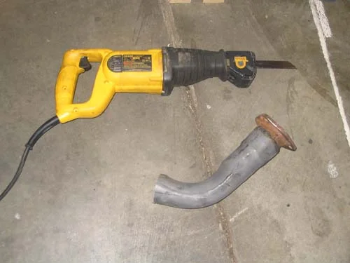

I made an appoinment at the exhaust shop but had a few things to finish up first. I installed the vavle cover, air filter assembly, slapped the hood back on, swapped front bumpers from the trail pig, and had to secure the exhaust under the rig until I got to the shop. This required cutting the last foot off in order to shove the exhaust up into the engine bay and hold it in place with the skid plate temporarily. That worked and got me to the muffler shop. Exhaust is now finished and it sounds pretty good.
The engine is running a bit rough and sounds like it is sucking a lot of air. I need to figure out which vacuum hoses to connect and which I will not need now that the carb has been 'desmogged'. I'm partially done with this...Valves and timing sound pretty good. I'll have to tinker with it a bit more.

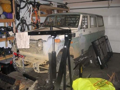

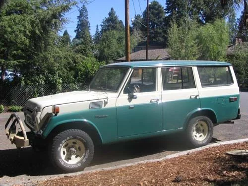

Pic of Lily basking in the afternoon sun after I just drove home from the exhust shop.
Oh what a feeling, Toyota!
And, a pic of Lucy, who has now officially become the new 'project'.

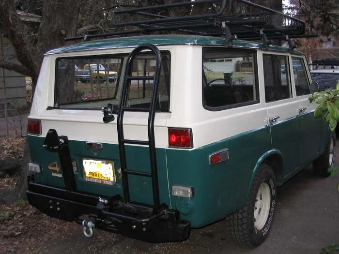

Old 08-18-07, 11:52 AM   #160
IH8MUD Addict
Lucy_FJ55's Avatar
Join Date: Sep 2002
Location: Bend, Oregon
TLCA# 10314
Posts: 836
Lou, you gotta get out more! Ha ha. ha.

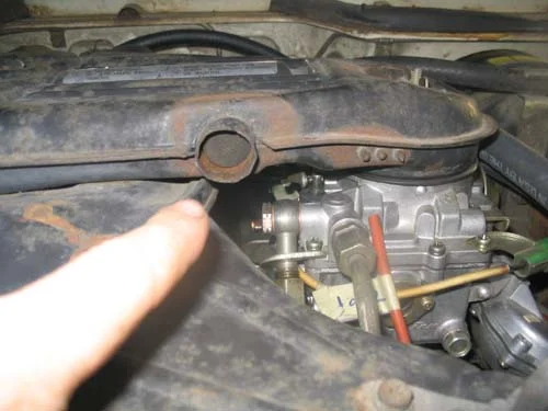

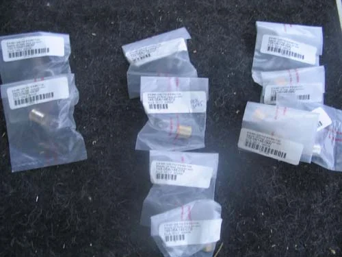

More updates:

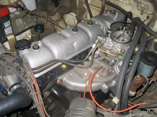

I have been 'fine tuning' my ride over the past week or so. I have been driving to work each day and each day I remember something else that needs attention. For now I'll stick to the engine. I am doing a complete desmog of this engine. The carb had been made 'bionic' (desmogged and built from the orig. '77 and an '83 carb for the best of both eras!) by Jim C. and the donor engine was also desmogged when I purchased it. It already had the air rail plugs as well as some exhaust/vacuum ports blocked. I am still figuring out what to leave connected and what to plug and what to remove and...
First pic: Just a shot of the engine with some extra vacuum hoses still left.
Second pic: I had to plug this hole in the intake manifold and I bought this brass plug for it.
Third pic: Plugged.

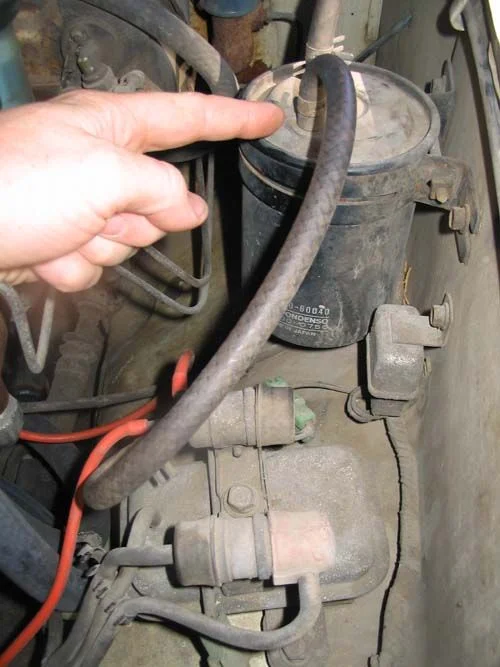

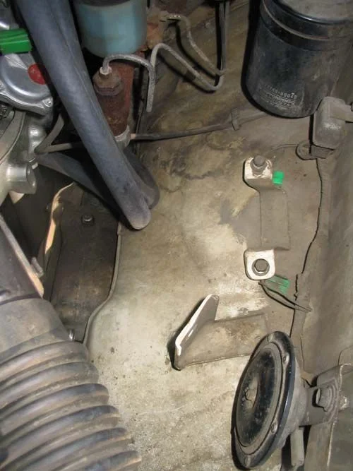

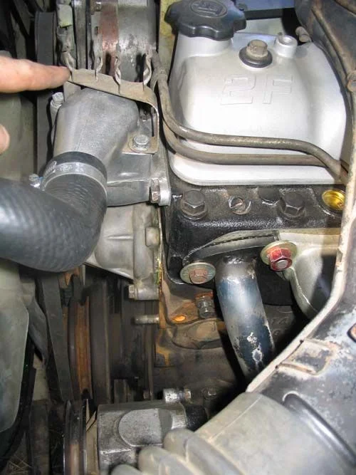

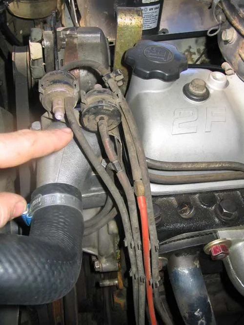

Here are a couple pics of the PO desmog attempts. Unfortunately he decided to crimp/ weld or shove crap in/plug the orig. air cleaner, I had hoped to use some rubber caps I have seen others use. I decided to stay with this air cleaner and valve cover as per Jim C's advise (lower profile, etc.). We'll see, I may just leave it as is, it seems to work. The last pic is of some other caps I found to plug some vacuum ports. These work great.

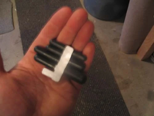

I have to plug one of the holes on the dist. cap, which I did with one of those handy rubber vacuum caps. The other is connected to the base of the carb with vacuum hose. The last should be left open to air/vent. I picked up some goodies (sm. filter, brass barb fitting, sm. clamp, vacuum hose) from NAPA and will be attaching this to the opening on the dist. cap and finding a place in the engine compartment to attach and then vent/pull clean air. I'll post a pic when I finish.
I got this idea from Guyute on the Cascade Cruiser forum.
I also need to re-tourque the head bolts and other items here and there. I still need to toss the flywheel cover on. Should re-adjust the valves again. I also need to address my taillight/blinker issues. Then perhaps upgrade the brakes, suspension, and steering, and, and, and.

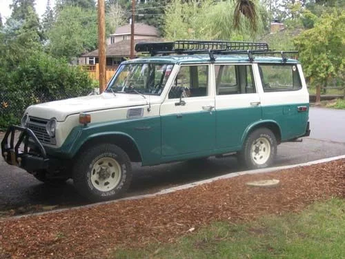

Tossed the rack back on the roof. Figured I should share a pic, just cuz.

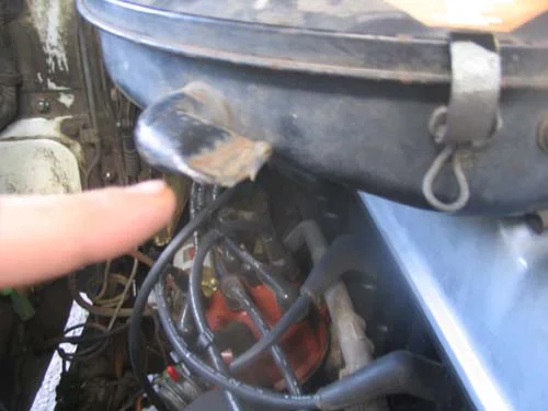

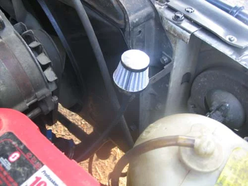

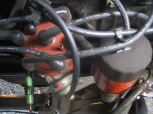

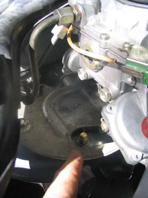

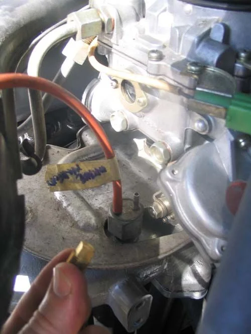

Just a quick follow up.

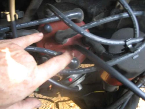

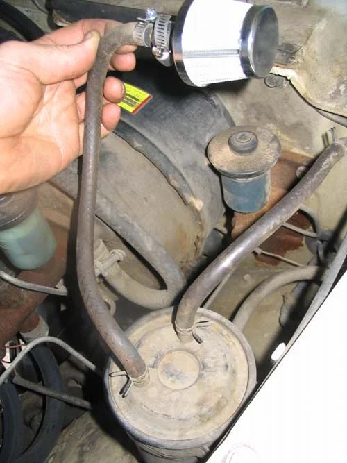

I still have not figured out exactly what to disconnect and what to leave under the hood for the desmog. I finall sent Jim C. a note to ask for help. If anyone else has any advice let me know. I have posted what has been done up to this point earlier in the thread. I am basically still confused on some of the vac. lines and whether or not I need to remove some sorta 'emissions computer' and where is it? The truck runs OK but is sluggish. I know I have some vac/exhaust issues still to figure out. Anybody else do a desmog? Any ideas on the vac lines and such?
I thought I would also post up pics of the latest in the desmog/engine work.
Pic 1- My pinky is pointing to the opening in the dist. I capped and my other finger is pointing to the vac line/air I vented through a filter...
Pic 2- I stretched the vac line from the dist. to a clip I mounted to the radiator and connected it to a small air filter. I saw this idea from fellow mudder Guyute's desmog write-up. Seems to work and is slick.

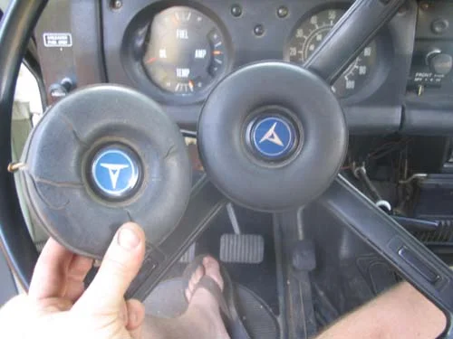

I swapped out some bulbs with new ones to see if that would help the situation-no dice. I also ckecked fuses-everything looks good. Do these 'ol pigs have light relays? If so, where?
Pics of my new stash of replacement bulbs (for both piggies)...
...and check out the newish-looking horn button I scored off Ebay. It really sets off the interior, one of the last final missing interior links.

I found some details about a bunch of the smog-related stuff on the driver's side of the engine bay. My freakin' Haynes manual ended up being the most help-strange. It had specific details for my rig's emissions as well as good diagrams, info/explanations, pictures, etc. about each part. Glad I found that.
I ended up removing the Vacuum Surge Tank and both VSV's (they were mounted to the top of the Vacuum Surge Tank) as well as all the vac hoses that were connected to them. I also removed the VCV's that were mounted on top of the thermo. housing. This left me with a few more vac ports to plug. I used some small rubber/plastic vac plugs to cap off the diaphram on the carb, the BVSV connected to the thermo. housing, and then I set up another mini-filter to the charcoal canister.
I then took it for a spin and it did seem a bit better. I think I have other issues I need to decipher now, but that is another post.
Please post up advice/ideas still if you have any. Suggestions always welcome.
Pic 1- Here is the Vacuum Surge Tank, VSV's (bottom of pic) assorted vac lines, and I am pointing to the end of the charcoal canister I vented.
Pic 2- Pointing to the VCV's I wound up removing.

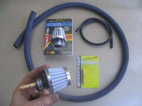

Pic 1- Removed...but I left the bracket on for now.
Pic 2- Removed...looks like a good spot for my compressor, hmmm.
Pic 3- Mini-filter bling, just because.
