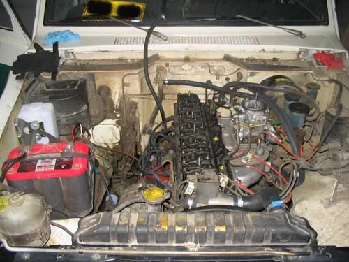

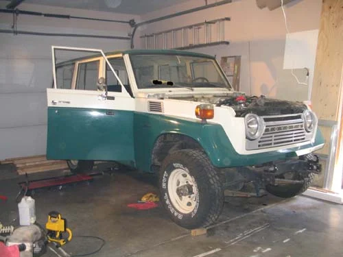

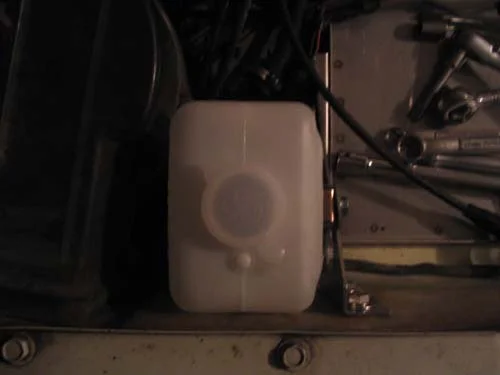

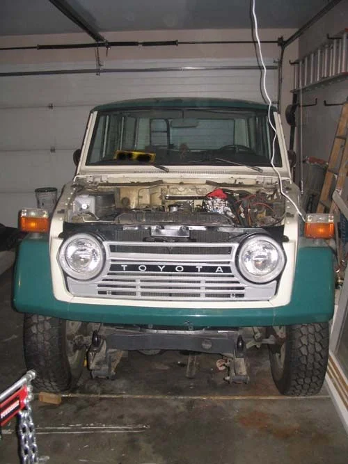

I thought I would post an updated pic of the front end of the cruiser. As mentioned earlier, I have buttoned it all up-just need to adjust the valves, timing, and deal with the tranny, and, and, and.

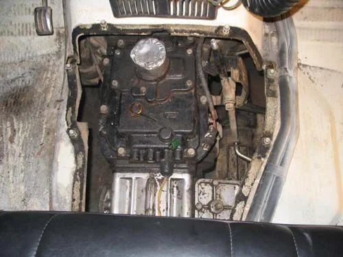

Speaking of tranny-I received the 'detent spring and ball' I misplaced when I removed the tranny top plate during the engine install. I should be able to button that up soon.

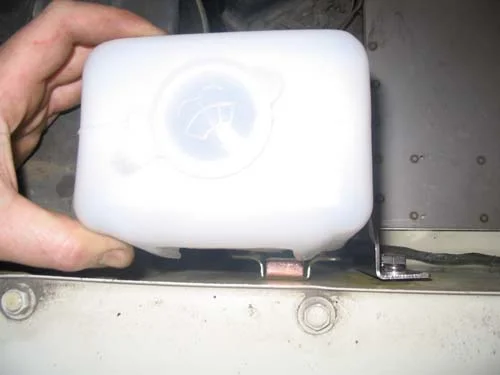

I also posted a pic of the windshield washer fluid res. setup. I was able to use the original location by simply rotating the assembly and jerry-riggin'/attaching it to the battery tray. Now I have the room I need and I can tap into the original harness/wiring setup.

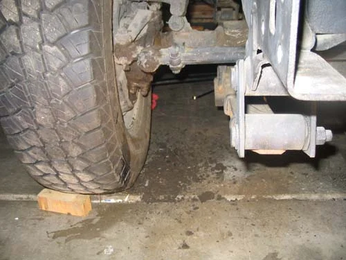

Took a couple hours to scrape mud and crap off all the front and rear axle and suspension components. Filled up the radiator with coolant and fixed a leak or two. Temporarily spliced a couple wires my buddy instructed me to connect before I tried to start the rig. I loosened the valves a bunch and then finger-tightened them. I tossed a battery in and then thought about all the connections and engine components and systems before I put the key in the ignition-and tried starting her up! After I calmed my nerves I gave the old gal a try. The gear reduction starter spun the engine like a champ and she had wanted to come alive but I have no fuel getting to the carb yet. I cranked it over a few times, a little longer each time. I swapped in a new fuel filter and cranked the engine a bunch more, trying to get fuel through the lines to no avail. I did not see any oil coming from the rocker arms which made me even more nervous. She popped and coughed but never really ran. I did however notice that I have a serious exhaust leak at the header. Stupid shat has given me more trouble than anything else on this project. I ran out of time and energy this weekend and may not be able to work out the bugs anytime soon...:( OINK!

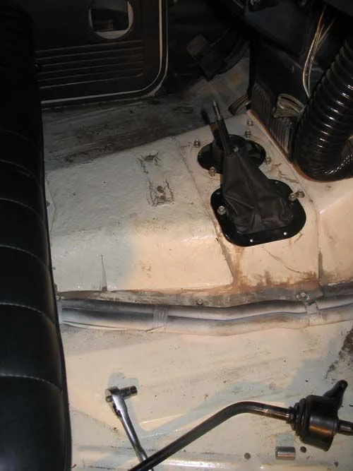

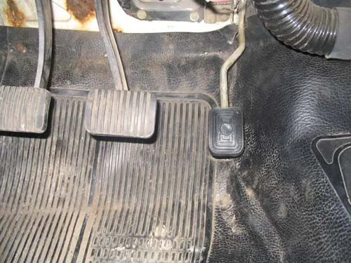

I finally got the tranny lever to seat properly. The two pins that help hold it in place are kinda loose. One is real bad the other not so bad. Aren't those pins supposed to be soild/not move? That allowed me to finally toss the floormats and stuff back in the truck to finish up the interior. Minor accomplishment but it sure feels good after all this time.
I also found the rubber gas pedal pad I bought about two years ago for this rig in the glove box. So I tossed it in a small pot of water and brought it almost to a boil. The wife loved that. This allowed me to be able to stretch it over the gas pedal-looks good.

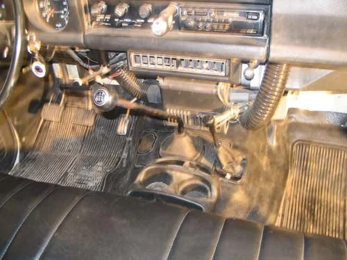

Carlos, looking good; can you tell more about the cup holder /console in the front? never seen one like that before in my very limited pig experience
Lou
n2666s is offline   Reply With Quote
Old 07-16-07, 10:59 PM   #137 (permalink)
Site Addict
Lucy_FJ55's Avatar
Join Date: Sep 2002
Location: Bend, Oregon
TLCA# 10314
Posts: 1,047
Quote:
Lou
Oh, that 'ol thing. I found that at Fred Meyers'. It's plastic and cost about $6. It fits a bit tight. You can probably find something similar at an auto supply/parts store near you.
