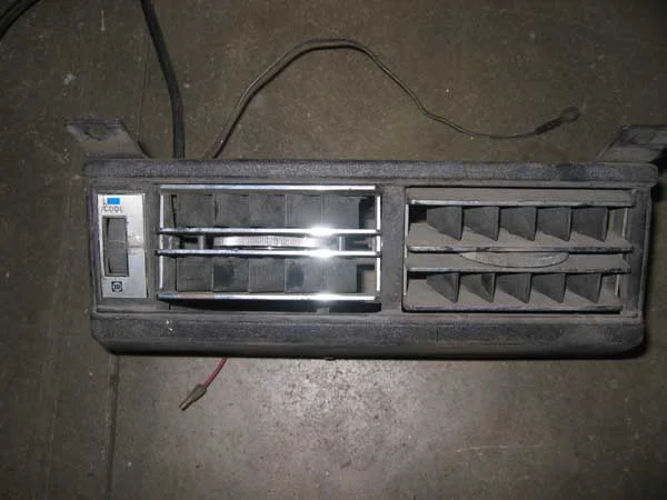

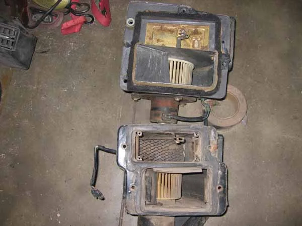

the vent assy, and the old pig blower next to the new one

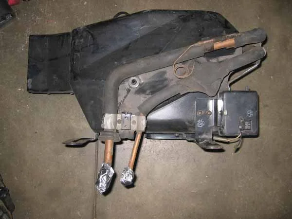

the box (evap )

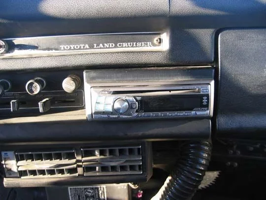

you can kinda see the the vent installed

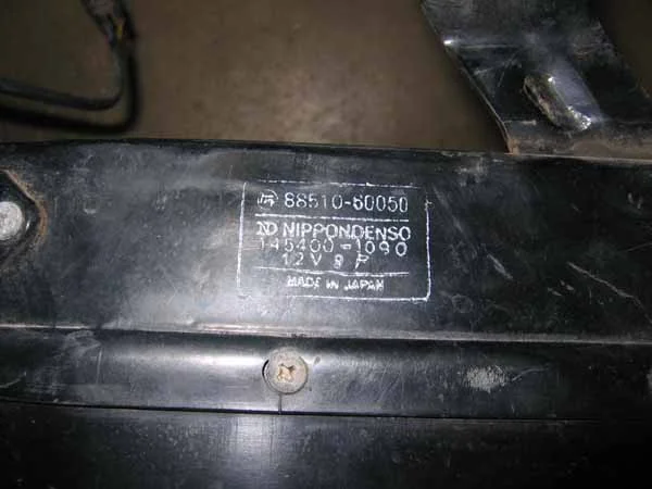

part # on the evap case

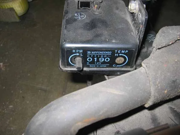

ac controll
