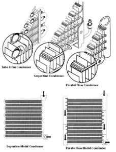

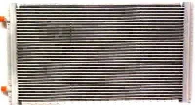

Condensers in any size you need .http://www.ackits.com/index.cfm?fuseaction=Parallel
