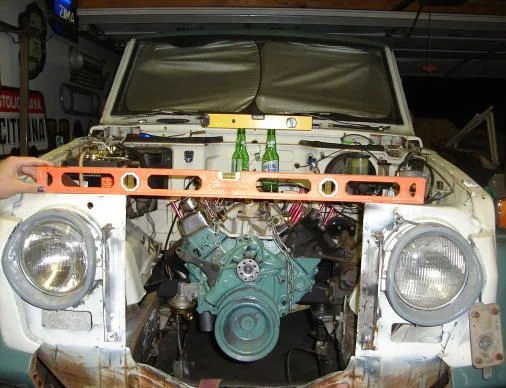

well, we winged it and it's in...just tacked for now. got to set axles and tack and pull it all out and weld everything in solid...started the morning stripping everything off and grinding the old motor mounts down...ended the day checking it all on a level.

Heh heh, at first I thought your level was the Rolling Rock!
The Piggy is looking REAL good!!!

the only way to get the level above all the crap where we could set it level on the engine was "risers" we enjoyed a few of these yesterday

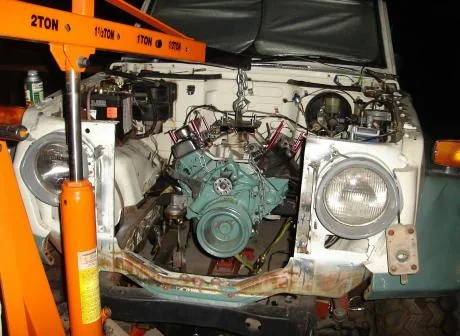

Posts: 9,325

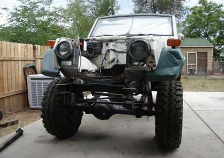

i'm actually surprised, but it appears that i may be able to use the stock rear shaft, only the front shaft needs work, but i'm soa, so the lift may affect everything.
here's a few pics. you can see in one pic where i will clearance the firewall and relocate the e brake cable. other than that, there's really a lot of room

i'm manual steering for a while. these pics show just how close i am to the steering box to get it away from the firewall
motor/tranny are mounted nice and high though...nice change from my 40 where we put them low to keep cog down, which turned out to be a wheeling mistake, but great on road.
