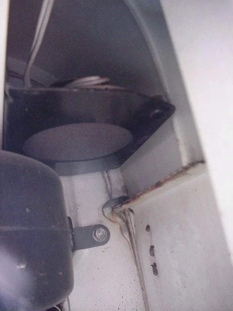

Who knows how the radio is wired up on a pig. I've got the radio it is very basic. really only one power wire and and two speaker wires.
Question where on the wiring loom does it pug in for power and where was the original Am radios speaker located?

Quote:
On my 40, there is a speaker (looks orig) under the dash...
Any pics?
Give me a minute...
Any pics?
Here you go:
