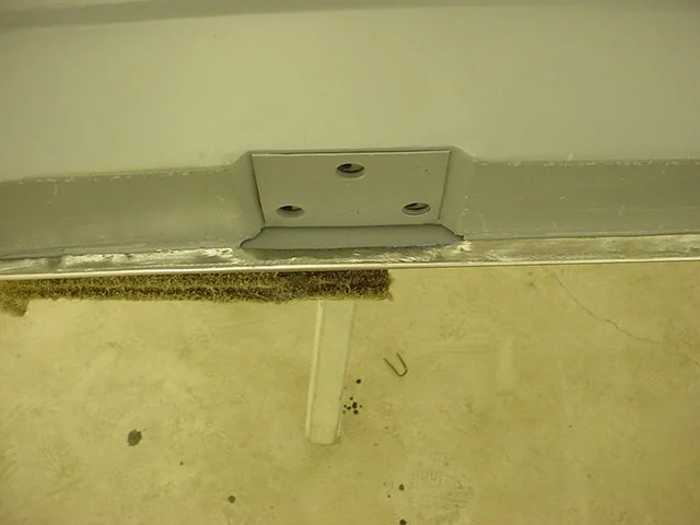

Here are some quick pics. My battery is needing charge so pics are a little rough. If you need more let me know.

Couple more....

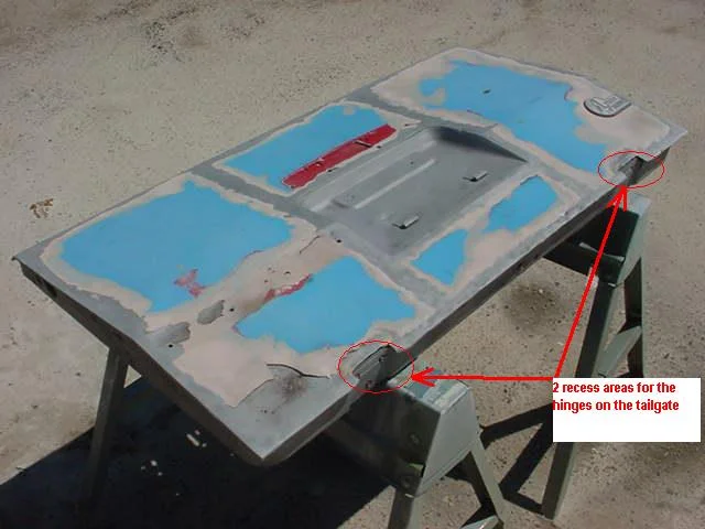

The arrows I have is kinda the area I am interested in. From the pic it looks as though they cut the skin for the hinge and just left that area open between the tailgate and the skin itself.
If anyone else has got more of this area, please post.

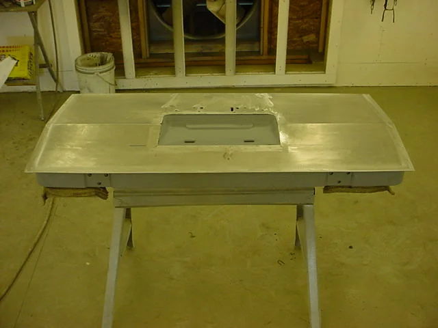

Went home for lunch and took a couple pics.
Just wanted to confirm to everybody what I'm trying to do. I got my tailgate skinned now so I have to cut that area out.
Matt

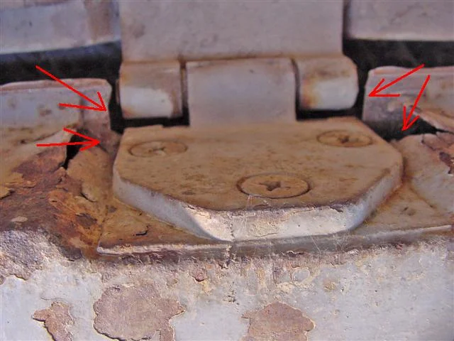

Heres a couple more...
Let me know if these help.

Yes they help, thanks! Pretty much confirms what I saw in Ground up's pics. Looks to me like they folded the edges over around the recess, but it is left open in that area. They don't fasten that portion of the skin to the tailgate.
I think I can handle that tonight
