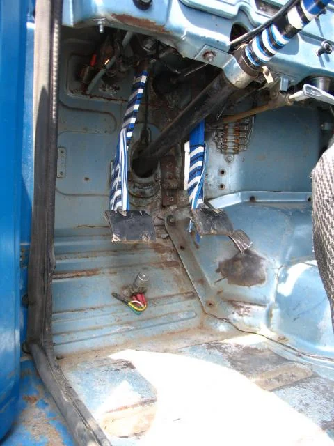

I crashed my Chevy on the way home the day I bought it. Brakes went out, no parking brake....whoops!
Now I tow them home and never expect to drive them until I can at least go though the important parts.
This may have been your first clue....tassels on the pedals are the coolest
