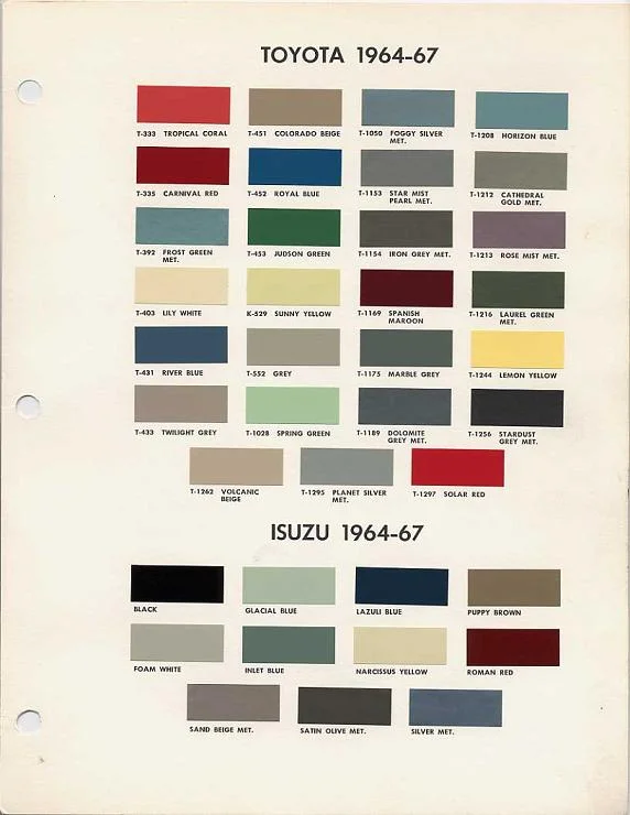

Just like the title says, wondering if anyone knows the paint code for the upper white on US imported LV's.
Looking at Mike's site, looks like the upper white color was the same on all 4 models?
http://www.root45.com/exterior.html
Before I re-assemble the roof on my LV I wanted to shoot a coat of single stage urethane in that area for even more rust protection. I guess I would like the correct color so if a person was to pull that upper rear cover to access the upper hinges you would see the same color as the interior. Just trying to do it right?
Any help, anyone know?
Edit: If this link works
http://autocolorlibrary.com/cgi-bin/...oyota-pg01.jpg
It is supposedly the colors offered from 64 to 67 for Toyota. The only color on there is T-403 / Lily white. Is this the correct white? If the link doesn't work, goto www.autocolorlibrary.com click on asian then Toyota, then 1965, should bring you to the colors offered.
Thanks, Matt

Matt I double checked and that is all I found as well. Landpimp might be the only one who could trump it.

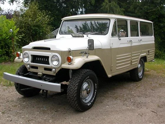

my 45LV is GM colors.
the roof on a stock LV should be the same color as the lower color on the body. So if red lower......the roof is red, if green lower, the roof is green ect ect

The entire inside of you LV is white, right? The area I need to paint right now is the drip edge on the inside. In reality it will never be seen, except for that area in the rear from the inside and only if you removed the hinge cover, but this would be considered the inside I believe.
Looking at autocolorlibrary the colors offered, specificly the Lily white, doesn't look like yours? Is it your opinion that the Lily white on this chart is the stock white?? I would imagine you would know better than me?
Thanks for the help, Matt

yeah mine is all white inside.........but thats not really correct. I think gray-ish was used for most of the interior, like the rear panels and such.
If it were me(and its a 64), I would use my old 64 45LV as a possible guide, the interior paint(rear and dash) is original(for sure)
I would also look at the Spring Green(not Seafoam Mike 45 that Vintage had, that puppy is very orignal I believe.
and it also depends on the year....and the mood the boys at Gifu were in the day they painted em

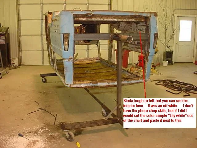

Odd and confusing to say the least? If I was to make a guess, I think the entire interior of my 65 was possibly Lily white. I believe orginally mine was a red and white lv, red has shown up all over the place when I was taking it apart.
I attached a photo of mine. I think you can see the color on the interior. If I had the photo shop skills I would cut out just the sample of Lily white on the paint chart and paste it next to the interior of my vehicle. It looks very much like the same color?
I guess I was planning on painting the entire interior the same white as the exterior and then the roof and lower color would wrap in and end at the pinch weld in the door jams, where the door weatherstripping attaches. I've seen a few pics of TLC's restos and that looks like what there doing. TLC's lv's all have that off white look, wondering if there using Lily white or something else?
Doesn't have to be stock, just would like that color to be the same white since I'm spraying it anyway, might as well be correct and the same color white inside there.
Wife hasn't told me what color anyway yet I don't need to know the lower half and roof color yet, but she said she was leaning towards grey. I'm thinking the T-552 grey on that chart above.

sure yours isn't a 64 fj45LV? thought 65 had the rear reflectors under the brake/turn/parking lights
I really have a feeling there was no real set way they were painted.....or when they were built
my old 64 was orignaly Spring Green/white, the interior(dash, doors, rear panels, upper metal by headlinner ect, all but the floor) apears to have always been gray(which would have matched the original door panels).....no trace of any other color(besides gray and red primer) underneath.

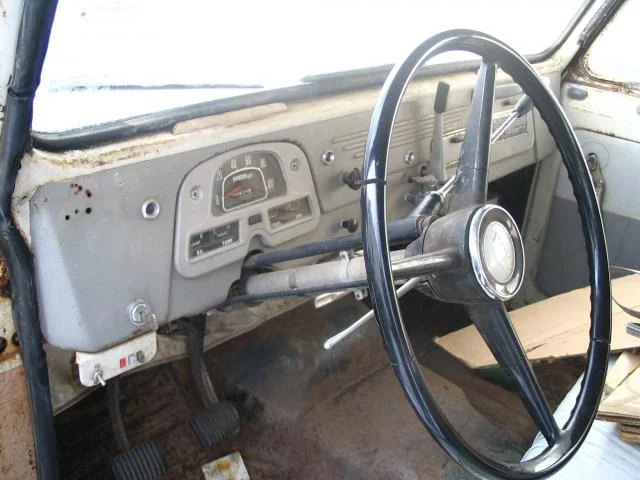

The interior is a two tone grey just like the fabric on the back of the front seats. I would post pics but the wasps are still swarming in the LVs. I have seen different colors on the floor of the LV. It was either black or one of the grey colors.
Another question I though of was the bezel. Do you think it is the same white?
The FJ55 mentions artic white? or olympus white? on their two tones (exterior color). I was thinking that might be correct for the LV as well.

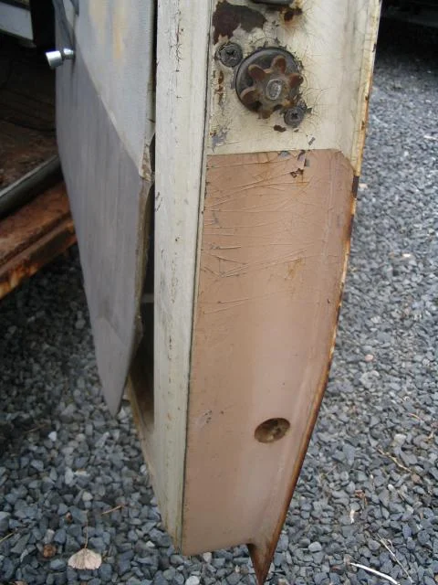

Here are two pics from the Hantavirus II. I can take better ones when I get home if needed. The dash is the darker grey with the areas around it the lighter grey. It almost looks green to me. The pics of the Spring Green 45 shows the interior with the green/grey but the inside of the doors look like the exterior color. I don't think that is correct. If you look at the 2nd pic of the doors, the exterior white color is different than the interior.
