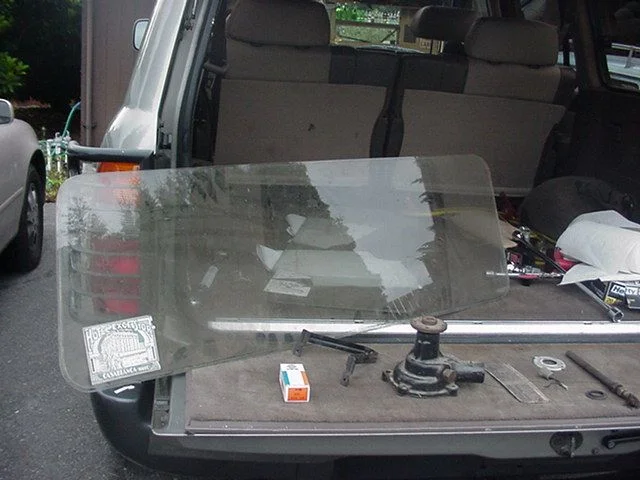

Look what the cat drug in

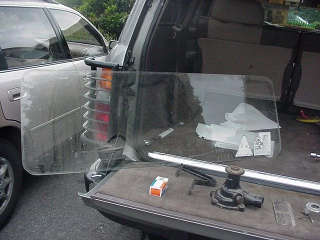

Talked to Jason *the guy who sold me the LV* the other day and he said that he found some stuff.
Tonight I went over there and picked these up.

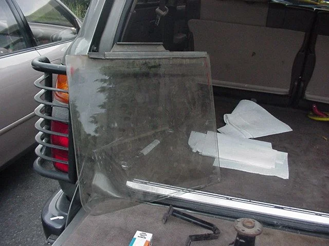

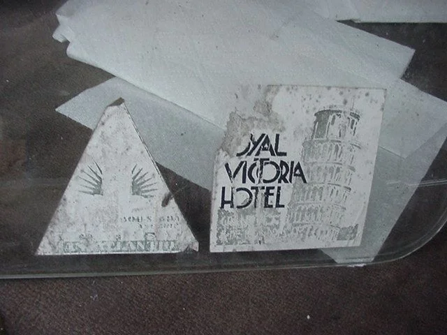

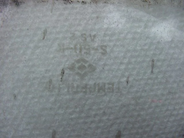

Here are some more... these are the rear windows... they all have the symbol from the first picture on them.

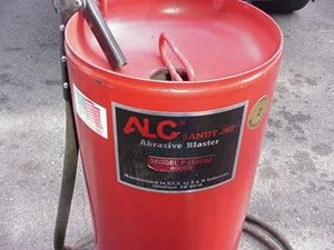

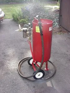

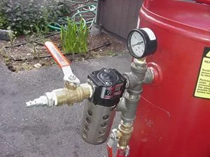

Here is a picture of one of these tools that I got today... the sandblaster... a 125 lb blaster.. used only 1 or 2 times.
I don't know what the thing is between the air fitting and the tank?

Quote:
Water trap - Shoud be a little flexable rubber nipple on the bottom. When it is hooked up to the compressor, just flex it sideways to open the valve. If it has any water in it, it will spray out.
Good that it is on there. I'm sure it didn't come with the blaster, whoever owned it probably put it on there. If your in a high humidty climate your compressor can pull moisture out of the air and gum up the sand. Silica sand and water don't work well together.
You can also use that on your compressor also for painting, good idea to have one on the compressor anyway. Moisture is tough on all air tools. That type usually costs around $50.

Not a bad idea to put a motorguard filter on after that trap. Makes a huge difference when running a plasma cutter, so I'd imagine just as much with a blaster.

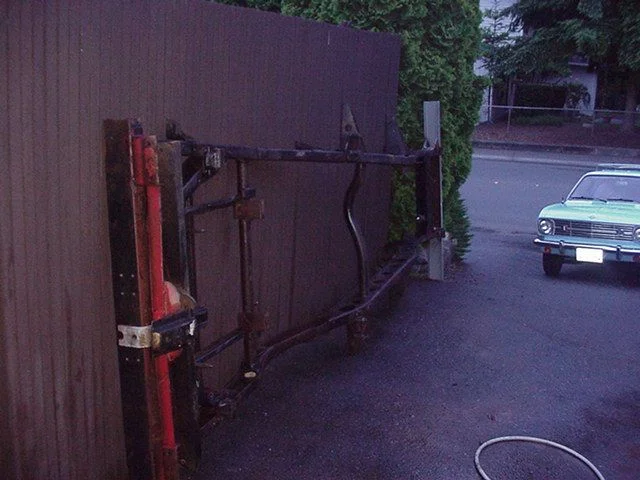

A cry for help from LV owners!

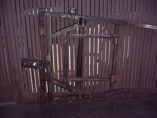

Tonight I got to work on the LV a bit... going to get the 220 plumed and the air compresser installed soon... sandblaster is ready to roll once it is... so I pulled out the frame and cleaned it up a bit... WOW... LOOK AT THAT TAR! I have 1/2 inch of tar under certain parts of the frame... Im thinking a heat gun with a puddy knife will get most of it... It will take a lot of sand to get it off otherwise. What were they thinking!
LV owners... can you pick this frame apart? I know the rear hitch is bogus... and the muffler metal has been previously cut off... the front bumper is not stock... Can you guys pick it apart?
thanks

Make sure you understand silica sand and silicosis before you start sand blasting.
I'll have to get back to you on the frame. I have a few '64s but I don't remember the rails on the sides of the tank. I'll have to look.

Let me know what you think may or may not be stock on the frame and I'll check when I get home.

MikeCO,
the front bumper doesnt look stock, the back bumper... ouch... dont know what belongs/doesnt... know the hitch needs to go... thats about it... if you have any pictures of frames... expecially the front and rear ends... that would be helpful.... I know you have one or two

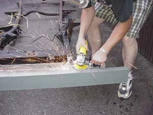

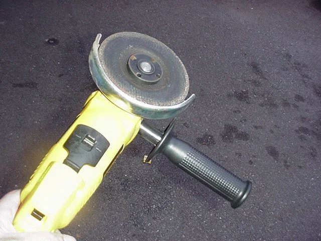

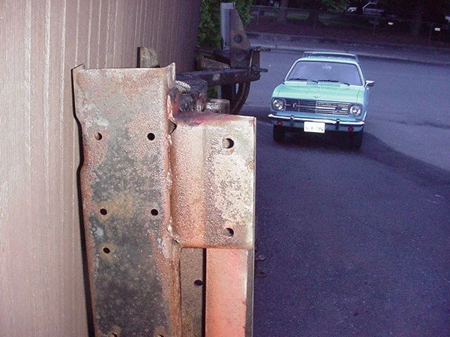

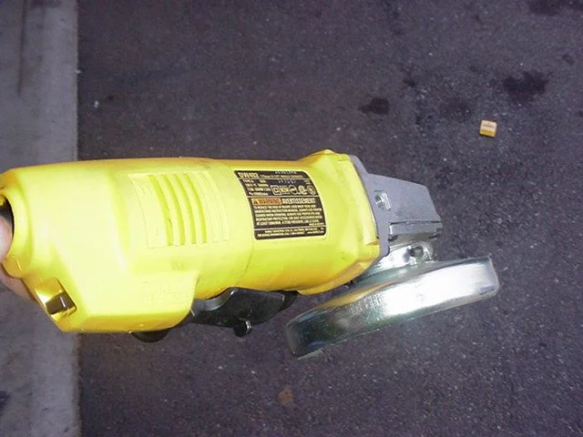

Went to Lowes today to pick up some Lime for my 1/2 acre lot of grass... and picked up a toy when I was there.
Dewalt 4 1/2" Grinder with 3 Metal cutting bits and a few other accessories.
Spent about 15 minutes, got the front welded bumper out and the bumper members ground down... first grinding experience and it came out great.
