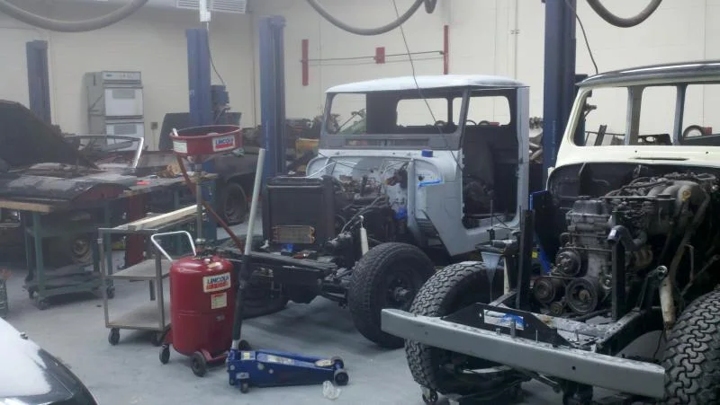

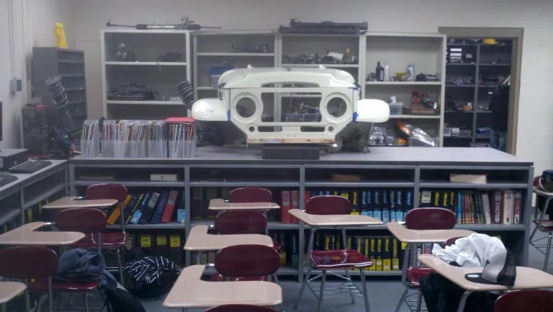

What an auto classroom ought to look like.

Shouldn't the kids be facing the altar ?!

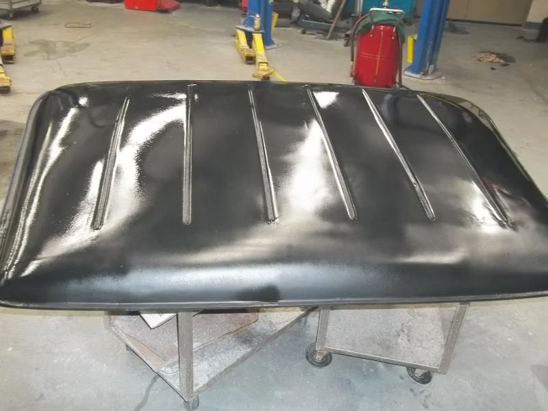

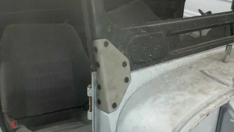

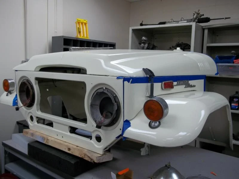

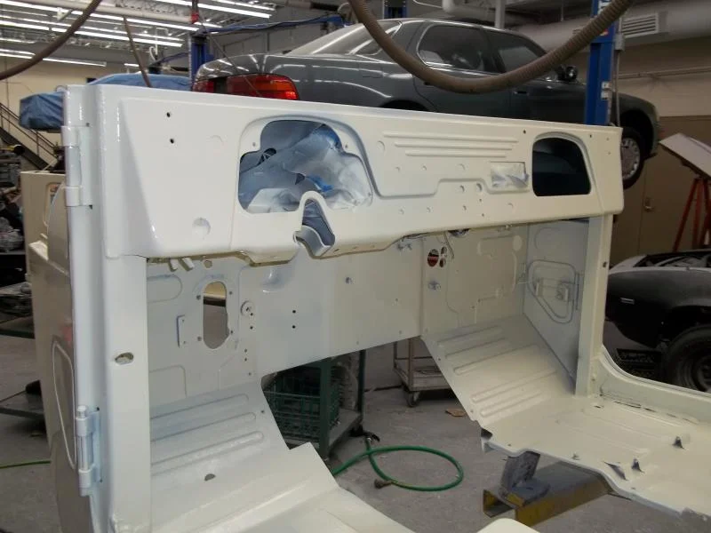

Wasn't feeling the body work today so I told myself I'd do something I'd been dreading and then be done with it for the day. I went to the hardware store, bought some new, good quality drill bits and drilled out the broken bolts in the cowl and roof panel. All but two of the 16 w/s bracket bolts had had the heads drilled off and 12 of the roof panel bolts were snapped off.
It really went a lot better than I thought it might. Two of the captured nuts in the cowl spun and had to be broken out of the cowl and three of the roof panel bolts needed to have the spot welds drilled out of the captured nuts. Everything else got drilled and tapped.
Then I sandblasted and installed the w/s brackets and installed the roof. It'll all come back apart to finish, but it all lines up.

Funny, I have a bezel hanging in my classroom. It is lost on most kids though...
Where do you teach?

Outside Chicago. I had a 55 grill hanging for a couple of years.

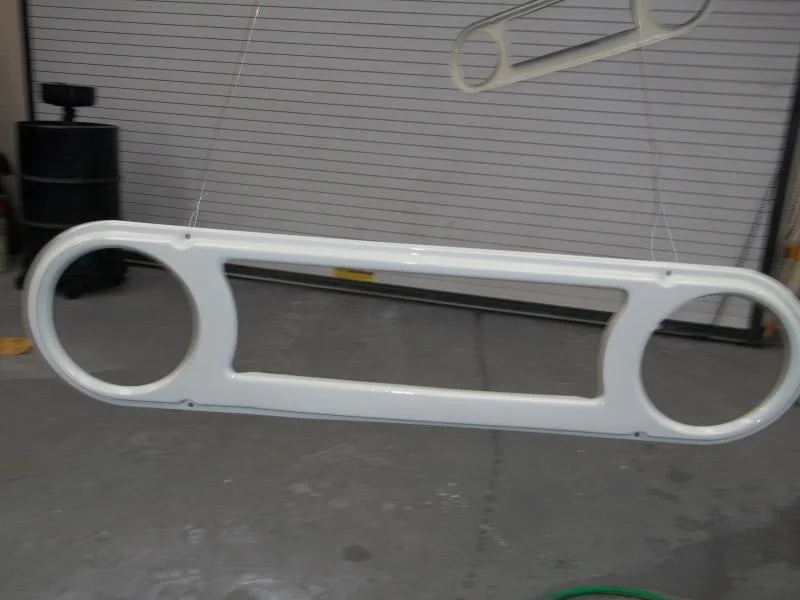

Got both bezels down to bare metal and hit them with K38.
Took the w/s brackets back off and sprayed them with primer.

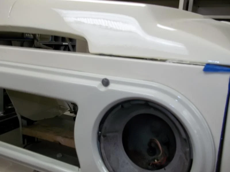

Hit the roof panel with a couple of little spots of filler, 3 coats of high build, blocked it down and hit it with three more coats of high build. It's just not going to get perfect. I have to find a place where it's good enough. I was hoping to shoot all the Cygnus White today, but it's not going to happen.

Looks great!
Very interested to see the Lilly white and the Cygnus white next to each other.

This one isn't lily white, but it does have a cygnus white cap and bezel.

Quote:
on my monitor, bezel looks to be too white to be cygnus.
looking forward to your pics of the lily and cygnus together on yours.

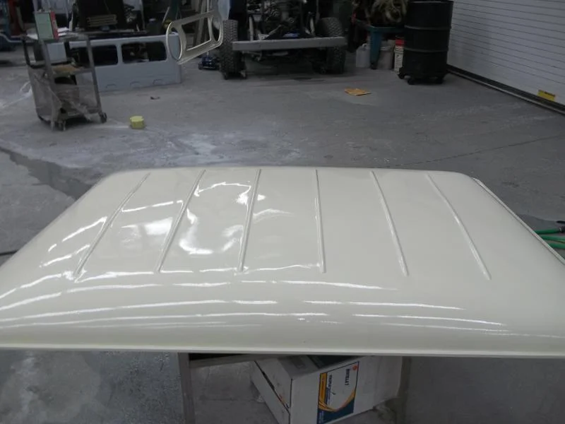

Not today. The gun was uncoorperative and dripped on the roof panel as I was sealing it so I have to wait until tomorrow to sand it down and spray color.
I did block down the roof panel again, and the bezels and the cab back. I also started blocking the tub. I Got the rest of the stuff off of the dash. There's some small holes to fill.
I also worked on the trans tunnel for a while and mounted the turn signals on the fenders.

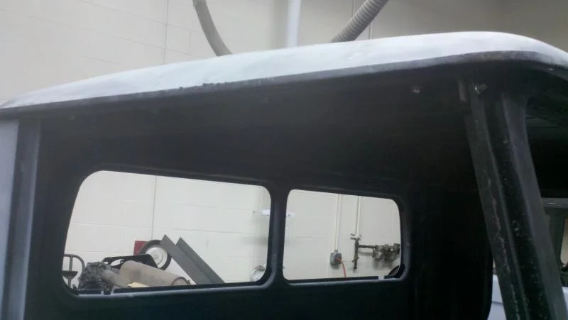

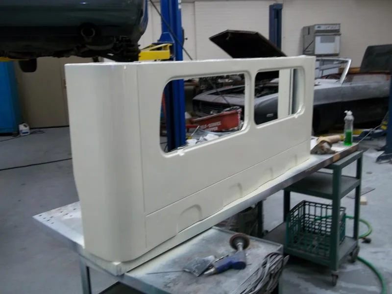

Okay. I lied.
It was too boring sitting around the house so I went back to the shop, sanded the top and shot the cygnus white.
Can't put it together with Lily until tomorrow when it's dry.
The cap is nowhere near straight, but it's the best it's gonna get.

Great job on the body work.Paint looks awesome.

looks nice! And it looks straight to me.
are you painting 2 bezels?

I'm building two trucks.

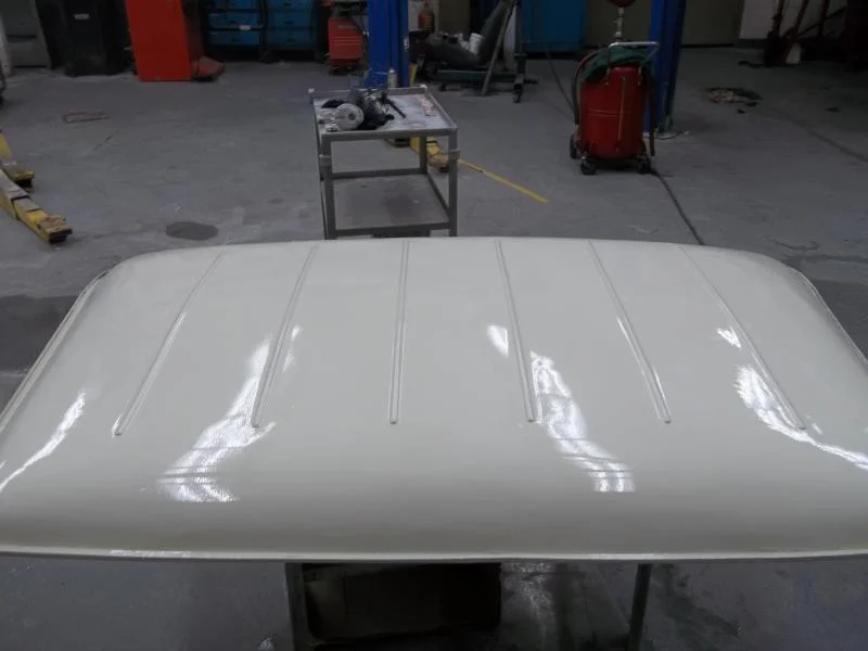

Glad I went in today. The bezels both had light spots. This paint covers really well, but hanging them was a mistake.
I put the better one on both bibs to get pics of the colors. Cygnus is not nearly as white as I remembered.
I mixed up a 6 oz. cup and hit them again before I left.
I also flipped the roof cap to get the underside that won't get covered in sound insulation and headliner.

thx for showing that. On my monitor the Cygnus looks a little more on the grey side vs the lily. Is that How it looks to you?

Yep. Grayer.

Whew. Needed way more blocking than I thought.
Stripped the doors down while I was waiting for stuff to dry. One door is down to bare sheet metal and the other down to the factory primer.
Ran the trans cooler lines too.

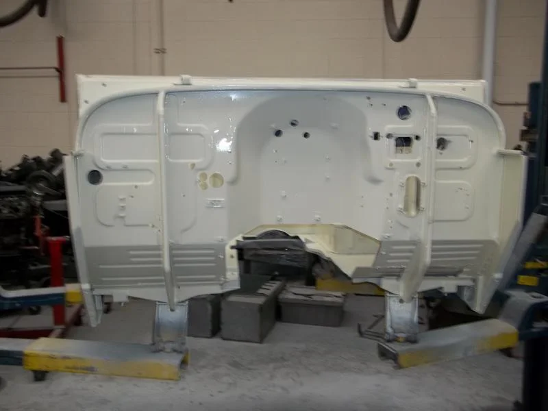

Another long day. Lots of progress. No pics. I brought the camera, but forgot the SD card.
Got the cab and the back panel in color. Looks good in white.
