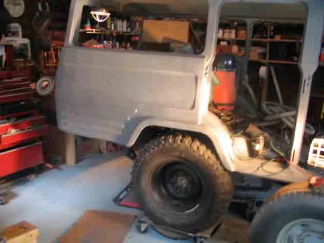

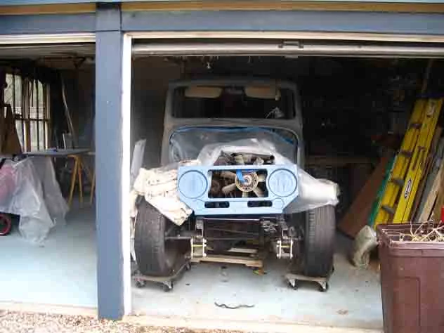

got some time in on wilma finally... back from a long vacation and now i need some quality cruiser time. was mostly workin on the rear quarter panels stuff. got the new metal welded in and ground down then leveled it all with kitty hair. must have done 30 different coats and sanded it down then did another 5 coats or so of sandable primer and snaded it down and last shot a coat of epoxy primer..
again my pics aren't great but you get the idea.
Jason

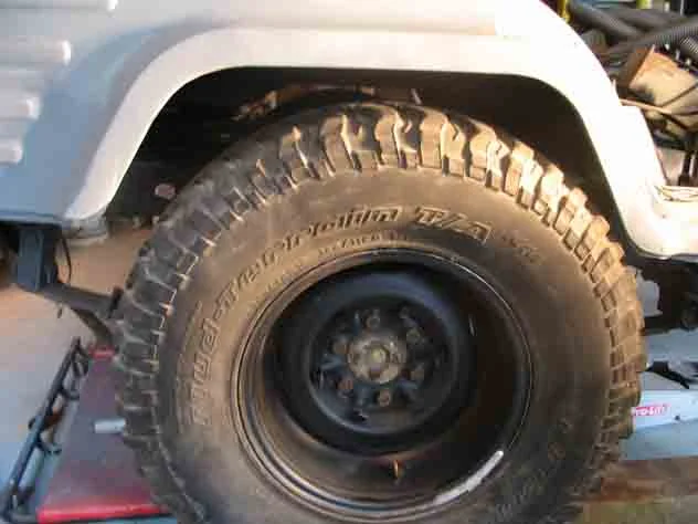

ok here are some side shots but i saved them for this post in that i also decide d to stick one of my 285 r16 tire wheel combo's on. these wheels are 16x8 widen wheels with hubcap clip centers. i geuss i should have put the hub cap on for the pics. anyway a) you can see my new rear quarter. but b) you see the tire wheel.
here is my question though. as you see the tire barely clears the front fender. but right now the body is on 2x4's the body is about 3 1/2 inches above the frame. for those of you running 33" or larger tires, How much lift do you have to clear the fenders? i will run my 31"s at first when it first gets ont he road but my plan is to run 33" or 34" nothing bigger. oh the tires stick out about an inch so....
thanks

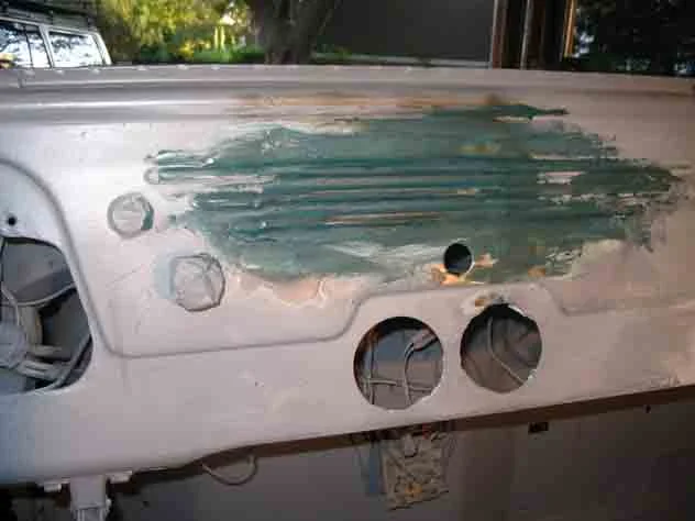

Ok its been awhile since I have updated the thread. not much really to reposrt been away most of the weekends until this one.was able to get my new shackels on the front end but got the right info to put the right ones on therear. also got the tranny crossmember mounted right and centered. took anumber of hourse to drill upsided down through my angle iron.
i also got my dash peice welded in just needs to be ground down and i will get pics up. collected a bunch of parts and stuff expect my carb and distributor this week so it will be nice to get the engine stuff squared away.

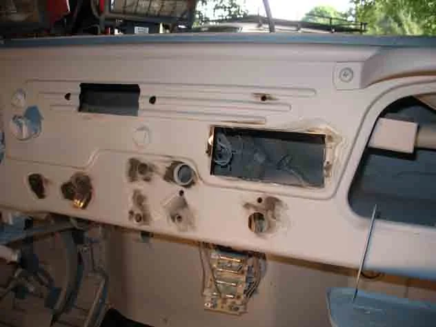

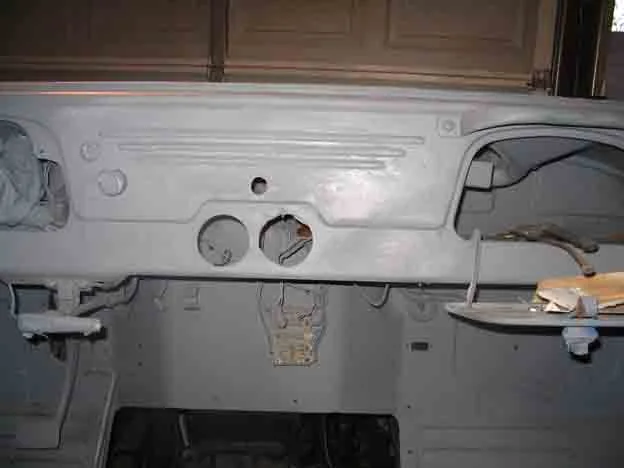

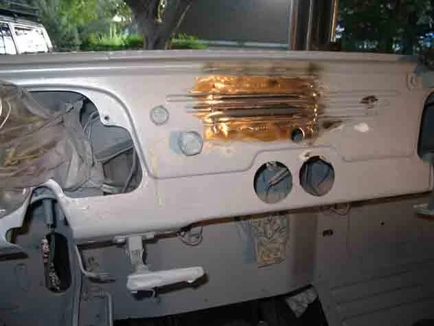

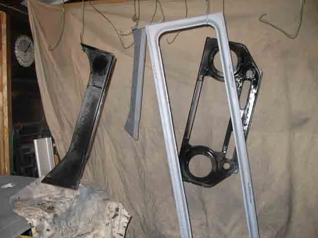

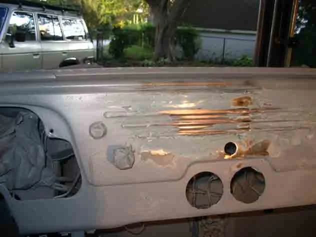

ok took some pics today of my junk. ofcourse it would have been better to take before during then after but I did take some shots during todays work but I will explain what I did. or you can go to Matt's thread for a better example
anyway Foxfab gave me a hole dash panel peice (just the ribbing) but I decided to just use a square section of it. I cut the entire lame section out and just patch it in. the first 2 pics are reposts then I will post how I went about it and a couple shots toward the end of the project.
fogblanket is online now   Reply With Quote
Old 10-02-06, 06:19 PM   #188 (permalink)
lv junky
fogblanket's Avatar
Join Date: Jun 2004
Location: newport RI
TLCA# 6204
Posts: 1,502

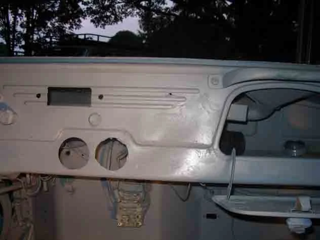

Ok what I did was get some kewl new vice grips that are like 2 feet long. I cut the new square peice and evened it all out with a grinder so it was square(fow gave me a starfish shaped thing )
so then I placed the new patch over where it was going to go and traced around it. then used Matt's most excellent explination of how he cuts body panels and put a 4 1/2" diameter 1/8" thick cutting wheel on my grinder and cut inside my lines then used matter moer on the grinder and a stone on the die grinder to get it so the piece fit in the whole a bit looser than snug. then used my new 2 foot vice grips and a pair of clamps and clamped so alluminuim bar stock behind the seams (Idon't think Matt does this he is better at it than i ) so now the new bpice is sitting flush with the rest of the dash with space all around it meaning it was not touch the dash board but is set up for me to weld the pieces together.
so I switched to .030 from .023 wire and had great results I tacked it here and there then would weld the seam about a 1/2 - 1/4" at a time. then ground it down with a flapper wheel. then put on a coat of mud and sanded most of it off. the last pic is the 4th coat of mud with will get sanded down next time i am out there. it doesn't really need the mud but i want it to look seamless.
Jason

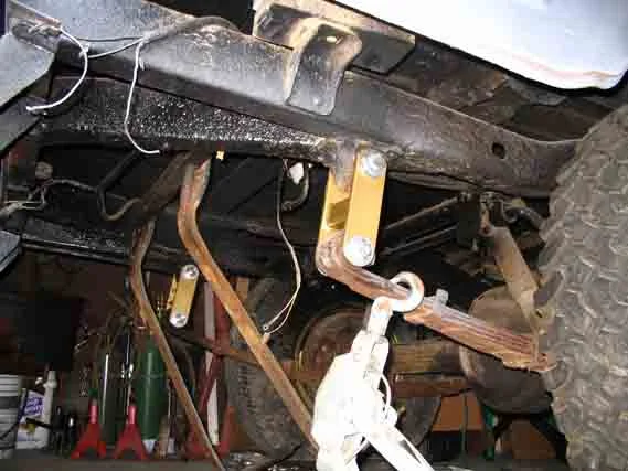

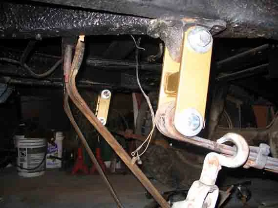

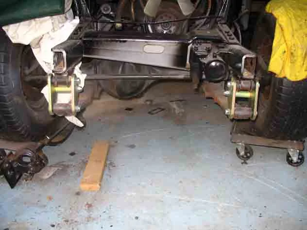

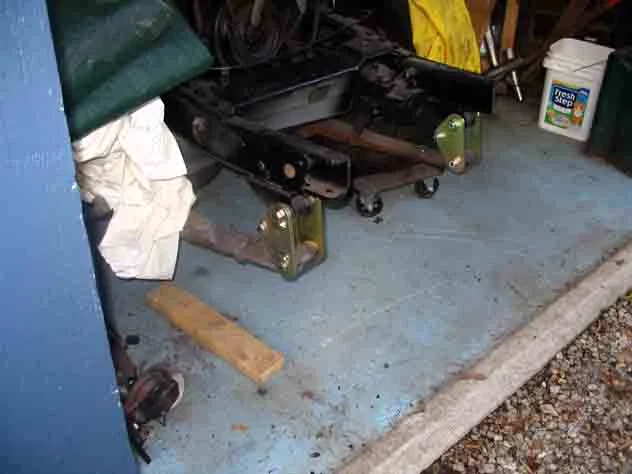

and the last three are of my RSK 4+ shackels ont he front. they look nice. I am pleased with them
Jason

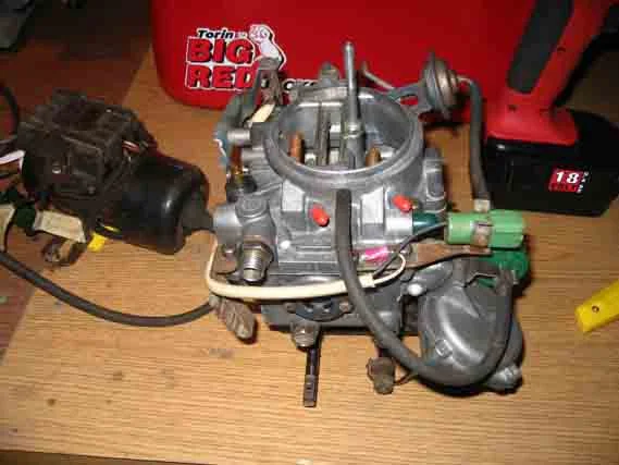

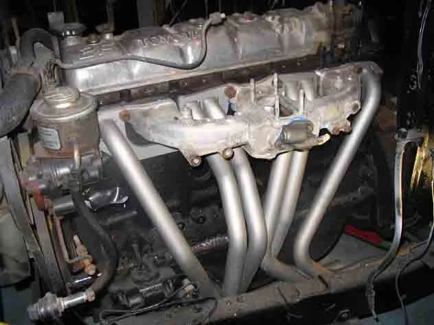

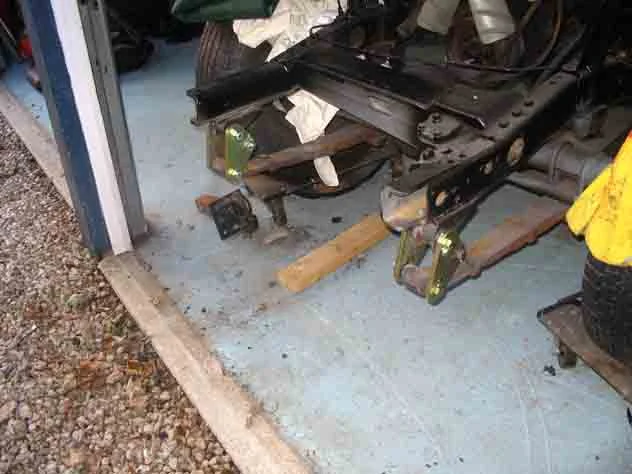

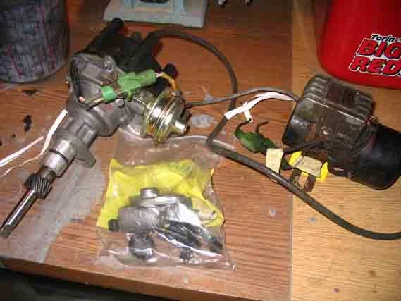

well not a hole lot done in the last 10 days since i updated last. i did get the rear shackles on. and I got my carb and disribtor back this afternoon from TLC Performance. I hope to get those and the engine all put back together this week end so I can rap it up for paint. i started leveling some of the other body parts like the front fenders and rear lift gate and everything else that is not attached to the tub. plan is to get them all leveled and straight then paint the insides and jam the edges so when I reassemble everything i am ready just to do the final coat.this way I can see my colors and make sure I like them. still not sure i am going to do the final color coats but will see how the jamming goes and if i get a good feel for shooting color.
here are some pics of my shackles and carb and distributor.
I wish i was faster at this but I'm pluggin away makin progress.
jason

one more of the shackles. you can see i am ready to plop the refurbished gas tank back in just need to await the meca treker..

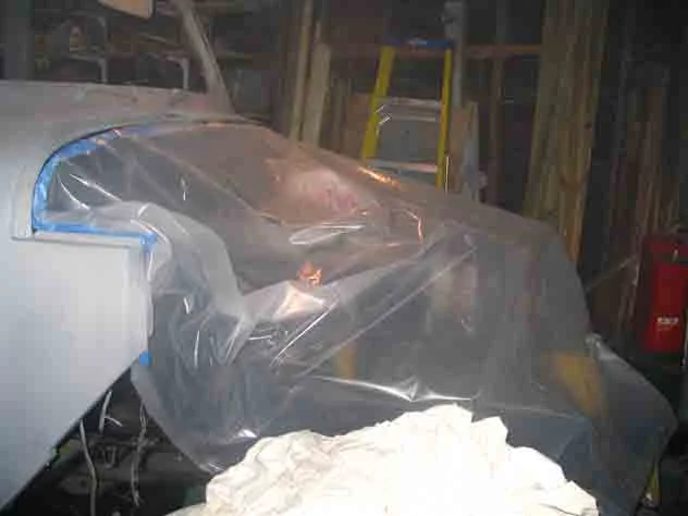

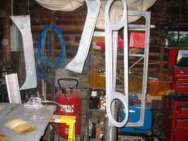

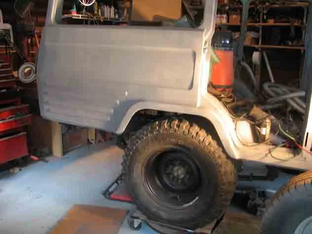

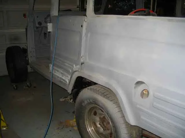

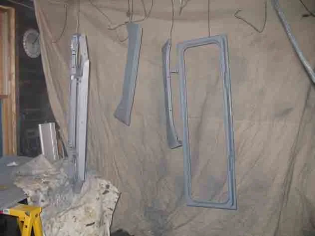

I got some time in on Wilma today. it was fun hagin out in my garage with 60 mph winds howling about. I was able to get the cab distributor , headers, and intake manifold all back on. and change out the airrailfittings for allen head plugs. that went to gether nicely so i started on some more body panels stuff
was able to sand down and prime again the rear hatch anthe aprons and the front bib. i got a coat of the extreme chasis black ont he backs of fthe aprons and the bib. needs anothr coat and they should be all set for jamming the rest.
here are some pics of my prgress today.
Jason

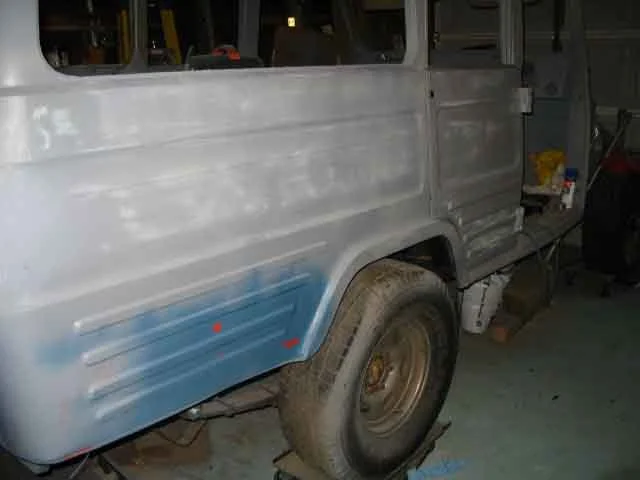

3 of the body panels

other pics of the day

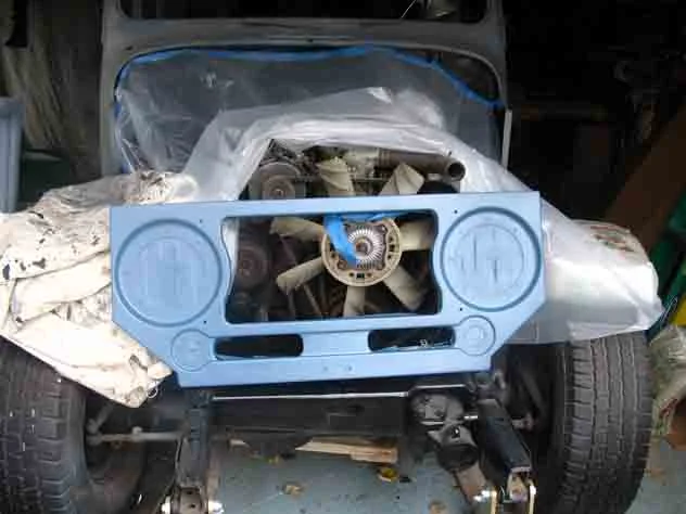

go some paint on the front bib and jammed some bottom color parts. pulled up the cover and kind of sat the bib on the front crossmember to give me anidea of how it wil look. the first pic it is a bit washed out in the second pic the color is a better match to the real thing
I am pleased

I have made some progress on Wilma. for the year I have owned her this is the first time I have gotten a door on her. I have finished up the body work on the rear doors and tailgate and am starting on the front doors now. plan is to finish the body work hang them and finish off any for body work and get the paint line then get them off and jam them and paint the inside and put them away safe in the basement until the floors are done and the inside is painted.
but i am happy to be reesembleing the old girl for the time being anyway.
I have my work cut out for me getting the window hoops reinstalled. all of the hoop mounting studs snappe off either before dissasembly or during. I have all new harware.
those that are fabricators tell me if this sounds kosher. my plan is to dril out the studs on the hoops and tap the hole. cut the head off the new bolt and using the double nut technique threa the new stud intot he freshly tapped hole. then either a small tach weld orjb weld it. I suppose a pic or 2 of what i am talking about would help will take one at lunch.
anyway here are some pics of the doors on
Jason
