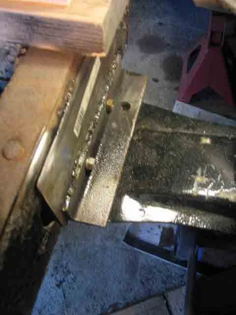

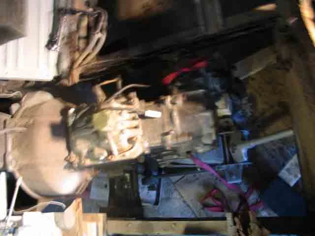

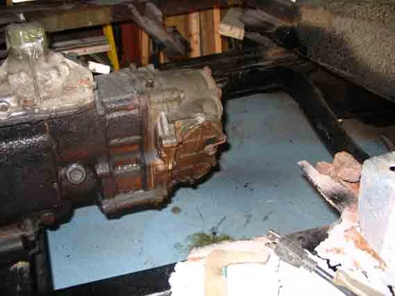

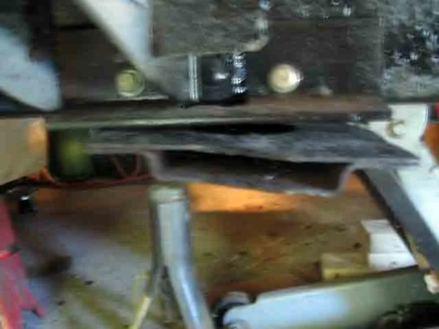

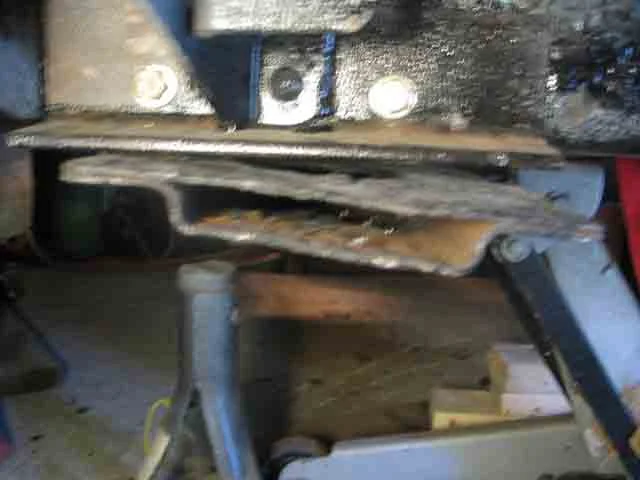

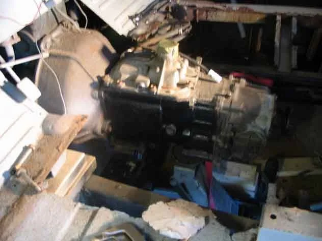

ok I have made some progress. the transimission/transfer case is in. i bolted the crossmember to the bottom of the transission and jacked it up but as you will see int he pictures it hits the frame at an angle. I don't want to stress my new tranny mount too much is just bolting it flat and lettig the angle slack be taken up in the rubber isolater portion of the mount going to cause to much fatigue in it or should i keep it angled?

2 more once i get it all position perfectly then it will all get welded up .

Old 06-28-06, 06:22 AM   #124 (permalink)
Site Addict
merbesfield's Avatar
Join Date: Jan 2005
Location: Atlanta, GA
TLCA# 16162
Posts: 1,752
no expert here, but can't you weld the mounts at the same angle as the crossmember?

Bolting it up flat is not gonna cause a problem IMOH. Junk has been running his that way for almost a year with no issues.

thanks nick that is what i did. just bolted it up . as it turned out the passenger side was level anyway and the drivers sidewas really only a 1/4" off.
so I have been making progress on wilma since i last posted. with so many pm's from Mersfield i have n't had time to post updates on Wilma
so the tranny is all bolted up and in the brakets were welded in and it is solid.

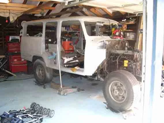

O k back on subject. Wilma
got some time in this week . got the rest (back half) of the frame primed and painted. using the ppg epoxy primer and the chasis black extreme undercarriage paint from Eastwood's while i have the tub jacked up I plan to hit the tail end underside with a coat of the SEM truckbedliner. got my truck bed liner spray gun yesterday so I am amp-ed to use it. I am going to try it out on my CDN M101 bed first. will post pics of the befores and after of that.
I have been lame about my camera recently, but I have been putting some quality time in with Wilma.

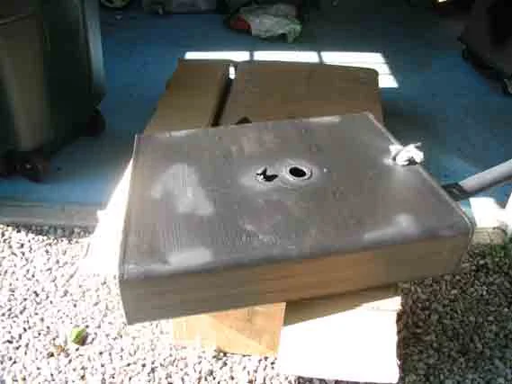

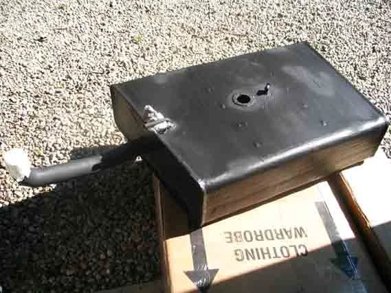

Also got my fuel tank back today from the re-tankers. the outside was not in bad shape but after Matt's posts on his tank I decided to be careful and sent it in. they took about a month from me sending it until I got it back. it cost $379 they pulled the top off and cleaned and replaced anything that looked like rust then coated it. it was more expensive than normal in that our tanks have 4 baffles and they had to get to each one.

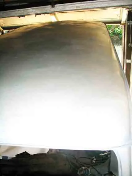

Ok on tot he pics first is the roof can't really see how much work has gone into it but i know thats what matters right??

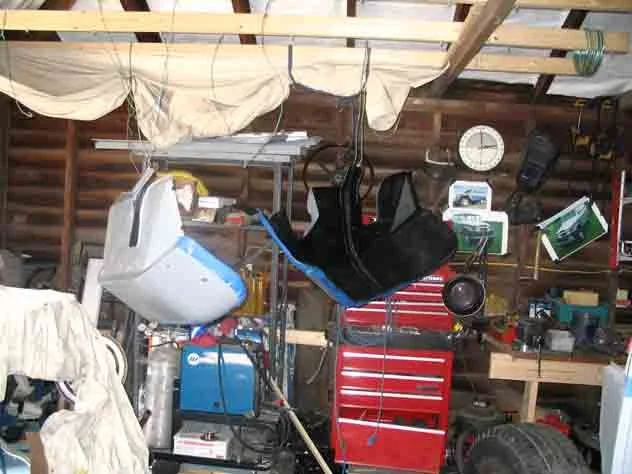

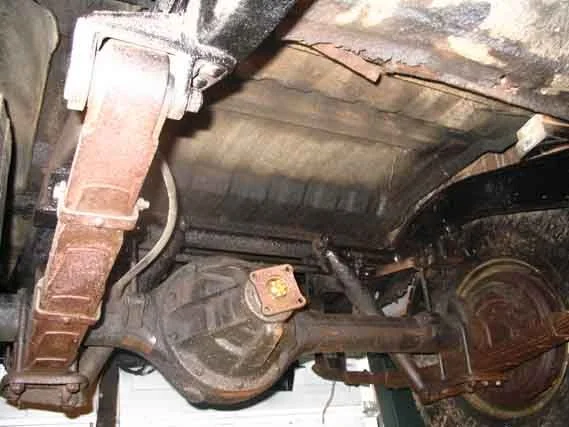

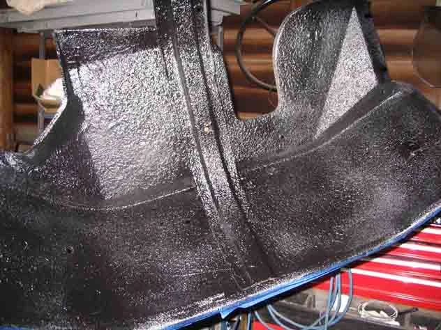

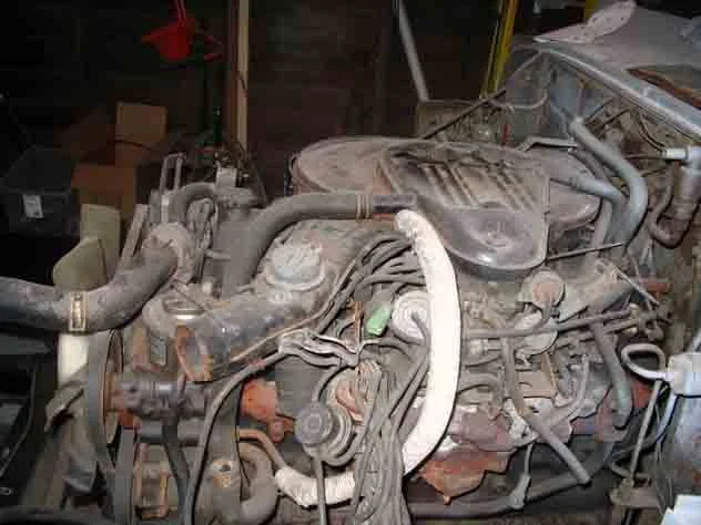

the next shot is the tranny in and the painted frame most of the floor pan you see is going soon .

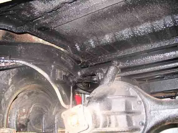

and then a shoot from underneath of the painted frame with the body lowered back on it after painting.

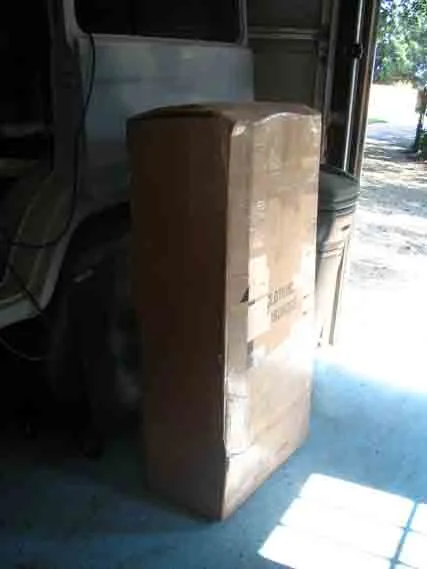

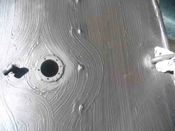

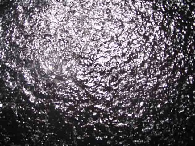

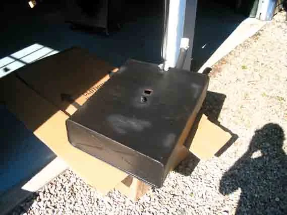

ok this next series of shots is on the tank. first ist he box that it came in . next is what I found inside the box (ie styrafoam peanuts that subsequently spread out over my yard due to a gust of wind.
then some shots of the tank and a close up of the top so you can see the texture of the rubberized coating they put on inside and out. very cool stuf and very nice work. i am pleased.

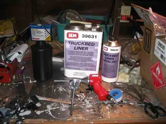

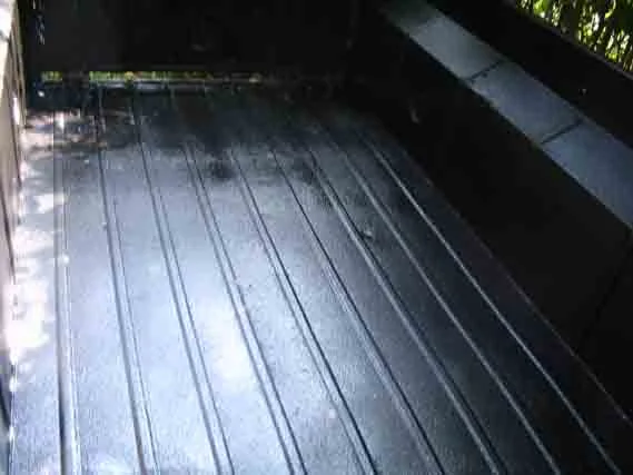

ok these next shots are of the truck bed liner SEM stuff and the bedliner gun aas well as a cool idea i got to lighten up an old 2 car garage (ie my workshop) that is to staple tyveck strips in between the rafters. really lightend things up.

Thanks for the pics of the tank, looks like it came out really nice. One day i might have to get mine professionally done. It was just not in the cards for this time.

i am pleased with the tank.

Make sure the gun you got has a 1/2" orfice and pick up tube where the product comes out. I tried a gun with a 3/8" opening first years ago and it doesn't work. SEM will also recomend a 1/2" gun.
Just don't want you to catalize all that material and come to find out you can't get it on?

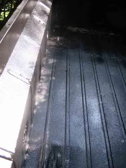

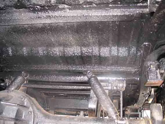

thanks Matt i sprayed yesterday before i lgot your post i went back and measured the gun and its 1/2" i guess i got lucky
i did get a couple of coats on underside of the tub and i also sprayed the bed of my M101 CDN 1/4 ton trailor. my pics aren't great (they never are ) but you can see how it looks for the most part.
it shoot pretty well out of the gun kind of like a constent buckshot effect i had good flow. there is no way to really adjust the gun unlike my hplv gun so I can see why it is important to have a gun that shots properly. i am pleased with the results and will do the underside of the fenders and the main floor pan when it gets here as well. not sure how much more it will harden but it has a rubbery rhino liner type feel unlike the durebek stuff I had on the tub of my old fj40 which was really hard.

got some time in on wilma this week end and tonight between tiling my back entrance and designing my kids tree house and working up a lumber order for that project.
anyway i decided to get as much undercoated as I could so i first dove into the wheel wells last week removed the shield thingy that protects the exposed area between the underside of the fender and the outer body edge. intersting setup wonder why they moved away from this setup for the fj40s would have made the fenders on them last longer. anyway the pics of my work on the rear fenders did not come out but the first pick is of the fender coated in the bedliner of which i got 3 coats in on each side. i will say thank you to atleast 2 PO ago (the last owner just tore everything apart) in that there was alayer so thick of under coating on most of the wheel wells that it was all still fresh from the last time someone did body work , which i am geussing was in the early 80's sometime.
I also dragged the front fenders out of the basment which were blasted stripped and primed last fall and put a couple coats on the underside of them as well. now i just need to high build prime them and sand them smooth.
I have been contemplating using this stuff on the inside floor boards in that i was going to dynamat extreme them anyway anyone know how bedliner works as sound proofing. i have the dynamat extreme stuff in the whole interior of my fj62 and it made a huge different. i could actually hear the stereo on the way to the trail with 35" swappers.
Jason

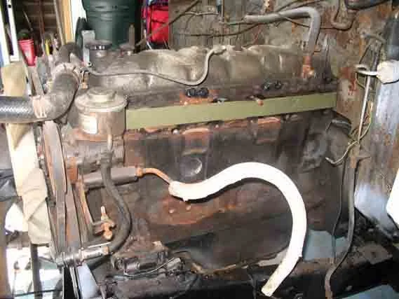

the next project i started working on tonight was tearing everything off the engine. the engine is a n 87 2f from an fj60 which I plan on sending the carb and distributor to Jim C to get tuned . desmogged and run some ceramic headers. i have already picked up alot of the parts for this like the headers and an early f aircleaner. but i still need to get the carb and distributor off and to Jim C for rebuild. then get it all back together and running
fogblanket is offline   Reply With Quote

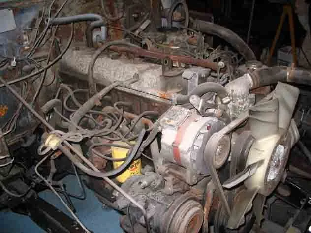

got alot of stuff of the other side only thing noticable in this pic is the air cleaner is gone. but i will keep updating the progress

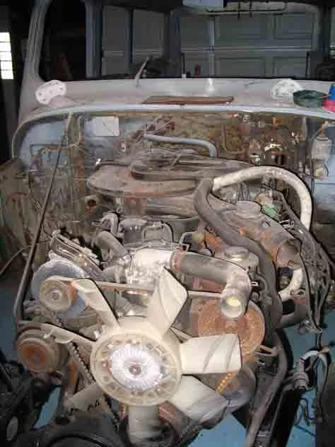

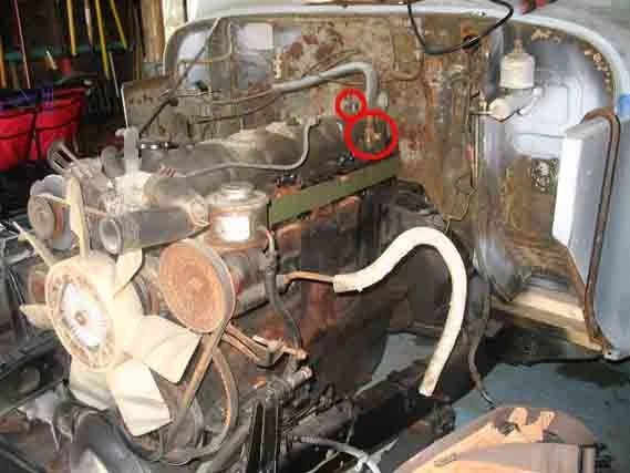

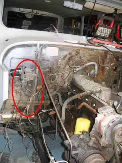

got some more time in on Wilma this week end. got some more stuff stripped out of the engine area for the most part its all straight forward but I had some questions. I am running an 87 2f so the only thing I really need to save wireing wise is the lights and instrument wireing. well some of it anyway. but the area circle in the first pic is part of the stock heater (I think) is this going to work with whatever heater I swap in? or am i better of starting from scratch and can anyone make a good recommendation as to what heater i should use.
- my 2f came with an ac pump is this worth rebuilding and using or am I better off, if I decide i want AC to go another route?
theoretically I would like to set up a system that uses the same vents for both heat and ac. i am really not wild about the extra expense that ac is going to add but where I live it is so moinst that ac is a must for defrost.
- and as far as desmogging goes the top circle gets pluggd into the aircleaner but what about the larger circled area. this hose outlet has 2 outlets and is ported off the top of the head next to an air rail fitting. both hoses were not conected so I have no clue if i can plug it up.
lastly i spun her around in the garage so the engine is closer to the door now so i can clean it and work on it a bit easier also i have some body work to do on the passenger side now which will be closer to the welder.
Jason

and one of her spun around

If I remeber, Wilma, had some aftermarket heater setup.
I believe what you have circled is the vacume actuator for the stock t-case. You don't need it since you're using the floor shifted 4 speed split case.
One of the hoses off the back of the head is a heater hose. Not sure about the other.
