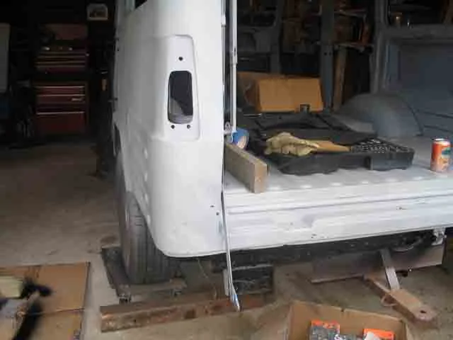

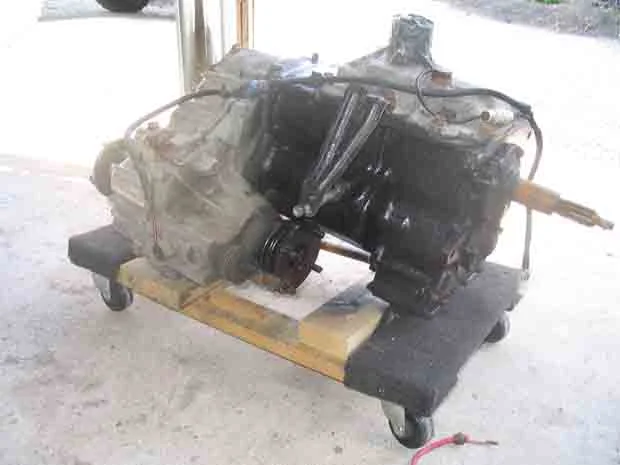

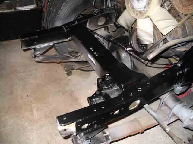

ok been real busy this week on my cruisers in generl. on my fj62 i put an extreme valve body installed drove less than 3 mile son the test drive and had a tre blow out....
anyway i also got alot done on the lv. I finished stripping the paint on all the sides and the interior areas that are in good shape. cleaned up and preped the front half of the frame for paint and shot a coat of epoxy primer on the frame and on the whole tub inside and out.
i also got the transimmison cleaned up and painted with some marine engine paint. hopefully get that installed soon.
jason

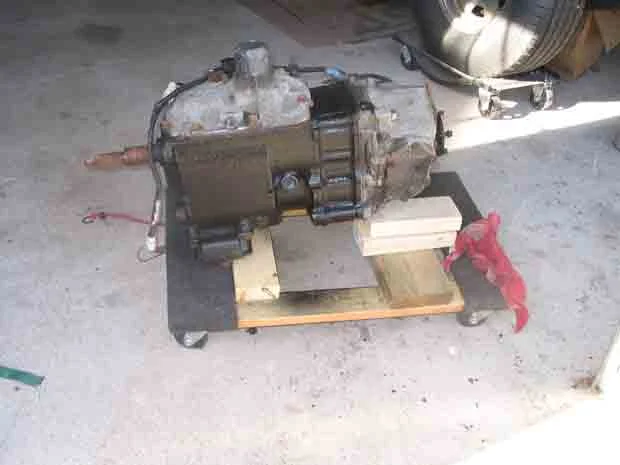

2 more

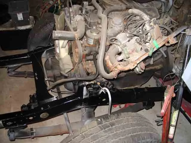

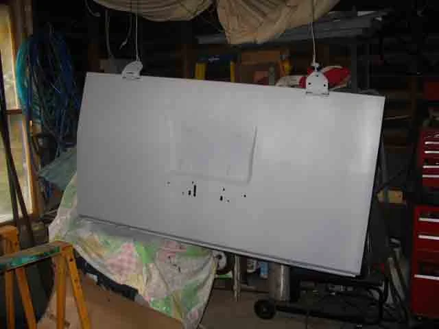

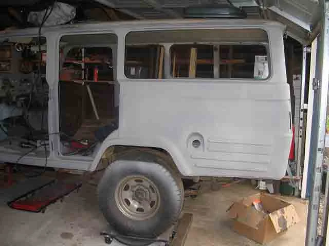

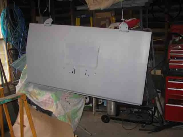

had a procutive week sneaking out and working on Wilma.. was able to remove all the body mounts and get the body up on blocks on the frame.want to get the trarny installed then it will be moveable and i can then contempte taking the bod y completely off or not.
I got the body sanded and another coat of high build on it. i finally got the tailgate sprayed with epoxy primer. i also got chasis black on
the front half of the frame. it needs a second coat but it is slowly coming together
here are some pics of the progress
fogblanket is online now   Reply With Quote

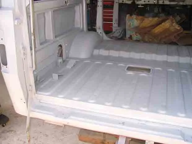

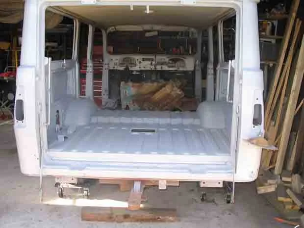

3 more

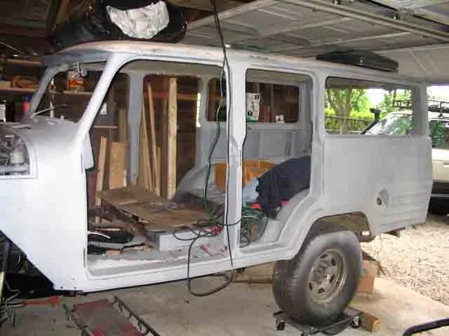

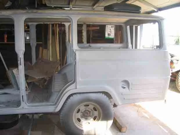

1 more

Well I got some good fathers day time in yesterday on Wilma. since I don't have an engine hoist and I am pretty much doing everything on my own. I rector setted a lovely crane to get the transmission/transfer case up off the floor high enough to get a floor jack under to help take some of the weight.
my crane consisted of 2 metal collapsible saw horses (the ones you get at home depot that you can extend the legs on). so I had those set up through the holes in the floor from each side so they could be as close as possible.and bolted a pressure reated 4x4 across the top then used a come a long to lift it up.
anyway I was able to get the transmission up and in. At first I could not get the input shaft splines lined up but a call to Foxfab had me putting it in gear and turning the output until it slide on to about 3/4" from all the way on. I am so close. I used a clutch alignment tool so i know it should be lining up with the pilot bearing. before i start cranking it in with the bolts. I just want to make sure thats a normal occurance.
I also finished up the mounting brackets for the crossmember so once i get it all on and bolted up i can finally get the back end of the engine off jack stands and move the lv around the garage to make body work and things a bit eaier.
I didn't take pictures yet not really much to show except my rector set tranny hoist
Jason

Jason,
DON'T DRAW THE TRANS UP WITH BOLTS! That's how ears get busted off trans cases. Most likely you need to wobble the trans one way or the other to get the input shaft aligned with the pilot bearing. Sometimes they drop right in and sometimes you gotta fight'em. You can also buy a couple bolts from Home Depot/Lowes that match the treads of the bell housing. Cut the heads off and thread the bolts into the bell housing. Use them to help guide the trans the last bit of distance. Once you get the trans within an 1/8" or so then start drawing it up with the bolts. Make sure the dowel pins line up with the trans as it snugs up too.
HTH,
