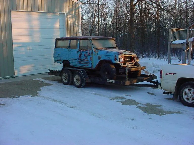

1965 FJ45lv build up/resto thread............and go.
I was debating on whether to start a thread on my (EDIT:THE WIFE'S-I CAUGHT HELL FOR, "MY") resto/build up project for the wife's 65 lv. But, figured it might help a few people and more importantly, help me if someone see's something or recomends something before I am about to do it!!
I've had a good month or 2 of obtaining parts and also determining what I wanted and what I wanted to do. I would say actual working on this rig started approx. 2 weeks ago around 3/15/2005.
I've always kinda considered myself somewhat of a purist, not die-hard, but liked to see things kept mostly stock. I will be deviating from that belief somewhat on this project. Sorry if I offend anyone, but for me what it came down to is I want to use this rig, a lot! I want the stock look, but more power and a nicer ride. So I am building it with some creature comforts in mind.
Mod's in mind:
350 sbc
700R4 auto tranny
Saginaw power steering
parabolic springs
79 disc axles w/ 3.73 ring and pinion
Ididit steering column, tilt, cruise control
Vintage air - A/C
more stuff as I think of it?
I'll start posting pics and if you want me to stop, just let me know. Threads can be deleted anytime.
And of course as always, more pics on my site - www.crustycruisers.com
Thanks, Matt

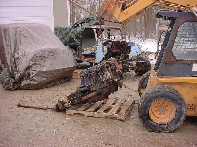

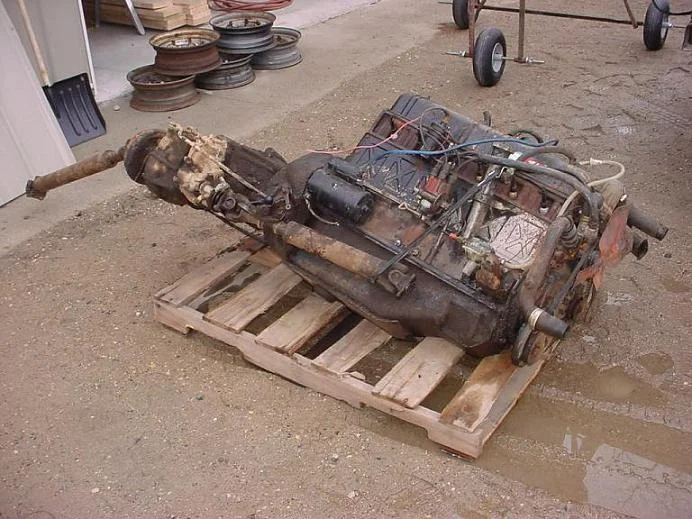

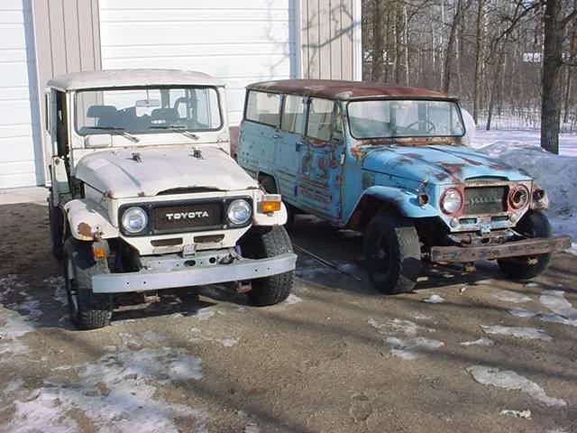

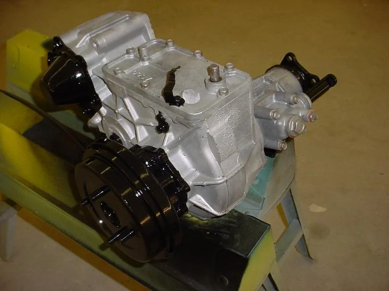

The Donor 79, to be sacrificed in the name of the Wagon!!

Cool!
Pretty transfer case.

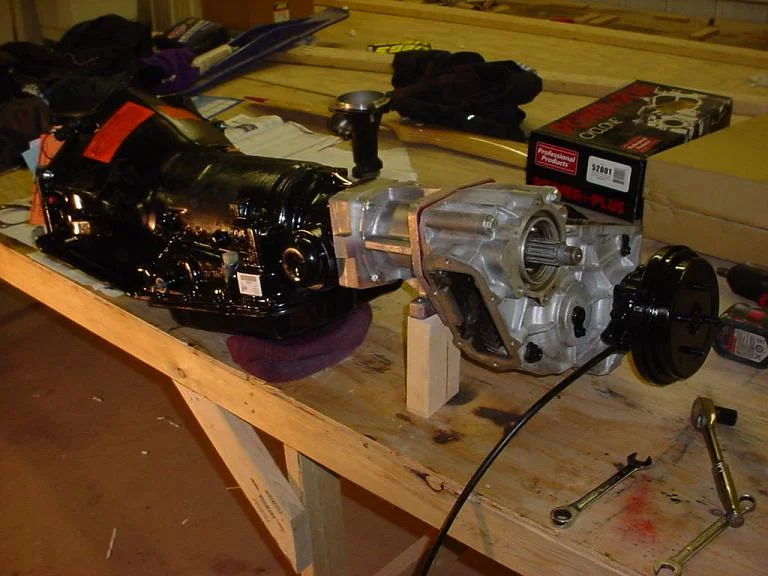

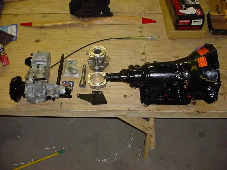

more pics

03-28-05, 07:56 AM

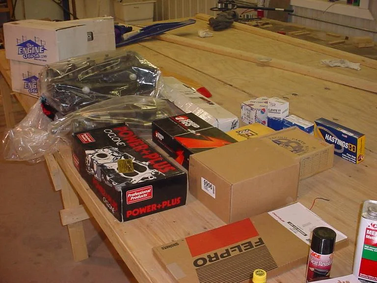

1 more post for now

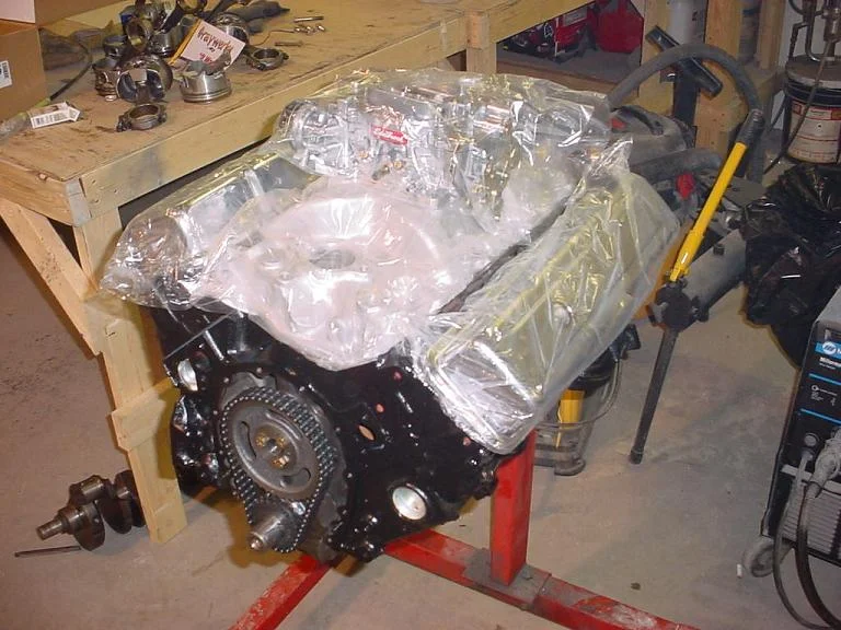

Goodwrench crate motor?

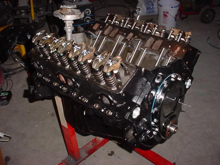

Posts: 3,069
Quote:
No, building it from scratch. Had the block machined locally for the pistons I am using, ordered up all the parts that I wanted. Good mechanic friend of mine is giving me a hand doing the motor.
Matt

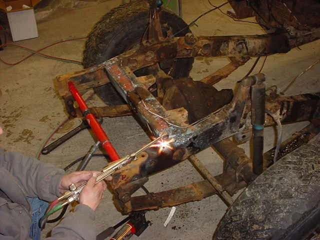

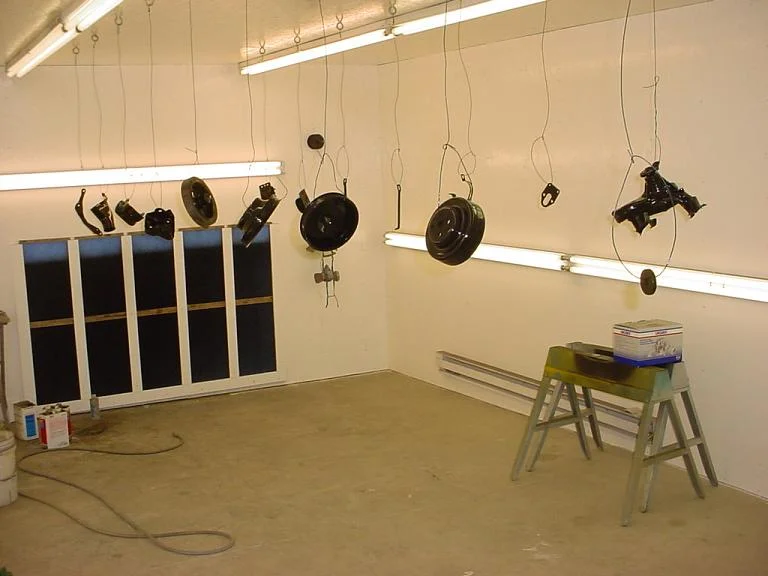

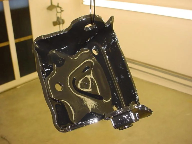

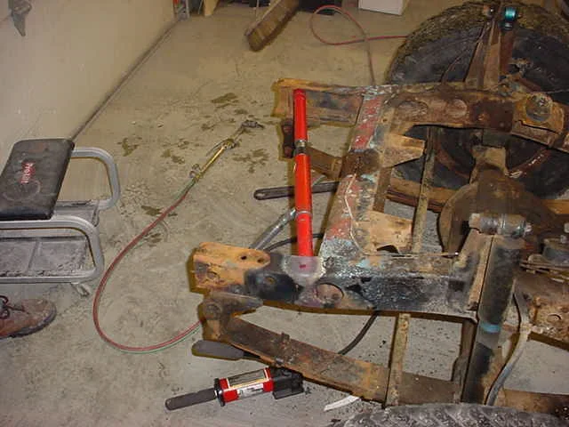

Few more pics of fun from later this afternoon. It looks crude, but I want to get this messy stuff out of the way outside before I bring it in the shop.
Matt

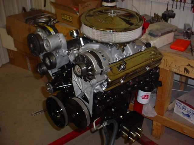

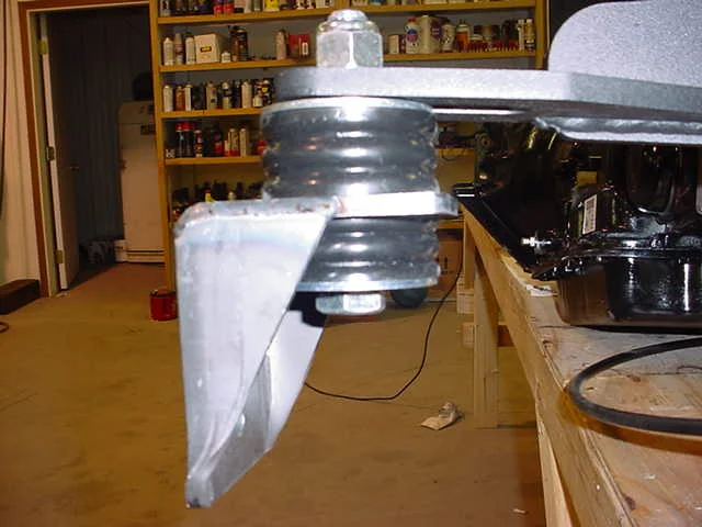

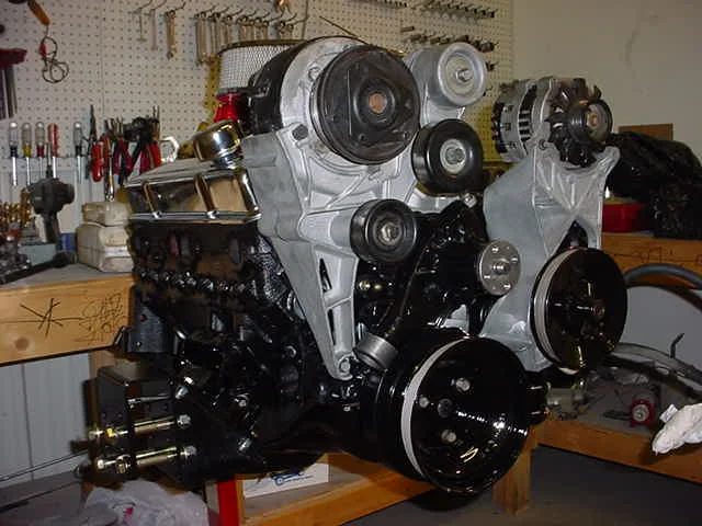

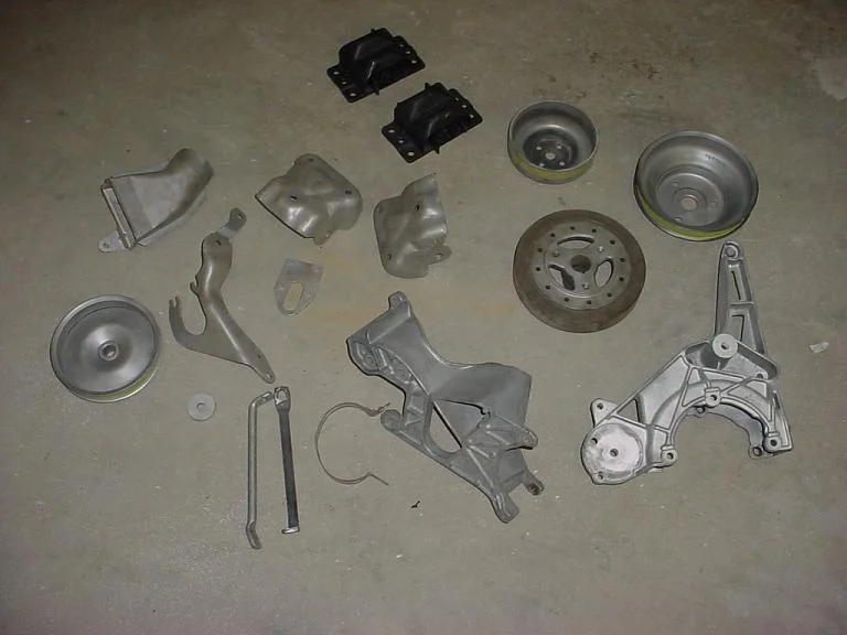

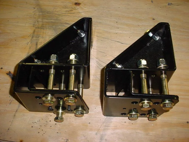

Worked on the 350 a little this even, got most of the acc. bolted on, few pics
Also, do I have my mounts correct on my rear AA T-case bracket? AA says small donut on the bottom and large on top, but in the pic in there instructions the small donut looks like a smaller dia. Both mine are the same dia., just one is thinner.
Thanks, Matt

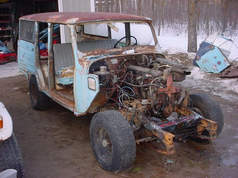

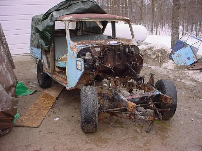

Loaded up the LV tonight and brought it up to a friend of mine who owns an auto body shop. He has a frame rack and I wanted him to take a look at the front end, since I noticed the frame was swayed to the driver side slightly when I took the front clip off.
After some quick measuring on his part he determined the front end was about a 1/2" out of square to the driver side. Frame rack not needed, but porta power and torch was. Some precision heating, targeted porta powering and a little BFH'ing, all is well and square now, amazing how fast he did it.
When I had it up there this evening I noticed the passenger side shock tower was bolted on instead of buck riveted. With a cast piece like a shock tower, I imagine if it got hit on the side it wouldn't have bent, it would have broke. With the amount of filler in the front tin and the shock tower, must have been hit in the right front corner sometime during it's life? Oh, well....nice and straight now.
Matt

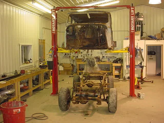

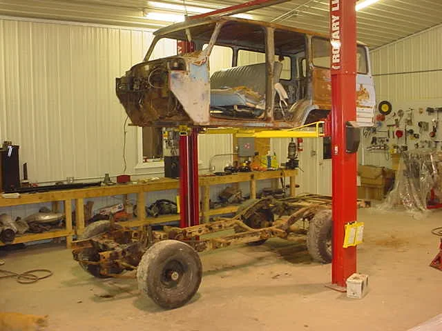

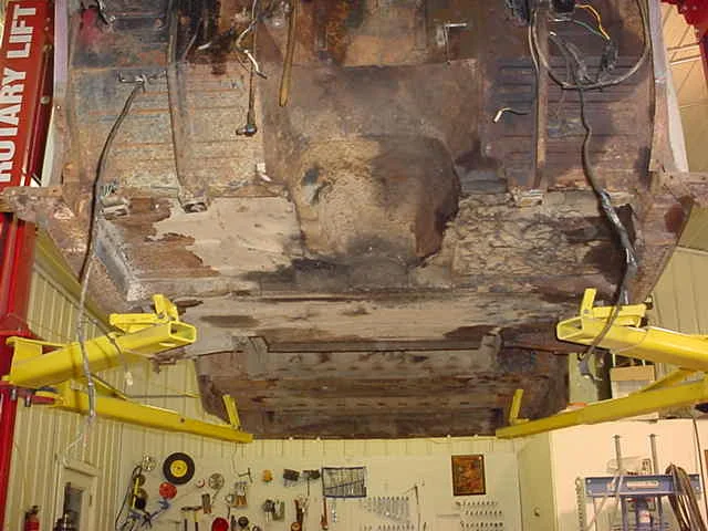

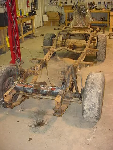

Got the lv in the shop tonight. Plan was to just get it in the shop, clean up, get all the parts in order and ready for Friday night.
My buddy Chad and I got a little ambitious and spent about an hour and unbolted, busted and torched body mounts and misc. fittings off.
Got the body off and up in the air sitting on the hoist. Have a few more things to get off the fram and cleaned up ready for welding. Might have the motor and tranny mocked up by Friday night. I think we should have all mounts welded in sometime Saturday afternoon???
Matt

I was wondering about gloss vs semi-gloss on the frame for LVs. Gloss is nicer but I was thinking Semi-gloss might be closer to stock. What is your opinion on that?
All things shinny !!!!
Just kidding not all. The guy doing the powdercoating actually has 45% gloss that they use right now all the time. I would say fresh out of the oven it looks semi or satin as far as gloss. Here's an example of a 75 Bronco frame that we powdercoated about a month ago.
http://www.crustycruisers.com/b38.jpg
It looks a little shinnier in the pics than it actually is.
That is fresh out of the oven. What I have noticed, for example on my 77 FJ40 that I restored. I used singlestage ureathane on the frame in black, which was like a mirror when I was done. A year later after going up and down my gravel road every day and what ever road grime on it over the course of the year, kinda satin/semi-gloss now. Not chipped or rusting, just not as shinny.
I would say if a guy was going to leave it in the living room in an auto caccoon for ever probably semi-gloss. If your going to drive it, as shinny as possible, because it will dull somewhat.
Matt
