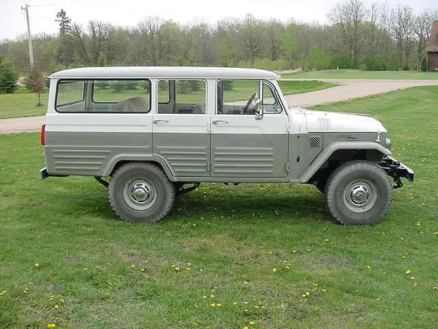

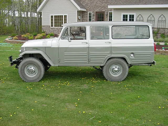

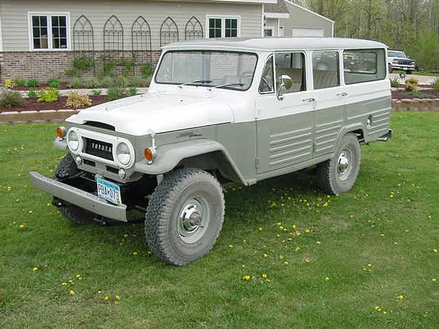

About 2.5 hours on the the lv today, got the rear springs swapped out.
I had boughten that set of OME springs from POSER last fall. The parabolics after 500 miles had sacked out into the negatives in the ass end of the lv and the wheels were rubbing in the wheel wells......so they had to go.
I had painted the springs last fall, so they were ready to go. Went pretty much as planned, it was nice that the bushings in the parabolics were the same size as the OME, so everything fit right back in.
I wish I would have taken a before pic, bummed about that. The lv is definetely sitting back up, I'm thinking about 3" or so higher than it was before? I can now see the tops of the tire in the rear wheel wells, and it is pretty much sitting level again. Took a couple trips into town today and the wife and I went for a drive this evening to the, "drive-in". I think it actually drove better than it did before. Before it seemed kinda mushy in the ass, maybe just to soft? Now it seemed firm, but it still drove amazingly well. The OME's seem to suck up the bumps just fine and still offer a smooth ride. Needless to say, very happy with the OME's!
Matt

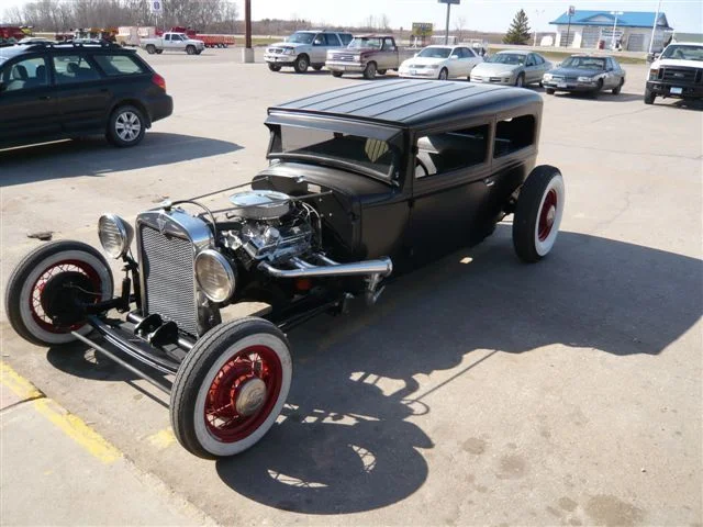

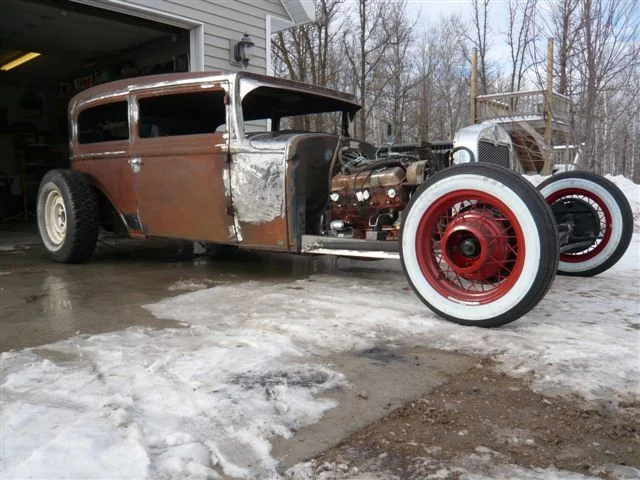

Few pics of the project I have been working on since October, 1930 Chevy 2 door sedan. I picked it up mid-September, but didn't get started on it until October.
Thought I might have to work on some Detroit junk for a bit....but, I have slightly mattified it a bit

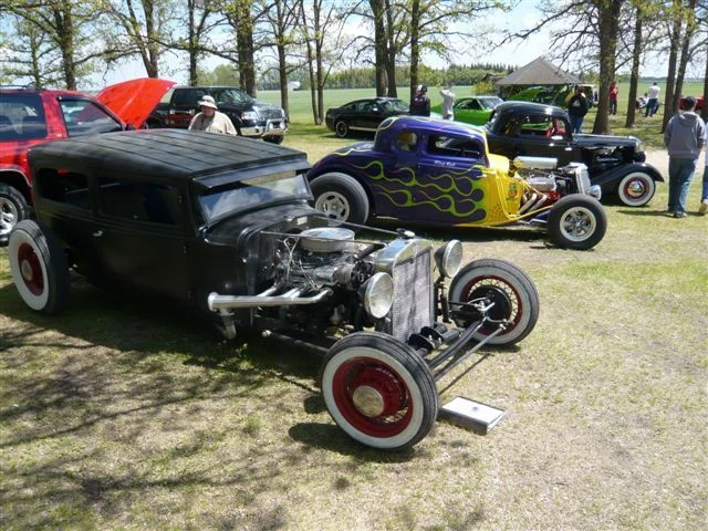

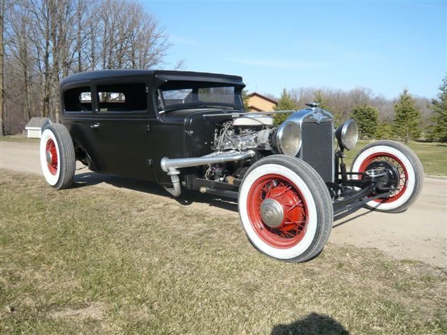

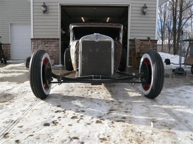

Thought I might throw out a couple teaser photo's These 2 pics were taken a couple weeks ago...had to roll it out to clean in the garage.
I fabbed the frame from scratch, Z'd the rear end 12". Using a 40 Ford front axle and a 73 ford 9" rear axle. Drivetrain is 350 sbc with a TH350 auto tranny out of a 75 chevy truck I bought for $200 bucks. I channeled the body 4" over the frame and chopped the top 3.5". Also welded an 88 dodge mini van roof into the roof of the chevy. The rims are 1928 stock ford wire spokes, got those from a local 70 year old man for $5 bucks a rim...had to straighten them out, blast and paint..but pretty cool. Front tires are motorcycle tires I bought off ebay for $25 bucks each. I have rear wire spokes, just don't have the rubber yet.
I have a build up thread on another website....it is no where near the detail of the LV or LPB thread. Just seems so hard to keep up on top of it.. But, there are a lot of photos on it..
Matt
