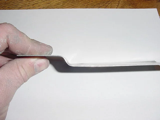

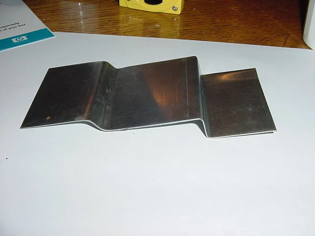

Matt, can you show us or direct us to where and how you bent 45 degree angles for the floor pans with this contraption?
As far as the location of the bends, I measured in between every angle and bent it on that mark.
As far as the 45 degree bend. I just looked from the end as I was making the bend. You can just watch as your bending it, as long as you know what 45 degree angle looks like. If you off a degree or 2 that's ok. Once it's out and your fitting the part you can tweek it with your hand.
Hope that helps, Matt

yes, but did you figure a way to make the brake do what i would call a hard bend at that angle? when i try to bend at the 45 degrees or close to it, the bend is not sharp and creased like when you come all the way down on it for a 90 plus bend. it just sort of gives a rolled bend which does not look like the factory bends on the floor. does this make sense the way i am describing it. that is why i thought there was a way to set a hard 45 degree brake? what am i missing?
If your trying to make the floor bends, it can do it. You've seen the pics in this thread, those were done with that machine.
The brake can bend within about 3/8" to 7/16" of a bend next to it. I believe the floor pan bends are about 7/16" apart at those 45's.
Does that make sense?

I just went out in the shop and bent this up. Bends are 3/8" apart exactly.
Yes, it is hard to get tight, crisp bends that close together. I think that is what you are having problems with right?
Matt
Matt
yes no problem with the distance between bends, i am talking about the actual bend and how it is not creasing at the bend, more like rolling it.
merbesfield is offline   Reply With Quote
Matt
exactly, but that is what my machine does so i guess that is normal. i just thought they would be more creased bc i am used to seeing 90's and locking seam bends. i will use this picture to bend some tomorrow and compare mine to yours, but i think they will look like that. so do you just mark them out with a sharpie or something and go to bending?

Full 90's with the same piece.

Quote:
Yep.....
I think once you get started and see what you produce, you will be happy.
Matt

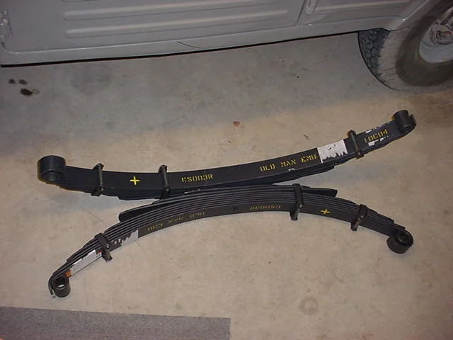

Guess what showed up today???? A brand new rear set of Old Man Emu springs for the lv Courtesy of POSER (Steve) from LCR4WD.....Thanks Steve!!
I think your going to have to swing up and give me a hand putting them on......holy heavy bat man It's going to take a couple men and a small boy to get those baby's in!
Needless to say, very, very happy. Looking forward to getting them installed and trying them out. Hopefully keep the wheels off the wheel wells now. I'll try to get them hung up in the booth in the next few days. Scotch brite them down with a pad, spray a coat of epoxy primer and a couple coats of single stage urethane.
Steve also sent a couple other goodies. Those key chains are cool, where did you get those?? The stickers (which I didn't take a pic of) are awesome also.....running out of room on the tool box though..
Thanks again Steve and get up here soon so we can put them in
Matt

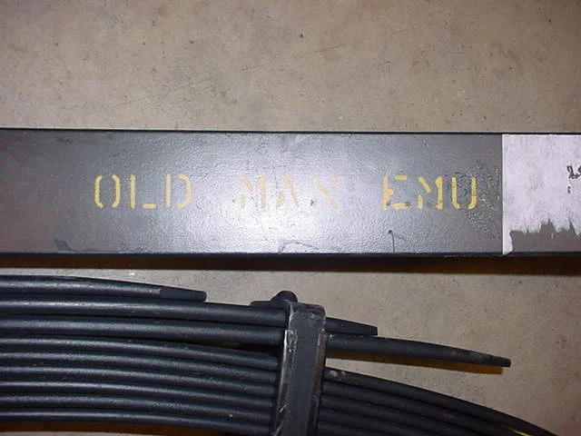

last 3
