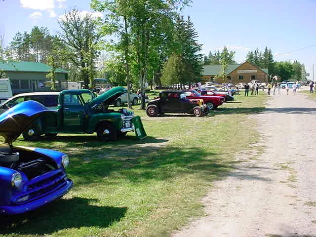

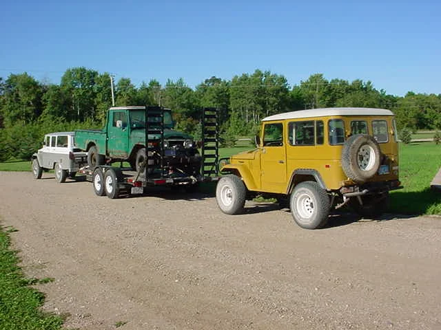

Haven't made any updates lately, still having to much fun this summer. But, few have asked for driving impressions of the lv and I definetely have one.
There was a car show this weekend in a town up here about 50 miles away. Kinda of a redneck carshow, lots of fun..i've gone the last few years. They roast a pig outside all day, beer and a burn out contest later in the afternoon on the state highway. At the end of the day towards the evening they have a big supper, hand out a few awards and have some more fun.......Anyway, what does this have to do with the lv...I loaded up all my Landcruiser junk and drove down there.
I wanted to take the lwb to show others more variations of the landcruiser, but also for motivation. The kinda motivation where people look at it and roll there eyes Say crap like, "that thing is junk, boy you got your work cut out for you or who in there right mind would fix this?".....Needless to say, I got lots of motivation. I hooked up my trailer and backed the lwb onto it. Reason I backed it on is that I didn't want to get to much tongue weight. Those parabolic springs supposedly with a 2" lift are damm near flat now under the just the weight of the vehicle.....so I was trying to keep the tongue weight to a minimum. Backed it on and got about 50 to 100lbs on there, as much as I thought was possible.
Started heading down my road, which is gravel for about a mile, no problems. Hit the highway and started speeding up. The lv had no problems with power pulling it, you could tell I had about 6500lbs behind me, but the engine had no problem pulling it upto speed. But, as soon as I started getting around 50 mph the ass end started getting that heavy trailer wag......For those of you who have pullled heavy loads, that trailer sway you get when you have a heavy load and you want to stop, but either you have no trailer brakes or there not applying enough. This was that same kind of sway, but I wasn't stopping. Almost like I didn't have enough tougue weight, which I believe I did. Seemed acceptable under 50, but if you started getting over that it got a little scary. I'm not really sure what the cause of this was? I think I had enough tougue weight, but maybe more would have been nice. With the parapolic springs I have, it can't handle the weight of the vehicle, let alone any trailer weight? Although this would suck because those springs were so expensive I am thinking of swapping them out? Not sure to what yet, but after 300+ miles those springs are about level with the world, so I think they have exceed there life span? This may not be the problem, but it might cure the trailer pulling problem and also get the lv back up and keep the wheels from bottoming out in the rear wheel wells.....even when there is no trailer behind it the wheels have bottomed out and the highway??
Anyway, few of you wanted a driving impression and this was one. So, figured I would post something about it and a few pics.....
Thanks, Matt

not sure what to tell you about towing with the waggy. the only towing i ever did with mine was going to SNt which is about a 250 mile trip. i towed a trailer with three dirt bikes down there and had no problems at all, but that was maybe 2000lbs at best on soa stock springs.

Cool pics. I love the roadster burnout!
I think that 50-100 lb on the tongue was a bit light for the amount of towed weight. 10% of the towed weight is the recommended tongue weight. With that much weight I would also use a weight distributing hitch with an anti-sway device and/or some way to level the load. Several companies make kits to install air bags on leaf sprung vehicles. Airing it up raises the rear when towing but does not interfer with daily driving when aired down. I have Air-Lift air bag springs on my Pathfinder.

I pulled those jet skis's a month or so ago and it was absolutely perfect. But, that was only about 1000lbs?
I guess I thought it would do a little better, still thinking the springs are just to soft?
Thanks, Matt

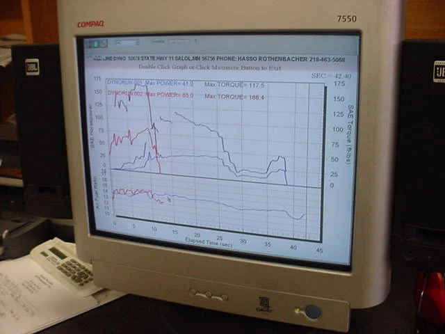

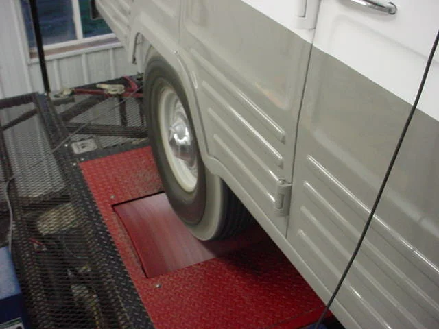

Full night this evening on the lv, had an appointment with the wheel dyno guy. Spent a little over 3 hours up there this evening, just wanted to make sure I had the carb and motor set up right.....left with a little better running vehicle.
He started off testing the vacumm on the carb, did a little tweaking on some screws and got it where he wanted it. Then he moved onto the timing, he crawled underneath and painted some marks on the balancer. Had a fairly fancy timing light, he was all over the place with specific RPM's, while he had me ever so slightly turning the distributor. When he was all done I had never heard it idle that nice.
Then we got to the good stuff, running the lv on the dyno . He stood over on the passenger side next to the monitor with this remote in his hand telling me what to do. We had everything set up for testing at 60 mph, going for maxium usage at that speed. I could type a lot about the next 2 hours, but it mostly consisted of him resetting the computer and having me doing dyno run after run and changing the carb set up. He varied some of the runs, applying certain amounts of load and brake during the runs and how fast or slow I brought the lv upto speed.
He ended up changing the metering rods twice during the runs, but the drive home proved worth while. I noticed that the temp gauge was noticeably less. And since I don't have all my rubber grommets in the firewall yet I was noticing the heat before and after coming through the firewall.... considerably less now. The engine was fairly quiet before....but now it seemed a bit less? Not sure how that works, but just seemed like it was running a lot smoother. One spec. worth mentioning I guess is mph and rpm. RPM was 1700 at 60mph....nice and low on the rpm I thought.
Anyway, few pics of this evenings fun.
Matt

I never thought I would see a 45LV on a Dyno

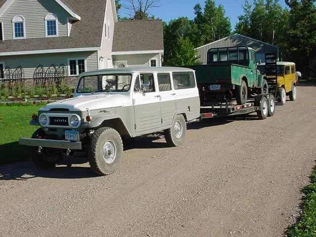

I agree with the 10% of towed weight on the tongue. I've experienced too little tongue weight several times and it results in the tail wagging the dog. That was in 3/4 ton pickups. Not a pleasant experience.
