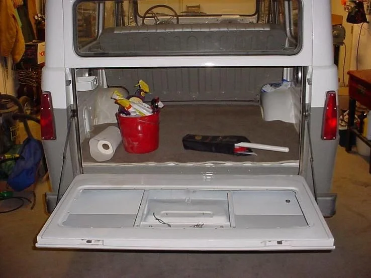

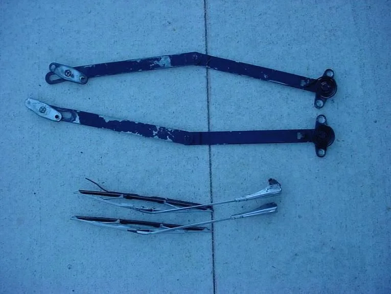

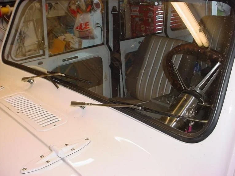

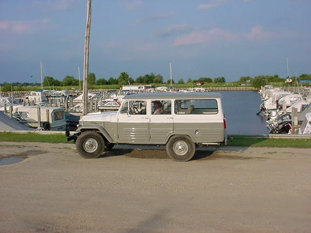

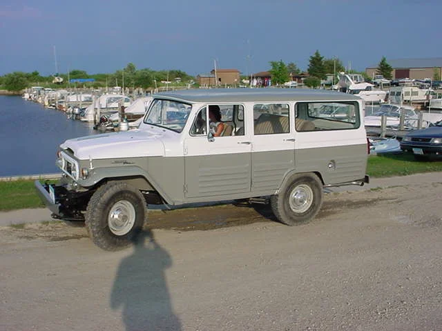

Not much really going on to report on the lv. I've done a little tinkering here and there, but nothing really to report on. I actually did however start working on my A/C lines tonight. We have an AC line crimper at work that they use for tractor AC stuff. I was using that this evening cutting and crimping all my lines. Actually got all the lines done, are AC guy was getting ready to charge the system and I have a leak in my condensor. I pulled it out this evening and hoping to get it aluminum welded tomorrow, get it back together. Kinda sucked because I had to pull the front bib back off to get at the condensor.....oh well.
Few glamour shots from the 4th of July....drove up to a town 20 miles away for an evening fireworks display. Few shots at about 7:30 pm next to the lake

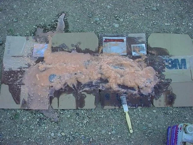

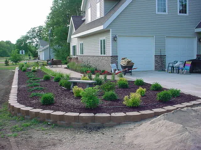

Last pic is what my wife has had me doing for the last few weeks.......man does that stuff suck
Matt

Turned out beautiful Matt. Puts everything else I have seen to shame. I think I will be leaving my stuff in the garage.

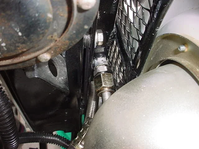

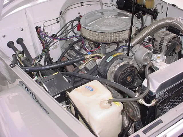

Got a little done on the lv today.....and I stress little I actually worked on that 75 vette most of the weekend.
Got my shifter floor boots installed around the auto stick and the T case stick, few shots. I had to heat the T-case aluminum shifter ring with the acetalene torch and bend the aluminum to fit the tranny hump.
Shot of my A/C lines all crimped up and the lower attachment point on the condesor TIG welded up. Bringing it into town tomorrow, my auto mechanic buddy was over thies weekend. Said to bring it in Monday morning and so he can get the A/C charged. He was kinda excited to do it, so I figure I better get it in there

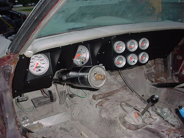

Just a quick update on the A/C.
Got it charged today..........28 F....... Just as it's approaching a 100F outside.
Also got the dash done in that vette this weekend, buddy came and picked it up this evening. He was happy, now he's trailering it off to the same auto mechanic buddy for to start wiring.

Good news on the AC Matt. Mine will freeze you out also, but it should considering I have 1/3 the interior volume. I am very happy with the functions of that unit as well. Having no cables and vacuum lines made it a much nicer install also. You should bring it down to Moab next year for us all to see.

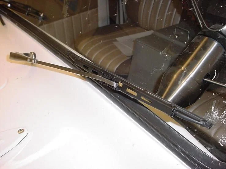

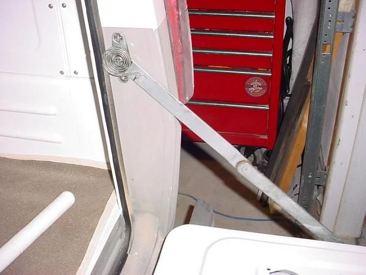

Little work on the lv tonight.....got a care package from Treeroot (Mike). Actually came last Saturday, but had to work all last weekend and just got a chance to do some more work on the lv tonight.
Started with the wipers since that was going to be fairly easy. I had some wipers from CCOT that they had sent me a long time ago, one of those freebee deals in the box. I took the stock metal ones off and popped them on the arms I got from Mike, worked perfect. I used a little metal polish and buffed the arms up before I put them on, but overall they were in pretty nice condition. I am going to try to locate some replacement blades for the stock holders, but until then these should work great.
Then onto the tailgate supports. Somone had painted them black at some point....so I busted out some paint stripper and sauced them up. Took about an hour, but after that all black paint was gone. I think at some point I might blast them and them re-plated, but for now since I need some they look very acceptable.
Cleaned them up in the parts washer at installed them. I took a couple pics to see if I installed them right...not really sure because just seems like no matter which way I positioned them they wanted to fold up instead of down? I don't know, probably got something backwards? If any of you lv owners see something wrong, please let me know.
I am happy the tailgate supports are on....was very hesitant to let the wife drive it, just in case she or someone opened the tailgate. No tailgate supports and if that heavy tailgate hyper extended.......ooh that would not have been good. At least now I'm a little less worried about it
Anyway, pics and Thanks again Mike
Matt

Those two little black rubber things I threw in the box mount in the hole under the tailgate supports. They wern't in the best shape but I figured you could figure something out. They allow the arms to fold down and not hit the paint.
You can see them on Pimp's tailgare.
