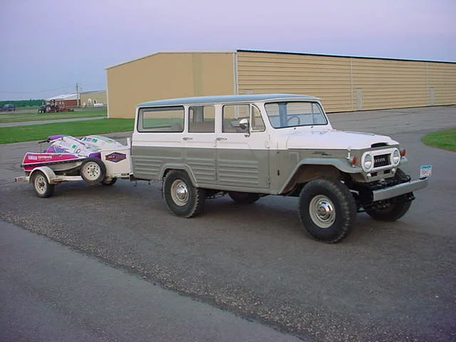

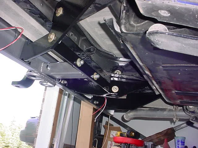

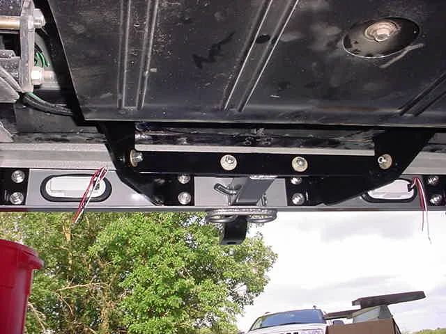

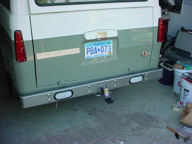

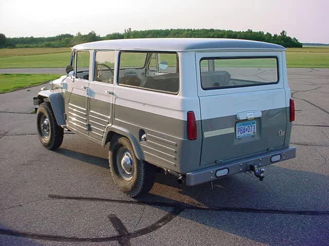

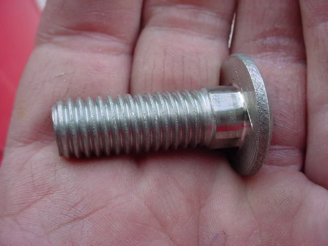

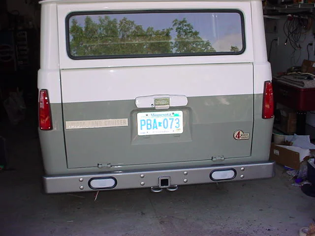

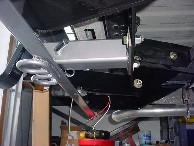

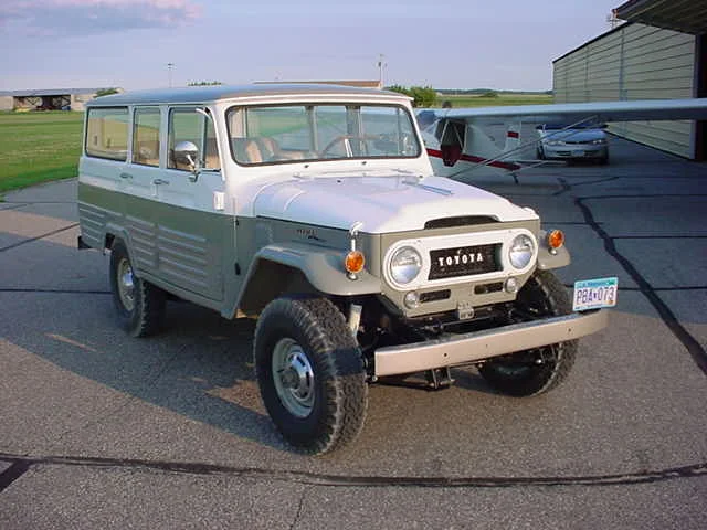

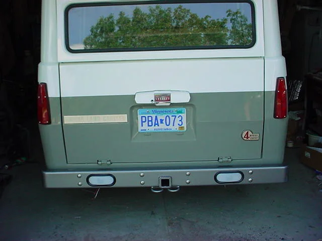

Little bit done on the lv tonight.......bumper and glamour shots
Got home after work and went to work on the bumper. S.S. carriage bolts shoulders were turned down to .510" in the lathe. They fit the rear bumper holes perfect, very tight but a couple good solid hits from the heavy hammer they set in just right. Got all the bolts tightened on the bumper then tighten down all the bracket bolts on the frame.
Wife came out and popped in the rear back up lamps, that was pretty easy, about a 30 second job. I had brought home a new reciever hitch with a
3 1/2" drop, seemed about perfect. Bolted on a 2" ball and figured I better give it a try?
Had to run out to the airport where I had my jet ski's stored....getting hot so it's time Friend of mine was out there so talked to him a while. Also got a few glamour shots, hope you guys don't get sick of them? Few pics of the trailer hooked up also.
Matt

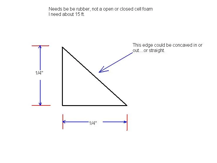

On another note.....I need a piece of rubber like this. This would be a x-section view of it. I'm thinking something like this would come in a roll or something.
It needs to be rubber, not open or closed cell foam. I have looked in a lot of books I have at the store, but can not find anything even close.
Anyone have a source for something like this? I will need about 15 ft.
Thanks, Matt

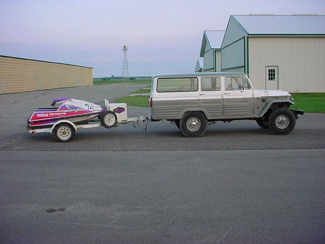

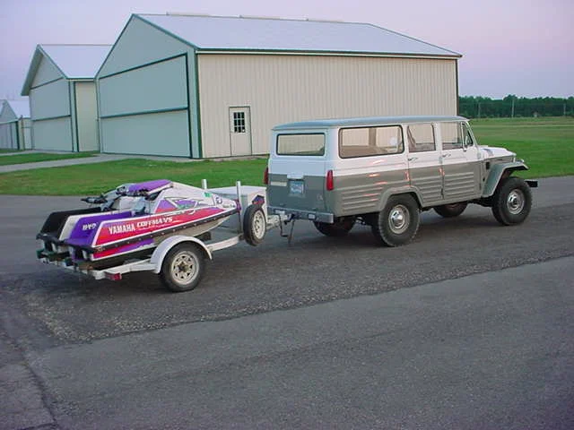

Originally Posted by subzali
Is it just me or does the rear end look saggy under the weight of the jetskis? I know you were talking about springs a couple pages back, but just wondering. I'm not even going to comment on the rest of the build because I can't add anything to what's already been said, just incredible.
I think it is also....I also think those Parabolics are weak. It doesn't seem to take much, although that is all the further it can go, it is now hitting the helper spring.
I think the jury is still out on parabolic springs.....but unless there is some updates to the problems I have seen and others have also......I'm chalking them up to a pyrimaid scheme
Just my 2 cents....Matt

those rear springs look way low to me.

Posts: 3,072
Quote:
I agree......on that note you heading back up to the lv soon?
Do you need me to send you a revised parts list
I'm really hoping a few more parts come off that thing.
Matt

I like the rear bumper looks great. And yes I see the squatting that you mentioned at the rear......it seems more evident w/jet skies in tow.
fjwagon is offline   Reply With Quote

now that you see that with only a little weight the parabolic springs are not up to the task, what would you do different so i can think about what i should do to my lv?

try a "bigger" drop hitch (more drop), the angle looks funny. what's on there a 2", maybe try a 4"

Quote:
Thanks, Matt
i have a possible source for 1/4" rubber, but it is in sheets. do you think you could cut with a utility knife well enough to make the piece you need? does it have to be a continuous 15 feet? if no one knows about the web site you should. i think it is incredible. it is called McMaster-Carr. i have found so many things and all you do is click and it arrives in the mail a couple of days later. http://www.mcmaster.com/
do a search for Polyurethane Rubber, or triangluar rubber, but there are tons of options that may work for you. good luck.
merbesfield is offline   Reply With Quote

Good work on the bumper! That thing is SWEET!
It has a little rise on the trailer, but not much. Those are also 12" rims, a lot of the tandem axle stuff I will be pulling has 15" rims so the trailers will be a bit higher and should be more level. They do make more drops, but I think this drop will be about middle of the road for most everything I pull.
Matt
