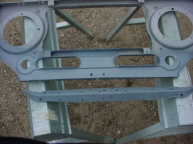

Didn't do much of anything on the lv tonight, the wife and I decided to goto a movie.

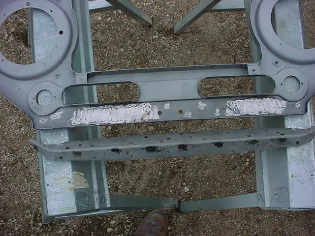

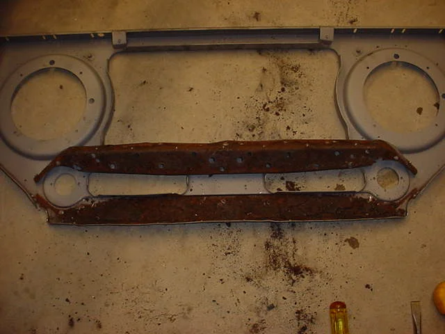

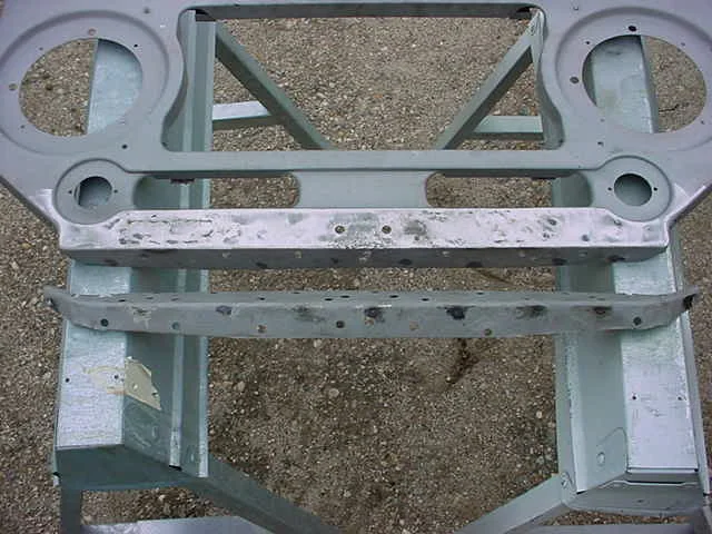

Got home and I've been meaning to tear into the front bib. I wish I would have taken some before pics. I might be able to find some in the back of the trailer after it was sandblasted. I bought a new/used bib from a fellow mudder because the one that came on the lv was bent and full of bondo. I knew when I bought this bib that it had this problem, I'm sure all do. You could tell my a small hole on the front and slight buldging between the spot welds, although after sandblasting it looked pretty good?
Anyway, took the spot weld cutter and cut out about 30 spot welds. I'll try to get both parts sandblasted tomorrow. A little metal work to do on the larger part, prime and plug weld it back together. I'm sure at the factory it was never primed, that's why this occured.
Just thought I would post a pic.
Matt

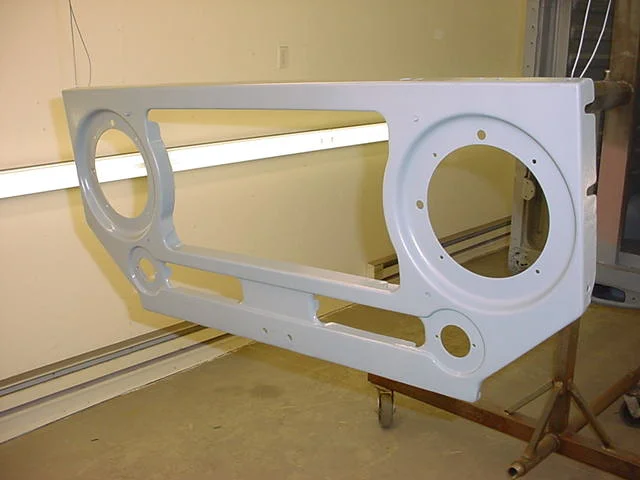

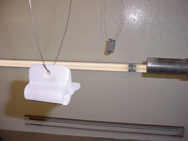

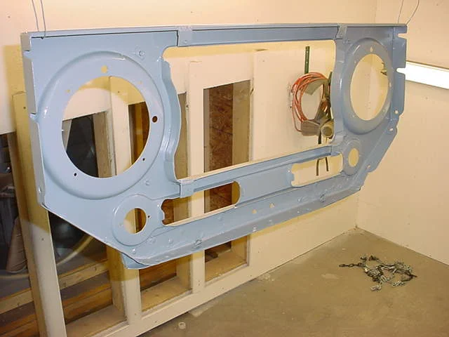

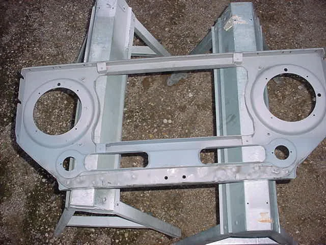

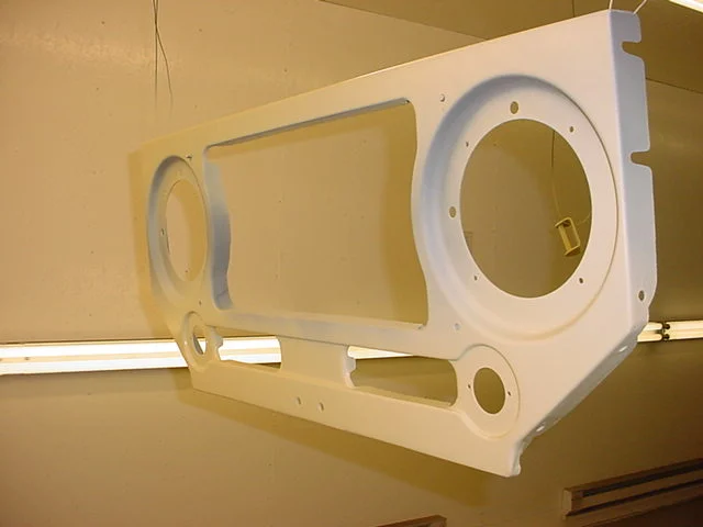

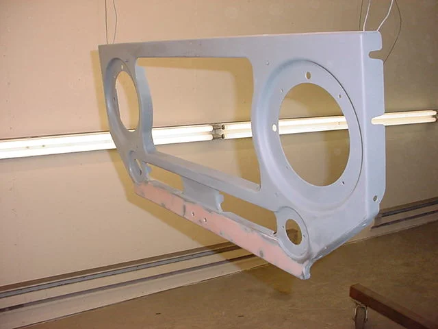

I got the bib sandblasted today. I had to weld in 2 patches, 16 ga. on each side about 1" x 5", where it just blew threw. I cut the patches to fit exactly in the rectangular holes I cut and butt welded them in. I ground the back and the front down after I welded them in. I then primed the inside of each piece, fit them together again with vice grips and plug welded them back together.
I used 36 grit on my air grinder and cleaned the face up and then sand blasted the back side to get some of the weld soot off. Hanged and epoxy primed the whole thing. Tomorrow night going to smear a little plastic across the bottom, block it out and spray some autobody master and the probably wet sand it out for now.
I think with that epoxy primer on the inside, I find it hard to believe it will rust in my life time. Wish they would have done something like that from the factory. After grinding the face off, I think I already have it smoother than it was stock. You could see and feel those spot welds on the lower part of the bib before I took it apart. A paper thin film of filler sanded down, should be better than new
Also, heading down the the iron store about an hour away on Thursday morning to pick up 2 - 4' x 8' sheets of 20 gauge sheet metal. I would like to get them DA'd down and sprayed on both sides with epoxy primer prior to cutting them up and using them. I guess that way there good to go when I start shearing and bending them up.
Matt

3 more

1 more

DO NOT leave DP50 un-topcoated for more than a week or so. you will have to re-shoot with DP50 again before you prime with a sandable primer if it goes longer than a week. I had serious adhesion problems with primer since I left it longer than the week. apparently it gets too hard after a week of curing and not alot sticks to it other than another coat of dp50.
looks great! seems like toyota had no ideas of the potential of rust when they designed the FJ45lv, and the grille.

You are correct on the top coat, DP has a 72 hour window to topcoat to achieve a chemical bond to the substrate. I will not be shooting the topcoat of paint (or primer if it needs it again) for several months on all the body parts that have been sprayed with DP, even the body. In this case you have to sand the surface prior to painting or priming again after the window has past. Normally a scotchbrite pad is sufficient, but each part will have to be gone over. Your not getting the chemical bond that DP was designed to do during that 72 hour spray window, but you will be getting a mechanical bond by sanding it.
It's just the way it has to be? I would prefer to spend a few extra hours several months from just going over everything and scuffing it up. I do NOT want to work with rusty, crusty parts so that's why I get all the parts clean and down to the bare metal and in primer.
On the chassis parts that I sprayed with DP, everything was topcoated with MTK within an hour.
Matt

Topcoating the dp50 right away is the only way to go... leaving it exposed around here has netted surface rust through in areas. I was not thrilled with it at all. and its so far from sandable it drives me crazy. I honestly tried the mechanical adhesion drill after the paint shop told me to get it topcoated right away, since I had let it sit for two weeks, and it did not work very well. just my experience.
Spies Hecker and others make much better bare metal primers/etchers.

I've never tried Spies Hecker, I'll check into that, I don't think anyone locally sells it though?
I've always had excellent results with PPG's DP line of primer, in fact from what I've used I would say it's the best I have every used. Doesn't mean there's something better out there, just my experience. I've also never had a surface rust problem or adhesion problem after sanding it again? I've let DP sit for months without rusting? I know where your at and the climate is pretty dry, seems odd it would surface rust? After sanding I can spray another coat of DP, I might have to do that anyway in certain areas.
It is just impossible for me to shoot a topcoat right now. I literially have months of work ahead of me before it can be topcoated, and that's working my ass off. Any don't get me wrong here, I like the input I don't know everything and am always learning.

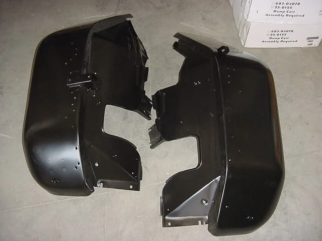

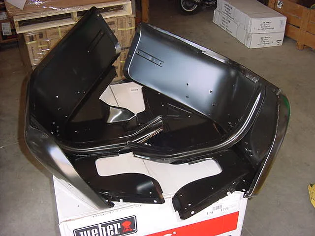

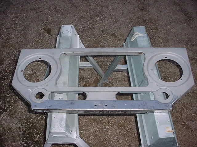

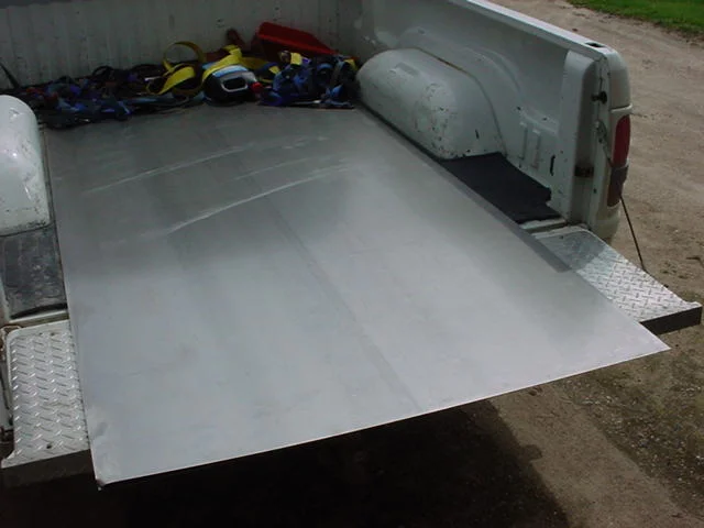

Look what just showed up
If I can get that front bib done might have to bolt on the front clip tonight for fun.

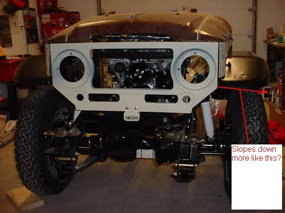

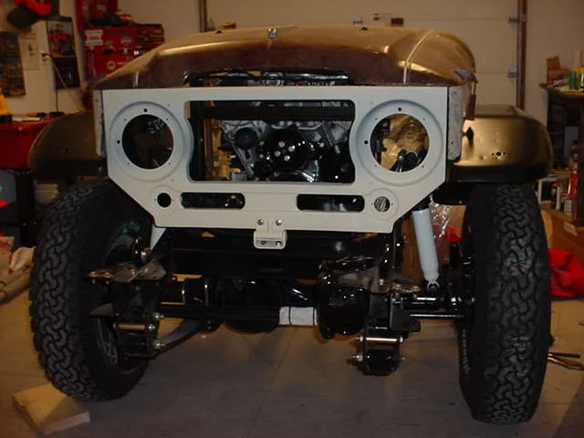

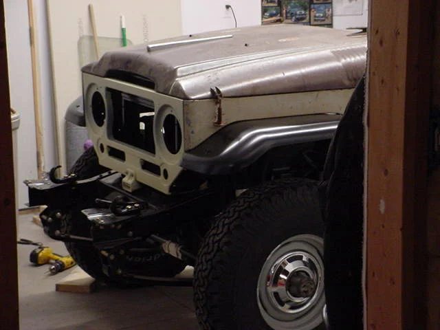

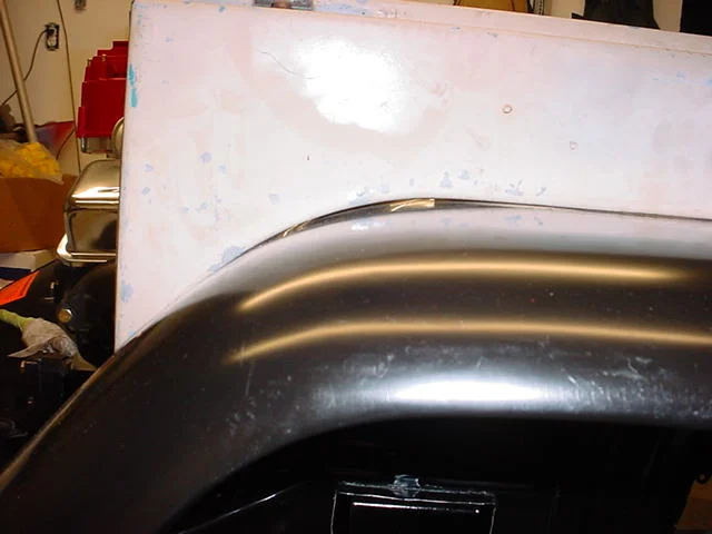

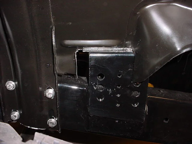

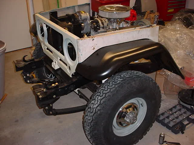

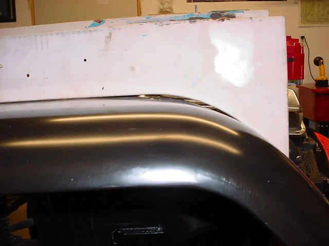

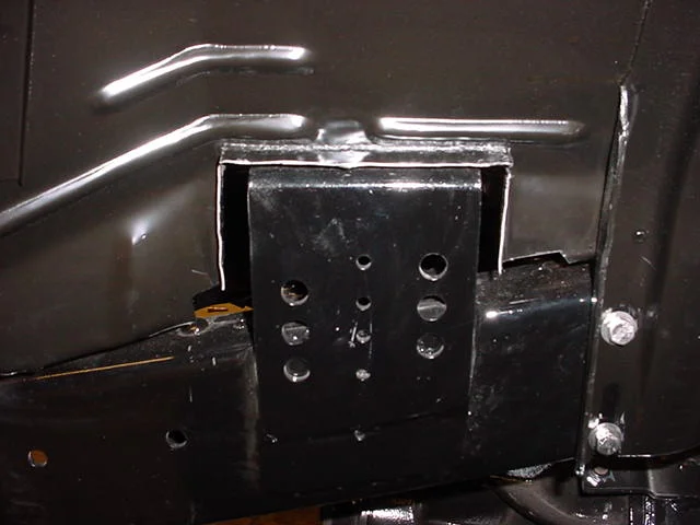

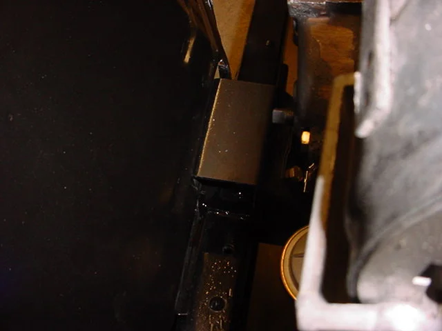

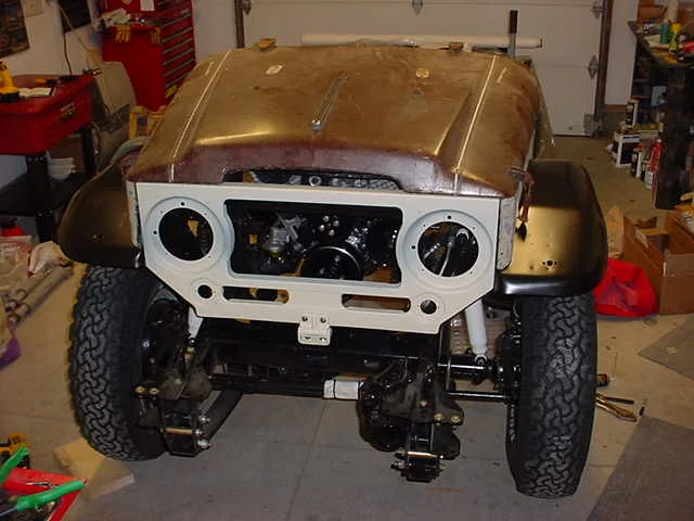

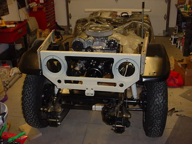

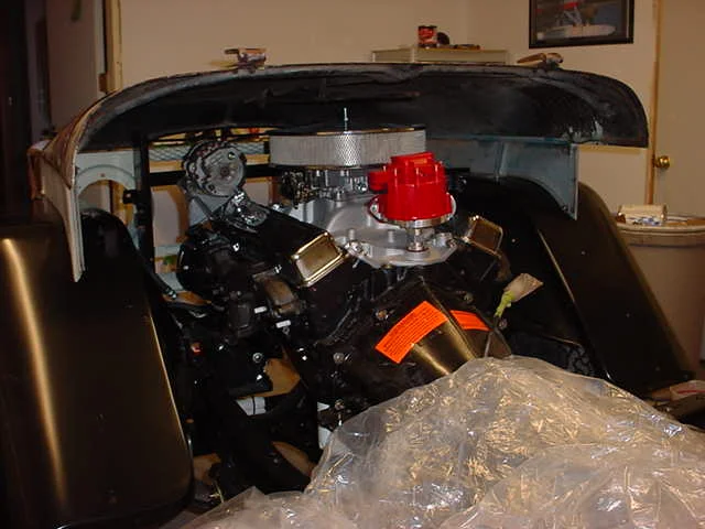

Got home last night and spread a thin layer of filler on the lower part of the bib and sanded it down. I think at the thickest point of th filler, probably 1/16", not to bad. Also blasted the lower bib bracket and sprayed everthing, with primer sealer.

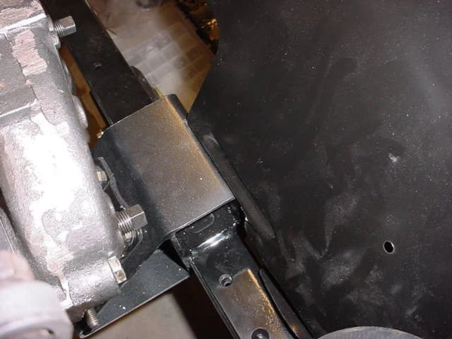

I had to do a little custom cutting and notching on the fenders. The Firestien motor mounts interfered with the fender. Not a big deal. I am not done with that either, going to notch a little more on the driverside, also have to hammer all my bends straight and clean it up, but you get the idea.
Aftermarket fenders............I've use aftermarket stuff before on other vehicles. I guess I thought they would fit a little better? I didn't expect them to be a perfect fit, but I thought they would have been better. I still have some massaging to do, but I did get all the bolts in and bolted up. I had to drill out 3 spot welds on the passenger side fender near the front apron curve. There was no way it was going to happend the way it was welded. After I drilled out those welds it fell into place.
I don't know how much I will get done in the next 2 to 3 days. I have to work late tonight and the wife has got me scheduled this weekend to make Concrete countertops for her new kitchen island......
Figured I better post some pics. Fun to see some parts bolted back on
Matt

more

more yet

even some more

more more yet

I am sure you dont want to hear it, but you will need some SERIOUS hours to get the fenders right. I must have spent 10 hours working them.
I would highly recommend ditching them now, before you have alot of time in them and are still frustrated. I think at least some years of OEM toyota ones can still be had.

Looking awesome.. Why'd you put the anti-inversion shackles on backwards?
Dunno why Paul puts that square ubolt in the spring kit.. But they have different stuff over there.. Curious.. Did the bushings that came with the kit now have any changes? He was trying to get closer to having a bolt on kit after I put mine on..

4 x 8 x 20 ga. sheet metal, 2 sheets. Let the fun begin!
Because I'm stupid, that's why I was hoping no one would see that until I got them corrected, I'm still stupid though.
I didn't look at the bushings in the kit that closely. I did notice that the flanges were to wide, so they would have to be machined down. I didn't measure the ID's either. So I don't know if they would have fit my shackles w/ a 9/ 16" dia. pin, I would doubt it though?
Matt

Quote:
I think I'm going to have to agree with you on the SERIOUS hours to get them to fit. I think it's going to take some major massaging to get them in. I spent a good 3 hours last night just getting the bolts in. In hind sight, I wish I would have spent the extra dollar and got the OEM ones.
I think at this point I'm going to forge ahead and keep beating on them, since I bought them and have them. I'm pretty sure I can get them to look decent. I may come to regret it though and not taking your advice?
Matt

The '6X to '69 fenders are different. They slope down away from the hood almost like they are melting. The turn signal mounting is different and the inner fenders are more angled. There is also the mounting tabs for the coil and windshield washer bottle on the new fenders. From the looks of it, the slope in from the front to back is also different. As a quick fix, you could source a set of '70s era aprons and make the new fenders work.

Quote:
I the coil and windshield washer bottle mounts I was planning on drilling out anyway, since I have the 350. The inner fenders being more angle shouldn't matter to me either.
I guess I don't quite understand, "Slope down away from the hood like they are melting", not seeing what you are talking about here.
How is the signal mounting different? Further in / out?
Are you saying the Aprons from a mid 70's to mid 60's are different in shape? I know they emblem holes are different, but I thought the overall shape of the side apron was the same?
Thanks, Matt

If you are looking at the front of the Cruiser, the older fenders slope down instead of being parallel with the bumper.
Pic
