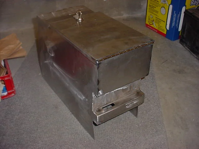

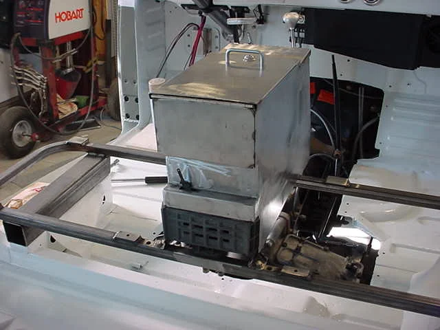

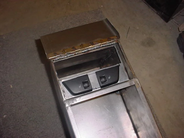

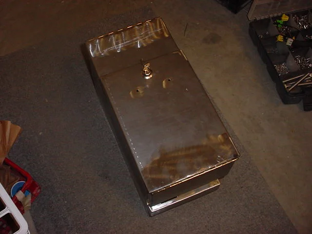

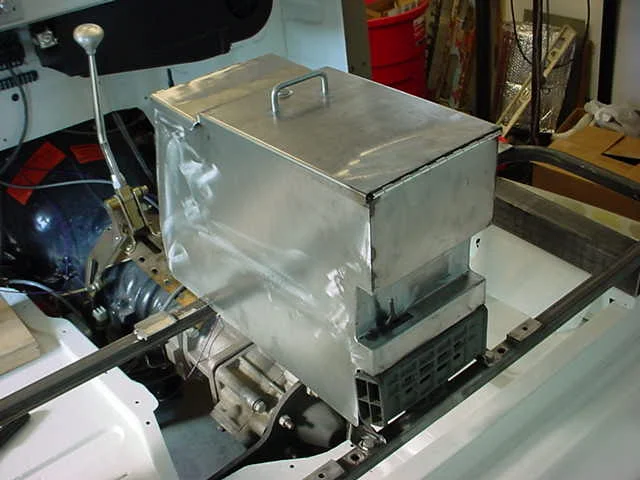

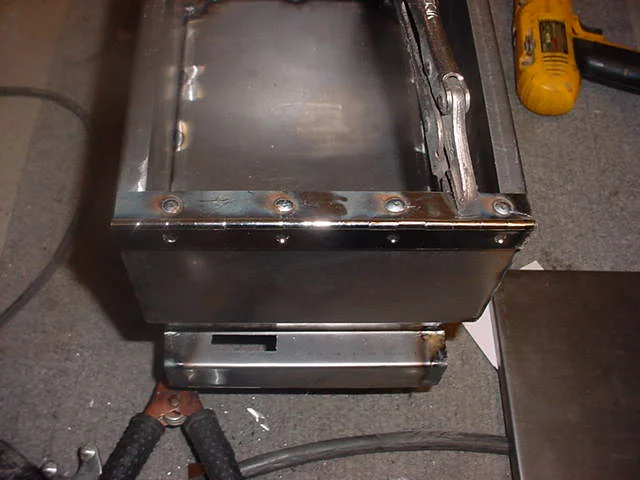

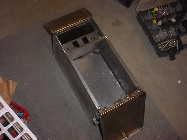

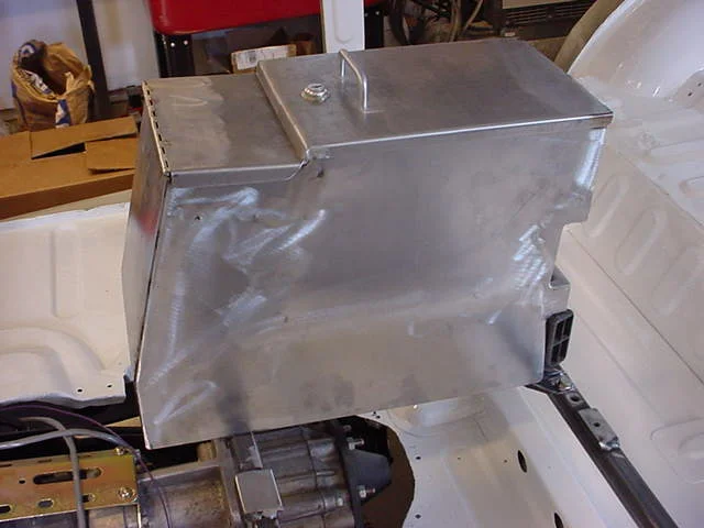

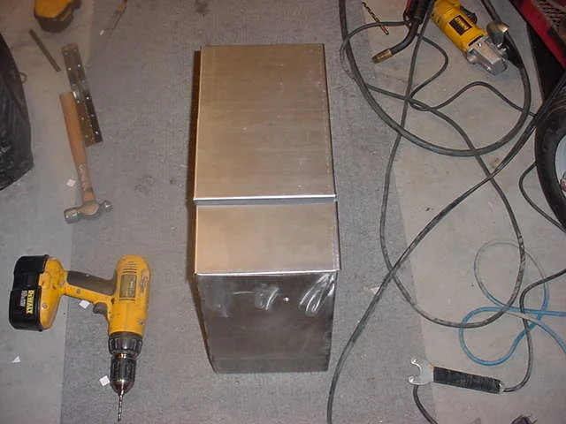

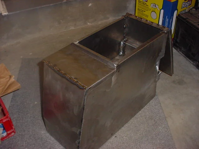

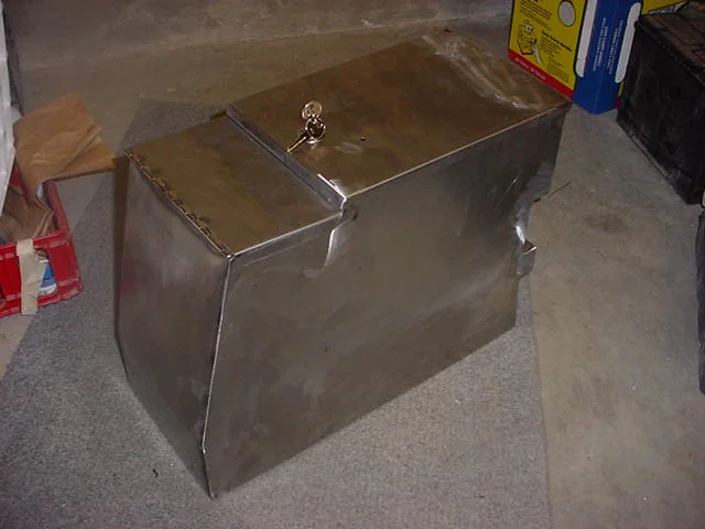

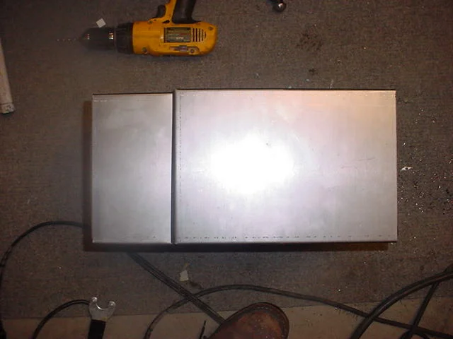

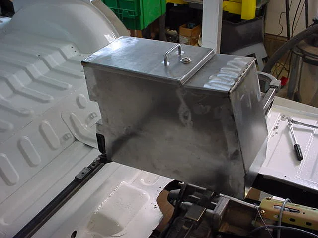

Got about 2.5 hours in on the lv tonight. Pretty much building the center console.
I bent up and welded in the radio area. I had to mark and grind out the areas for the radio and my 2 heater switches. I think you can see the heater switches popped in one of the pics. I don't have the radio installed for a trial fit, since I don't have it yet.
Made the 2 top pieces, 1 for the storage compartment and the one for the radio. I made the radio one like the tuffy, so you close that first and then the storage one, and then you can lock the storage one. Mine isn't as stout as a tuffy, but it's pretty good.
Hopefully should get the brackets welded onto the heater tomorrow and get that mounted to the console, then I need to fit it into the seat frame area.
Matt

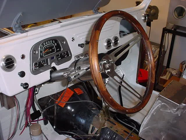

more

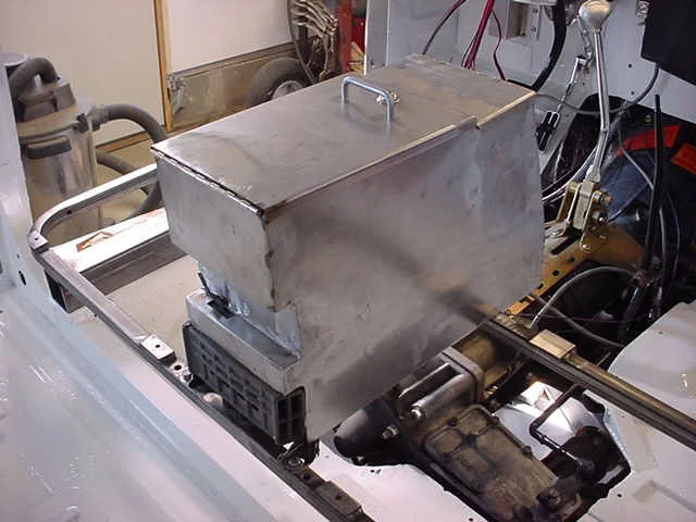

last 3

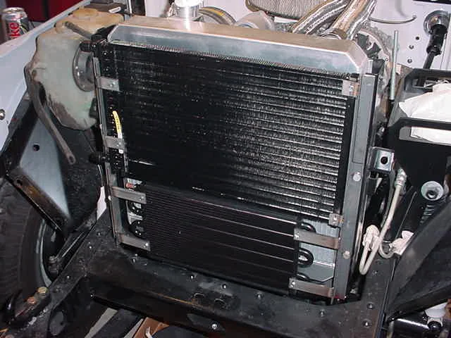

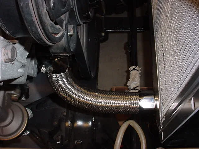

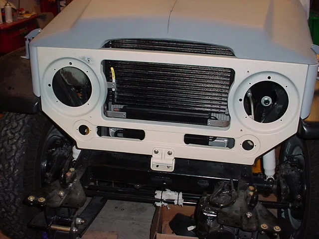

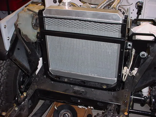

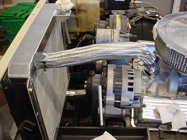

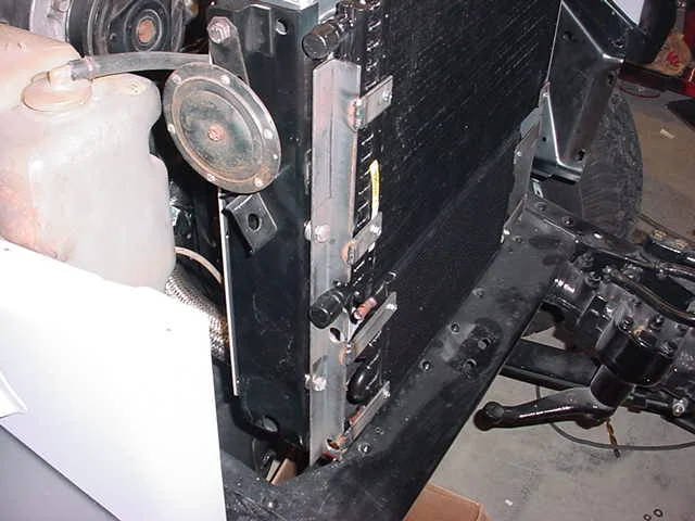

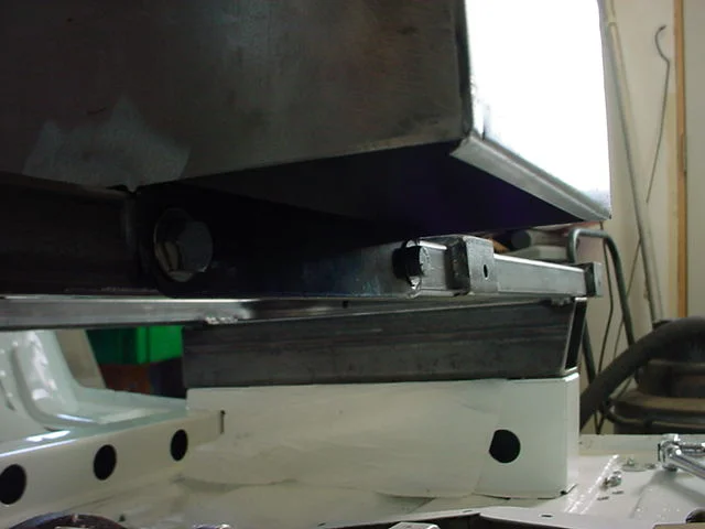

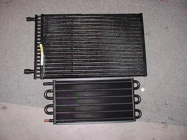

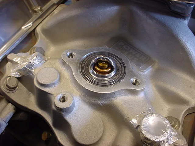

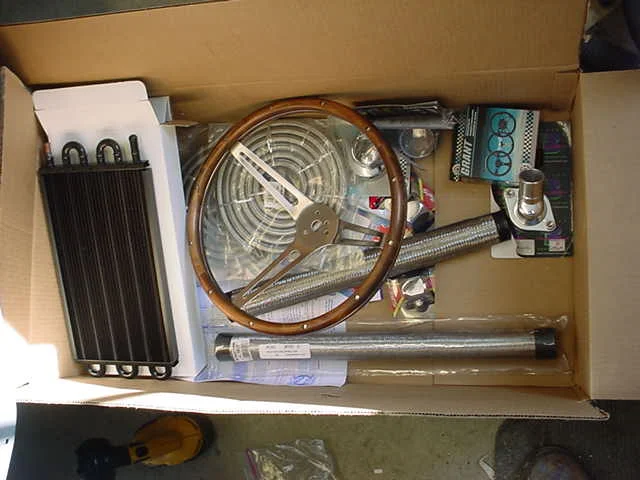

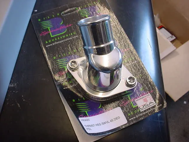

Got a solid 9 hours in on the lv today.
Started off the day by finishing my center console. The console was done, but I still needed to fit the heater in there. I had to make a bracket and weld to the heater housing itself. Then drill through the inner compartment and tap into those brackets, then bolt the heater in. Turned out pretty decent I think. It looks a little high, but I'm hoping will look correct when I get the seats in. I measured my CCOT console in my 40 before I started and it's the same height as that?
Earlier in the week I got a goodie package from Summit, more parts to make the motor go. As you can see, installed a few of those parts today, including the wood steering wheel
Also fabbed up a mount for the AC condensor and the tranny cooler. It's going to be tight, but should be enough room for the OEM grill behind the bib.
Hoping to do some sandblasting tomorrow and misc. painting of the parts I made today and some other stuff.

more

more 2

more 3

more 4

last 2

Matt, is the Rad support mounted for good? I have a Repro of the screen that goes across at the top if you want it.
Also a set of Hella Horns would look cool in the engine bay.
And I spent 4 hours staring into a media cabinet glass beading nuts and bolts........Just as much fun as seam sealing.....
Keep up the good work.
AATLAS1X is offline   Reply With Quote
Old 02-18-06, 06:49 PM   #1826 (permalink)
Site Addict

wow, that center console looks great!! are you gonna put a pad on top?

Quote:
Rad support is mounted solid. Screen is still behind the condenser, just can't see it.
Still looking forward to that care package
Matt

Quote:
Of course, gotta bust out the sewing machine again for that one! Probably be towards the end of the project, just not needed right now.
Matt

The wood wheel on the clear-coated column is major ...good taste, good build, good luck down the stretch!
