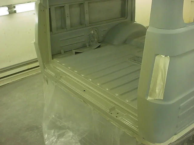

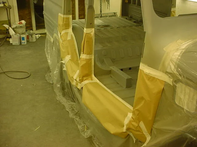

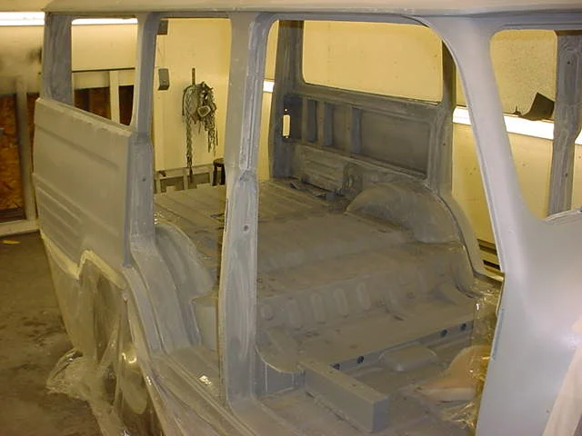

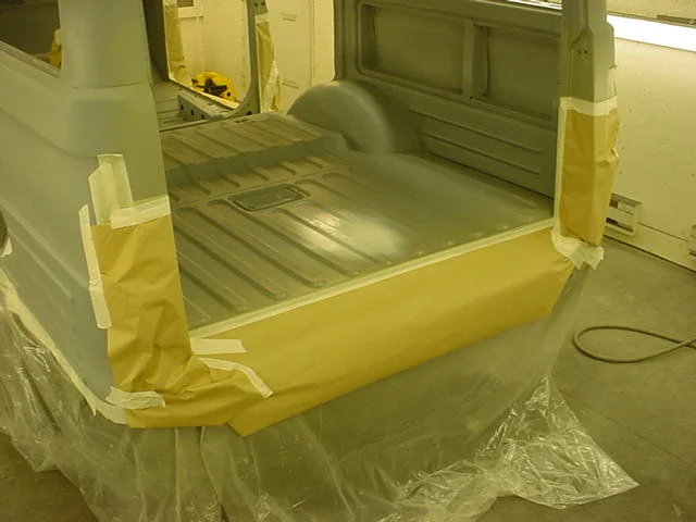

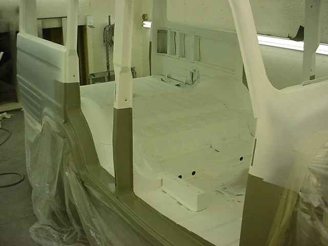

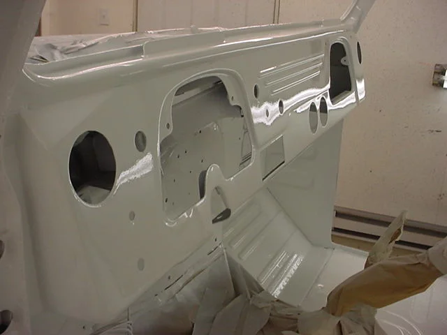

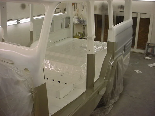

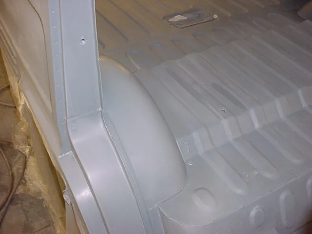

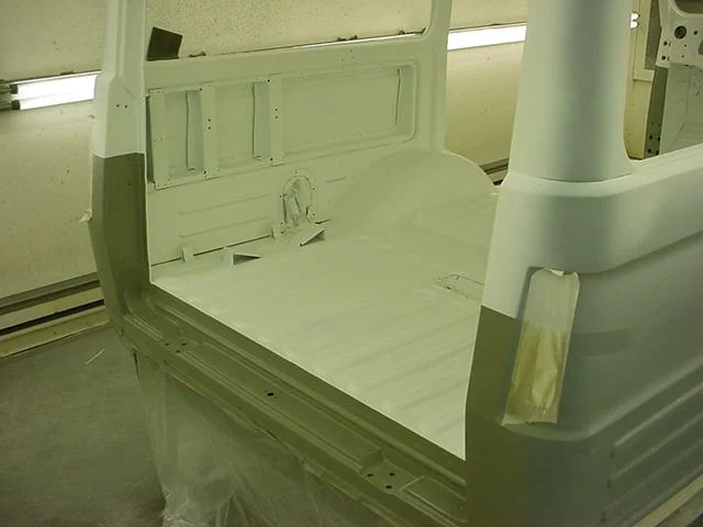

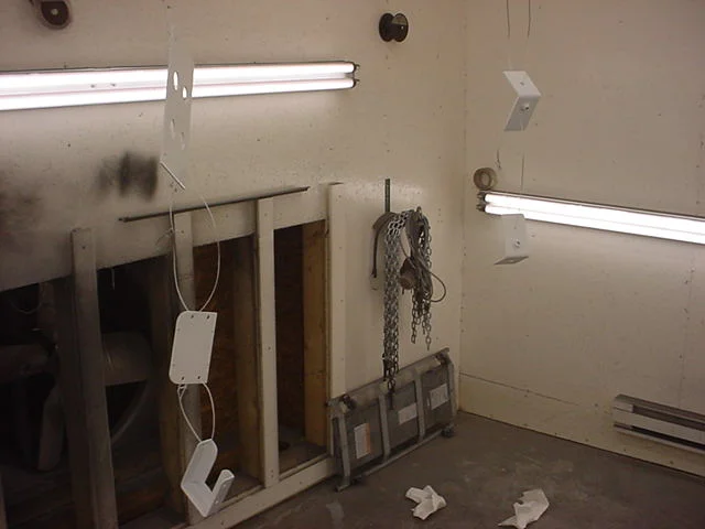

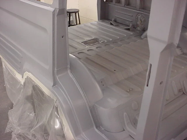

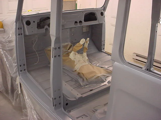

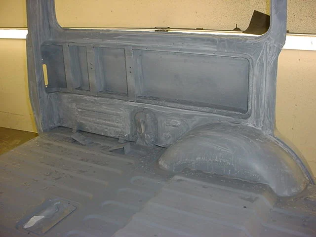

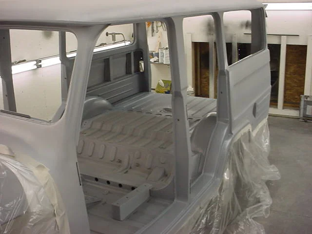

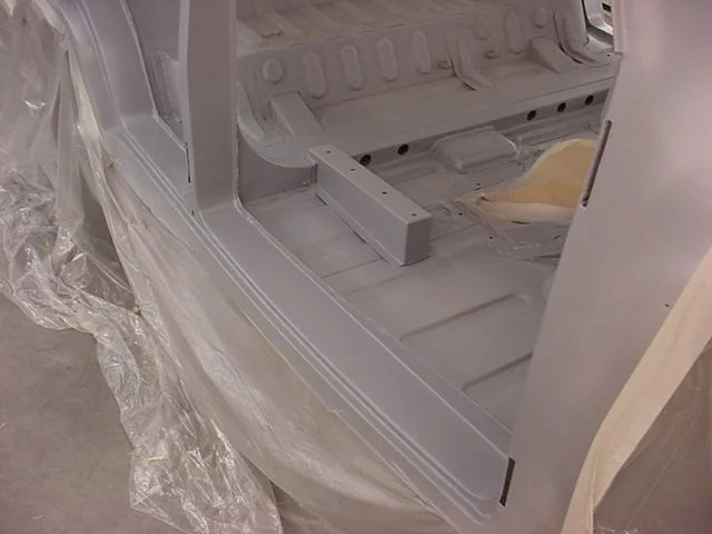

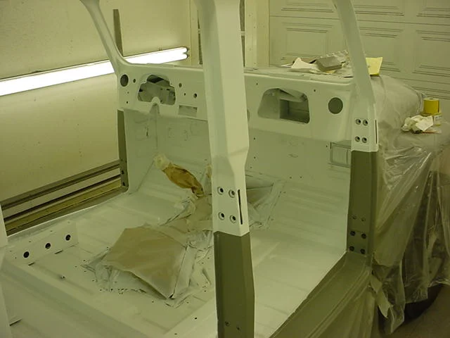

Little work on the lv tonight, not much. All I did this evening was shoot a coat of epoxy primer over the top of everything that I had previously sanded out, dash, jams, seam sealer, etc...
Also primed a couple other parts that are going to be white, shoot them white the same time I spray the inside.
Also brought up what was left of my windshield to the local auto glass guy in town. He said he could whip one up tomorrow, although no hurry. Going to order up 4 sets of windshield gaskets and keys from SOR tomorrow per/ LandcruiserJunky's recomendation for the windshield, side glass and rear hatch glass.
Might need that windshield next week Hopefully I will be wetsanding tomorrow, hoping to start shooting color on the inside in a couple days.
Matt

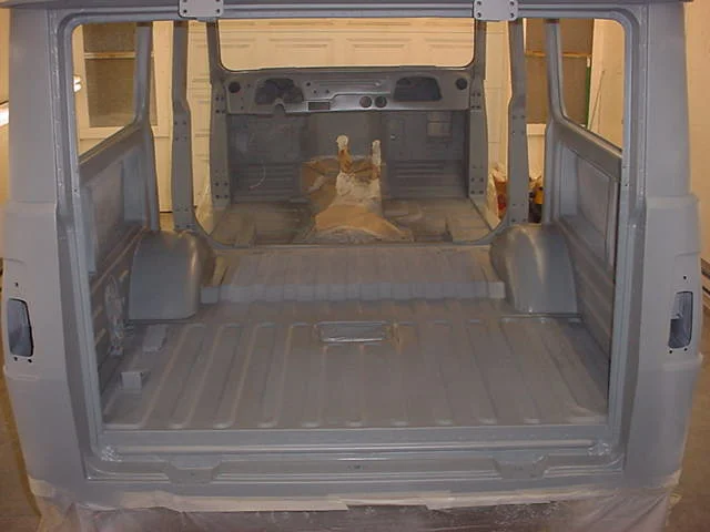

more

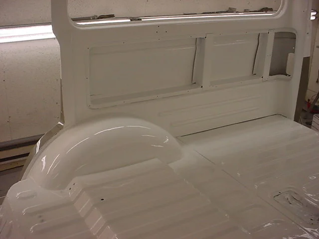

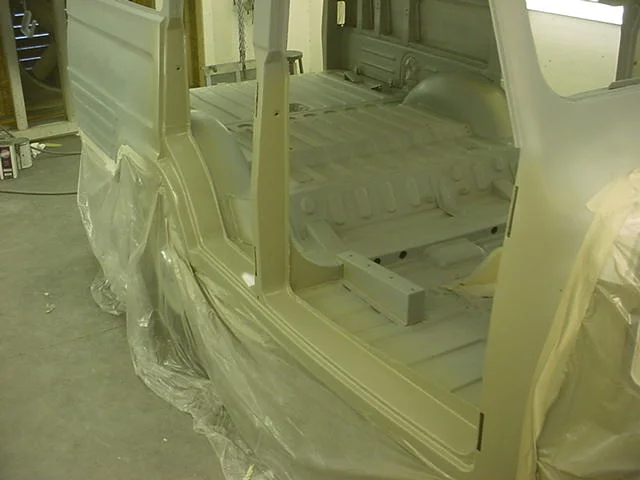

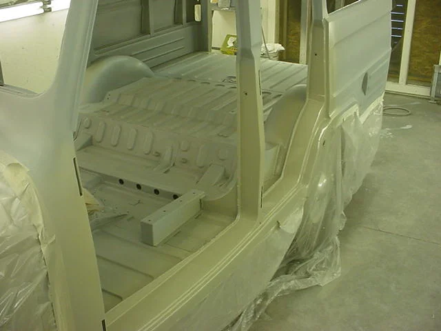

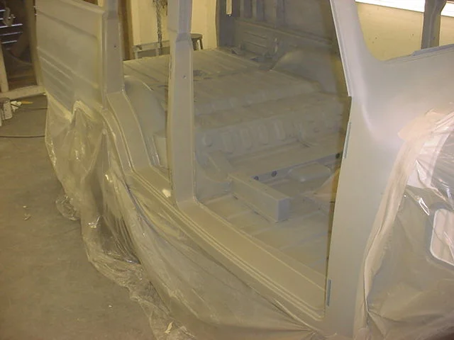

last 2

Damn I wish I had your skills Matt......
You are a bad dude....

Well at least I will be motivated (so I can see some color later) @ work tomm. (My first day back in a week, we had our second child)
Hope that made sense Looking good as always matt!

you gotta hang the old windshield on the wall matt! that bullet hole right by the steering wheel kinda freaked me out when i went to pick up the LV.

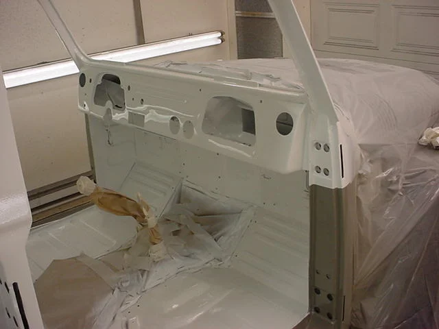

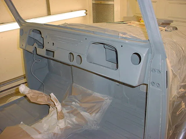

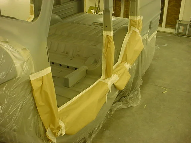

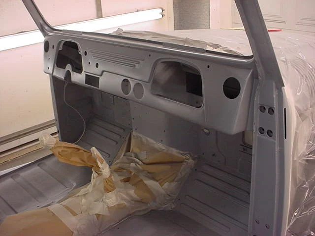

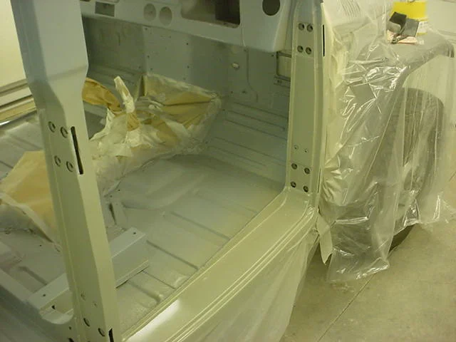

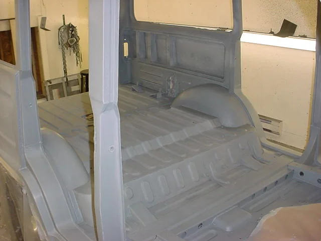

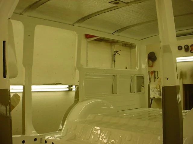

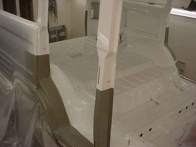

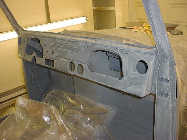

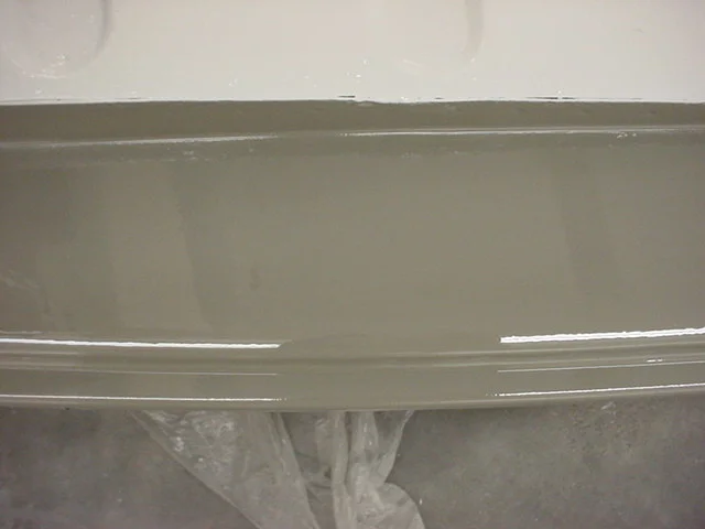

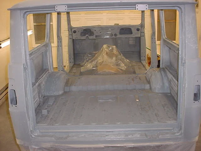

Got about 3 hours in on the lv tonight. My entire evening was spent wet sanding down the inside with 400 grit and then scrubbing and wiping everything out over and over with clean water.
Used the air hose and blew everything out real good and then wiped it down with DX330 and blew it out again. I plan on leaving work a little early tomorrow to get a start on painting. If everything goes right it should be base and cleared on the inside tomorrow night..........hopefully
Matt

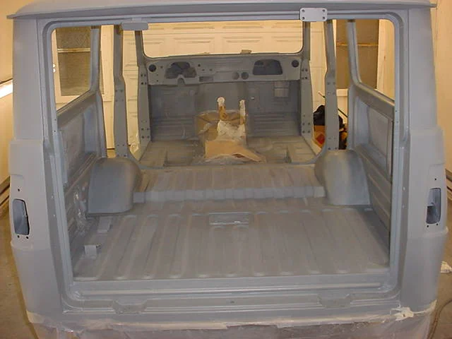

more

last 2

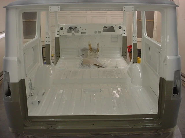

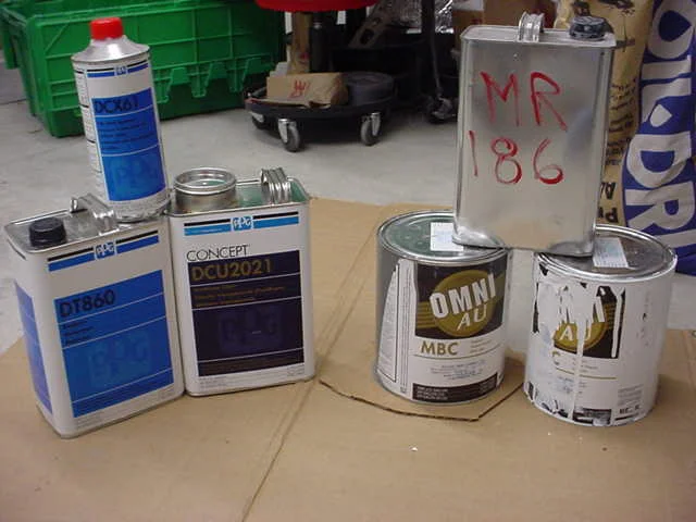

Small change of plans.....I will be spraying the dark color first and then the white. I just spoke to my body man buddy and he said to spray that first.
Because theres less to spray and back tape he recomended spraying that first. He also said the I would have no problem covering the dark color with white. He said the only color that would give you problems when you tried to cover it with white would be red....it would turn pink he said.
Matt

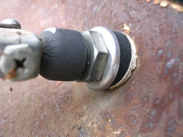

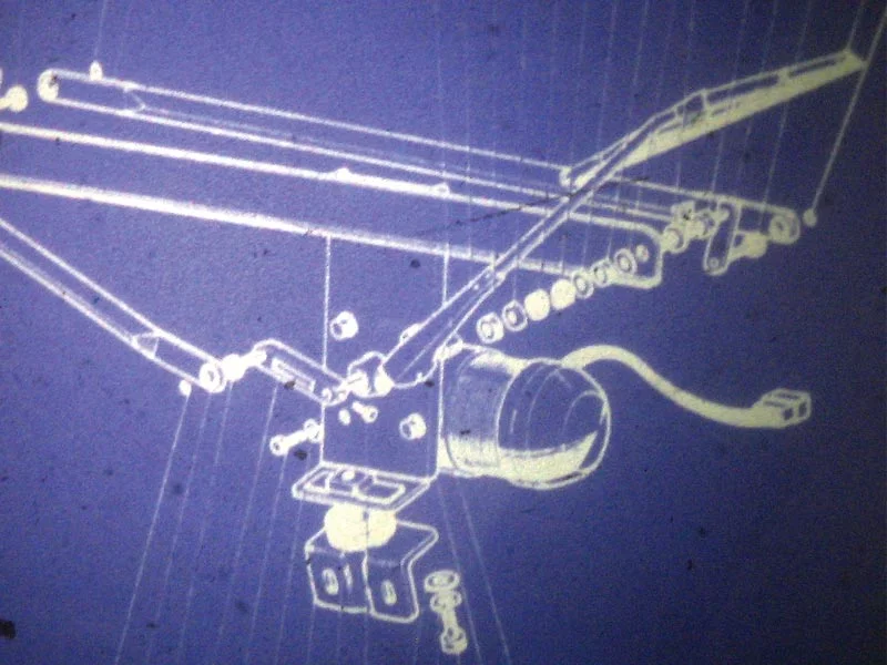

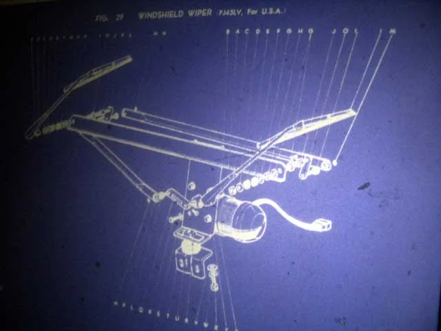

I will take a pic of the parts I have, but I need to know the order of how they go on the shaft, what's in front of the windshield and what's behind also.
Thanks, Matt
wipers, blue is 66, rust is 64. I couldn't get a shot behind/under the dash.

Quote:
And the inside
Matt

You had to make me get out the microfiche reader didn't you?
On another note....I have a microfiche reader
So far I have the fiche for 65 and 67 FJ45LV (V). I need to find a 64 though.
I have a microfiche reader also But, I might be installing this stuff this weekend so this is better.
You are one sick puppy Mike for having that on hand
I am still glad you have it, should work !!

Got a lot of time in on the lv today and tonight, and got the inside jammed
Left work around 2:30 and I was spraying the first color by 3:00 pm. I just finished about 10 pm tonight, so a solid 7 hours painting, long hard work.
Needless to say, I think it turned out extremely well, very happy with it. I'll let the pics do the talking, have quite a few tonight. Let it dry all night and tomorrow and might be doing some assembling this weekend?
Matt
