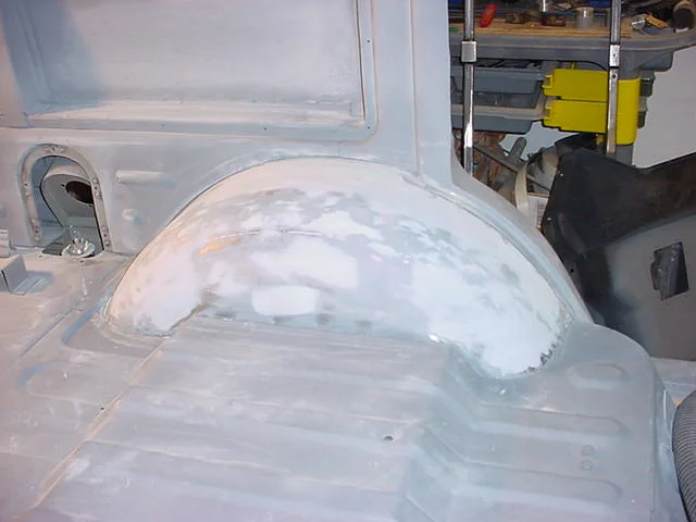

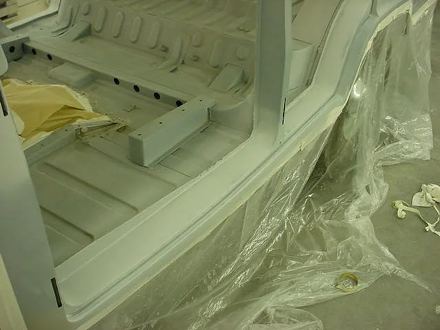

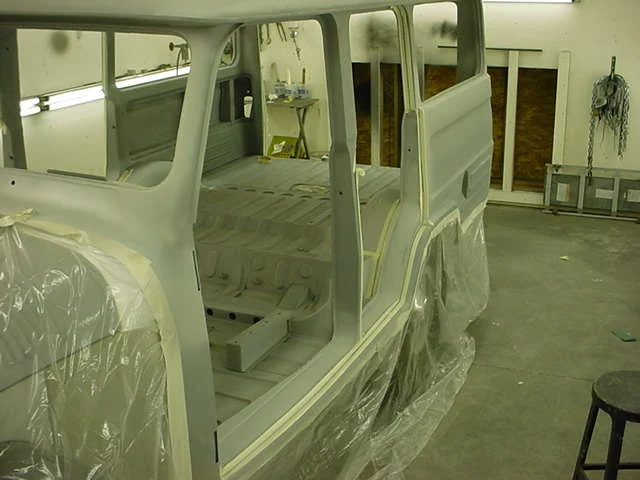

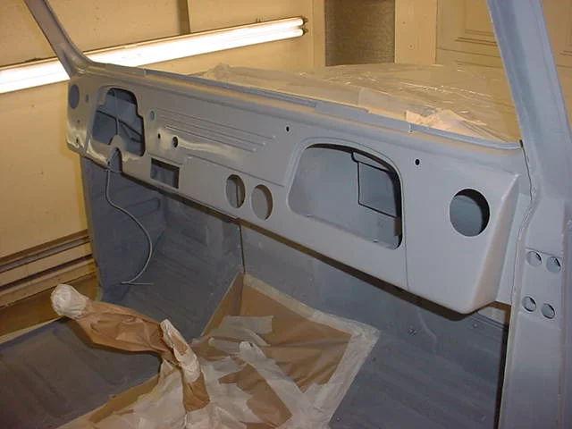

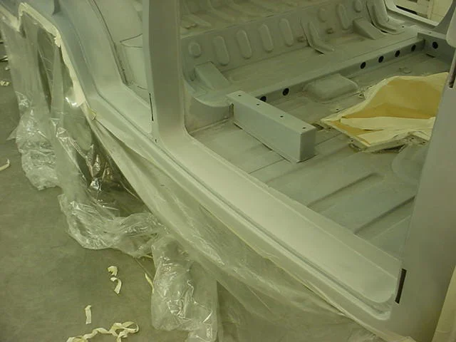

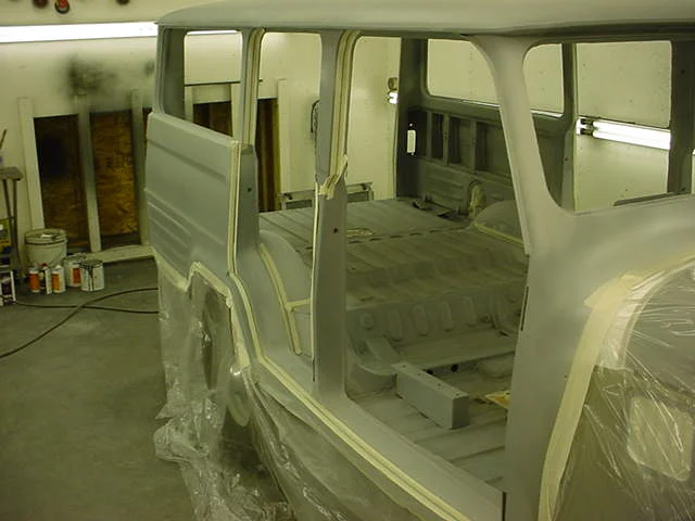

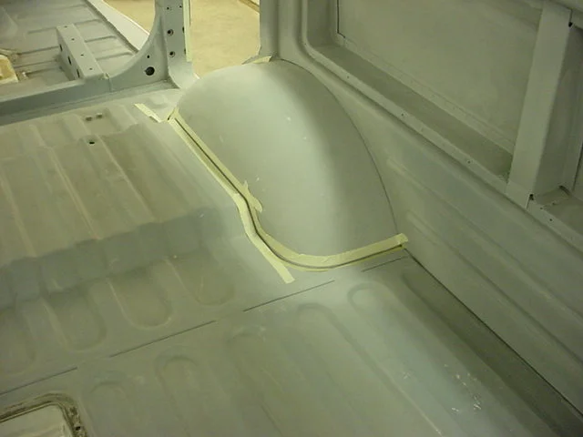

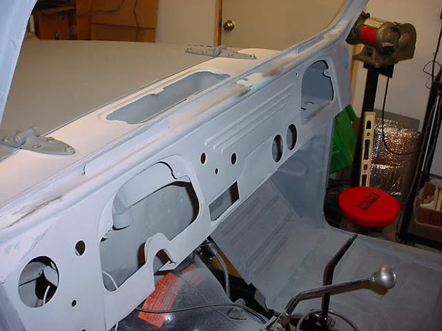

Not much done tonight, didn't try that hard this evening
Sanded on the inside a bit, worked mostly on the dash. Smeared a little glazing on a few of the un-even spots. I want to point out that the un-even spots were orginal un-even spots. So I'm not leaving the dash original, I'm making it straight. Little un-even at the top and along the outside edges, must be where they welded it together from the factory.
Not sure how much is going to get done tomorrow, probably some more sanding in the evening. I kinda told myself I'm going to take a break, put the skis on my airplane and go do some low level re-con out over the lake

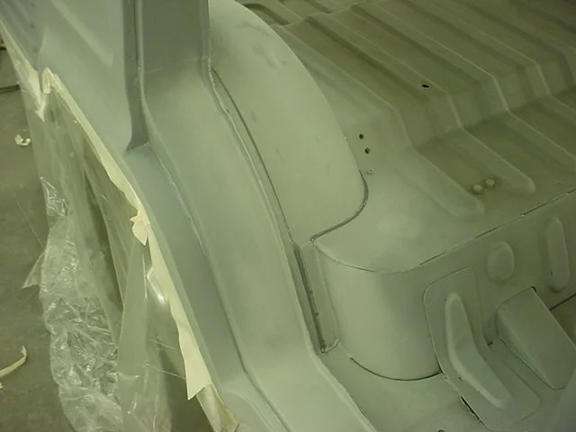

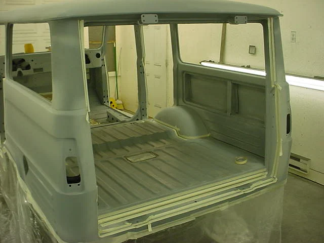

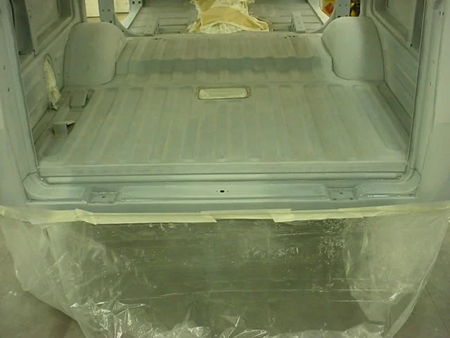

Gotta a couple hours in on the lv today.
Not a whole lot, pretty much more anal retentive type stuff. I said I wasn't going to do it, but a spread some glazing putty on the inside of the wheel wells and blocked them out. The wheel wells were pretty straight, but a little dings all over them from over the years. I guess I thought what the hell, it's paper thin and didn't take to long, so there smooth now. Still will have to get primed and sanded a couple times, but should look pretty nice when done.
The majority of my day was spent what I said I was going to do.......flying!! Had to get out to the airport early and do some shoveling, then another hour or so to get my skis on. Gotta a solid 3 hours flying and much needed, it had been a while. Flew up to one of the resorts on the lake and had a bite to eat, it was great!!
I'm going to have to make up for that tomorrow and see if I can kick ass on the lv

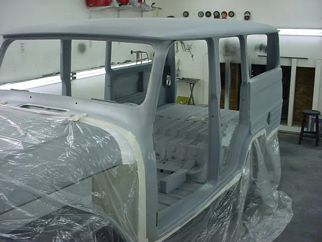

last 3

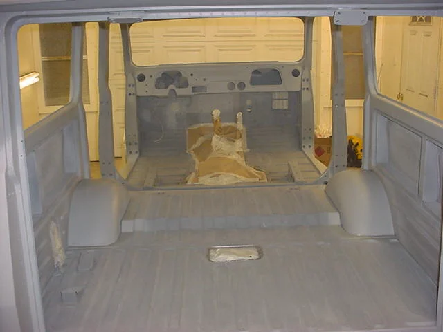

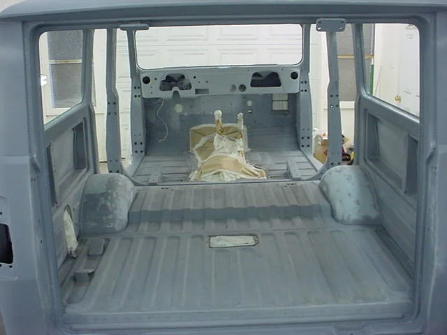

Few more hours on the lv today, might even do a little more yet, not sure
Pretty much waiting for primer to dry until tomorrow to sand out, so not sure what I will be doing the rest of today. Got up this morning and pretty much just did little tweaking here and there around the body, sanding, making sure everything looked good. Drilled the holes in the rear sill for the taillight switch.
Pushed it out into the paint booth, spent a good hour getting everything taped up. Shot ureathane primer on the wheel wells and a few other areas I plan on sanding out at least once, if not 2 more times.
Sand more tomorrow and prime again.
Matt

last 2

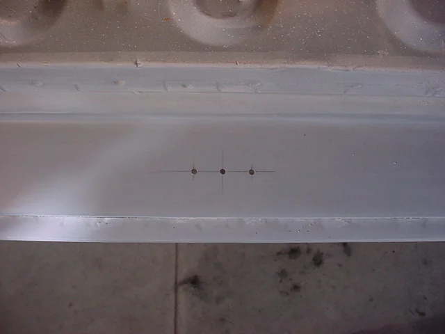

Got about another 3 hours in on the lv tonight. Not much to talk about. I spent the first hour just sanding out a few areas I had primed yesterday. The wheel wells, dash, couple areas in the door jams....
Then I spent a good couple hours masking off and seam sealing all metal edges. Took some time, but looks nice and shouldn't rust.
Not sure if I will get epoxy primer on the top of the seam sealer and a few other areas tomorrow or not, might have something else going on. If not tomorrow, the next day. Then the plan is to wet sand out the areas that are seen like the dash and sides. And then shoot color, hopefully should be white by the weekend?
Matt

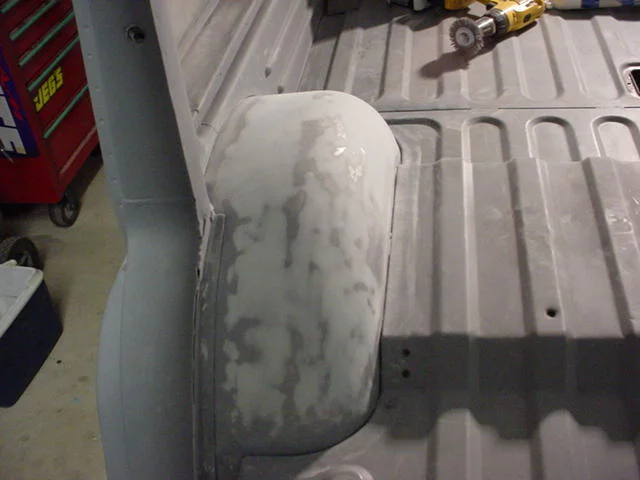

more

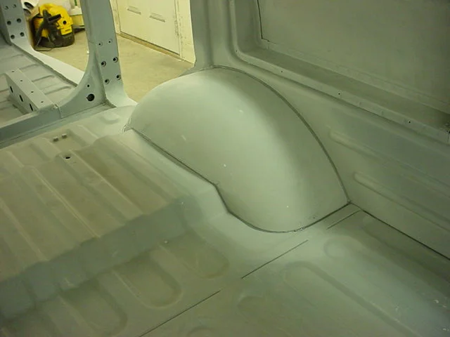

last 3
