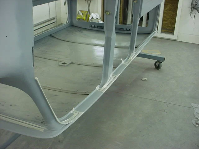

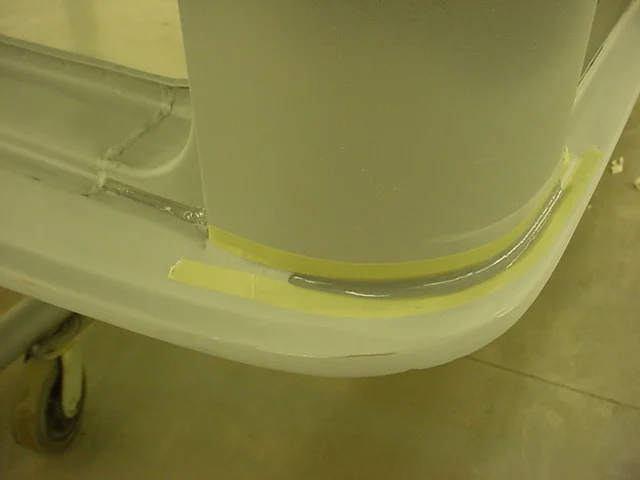

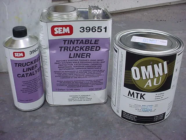

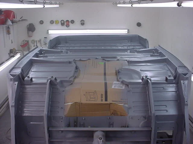

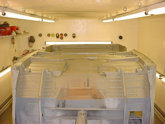

Again, doesn't look like much, but a solid 4 hours tonight on the lv.
Most of the evening was spent finishing seam sealing, that was at least 2 hours if not more. I can say with almost certainty that after undercoating, I think the lv will float now, it's that tight. I then spent a good hour or more and sanded the bottom down with 80 grit, takes a while to get in all those grooves. Then spent the remainder of the night and bolted up card board to the tranny opening and a few other spots, getting ready for undercoating.
I did call SEM today and talk to the tech guys. The recommended NOT spraying a single stage ureathane on prior to there product. They said maximum adhesion would be achieved going directly to primer. I guess I'm proving that on my 40 after 2 years, that's directly on epoxy primer and has held up amazingly well.
So, plan is to get up tomorrow morning. Spray a coat of ureathane primer around the bottom of the drip rail first. While that's flashing off, back tape around the pinch weld at the bottom of the vehicle. Shoot a light coat of epoxy primer over the seam sealer (which they recommended doing) and a couple other areas. And then spray some sauce on the bottom.
Be interesting to see another color other than grey

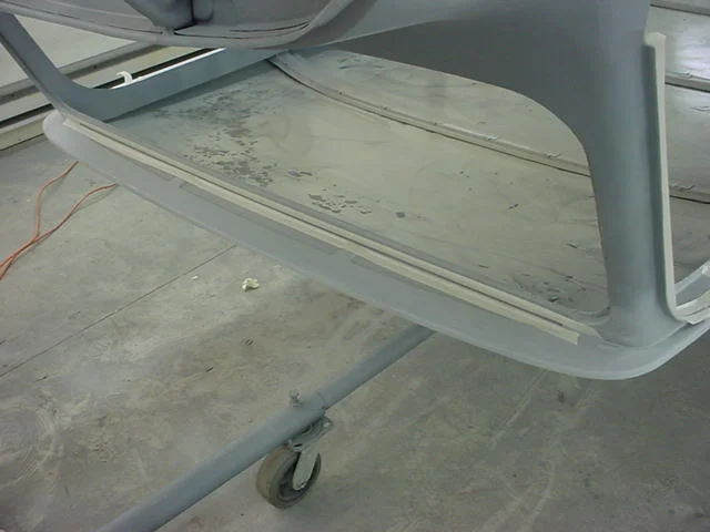

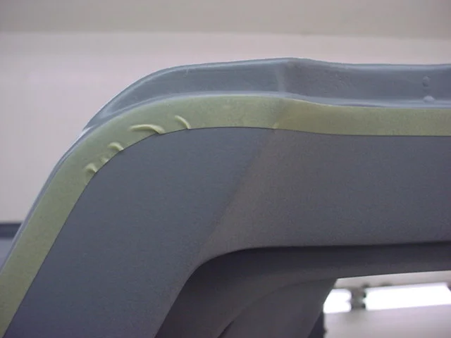

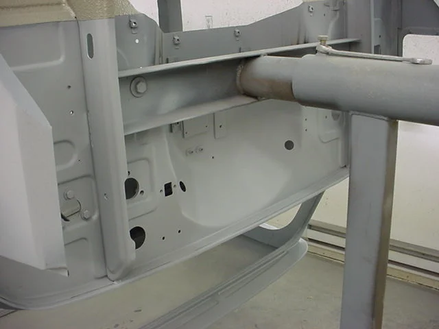

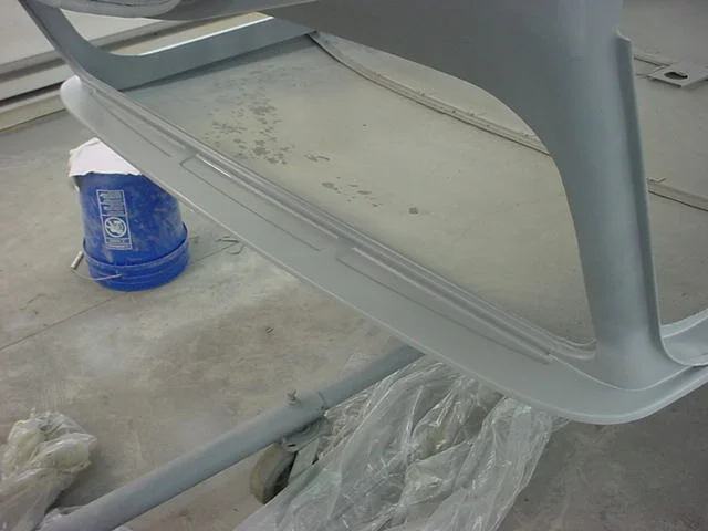

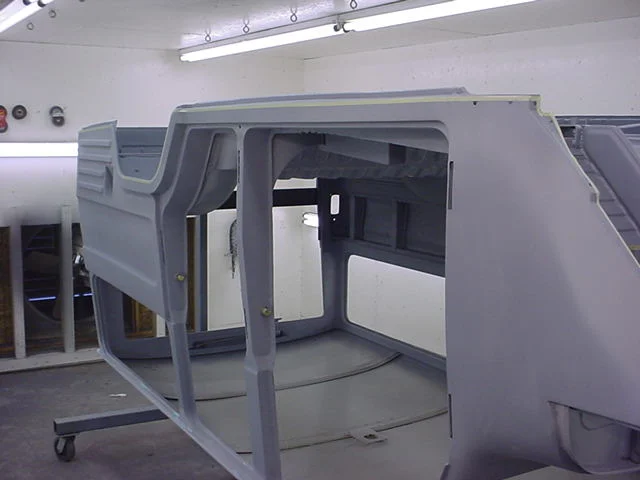

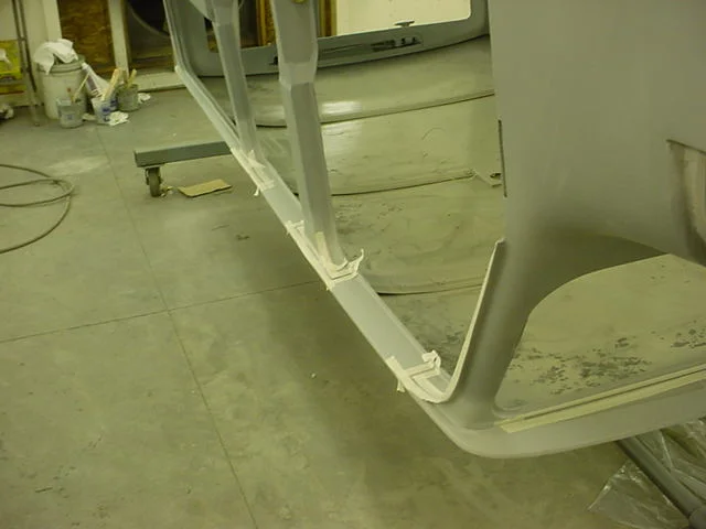

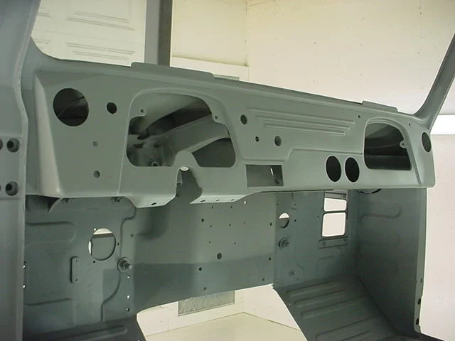

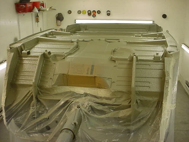

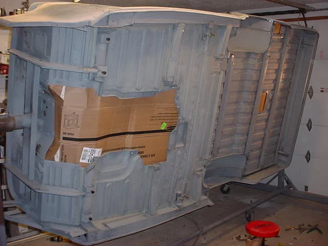

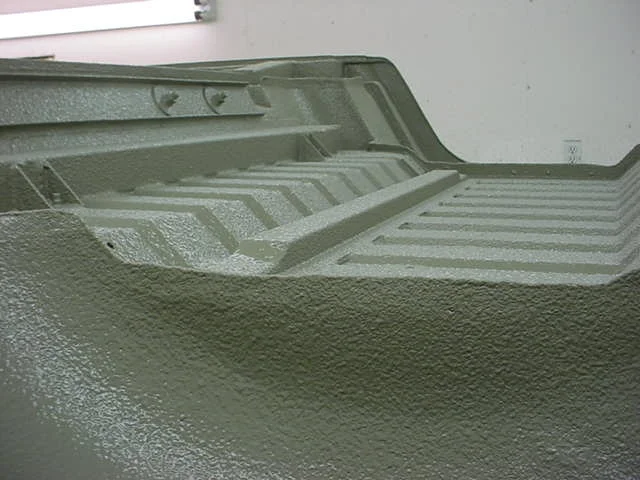

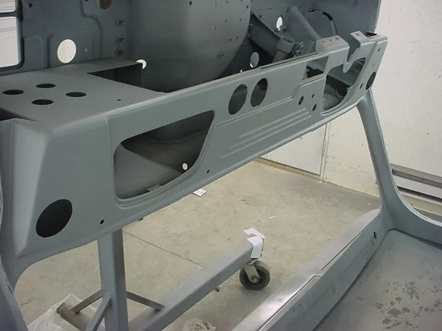

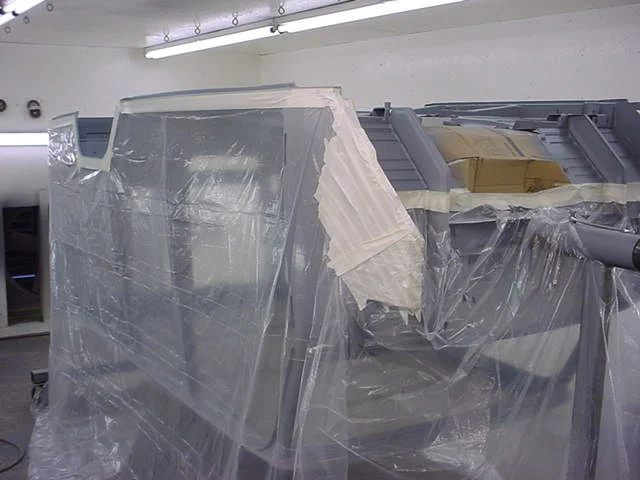

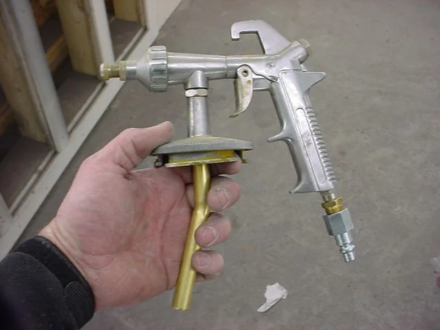

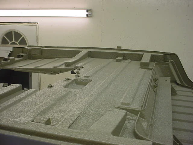

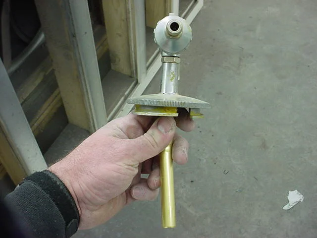

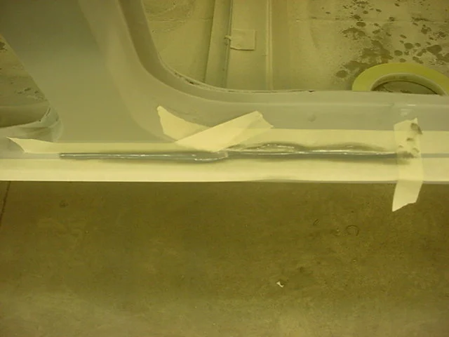

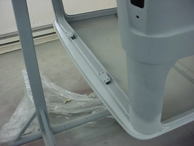

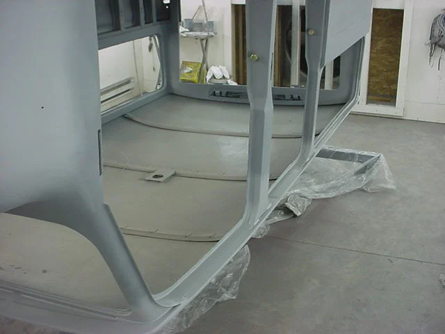

Pretty good day on the lv today, got what needed to be done.
Shot ureathane primer on the firewall, dash and under the drip rail. Of course they will all have to be sanded out a few more times, but all look good.
Taped off the edge of the body with fine line tape, few pics of that. Then had the wife come out and help me tape the rest of it off with plastic. Took a few pics of the stuff I used. The SEM tintable bedliner and the catalyst. Also the tint, which is MTK singel stage ureathane with out the 149 binder, which is basicly just the toner or color. I asked the paint guy for a gallon of continetal beige, but leave out the binder, he looked at me like I was nuts. Amazing how much binder is in there, without it, it's a little over a quart of paint.
SEM stuff went on good, I used about a gallon and a half of material. The other half gallon is going to be used underneath the front fenders, should be plenty. I think I'm postive the LV will float now. I don't know how I could rust proof it anymore, so.....bring on the road salt!
Probably sand down the drip rail, dash and firewall tomorrow and spray another coat of primer. Not much to do, but that's ok.....my buddy Heavylift (Travis) showed up today, just got back from Iraq. I went out and helped him pick up his BJ40 at the airport where I had it stored for him. Hauled it out to my place, he should be starting on it tomorrow or Monday. That should keep me busy now for the next couple weeks.

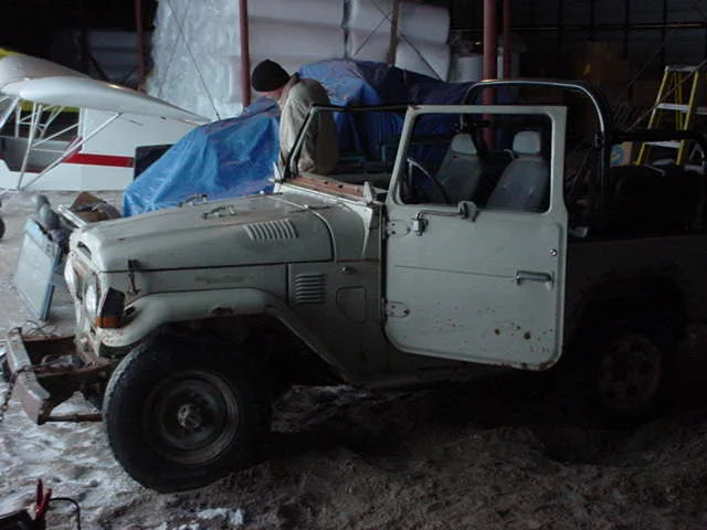

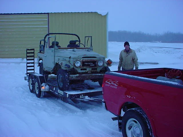

Buddy Travis (Heavylift), helping him load today
Matt

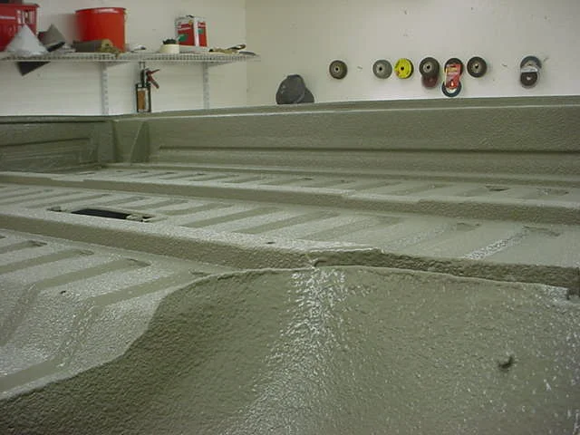

With Gator liner I used less catalyst as the stuff setup real fast, almost hardening in the gun.
I tinted with the paint, later thought about having it tinted at the store with the tinter instead for a more bang on colour match.
I topp coated at the end with paint to colour match.
Made for a great sound deadener also, and I new the wheel wells would not see stone chips as the stuff is real tough.
We dynamatted the floors and the truck is pretty darn quiet now.
Looking good Matt..........

Thanks on the compliment, I think it turned out real nice.
This stuff has about a 20 minute pot life, so you need to work pretty quickly also. I tinted the resin first and then just kept catalyzing a quart at a time, went real good. I had my helper moving the stool and hose around as I was spraying, also held the Shutz gun open when I poured it in so it went faster .
I think for the most part it matched perfect, it should, it is the same color.
I've also got my carpet padding that I ordered when I order my upholstery. It is about a 1/2" thick with a silver foil bonded on one side for heat. I think that along with this undercoating should keep it pretty quiet in there...........I want it to be nice because I'm debating on driving it out to Cruise Moab 07
Gotta get it moving first thought
Matt

Pretty decent day on the lv today. Had some more significant snowfall last night, so had to fire up the plow truck for a few hours of plow duty this morning.
Pretty much got out there and sanded down the entire drip rail all the way around. Also blocked out the dash and the firewall again on the engine side. Sprayed another coat of ureathane primer, let it dry all afternoon. Went back out this evening, same program........Sand, coat of primer.....
Actually looks really good right now. I think I'm going to sand the rear drip rail and that might be it. Pretty happy with the dash and the side and front drip rails.
I have to pick up another tube of seam sealer tomorrow for underneath the drip rail in a few places, but I think it might be back on the hoist on Tues. or Wed.?? We'll see? Probably will be on the hoist for 3 days while the firewall gets blocked down a few more times after I clean up where the rotisseri was. Then I have to base/clear the firewall on the hoist before it goes back on Whoo...looking forward to pretty white paint on the firewall......
Matt

more

last 3

Oh, one other thing..... While paint was drying this afternoon I helped Travis tear the front clip of his BJ. About 3 hours, pretty good start. I'm thinking he should have the body off tomorrow.
Matt

Oooooooh, thats like a seameless skin on the underside to keep it from ever rusting again.
Looking forward to Heavylifts build also.
Rob

I sure hope so
That skin along with the seam sealer, should outlast me.
Matt

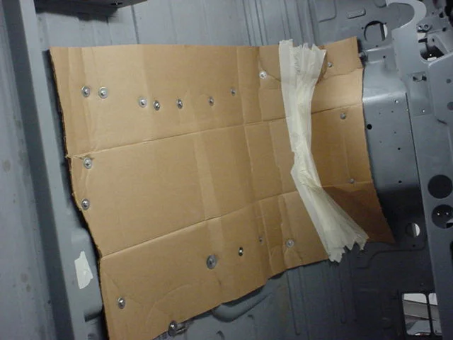

Got a couple hours in on the lv tonight. I was trying to hustle up tonight and get it back on the hoist tonight, but that didn't work out. I got back home after work tonight and someone was tearing apart a BJ40 at my place and I just had to get involved for a couple hours
Pretty much just block out the drip rail one more time with 180 grit. Then I wanted to get some seam sealer on all the exposed seams. My body man buddy gave me his tip of the day for seam sealing where you can see it. Run masking tape the width of the area you want it first. Then apply the seam sealer, run you finger through it and pull the tape at 90 degrees to the surface right away. Man, that worked good. I think after the priming you can see how it looks.......and it won't rust
After I got the seam seal on shot a couple light coats of DP50LF epoxy primer over the top. Also wanted to seal up the ureathane primer. Should be ready to wet sand now when I get ready to paint.
Might get back on the hoist tomorrow, we'll see if I'm playing with anymore 40's first though
Matt

more
