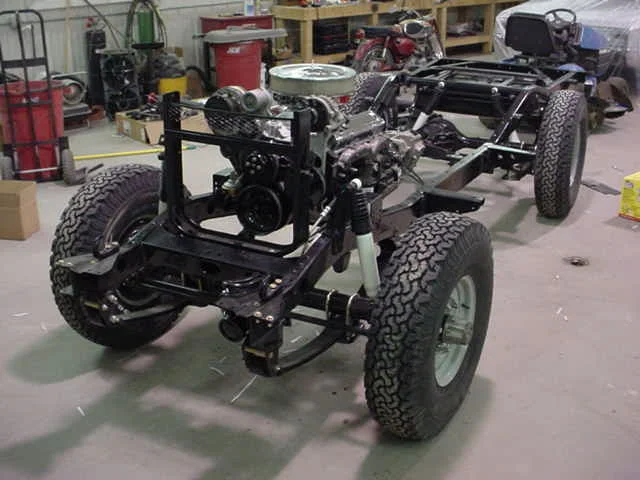

That looks sweet, you don't want to run Warn hubs on such a nice build, locate some Aisins.

I agree, I didn't spend a lot of time cleaning up the warns. If some Aisins become available I will pick them up.

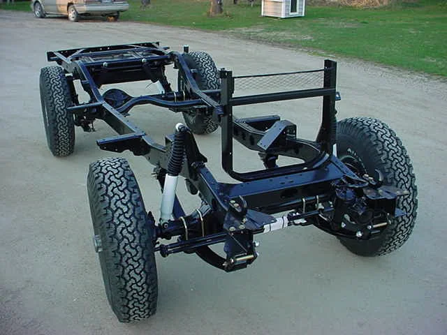

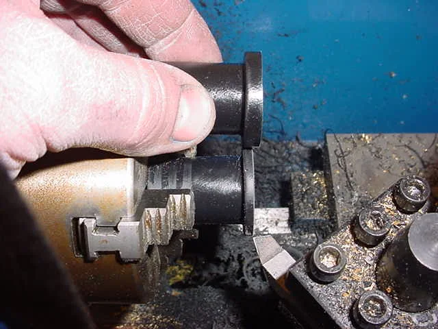

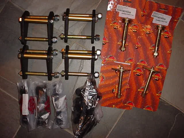

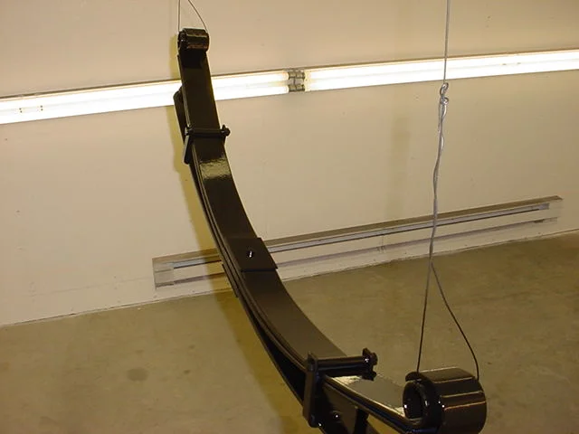

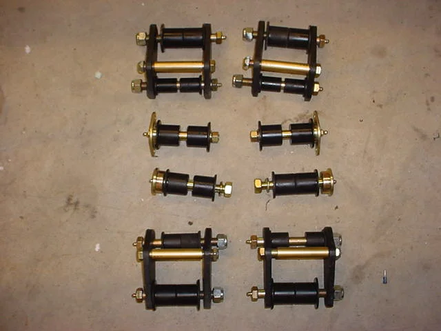

I got my bushings and pins from SOR on Friday. Shackles showed up today via USPS.
Problem , SOR sent 4 - 289-45 B-A bushings, when it should have been 289-45 A-A bushings. The packing list says 289-45 B-A, and I'm sure I said A-A, in fact I asked if I could repeat the parts list back to him?
I'm going to have to call SOR on Monday and have blue labeled to me so I can have them Wed. I'll see if SOR will step upto the plate and take care of it as far as shipping, but I doubt it. Since there's no way to prove that they made the mistake?
I've had problems with every cruiser parts supplier out there, except Kurt and Cruiser outfitters? I'm beginning to think it's me? Just seems like a never ending cycle of delays and screw ups.
Anyway, enough venting, I will be ordering parts either way on Monday.
Matt

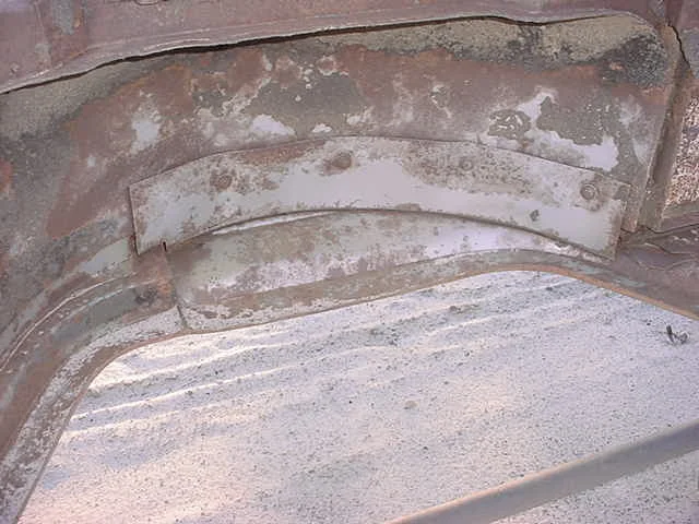

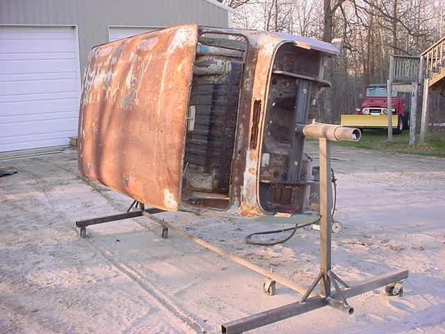

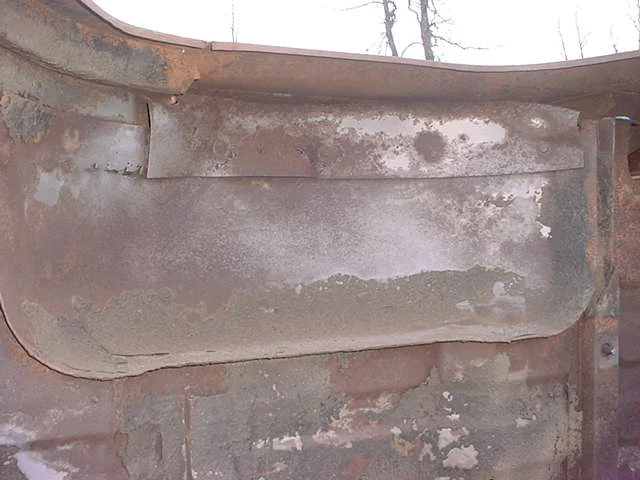

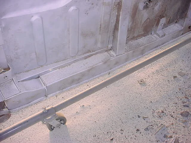

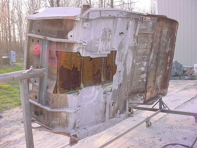

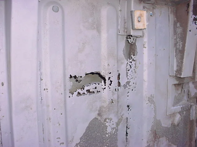

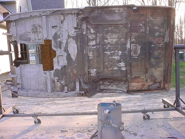

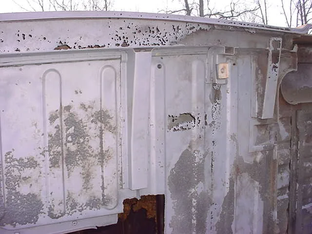

I couldn't sit on my ass any longer, springs or no springs, I was going to do something tonight on the lv.
Drug out the body and blew 6 - 90lb bags of sand on the bottom of the tub, that's all I had at my house. Went pretty good I thought? There is quite a bit of undercoating underneath and the sandblaster does not like the stuff that is still stuck on. Some of it just blows right off in sheets while other areas you have to auger away on it for a while.
Driverside rocker is in tough shape along with an area in the floor, but overall not to bad? I guess I've seen a few photos of entire floors gone so I should consider myself lucky. I think a good weekend I should be able to have most of the new sheet metal work done. Probably won't get to blow anymore sand until this weekend, assuming it doesn't rain?
Thought I would post some pics, springs are scheduled to be here tomorrow, although I just checked the tracking # and they have been Sioux falls, SD since 7 am this morning and nothing has happend? I'm sure they will show up
Bushing should also be here tomorrow to, replacing the others.
Also, lv owners. Take a look at each piece of metal under the rear wheel wells that is fastened in with 5 or 6 screws. Is that factory? It kinda looks like it, because they are both the same. Or is this something else the Doobie bros. fabbed in?
Thanks, Matt

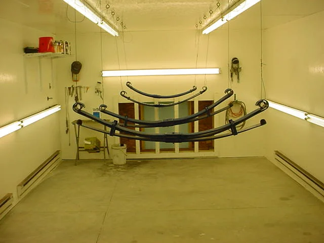

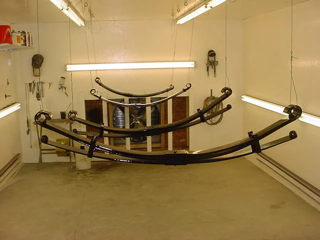

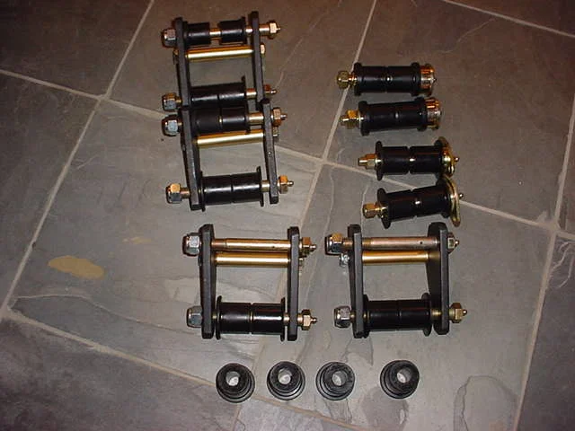

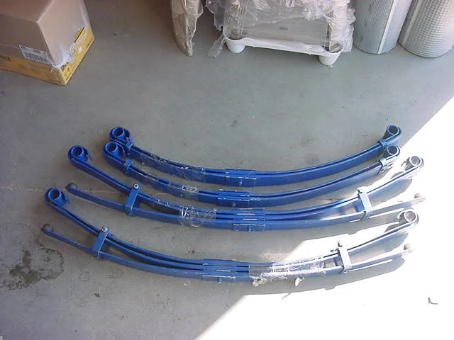

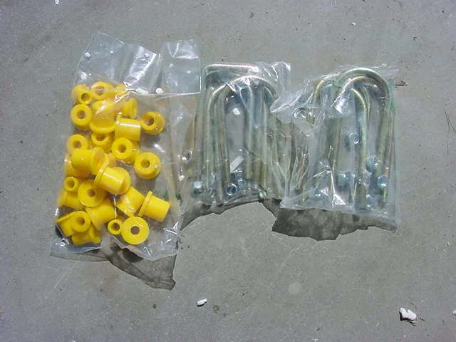

I've got springs!
Look what just showed up??
Took a rag and tried wiping off the blue paint with MEK, didn't come off very well. When I go home for lunch I'm going to try a little reducer, if that doesn't work I will scuff them up and prime and paint over them.
U bolts, 4 long ones, 4 short? Don't quite understand that one, check against the stock ones when I go home for lunch.
Bushings from SOR showed up today also should be good to go
Matt

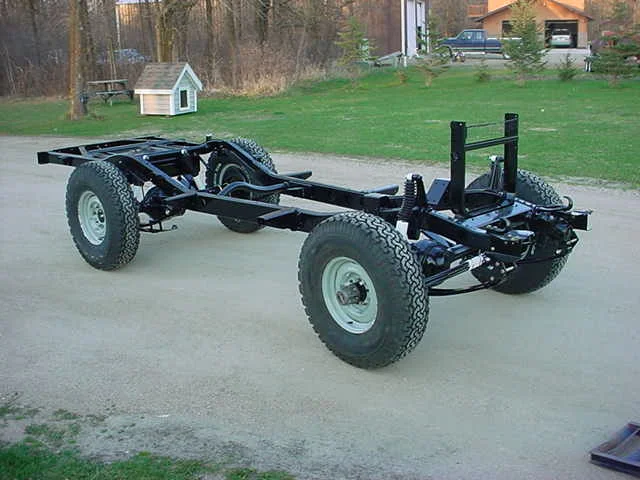

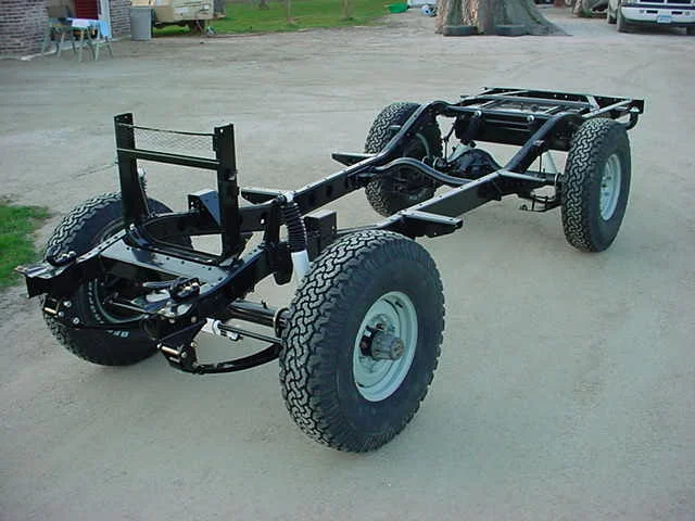

Old 05-04-05, 08:34 PM   #141 (permalink)
Forum Lifer
buckroseau's Avatar
Join Date: Mar 2003
Location: Northern Minnesota
TLCA# 14759
Posts: 3,070

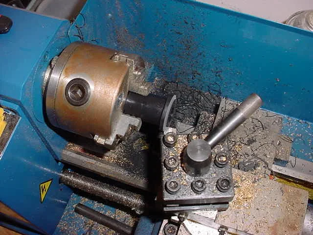

Spent about an hour with the DA and 150 grit going over the parabolic's. Reducer, MEK or Laquer thinner wouldn't really touch the blue paint. I thought of blasting, but that could be hard on the springs. I figured if the paint is sticking that well, scratch it up good, smooth it out and paint it.
I shot a light coat of PPG DP90LF and then 2 coats of MTK single stage urethane. Turned out real nice and I don't think it will be coming off anytime soon. I wasn't going to shoot the DP epoxy primer, but after DA'ing it had a lot of bare metal, so I figured 1 light coat would be good.
Few pics.

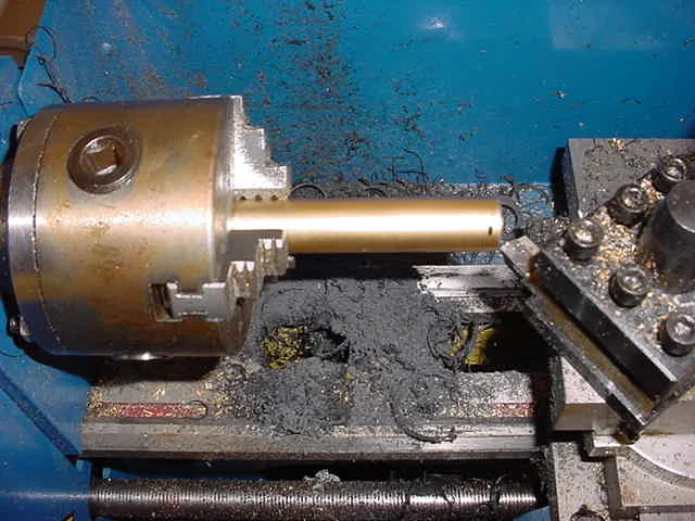

Heading back out the shop to turn down Polyureathane bushings in the lathe, I want to be installing springs tomorrow night.
Matt

I even got the wife out in the booth tonight prepping her springs with DX330.

Old 05-04-05, 10:04 PM   #143 (permalink)
Forum Lifer
buckroseau's Avatar
Join Date: Mar 2003
TLCA# 14759
Posts: 3,070
Just finished machining all the Poly bushings down to .125" flanges. Also machined down the anti-inversion shackle bushing to 3 1/16". Figured that 1/16" extra would probably be good for it?
Should be putting springs on tomorrow night.
Matt

Old 05-04-05, 10:06 PM   #144 (permalink)
Forum Lifer
buckroseau's Avatar
Join Date: Mar 2003
TLCA# 14759
Posts: 3,070
1 more, ready to go

Man you can paint boy, springs are tough will all the edges. You also use my product of choice for paint, just love the PPG line.
My paint helper prep person wears baggy ass jeans and is real ugly, I will look to hire another helper based more on appearance and gender.
I guess we will be getting our parabolics real soon.
When I turned down the bushings for our FJ45 the bushing material would bind up and pop out of the lathe, looks like it went well for you.
Rob

Old 05-04-05, 11:37 PM   #146 (permalink)
Forum Lifer
buckroseau's Avatar
Join Date: Mar 2003
TLCA# 14759
Posts: 3,070
Quote:
Rob
As long as I take it slow in the lathe, it goes real good. I turn at a pretty high speed, but don't take much when I turn it off. I had a couple pop out, but I just put them back in and keep going. I used a metal bit for the poly, used the carbide on the steel. The carbide doesn't seem to work that well on rubber? All of them turned out extremely nice, they all look factory on the end and are right on .125". I think the spring install should go really well tomorrow night, all my measurments are right on.
Thanks on the painting compliment, I take it very seriously. I like PPG's stuff. I also like Dupont and Valspar, I would say Dupont is as good as PPG in my opinion. I guess I've always used PPG so I've just stuck with it, it does work well and is easy to use.
You might get a better looking female helper, but it's kinda of a pain in the ass when they complain about having to touch those icky, stinky chemicals.
Matt

Quote:
Thanks, Matt
Here is a pic of mine. The two I have had both have/had them. I would assume from this that they are stock.

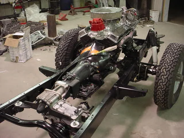

Old 05-06-05, 12:33 AM   #149 (permalink)
Forum Lifer
buckroseau's Avatar
Join Date: Mar 2003
TLCA# 14759
Posts: 3,070
Had a friend of mine come out and give me a hand with the parabolic spring install. Took about an hour and 45 minutes to install the springs and shocks.
Went a little faster than expected, so I figure I better put the drivetrain back in
I still plan on sandblasting the body on Saturday. They are forecasting rain in the afternoon and I really want to blast. I called a guy locally who does mobile sandblasting. $50 bucks an hour plus the sand. I told him to plan on 2 to 3 hours Saturday morning. He is meeting me at my place with his equipment and I am going to run mine also. Hoping to turn a 5 to 6 hour job into 2 to 3 hours.
Blast the body in the morning, get it back in and primed before it rains, at least that's the plan? I think it will be a good $100 to $200 spent.
Matt

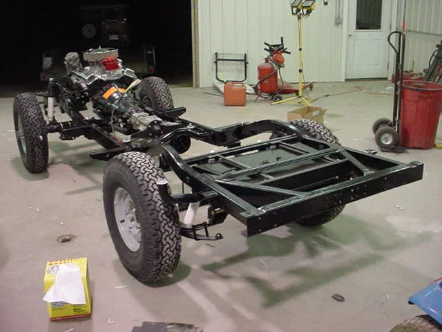

Old 05-06-05, 12:35 AM   #150 (permalink)
Forum Lifer
buckroseau's Avatar
Join Date: Mar 2003
TLCA# 14759
Posts: 3,070
Motor installed.
