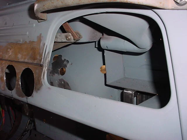

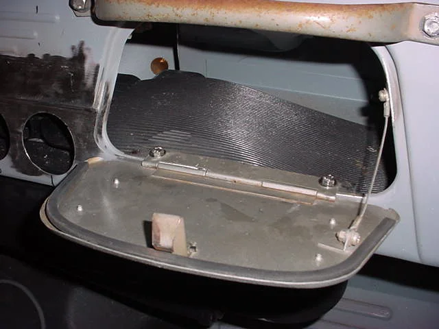

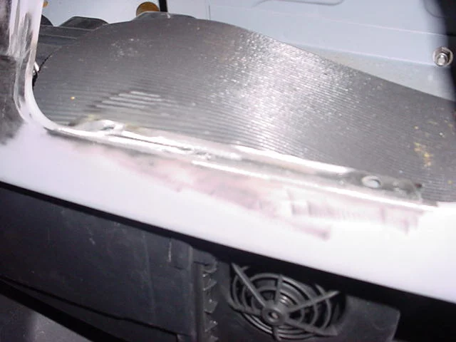

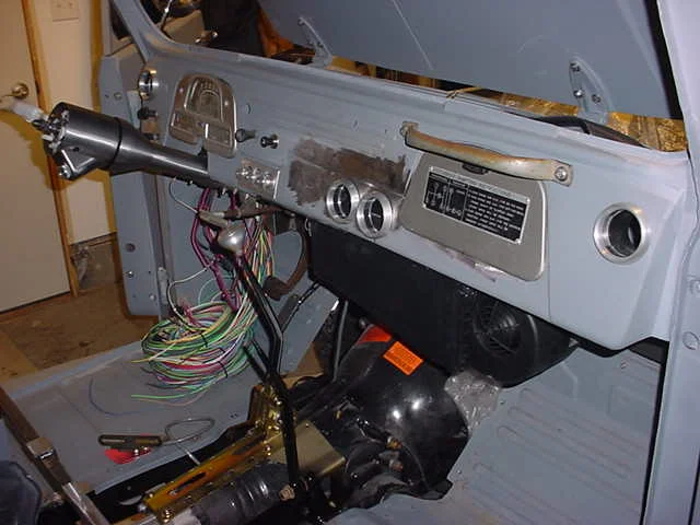

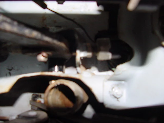

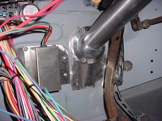

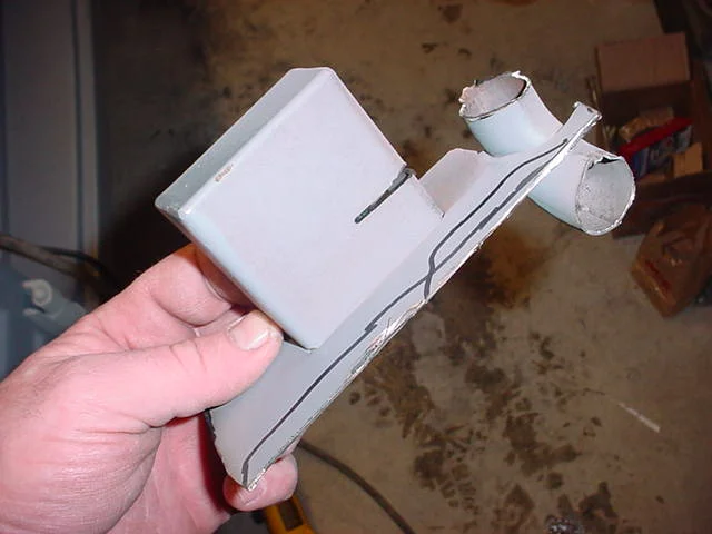

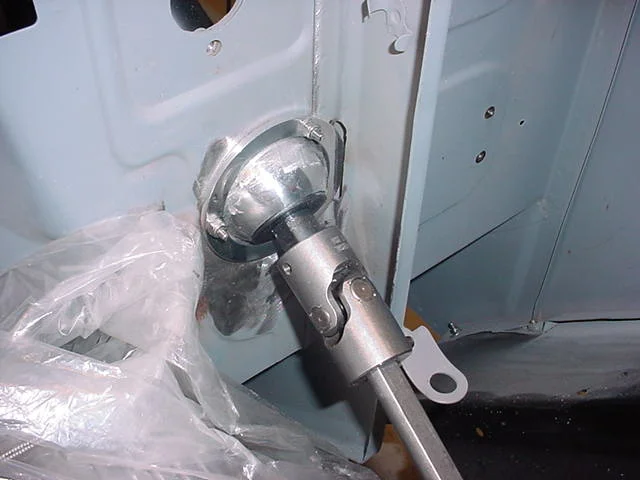

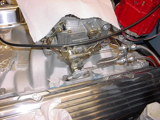

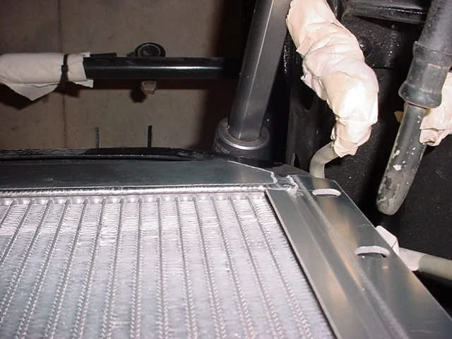

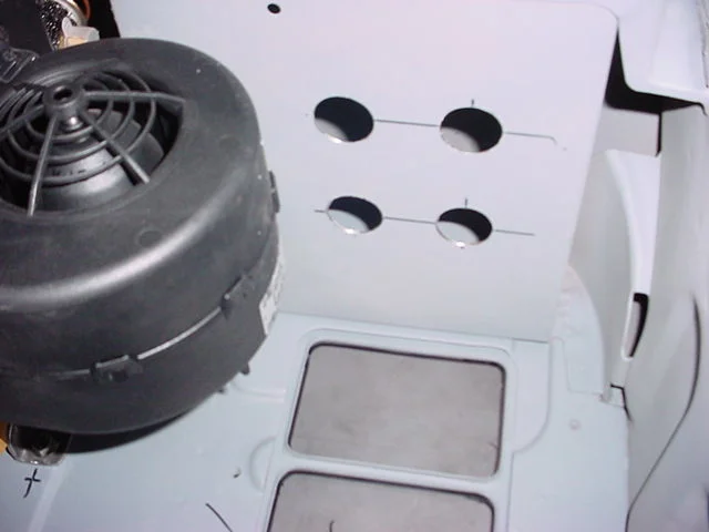

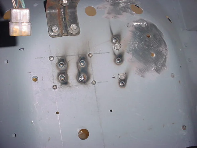

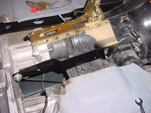

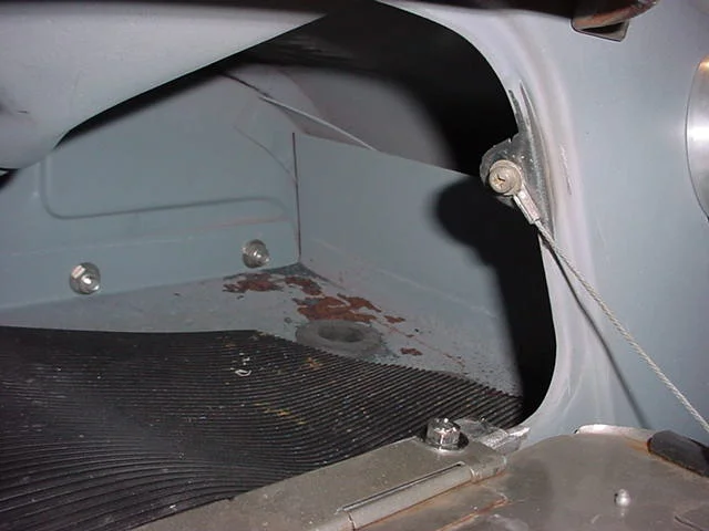

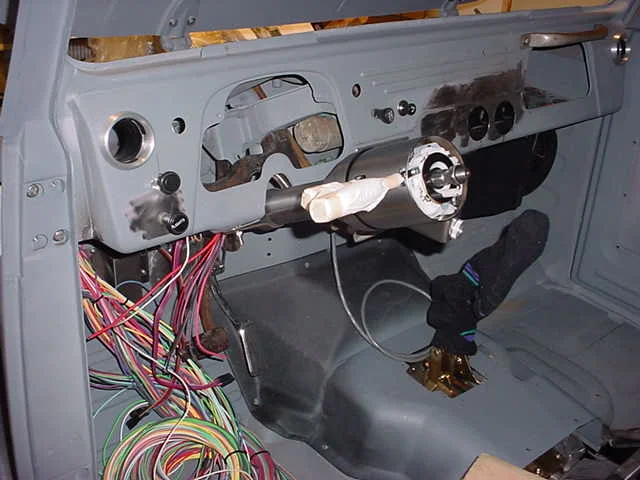

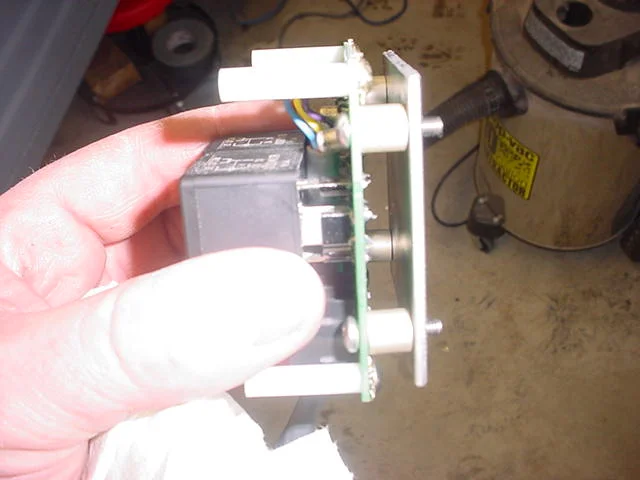

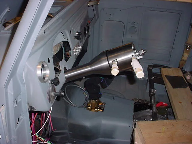

Another solid day on the lv, about 8 hours.

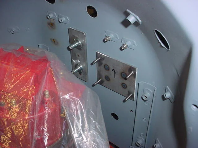

Started off the day by making threaded plates for the neutral saftey relay on the fire wall. Figured if I threaded a plate and welded it on, it would be easier to take on and off. Also made a a reinforcing plate for the middle AC mounts.

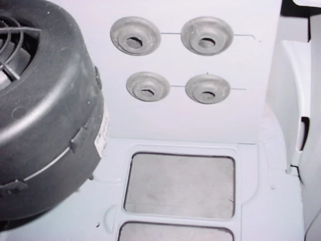

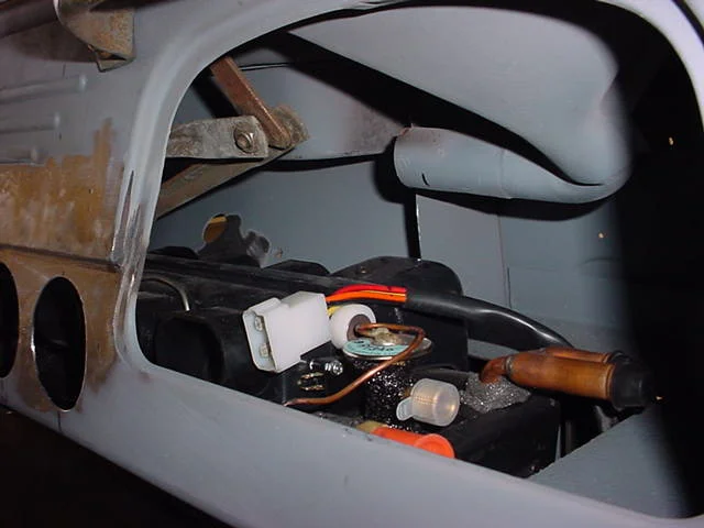

Made another decision on the AC area. I decide to pretty much gut the majority of it out. After welding up the ash tray area I realized how I couldn't see anything back there, let alone start pulling wires when that time comes. So, I really opened it up. This way I can at least get my hand back in there through the glove compartment door. Also drilled 4 - 1 1/4" holes in the bottom of the glove compartment for the rubber grommets. The AC lines and heater lines will come down through there and turn into the firewall area, still have to cut those holes in that plate I made.

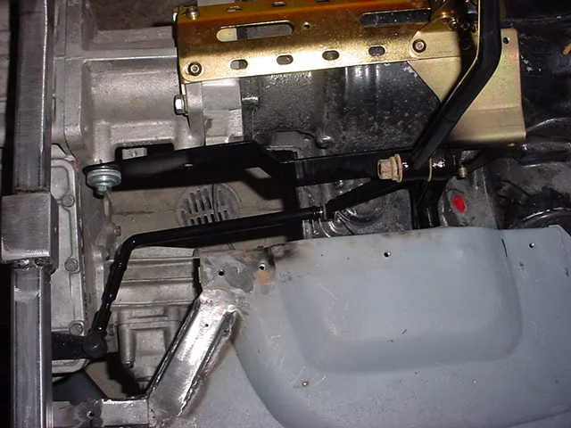

Figured I would mount up the steering column, just to make sure that fit. Fit pretty decent, except the set screws on the lower U-joint would hit the radiator core support. Looks as though I am going to have to move it about an inch or so to the passenger side. It actually isn't centered right now, it was the core support out of the 79, they must mount different? No big deal.
Wife also wanted a working glove box door, even though it's totally useless. She didn't want 4 bolts holding it on. I couldn't use the original glove box door since it mounted down in the glove box and that couldn't happen anymore. So I used the door out of the 79. I had to weld a 1/2" strip plate to the edge of the dash inside the door area. Then welded 2 captive nuts underneath for it to bolt to. I actually cut the tab out of the 79 that holds the wire and welded that on, since the orginal didn't have that style.

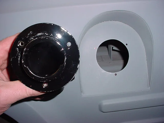

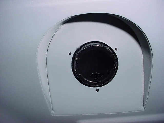

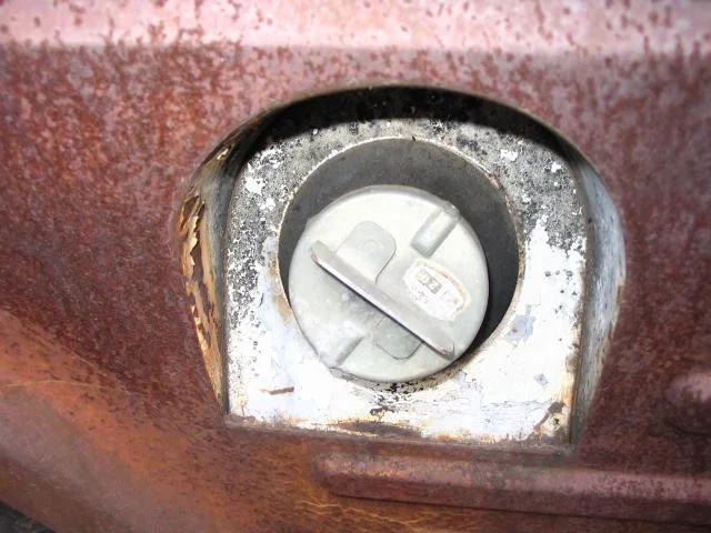

Anyone see any problems with using this filler neck and mounting it to the body with those 3 holes????

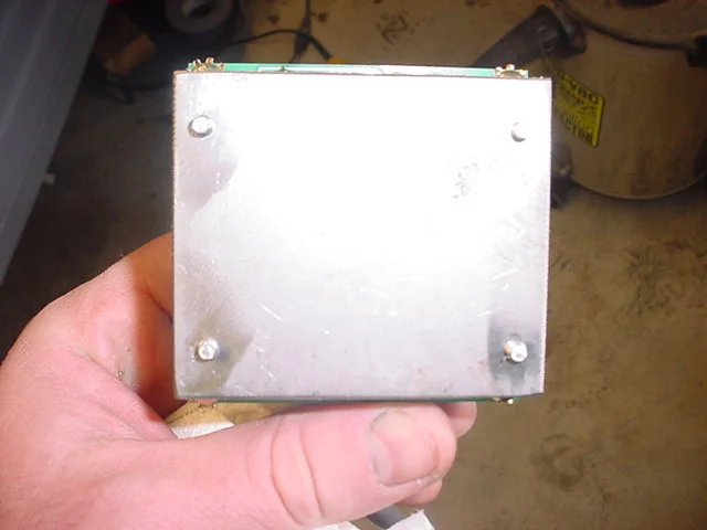

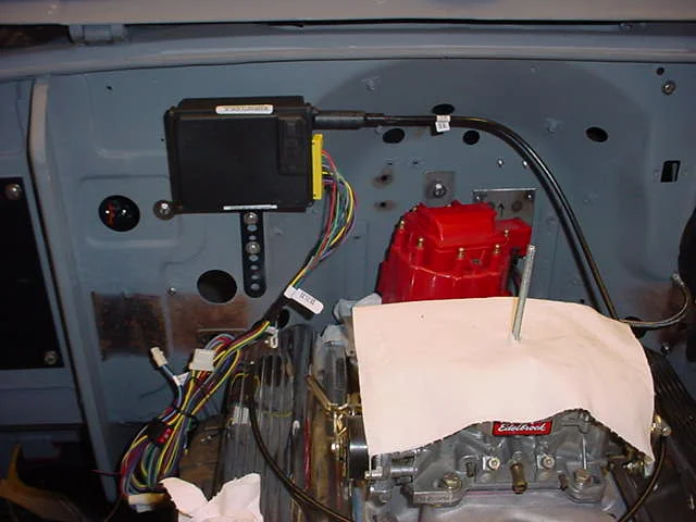

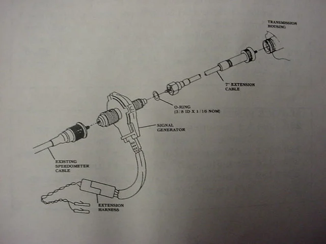

Anyone know anything about Cruise control units??? I'm reading the instructions and I'm getting confused real quick

Matt,
The LV is looking great!
Are you going to fabricate a new shift pattern badge that corresponds with your new trans/diff for the glovebox door as well?
__________________
--Martin
1985 FJ60
1973 FJ40
1982 Hilux 4x4
TLCA # 16348
Rising Sun
MDH33 is offline   Reply With Quote
Old 01-09-06, 09:53 AM   #1455 (permalink)
Forum Lifer
buckroseau's Avatar
Join Date: Mar 2003
Location: Northern Minnesota
TLCA# 14759
Posts: 3,072
Quote:
Originally Posted by MDH33
Matt,
I don't think I'm that good
The one on there might have to do.

I like the idea of making plates for the AC relays better than the first option you previously. Have you considered placing a plexi-glass cover on top of the relays for protection or cosmatic looks? Looks great and keep the pics coming.....I like how it's coming along.

Quote:
http://forum.ih8mud.com/showthread.p...986#post828986
post #1223
The OEM plug style filler necks that came on the 66/67 LVs do not work very well. It is an art to fill the tank without spilling gas on myself and the side of the truck.
This pic is the OE style the 64-65 LVs came with. The gas cap isn't correct though.

Quote:
post #1223
Yep, that's the same filler neck, just blasted and painted now. I remember posting that, just couldn't remember the answer, thought I would make sure.
Probably drill it in tonight.

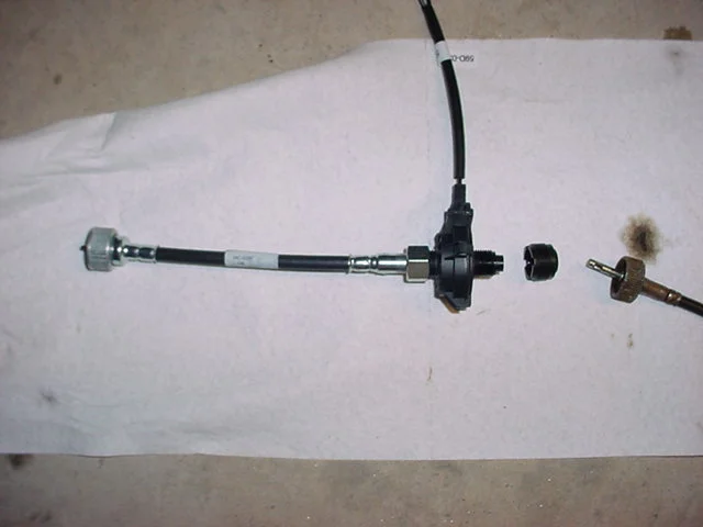

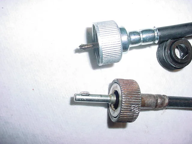

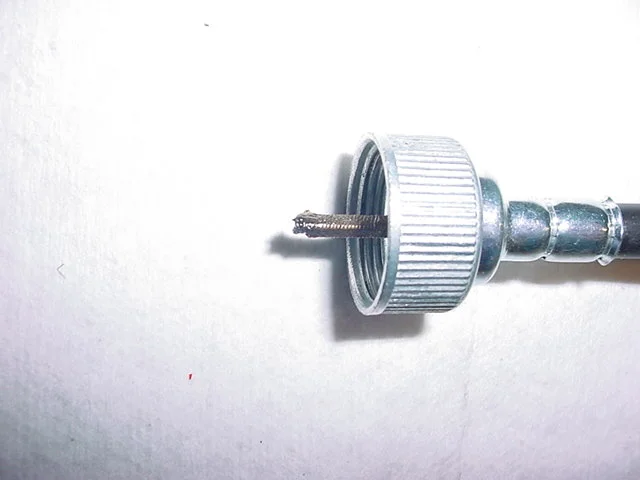

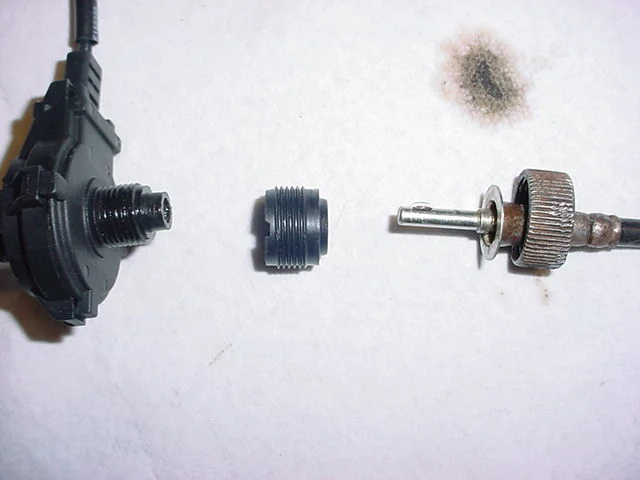

OK, cruise and cable guru's.....now is your time to shine.
Signal generator that came with the kit has a very small square end compared to Toyotas large end with that key sticking out.
So, I need to change the 7" stub cable on the one end to the larger Toyota end so that can hook up with the T case.
Then, I need to change the Toyota speedo cable to the small square end, to fit the signal generator.

Old 01-10-06, 10:55 AM   #1462 (permalink)
Forum Lifer
buckroseau's Avatar
Join Date: Mar 2003
TLCA# 14759
Posts: 3,072
last 2

Quote:
Originally Posted by orangefj45
pretty sure that downey and jagsthatrun sell a setup that'll bolt right in.
What no link? I'm to lazy or stupid to look or find it, maybe both
Matt

Old 01-10-06, 11:34 AM   #1465 (permalink)
Forum Lifer
Radd Cruisers's Avatar
Join Date: Sep 2002
Location: Vancouver Island BC Canada

Did a simular swap in a diesel landcruiser, comes with a chevy end, had to cut off the toyota end drill out the cable bits, then crimp and solder the end on.
Kinda goofy but it worked.
Rob

Old 01-10-06, 01:43 PM   #1466 (permalink)
Site Addict
usmcruiser's Avatar
Join Date: Oct 2004
Location: B to the E to the R to the THOUD!
TLCA# 15913
Posts: 1,368
Matt
No sure but is this the page look under speed sensors??
__________________
Nick
'78 FJ40 (scattered all over garage)
'76 FJ55
"If you can read this thank a teacher.
If you can read it in English thank a U.S. Marine."
CO/WY - Horsetooth 4 Wheelers Cruiser Club
usmcruiser is offline   Reply With Quote
Old 01-10-06, 01:59 PM   #1467 (permalink)
Forum Lifer
buckroseau's Avatar
Join Date: Mar 2003
TLCA# 14759
Posts: 3,072
Quote:
Your the man, ordered!!!
4 pulse speed sensor w/ 10" stub cable, set up for all Toyota product.
Also ordered yesterday from Lokar, pre-made cable to replace the cable in the Rostra cruise control unit. Made to hook up to all my Lokar stuff and the carb I have right now.
Should be good to go.........
Matt
__________________
Wanted to buy: FJ45LV interior door handles and door jam stops. If you have any or know of any, please PM me. Thanks, Matt
buckroseau is offline   Reply With Quote

Another question for the LV boys and girls.
Any pics of the brake switch underneath the dash?? I don't remember removing one, might not have been there?
What does it look like? Where does it mount?
Trying to figure out if I can get by with 1 switch for the brake, cruise control and tranny lock up, or am I going to need 3???
Thanks in advance.......again

you'll prolly have to run 2 switches. one stocker and the painless dual action switch. the painless switch has one open circuit when the switch is actuated and one closed circuit. and vise versa when the switch is in idle position of course.....
