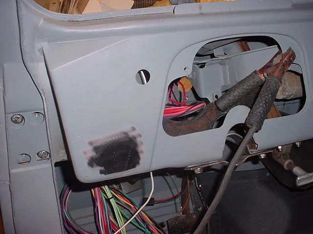

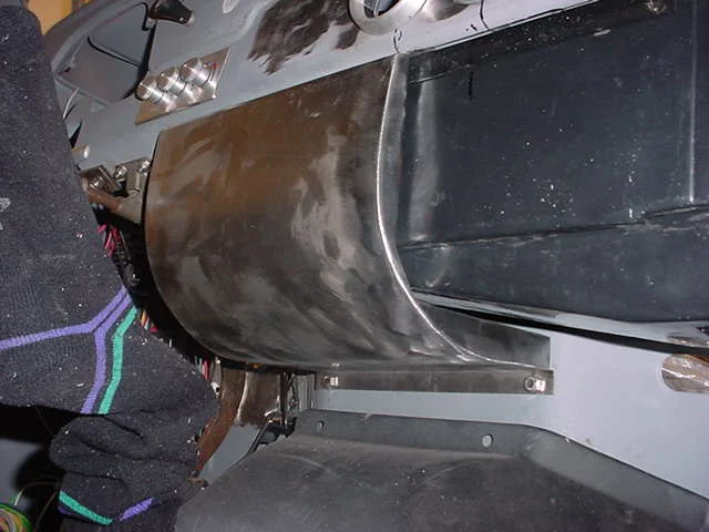

Old 01-05-06, 09:33 PM   #1411 (permalink)
Forum Lifer
buckroseau's Avatar
Join Date: Mar 2003
Location: Northern Minnesota
TLCA# 14759
Posts: 3,072
more 2

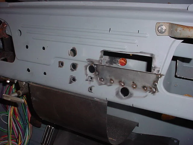

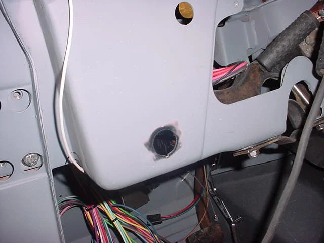

Old 01-05-06, 09:35 PM   #1412 (permalink)
Forum Lifer
buckroseau's Avatar
Join Date: Mar 2003
TLCA# 14759
Posts: 3,072
last 3

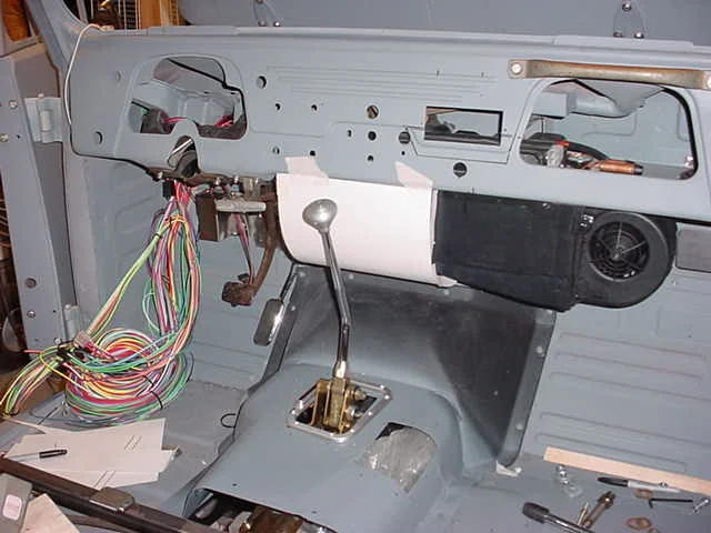

Old 01-05-06, 10:35 PM   #1415 (permalink)
Forum Lifer
Texican's Avatar
Join Date: Dec 2002
Location: Bonham Tx.
Posts: 3,667

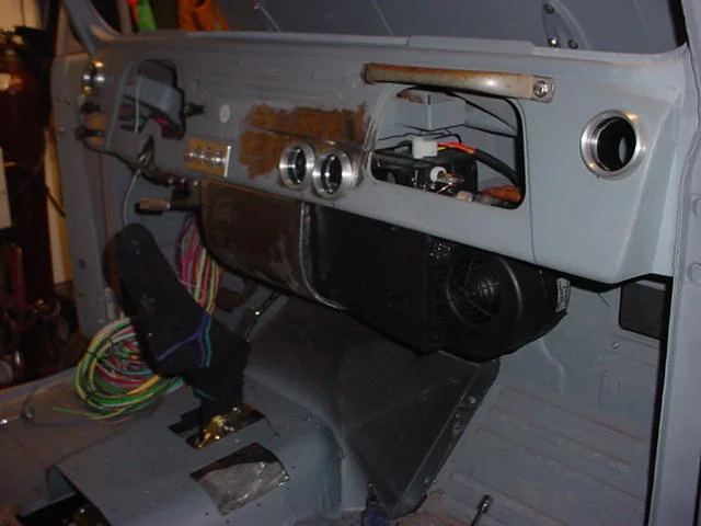

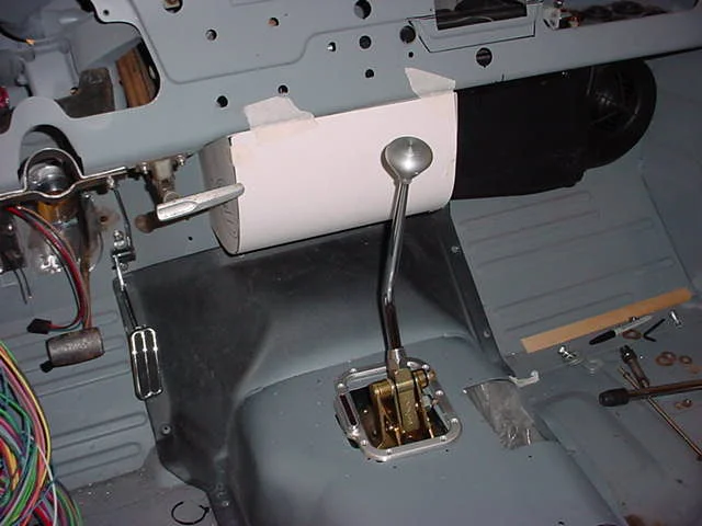

What is the purpose for the center section?
Looks? Or is something else goin there?
I like it, just curious
You might consider making it more squarish wth rounded corners and installing the sound stuff in it.
Butch

Old 01-05-06, 10:39 PM   #1416 (permalink)
Forum Lifer
buckroseau's Avatar
Join Date: Mar 2003
TLCA# 14759
Posts: 3,072
Quote:
Butch
The main purpose is that I need to hide that neutral safety relay box, barrier strip and all those wires. Also, some AC stuff is on that end, I don't want any of it hanging out in the open.
Good idea on the sound stuff, make a great spot for a front speaker.
Not related, I was planning on putting 2 speakers in the rear side panels, one on each side. Just don't know yet how to run the wires up front clean yet. Thinking maybe underneath the truck?
Matt

What if you gutted the heater box and used that to cover everything up.

Old 01-05-06, 11:08 PM   #1418 (permalink)
Forum Lifer
buckroseau's Avatar
Join Date: Mar 2003
TLCA# 14759
Posts: 3,072
Quote:
That's not a bad idea, why didn't I think of that
Not saying I can do it yet, but I will definetely take a look at that tomorrow.......did I mention that was a really good idea
Thanks, Matt
__________________
Wanted to buy: FJ45LV interior door handles and door jam stops. If you have any or know of any, please PM me. Thanks, Matt
buckroseau is offline   Reply With Quote

Since it's an auto.. why not use both the clutch pedal and the brake pedal. I think Nolen had welded the 2 together on his truck and left one lower than the other for ease of use but they both did the same function. Or it would at least make one big brake pedal like most automatic vehicles.

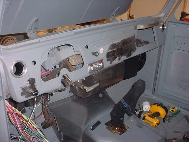

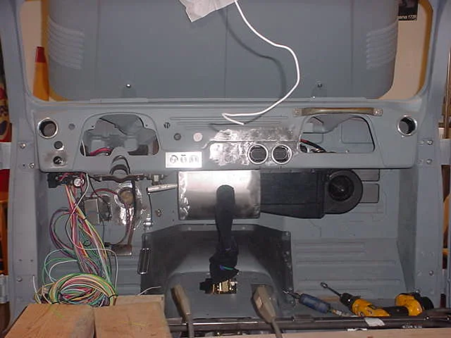

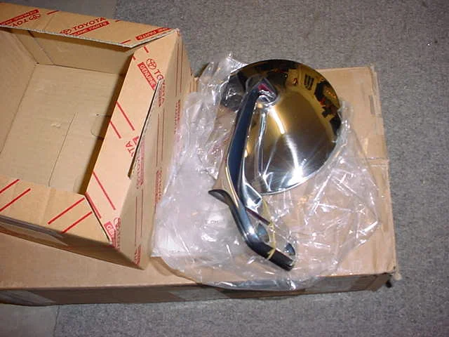

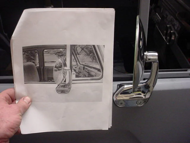

Old 01-07-06, 07:55 PM   #1430 (permalink)
Forum Lifer
buckroseau's Avatar
Join Date: Mar 2003
TLCA# 14759
Posts: 3,072

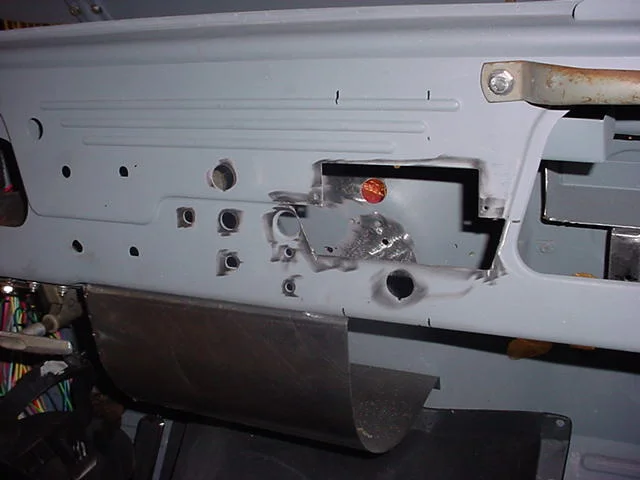

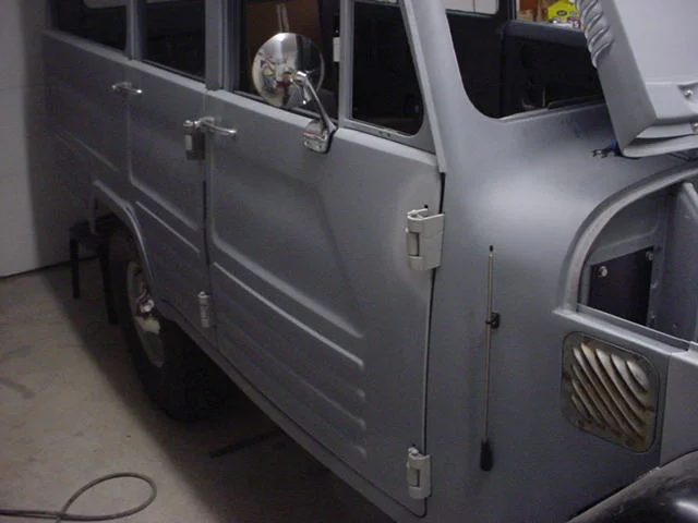

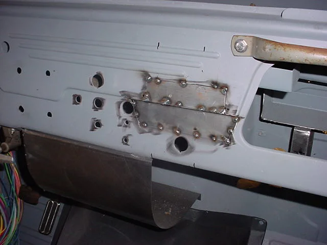

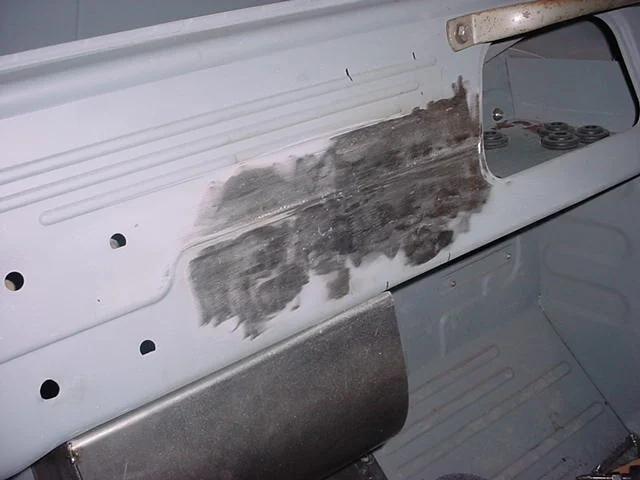

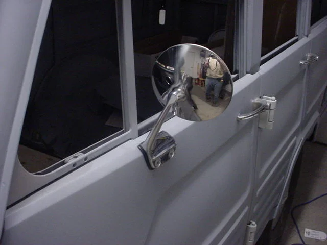

Pretty good day on the lv today, about 9 hours
Started off by making that center section, no real problems there. Made the center piece first and then the sides and tacked it together while it was in place. After it was tacked I pulled it out and welded the insided corners sold and then ground down the outside corners so it had a little rounded edge to it.
Started on the dash, kinda a pain in the ass. I wanted to make sure I carried that dash line across so it looked uniform. I think with a couple coats of primer and then sanded out it's going to look real nice. Pretty much got all the dash knobs and vents drilled in, except for the cigerette lighter, should get that done tomorrow.
Took a break from the dash and mounted the mirrors and the antenna, just wanted a change of pace. You can see my template in one of the last pics, thanks pimp
Plan is to hit it hard tomorrow, going to grind away underneath the dash a bit, get the AC unit fitting up nice and ready to go. Might start welding some of the extra firewall holes shut tomorrow also.......plenty to do.....
Matt

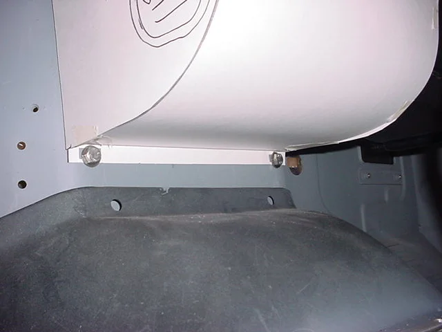

Old 01-07-06, 07:56 PM   #1431 (permalink)
Forum Lifer
buckroseau's Avatar
Join Date: Mar 2003
TLCA# 14759
Posts: 3,072
more

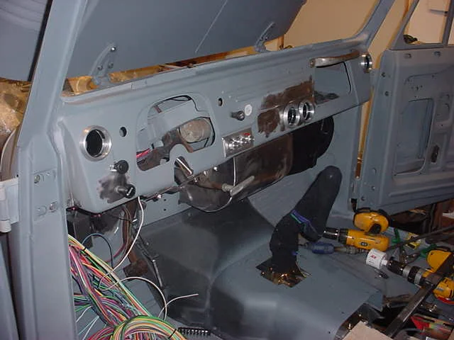

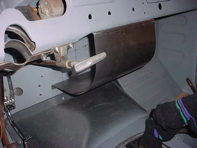

Old 01-07-06, 07:56 PM   #1432 (permalink)
Forum Lifer
buckroseau's Avatar
Join Date: Mar 2003
TLCA# 14759
Posts: 3,072
more 2

I have a Camry parts rig here, what about me sawzalling the brake pedal and sending it to ya' and you can weld the larger pad onto your brake pedal?
Butch
Butch
I'm I missing something here......do I need a larger brake pedal?
Just curious since others have mentioned it, I thought it looked fine?
What does the Camry pedal look like?
Thanks, Matt

I would stay with the stock look. Maybe use both pedals together if possible. But not a Camry pedal. Its yota but really. ???
But hey, Matt its up to you b/c you work some serious wonder.

are you going to weld that center cover thing to the dash? it might be a better idea bolt it, cause it would be a PITA to get all the dash knobs in with that there
Already bolted and yes it does come off. I do need to get behind there, lots of stuff
Matt
