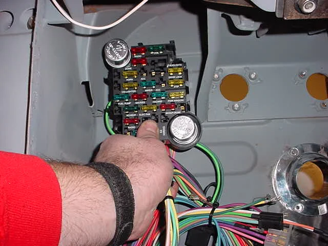

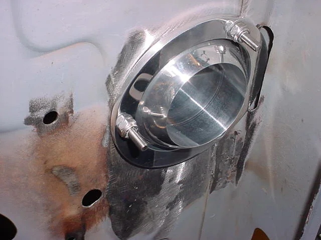

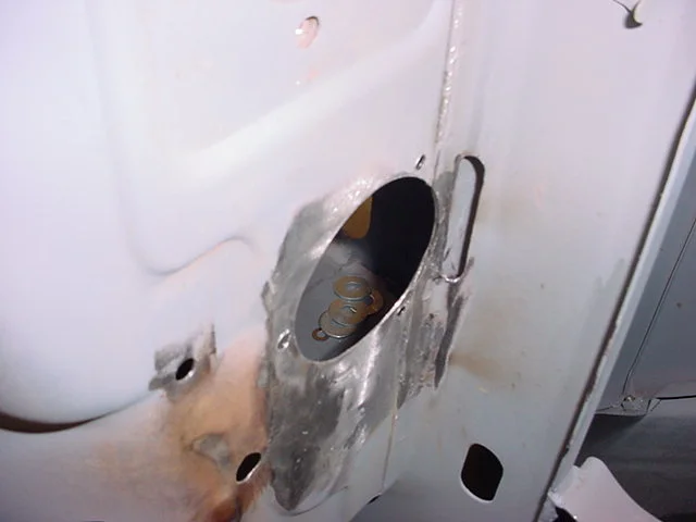

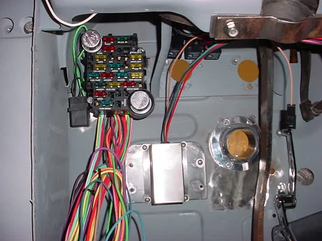

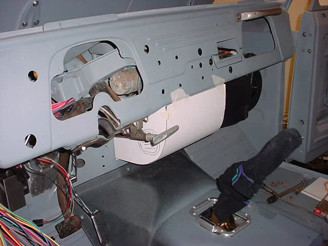

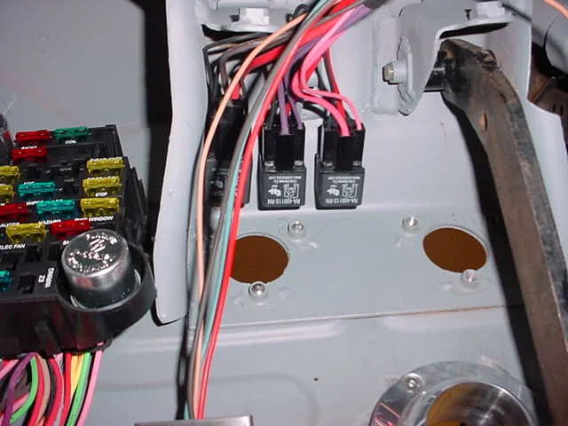

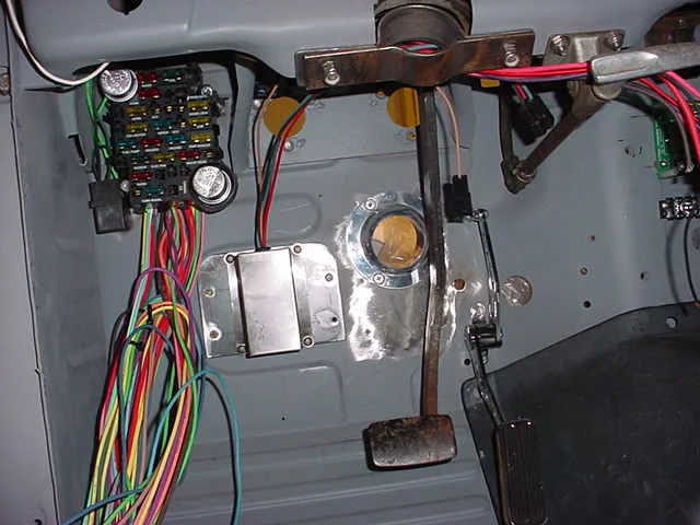

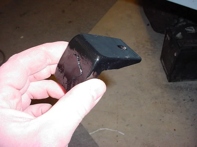

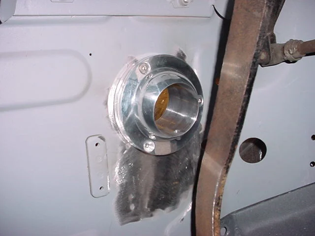

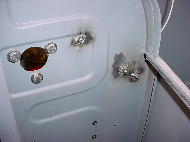

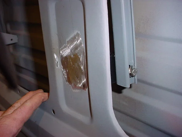

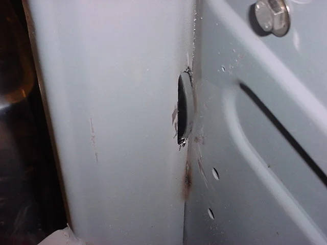

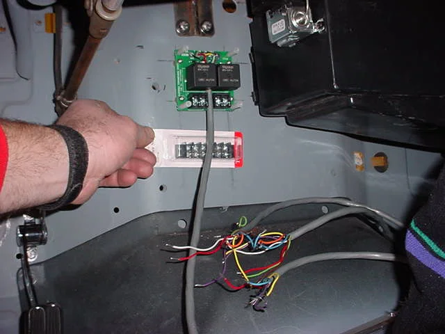

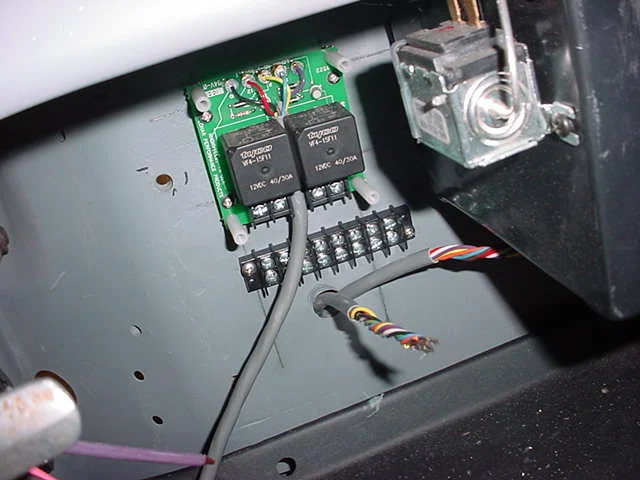

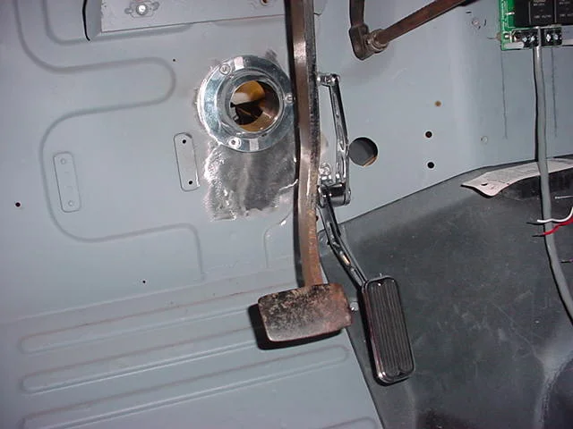

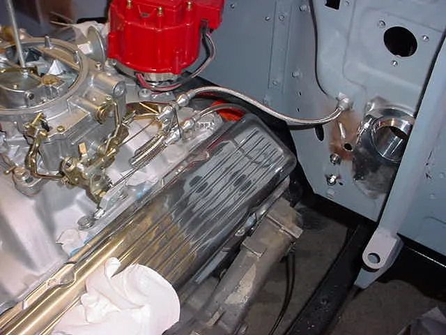

Got a little time in on the LV tonight, few little things, but moving ahead.
Started off fixing a bracket in the drivers side door. The bracket had pulled the steel right out of the door, it was laying in the bottom when we took the door apart. I had blasted and painted it (because I could) last week, so I cleaned off the paint and welded it in. Other side also had a couple cracks, looked like it was doing the same thing so welded that up also.
Worked on fitting the gas pedal. Also installed the steering column swivel ball. I had to relief the firewall rib for one of the pinch rings, I new I was going to have to do that though. Installed the throttle cable and kick down calble to the carb and the pedal.
Started figuring out the fuse box and neutral saftey relay box. I think the pics you can see the relay box mounted below the wiper motor. You can also see the 3 sets of looms of wires sitting below it. What I'm thinking is mounting a 8 position barrier strip below that relay box. Then bring the LED shifter ring wires and indicator wires into the cab through a grommet in the firewall, and then bring the wires from the relay down to the barrier strip which will be right below it, should work good??? This junk will all be covered up by a cover I'm going to make.
Also took a pic of where I think might be a good place for the fuse panel.

You gonna run one of the spacers for the Power brake booster or something else?
Matt has the spacer

Got about 3 hours in on the lv tonight, doesn't look like much, but lots of thinking going on before anything gets done
Finished drilling a hole in the center of the firewall for a 1/2" grommet. The wires for the LED shift ring and indicator are coming through in one of the pics. Also mounted a 8 pole barrier strip right above the hole and right below the neutral saftey switch. This way I can bring all those wires together on the barrier strip.
Mounted the fuse block and the relay right next to it. I used T nuts and tacked them on the firewall side. Just like the factory T nuts, but mine are round, should look pretty nice when painted. I mounted 3 relays to the metal brace behind the speedo head. Since I'm not needing a clutch pedal I have a little room there. Pretty solid metal so it was tapped to 10-24 and bolts threaded in. Used 4 existing threaded holes on the firewall where 2 plates were mounted. I made a plate out of 1/8" flat stock and then mounted the dimmer relay box to that.
Started fabbing up my center section with some tag board......Make sure you guys post what you think. I think it looks ok, probalby will look more natural when it is painted up gloss white like the dash. Since one of the rear heater defrost ducts comes straight down behind it I will have to take that one off and run a hose to a vent on the left side. I think you can kinda see the circle I drew on the side. Just so when the heat is turned onto the floor, it gets to the drivers side and it also doesn't get to hot inside that box/console I made. I plan on making some clips underneath the dash so when I put it in it will just slide in up top and then bolt in the bottom.
Also, Brand new FJ 55 mirrors showed up tonight, along with 8 brand new drive shaft bolts, lock washers and nuts Thansk Cruiserdan
Matt

more
