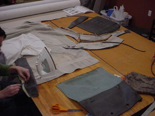

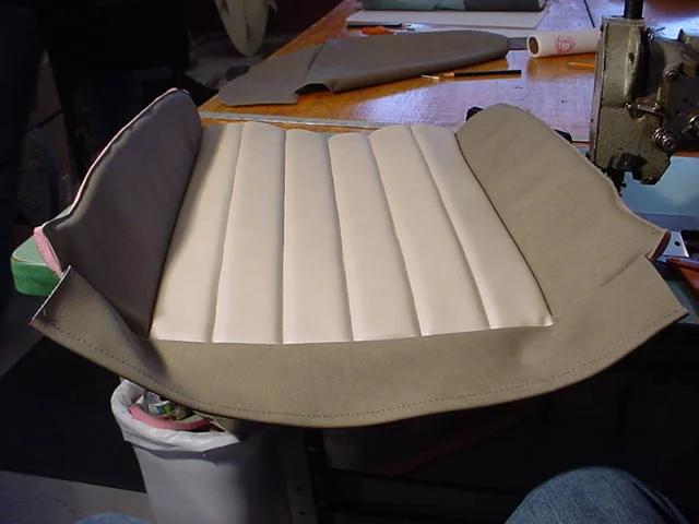

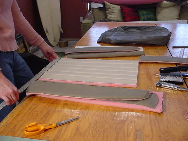

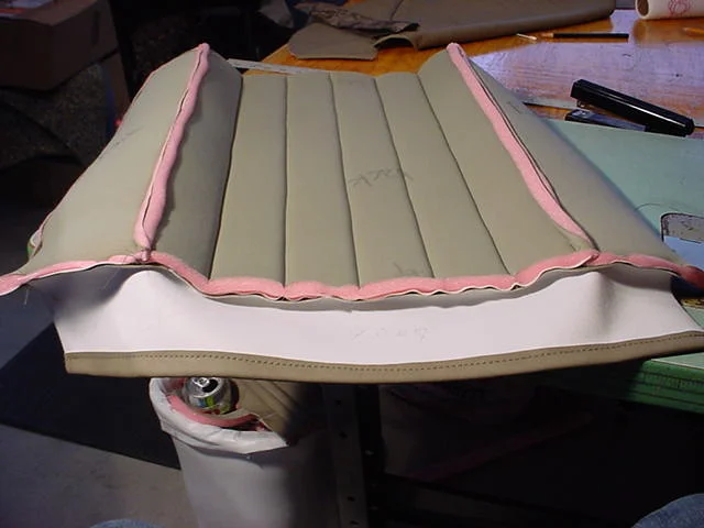

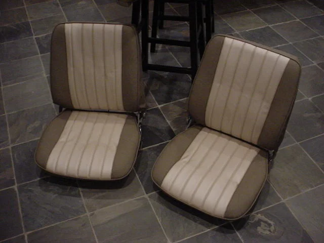

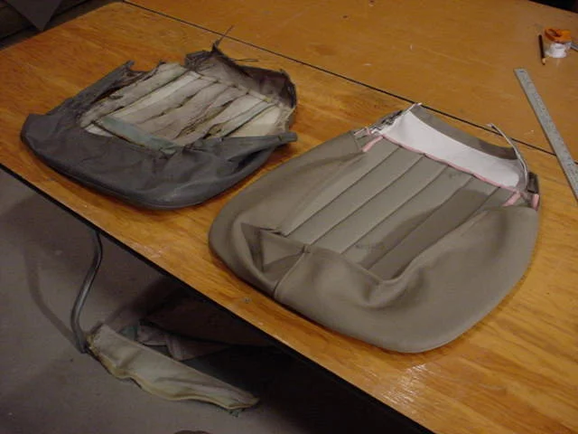

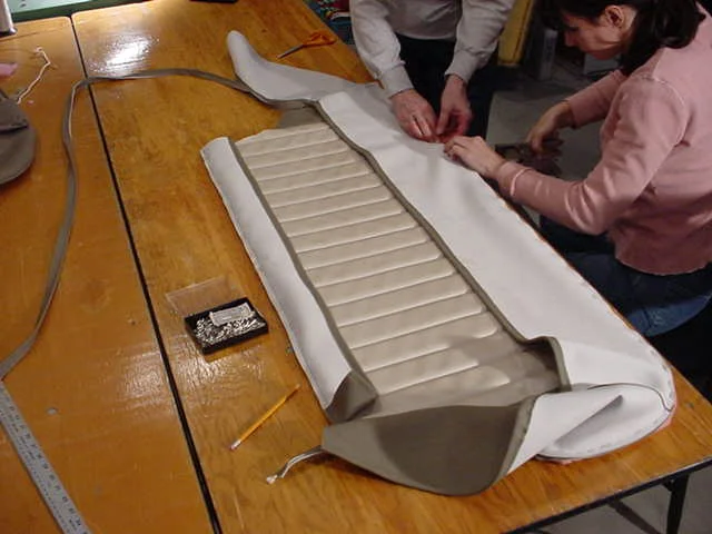

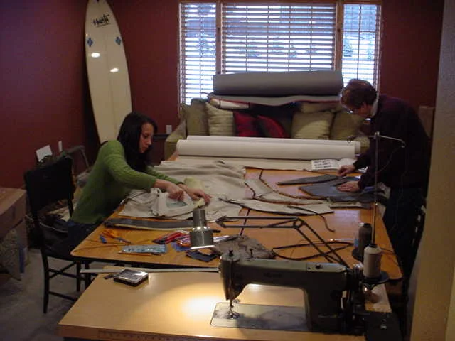

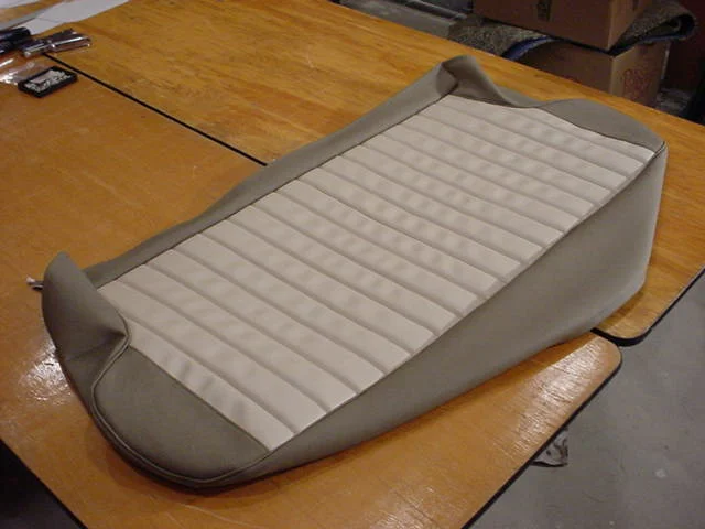

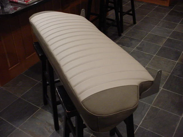

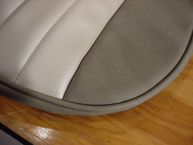

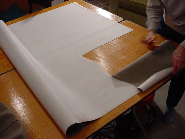

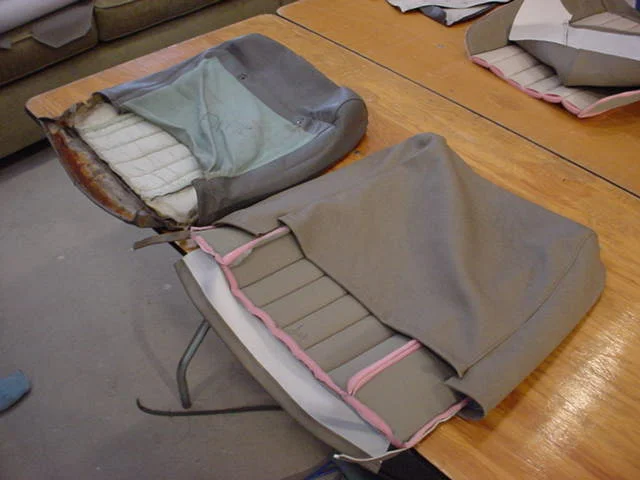

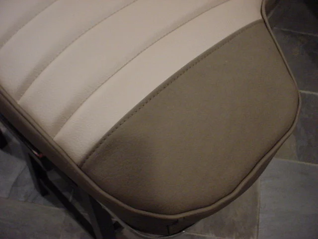

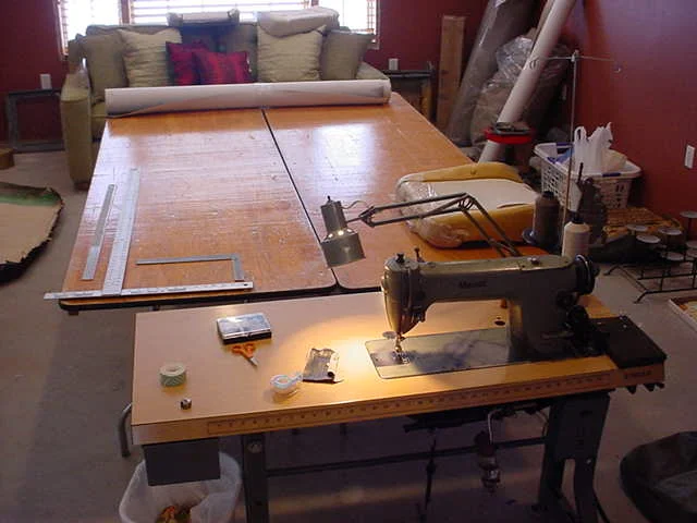

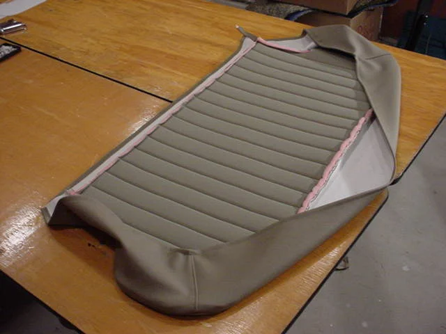

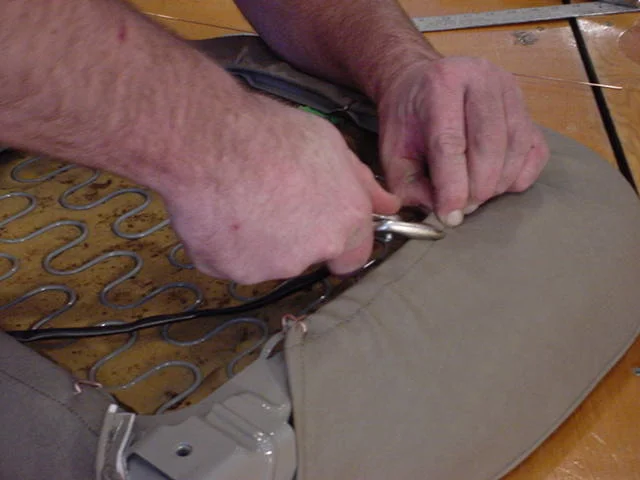

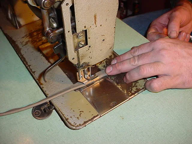

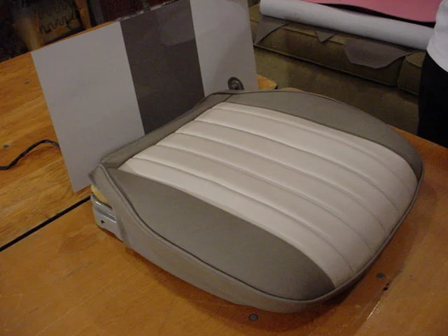

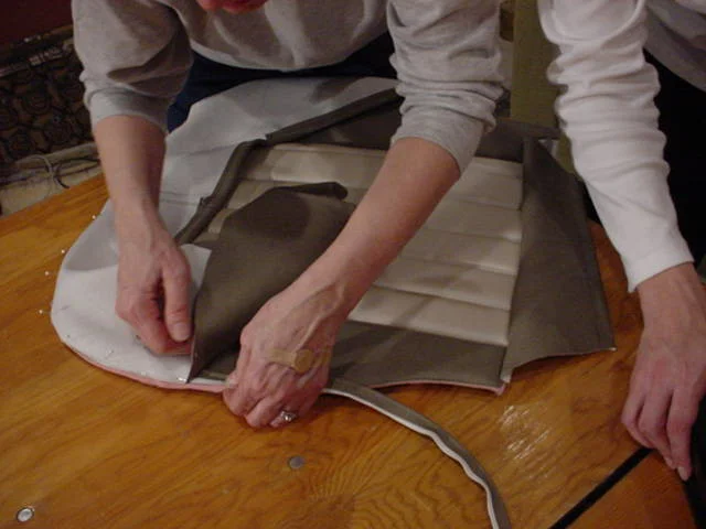

Happy new year everybody!!!!! I thought I would bring you up to speed on what I was doing when the clock struck midnight......it was sew, sew.....ok that was stupid...
Pics of yesterday evening and todays action. I can't say everything went as planned, it was far from it I consider myself a fairly good manager and planner, I had everything in place, people, facility and the right equipment...so I thought...
Mother in law got up here around 3 ish on Friday. Wife and her got going on seam cutting the OEM seat covers, that went fine. Then they started cutting out patterns, that went good. And then they went to sew......not good, not good at all.
I will keep this short, because I could fill a couple pages on how the machine worked for them. But, after taking it apart several times trying to make it so it wasn't so touchy on the tredle, nothing was working. The machine was either not moving or literally wide open where it was pulling the material out of your hand. We couldn't get a decent stitch, totally uneven with no consistency. After literally pissing away damm near a Saturday I finally gave up.
Now the good news. During the time I bought this machine over a month ago I had a want ad in the local trader for a industrial machine. I actually got about a dozen calls, but I had already purchased this one so I didn't need anymore. I did however remember one of the guys names that called, so I got on the phone Saturday evening, about 6 pm New years eve. Got a hold of the guy, was getting ready to go out with his lady to dinner. Asked him if he still had the machine, he did, sweet. Told him my situation, told me to meet him at his house at 8 pm before he left.
Now this guy used to run an upholstery business. Got there and he had a used Pfaff, looked pretty decent. My mother in law came with me along with a few samples of our material. He gave us a quick lesson and the thing worked absolutely sweet!!! Complete control on the treddle, fast or as slow as you wanted. Wrote him a check for $250 and we were gone. On a side note, I told him my problem I was having with the singer. He said he used to have a singer and it was the same way. Extremely hard to control, he hated it. One good thing is that the guy who I bought the singer from said if it didn't work out, bring it back. It will be on his doorstep Monday morning.
So, Pfaff is unloaded at my place around 9pm. Hauled in, cleaned up and put to work. Pics say it all, 2 hours later................you be the judge, but I think for our first seat cover, we did pretty fricking awesome I don't what you guys expect for my first stab at upholstery?????
And guess who did all the sewing........you guessed it
Matt

HAHAHA Matt that is awesome...good to see YOU helping out with a little sewing action....not sure if you got my email...stateside SOON!!!

Looks great Matt - love the work light in the dining room Interior is going to look sweet!

awesome work, those seats look great. i guess pops did'nt want in on the action though, huh?!

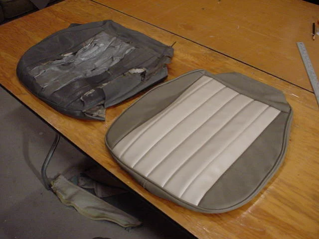

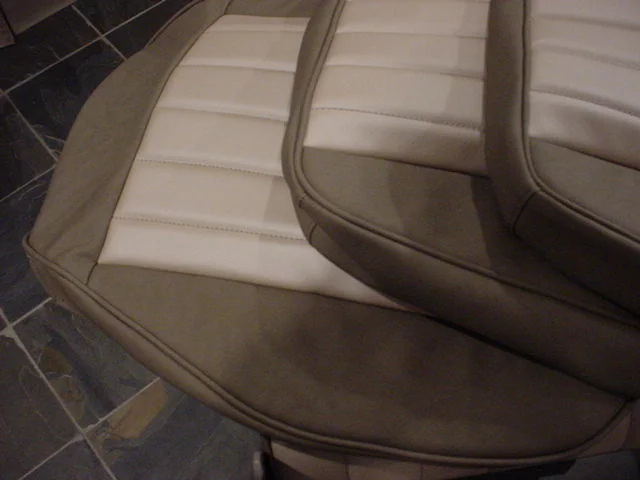

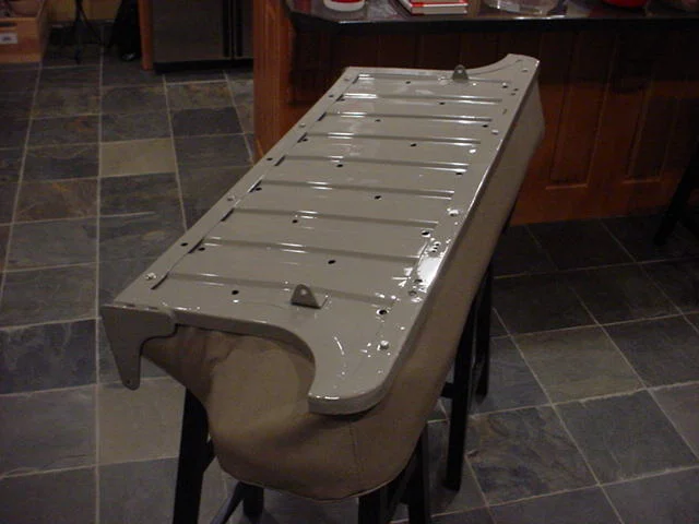

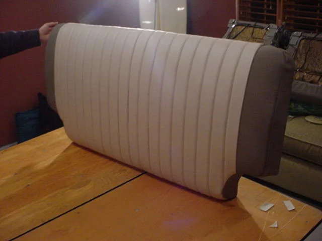

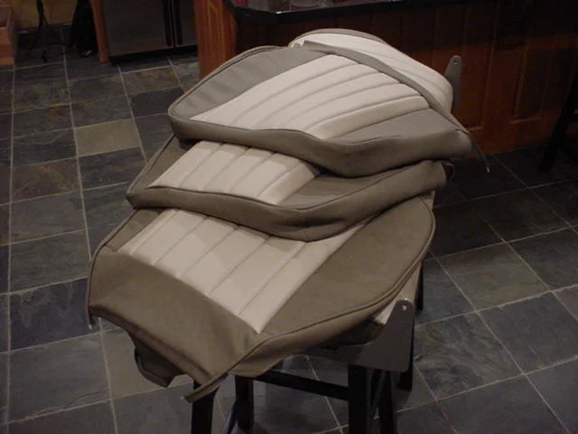

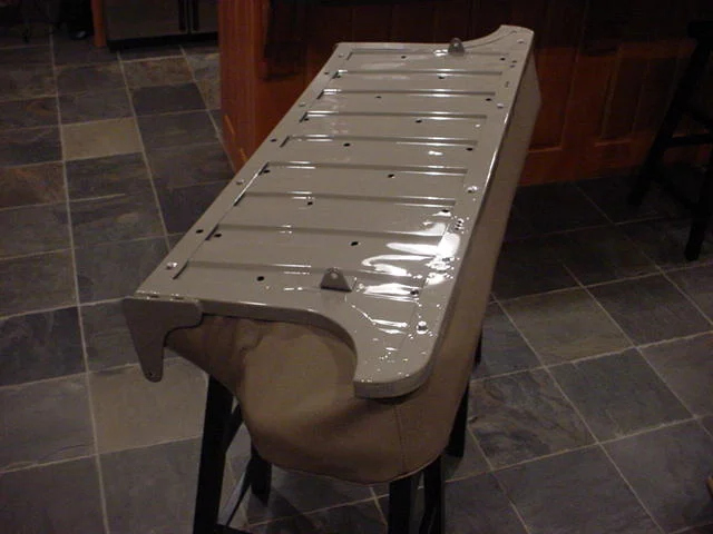

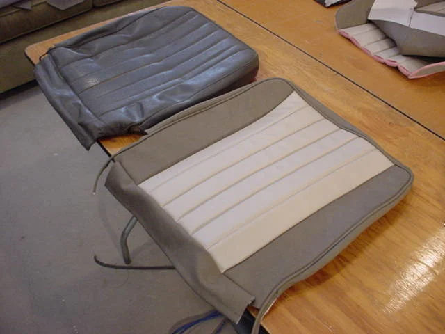

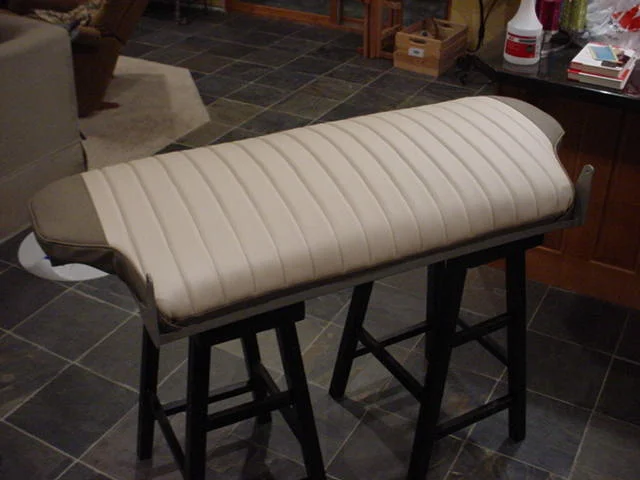

Fired up the Martha Stuart sewing factory early this morning Everything went pretty good.
We started the day working on the 2 bucket seat backs. Got those done by about 1 or 2 this afternoon. The girls starteed working on the rear bench while I started re-covering the bucket seats and hog ringing in them in. That went ok until I got to the new 79 seat foam I ordered from SOR. If you read a few pages back I commented on how much larger it was than the orginial. There was no way in hell the orginal size OEM covers were going to fit over that. I would have literally had to rip about 4+ inches to get it to fit. And after pulling on it so hard that it looked like the seams were going to blow apart I quit. So, I fixed up the original driver one pretty well, had to cut out some foam and adhesive in some new stuff. But got it looking pretty decent. Had to transfer the heat pad over from the SOR foam, but that didn't take to long. Needless to say, no more foam from SOR.
Rear bench covers took a while. A lot of pleats and they are extremely long, so it required several hands to feed them through the machine. But, we took are time, everything seemed to turn out really nice.
Anyway, few pics of the action today and some completed product.
Oh, and by the way........I personally sewed every stitch this weekend in all the seats I only mention that because I'm pretty proud of that. I do have to say though, most of the work is in the girls seam ripping, making patterns and getting everything ready to go, I'm just labor
Matt

more

Holy Crap,
Those look great! Now I am starting to wonder if you made the surfboard also. Why am I asking...you did make that surfboard.

more 2

more 3

more 4

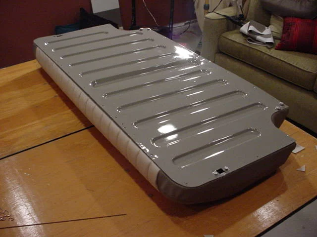

more 5
