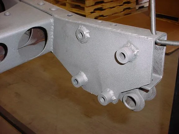

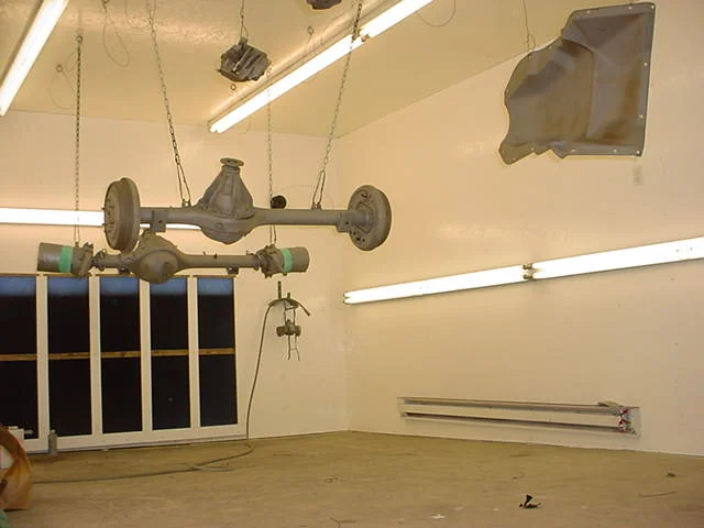

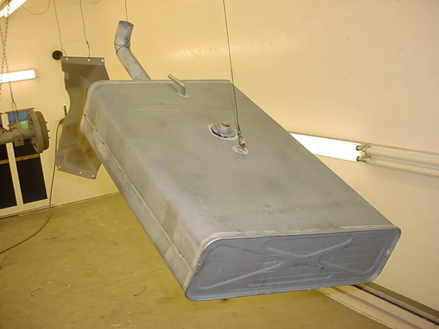

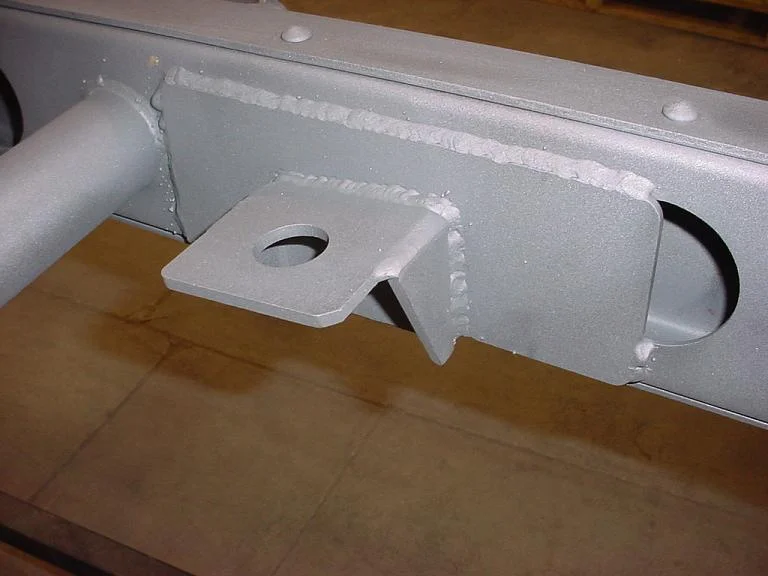

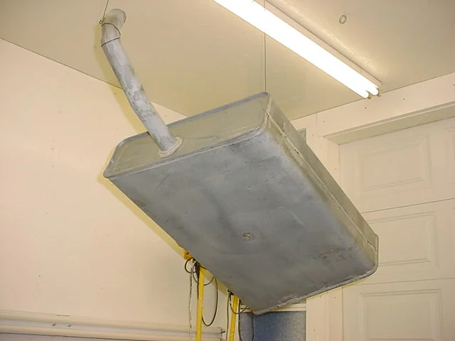

Got home this afternoon and got the axles, fuel tank and brake calipers in the booth. Prepped with DX330, 2 coats of DP90Lf and 2 coats of MTK single stage. Pics should show the results.
I have a couple small parts I'm going to throw in the blast cabinet tonight, but should be a go for powdercoating tomorrow evening.
Matt

Old 04-10-05, 06:37 PM   #64 (permalink)
Forum Lifer
buckroseau's Avatar
Join Date: Mar 2003
Location: Northern Minnesota
TLCA# 14759
Posts: 3,070
Quote:
Originally Posted by Mikesta
Curious as to how much 3 hours of this guy ran you... getting ready to do the same. Did you sand blast it or use other media! Great Picks!
$100 bucks and hour x 3 = $300. Yes, it was Sandblasted.
I have some fairly heavy duty equipment myself for blasint, but it is more cost effective to have someone else do it. I would have spent more in sand and time than him.
Matt

Old 04-10-05, 06:42 PM   #65 (permalink)
Forum Lifer
buckroseau's Avatar
Join Date: Mar 2003
TLCA# 14759
Posts: 3,070

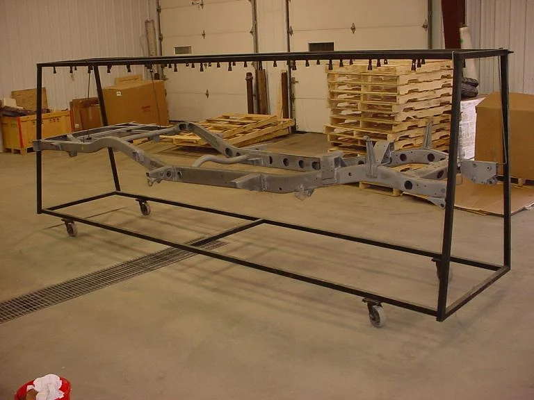

Quote:
Originally Posted by Radd Cruisers
When we did the FJ45 pickup, the frame was near mint with almost no pitting.
I see you have a fair bit of pitting the frame that will show up after powdercoating. Also I have heard thier are fillers you can used like body filler that stand up to the head??
Looks great.
Rob
Actually what I think your looking at is some areas that he missed, I think I could see how you would think that? I would say there is little to no pitting on the frame at all.
When I got home this afternoon I went through a couple bags of sand with my own equipment on the frame hitting a few small areas he missed. I'm actually amazed how smooth and how well the frame cleaned up
I know what your saying though. On my 77 FJ40 that I restored there was significant pitting on the frame. I didn't powdercoat that frame, it was painted, but if you look for it you can see it.
I think this frame is going to come out of the oven looking awesome. I will have pics tomorrow.
Matt

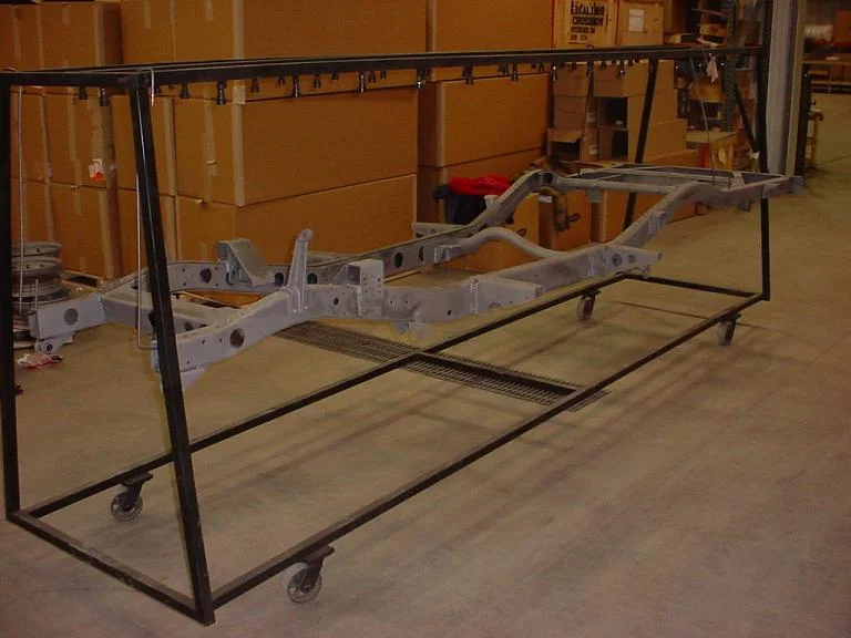

One more pic of the night, fresh out of the blast cabinet ready for powdercoating tomorrow.

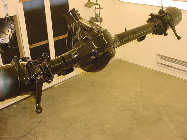

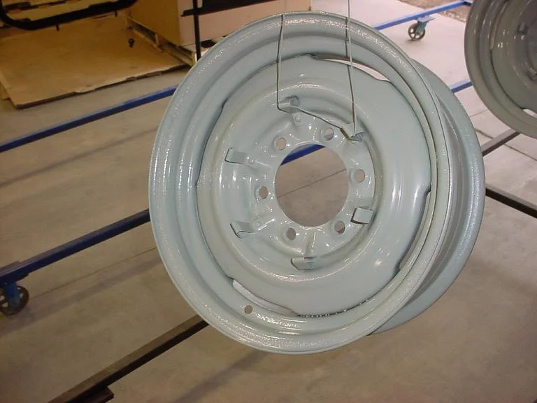

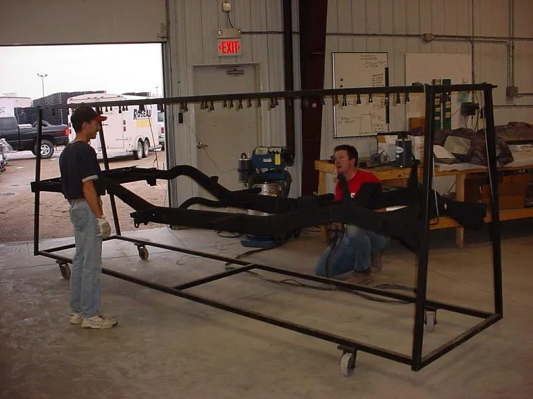

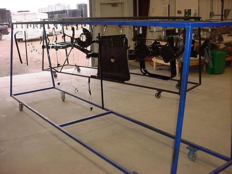

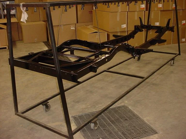

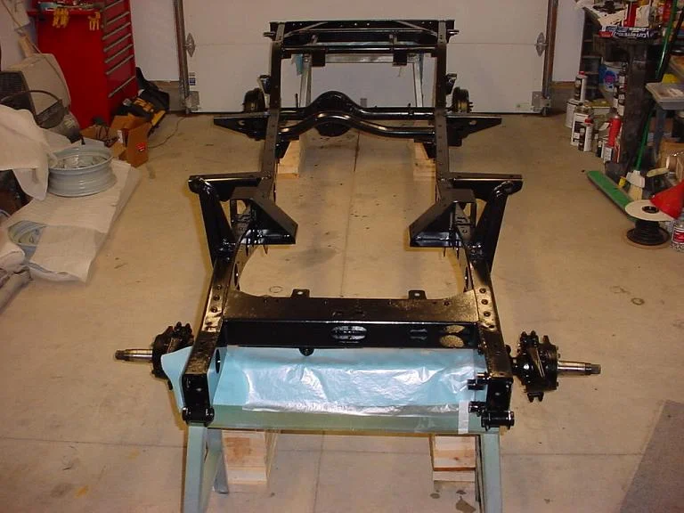

At the powdercoat place right now using there computer. Figured I better post some pics while we were waiting for everything to cool down.
Everything turned out really nice Black covered all the parts very well.
We sprayed the rims with a color that on the chart resembled electrical panel grey. Although when sprayed and baked on they seem a little light I don't know, pic of one of the rims. See what you think and make a comment.
Matt

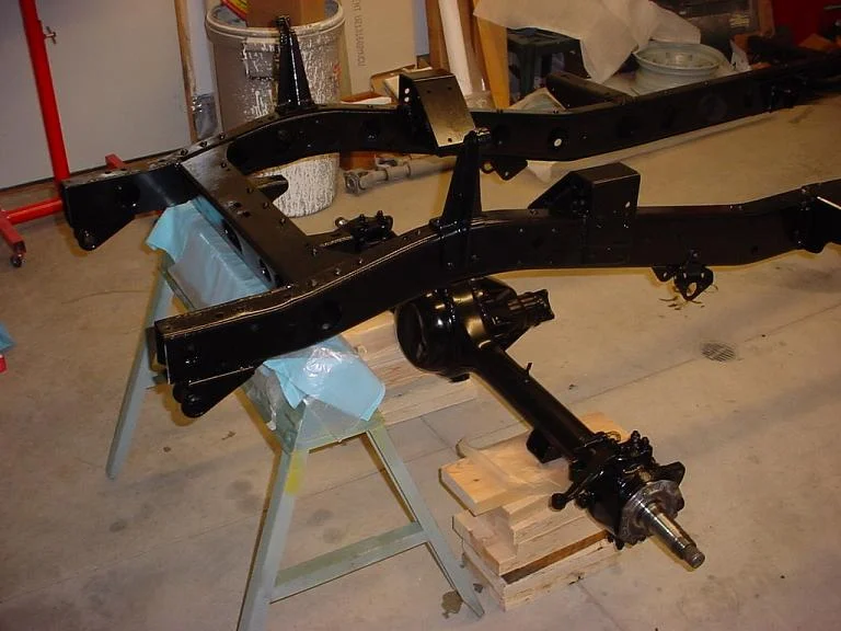

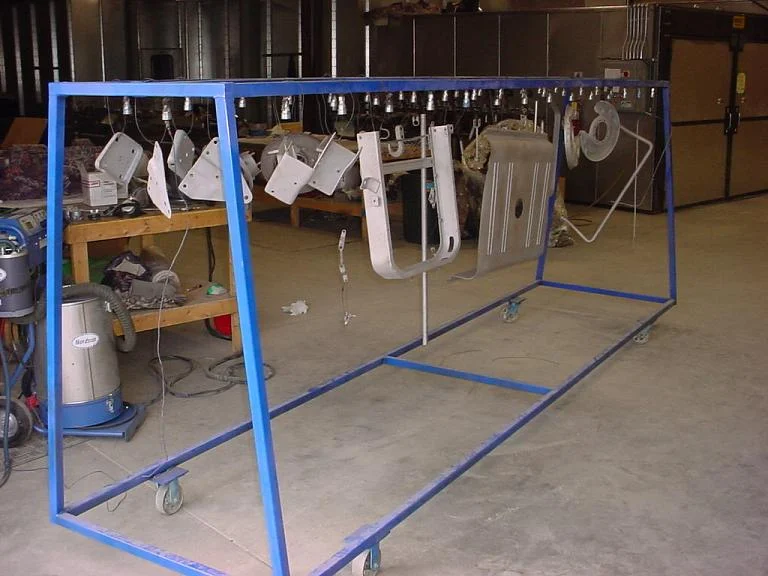

more pics

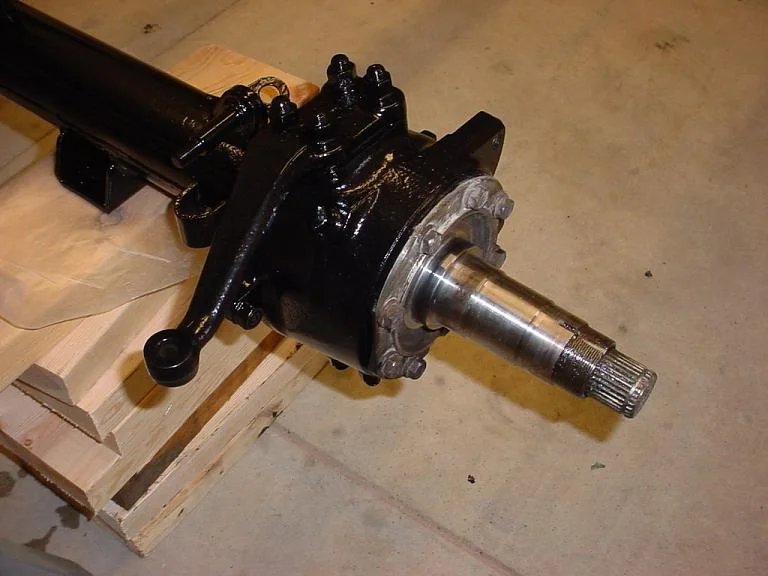

Posts: 3,070

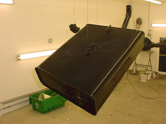

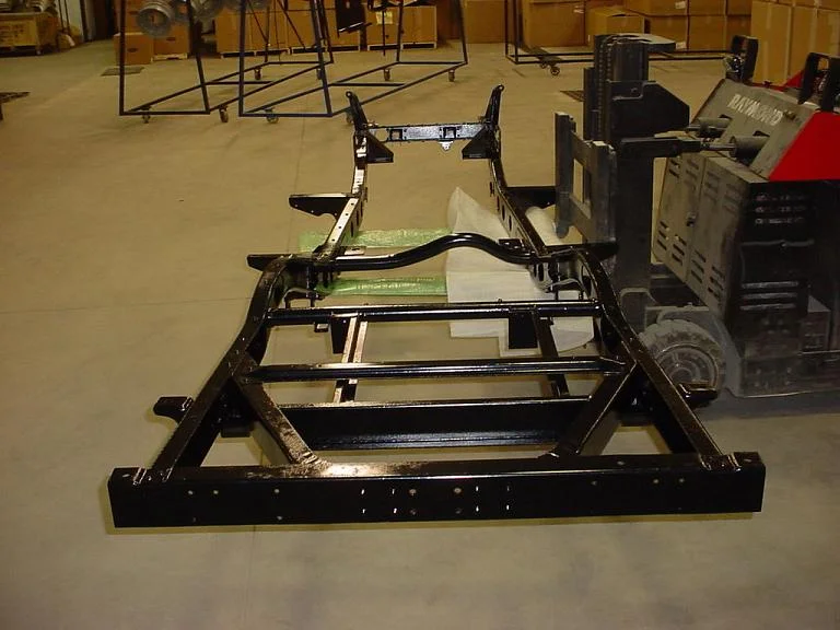

even some more

Posts: 3,070

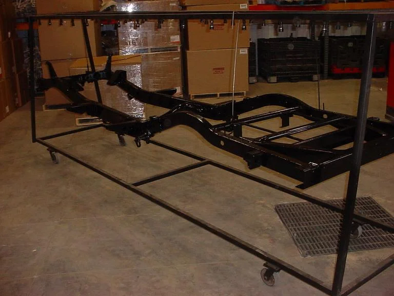

1 more

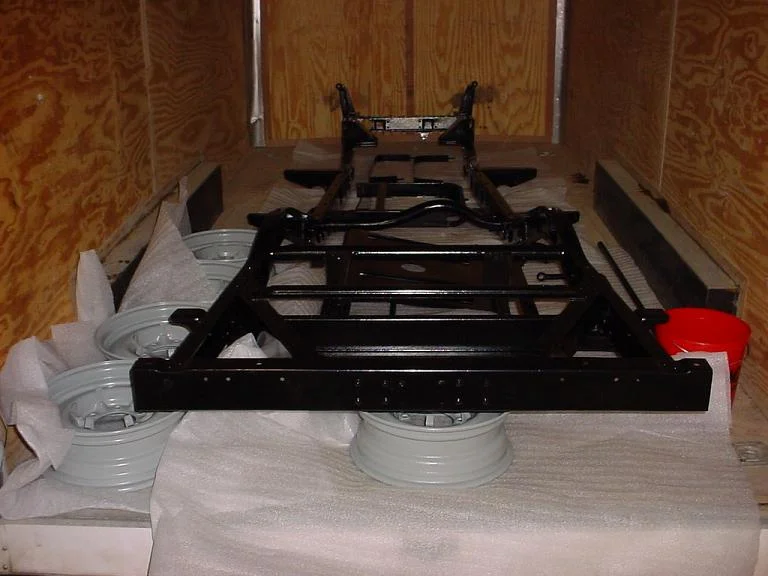

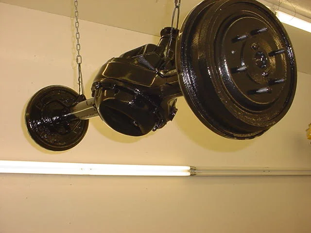

A few more being loaded for the trip home
Matt

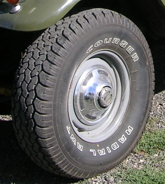

Someone once wrote (I think it was LandPimp) that the 1960s FJ45 LPB rims were black out of the factory. True or not? Was it also true for 45 LVs?
Anyway, on one hand, I agree that they look a little light for the "correct" factory grey. But on the other hand, as I compare, maybe not. But then on the other hand, there are 5 shades of grey inside my 45LPB, and the rims that came with it were yet another shade (I think they were original).
That said, I think I'm gonna cry, too.

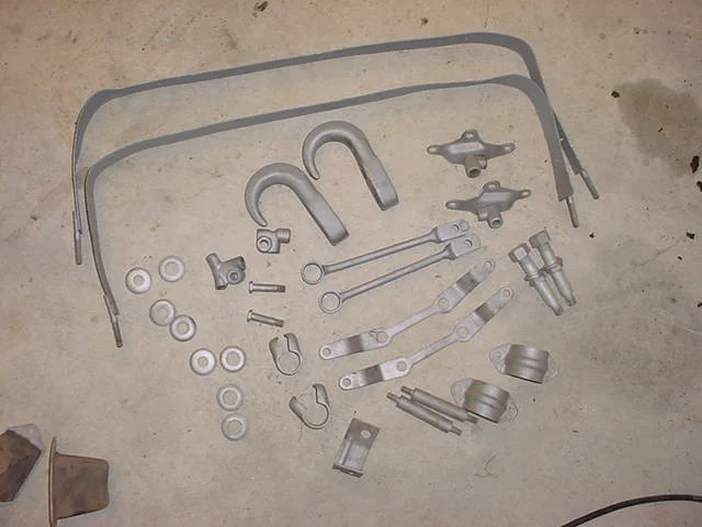

End of hijack. Now educate me. I recognize everything in the small parts pic, including the shock washers and brake line junctions. What I do not recognize is the two studs that are threaded at both ends. Are they part of the gas tank straps or something like that?

AKAIK, early to around 67 the wheels were black on all 40-45's. 25;s and early(prolly just non US 61-63) 45LV were body color.
Quote:
Nice job!
I beleive they hold the gas tank skid plate deal?

Slacker! I know you've got more elbow room, now the 40 is gone. Sounds like we might need an intervention. Maybe when I come back from Tin Benders
Brett is correct. They hold the gas tank shield, rear holes of the shield.
I will take some pics when I get that mounted.
Matt

Posts: 3,070
Rim Color
I guess I'm not so concerned about what is orginal color. I do want a orginal color, but it doesn't have to be year specific.
Just trying to get the correct Toyota grey.
Matt

Gotta love a freshly powdercoated frame, after 3 years the FJ45 still shines line the day it came back from P coating.
Looking real pro.
I often wished I had dipped a body, after a period of time you still see rusty water seeping from seams.
Only concern with dipping washing and dipping in Zinc is the health concerns when working on the body.

Posts: 8,206
Quote:
All my Dunlop RK3s [original equipment tires from the '60s]are mounted to grey coloured rims,
except the ones that have black paint over the grey

all my lit from the mid 60's shows black wheels(my 65 fj40 has the orignal black wheels on it still), I just tossed an orignal black wheel with a Dunlop RK3.......it was bald and dried out.........but I still had issues tossing it.
Quote:
__________________
Truth is a torch that shines through the fog without dispelling it. Always be true to your work, your word, & your friends, & you will never live a day without peace
Landpimp is offline   Reply With Quote

Original rims on both my 66LV and 65LWB pup are black.
Nice work!
