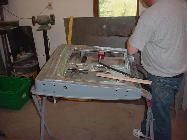

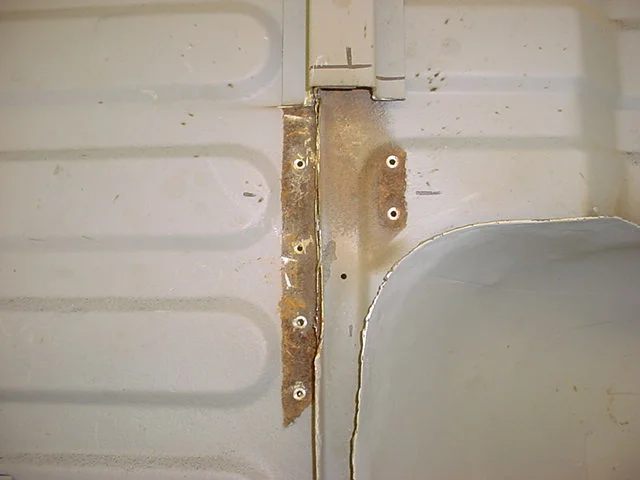

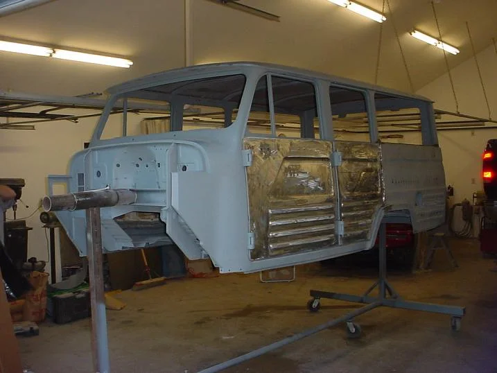

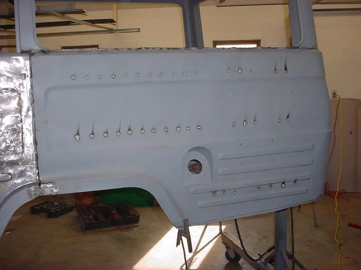

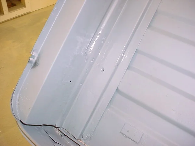

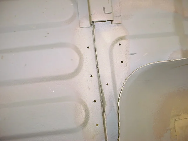

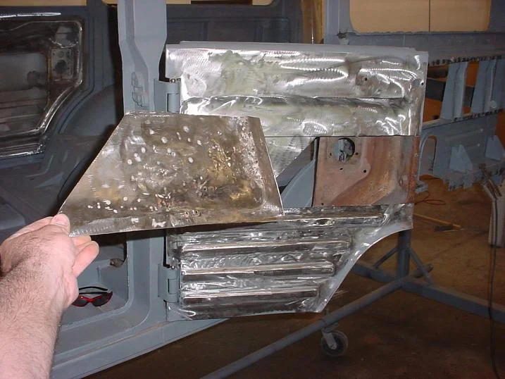

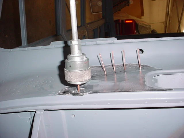

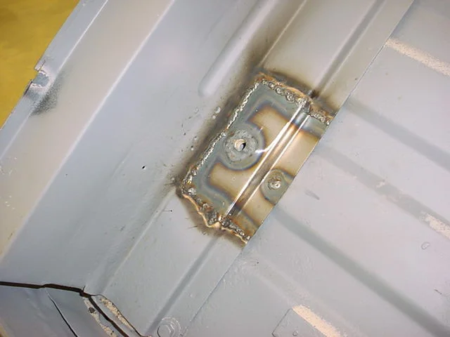

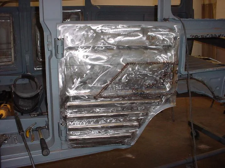

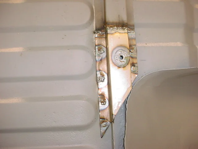

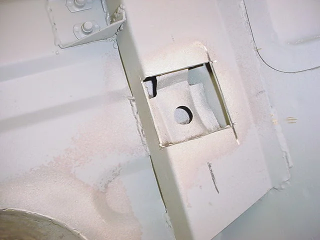

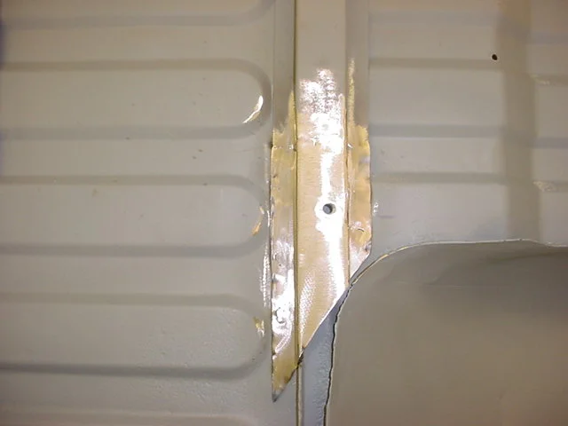

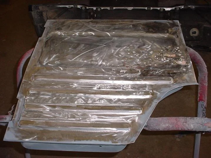

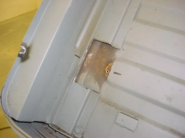

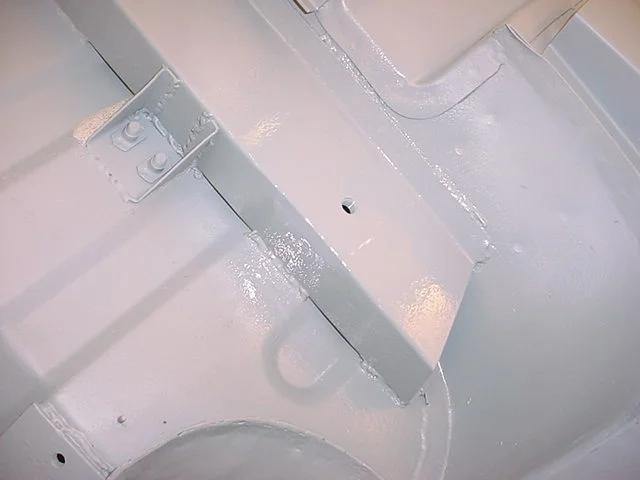

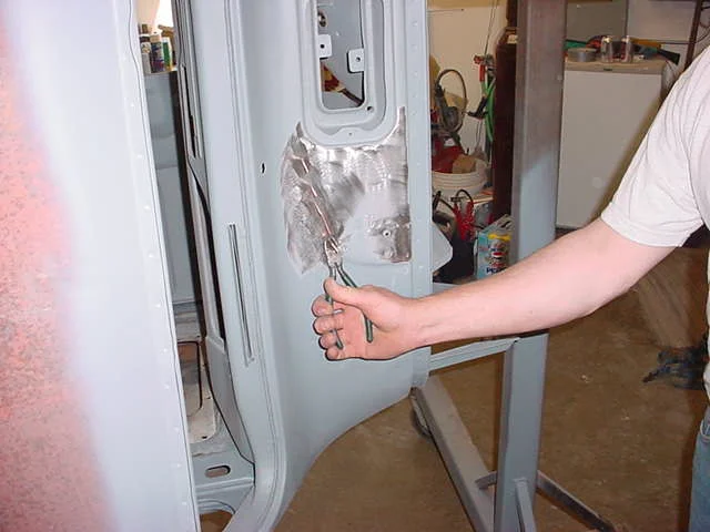

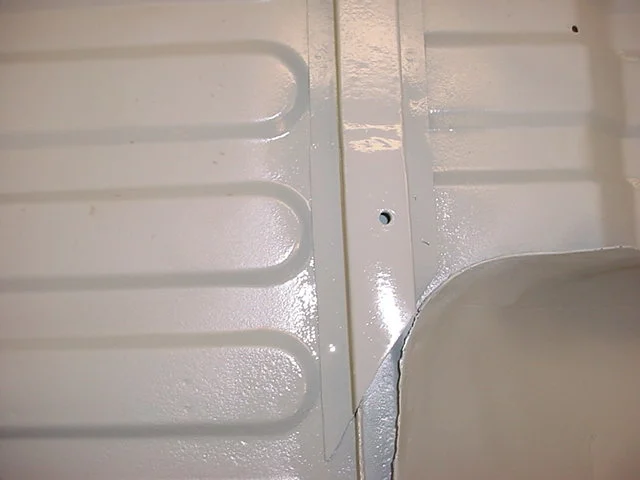

Pics in this episode are from all day Saturday and 3 hours Sunday morning. Put in about a 13 hour day on Saturday and got a lot done. Sucked a little because it was about 95 degrees out so it was HOT!!
Pretty much had to beat some more on that inner pannel and keep re-working that to get it straight. Also ground down the 2 drivers side doors with the zip wheel. Off course the rear drivers side door had about an inch of filler in it Must have been some collision to do all that damage on that side. It was bad enough where my buddy said we have to cut out that section just to straighten it, so there were a few extra hours just in that rear door to get that panel straight and the rear jam.
Got that rear quarter installed back on right this time, after all the pushing and pulling got everything lined up pretty decent, at least 95% better than it was before. Hung both doors, those new bushings in those hinges just kick ass!! Just amazing what a new set will do compared to the old ones.
Ran up there this morning about 7 am and put in about a 3 hour day. Got the driverside rear wheel well back in, took at least an hour and a half. Also my buddy and I did some work with the hammer dolly on the rear floor because it must have had some real heavy stuff in at one time and had little dents all over the place, that turned out good. Front cowl was caved in a bit on the upper right side, hood never fit the day I got it and was full of bondo. Did some work with the stud gun and slide hammer and got it pulled out about a 1/2 to 3/8 inch. Going to need a little filler, but not much now.
And since it was another 95 degree day in Minnesota with humidity threw the roof, off to the lake it was this afternoon for some Jetsking and fun in the sun!!
Heading back up tomorrow night for about 3 hours of work with the stud gun and slide hammer on the rear quarters, but after that. It comes back to my shop for another week or 2 of work and then back on the chassis.
Matt

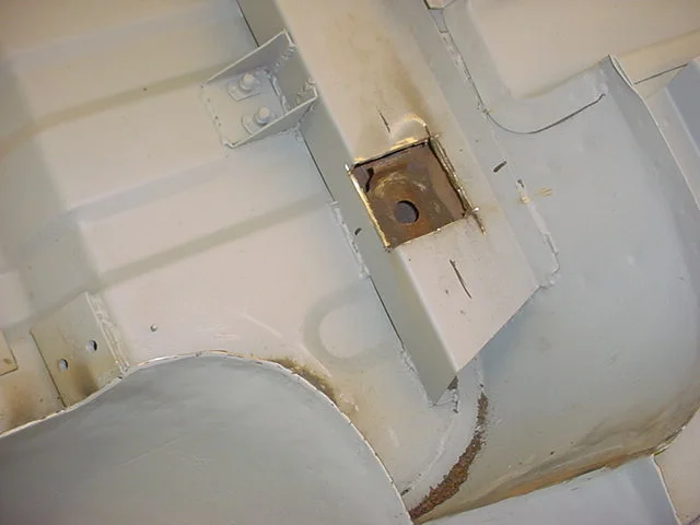

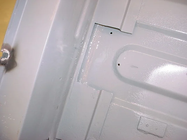

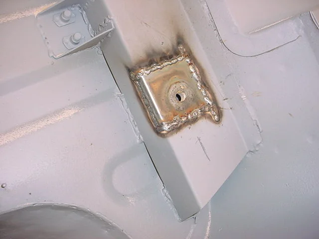

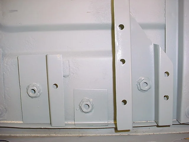

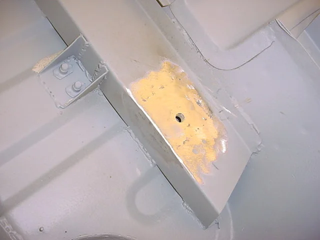

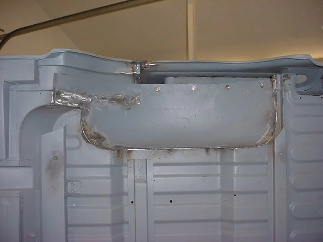

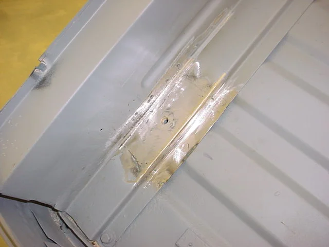

Well, in this episode . . . it was 95 degrees with about 95% humidity today. Oh God was it hot! I actually worked outside pouring concrete at my house all day so I was a little tired this evening. Managed to get a little work done tonight on the LV.

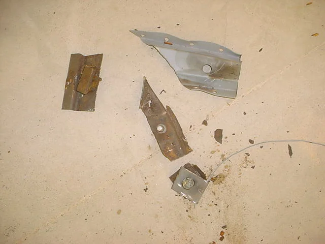

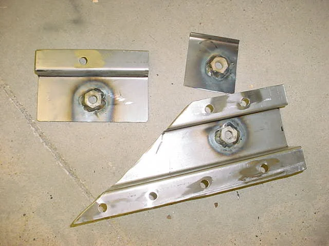

I think I mentioned a few posts back that some of the body mount bolts had busted off when we were taking the body off the chassis, 7 to be exact. There are 14 mounting points on a LV body, 8 of these points are a blind type nut. Meaning that the factory boxed the mount inside a channel and they were never meant to be removed. For weeks I have been applying penatrating oil to these broken studs/bolts. Tonight I used 1/2" nuts, cranked up the heat on the welder and welded the nuts to the stud. I tried to use the impact wrench to bust them loose..........Some broke off again even closer to the blind nut, others broke loose inside the channel and started spinning the blind mount. Had to take a different approach.
Tackled 3 on one side tonight. Cut open the channel and removed the blind mounts totally. After seeing them when they came out, there was no way they were going to move, so the right decision was made. Of course, sandblasted that area, epoxy primed. Then made new sections of channel. I used 10mm x 1.25 nuts, drilled holes in the new pieces I made in the same location as the old ones, and welded the nuts on the back side. Primed the back side of my pieces and welded them in and primed.
Now, this should work. The main difference here is that the blind mounts were in a cage inside the channel so that the mount could float a bit. Maybe an 1/8" in any direction?? I imagine it gave them some room for tolerance errors when it was coming down the assembly line. I thought of doing something like that again, but a ton of work and I think this will work better in the long run. If it is off a bit on the frame, I can slightly slot the hole on the frame if I have to and I know it will be no more than an 1/8" in any direction.
We'll more concrete tomorrow, but hoping to get the other side done tomorrow night We'll see how tired I am?
Matt

some more

even more........

mmmm.....more...

last 3 of the lv...

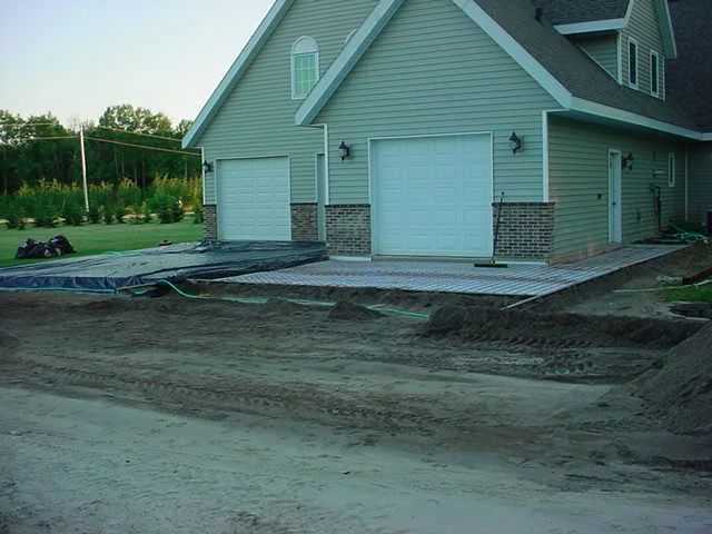

mmmmmmm..........concrete..................
