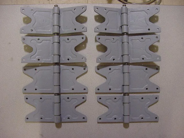

Oh yes, the hinge thing has not gone away yet. I have a little more insight to this now. I brought the hinges into work this morning to take a closer look and pin them together. This is what I'm observing.
Hinges 1,2,3,4 if laid flat in line with each other all have the same pin distance from the mounting surface to the pin center.
Hinges 5,6,7,8 if laid flat in line with each other all have the same pin distance from the mounting surface to the pin center.
Hinges 1,2,5,6 - the 4 bolt patterns on those hinges are all different, you could NOT put those hinges in any other spot because they could not line up. The bolt patterns are specific to each hinge.
Hinges 3,4,7,8 - the 4 bolt patterns on those hinges are all the same, you could put those hinges in 2 different locations. This may explain why Treeroot has a 7/8 hinge in the same location Mikesta has a 3/4
Hinges 5,6,7,8 when pinned together lay completely flat on a table.
Hinges 1,2,3,4 when pinned cannot lay flat on a table, the hinge will bind at about a 20 degree angle.
I think I have everything correctly pinned together and it all seems to make sense. Why Treeroot has that 7/8 hinge in the front doors lower hinge location?? I don't know? Like I said, 3/4 and 7/8 are the only 2 hinges sets you could switch like that, the only difference would be pin distance.
Matt

I just dug out my old fiche. It only identifies part numbers and makes no mention of the numbers stamped on the plates, sorry Matt.
D-

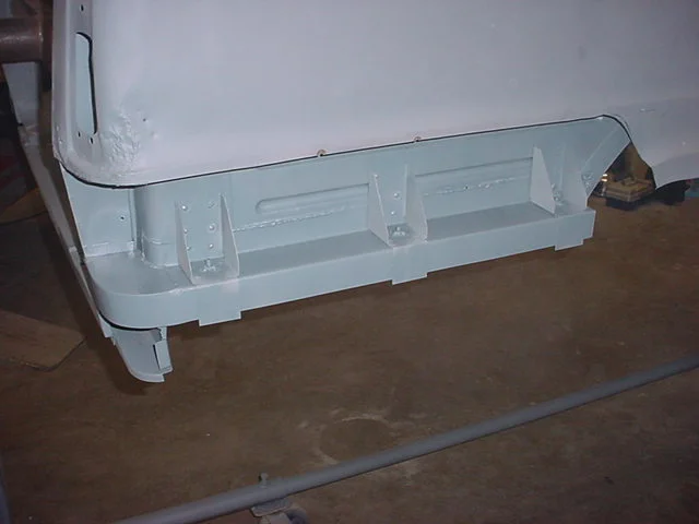

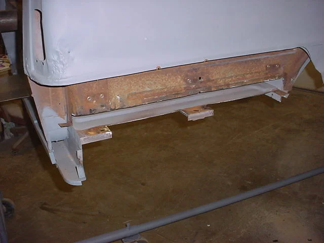

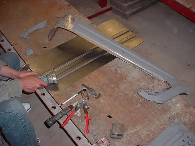

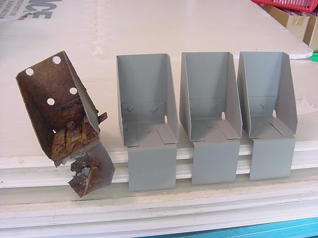

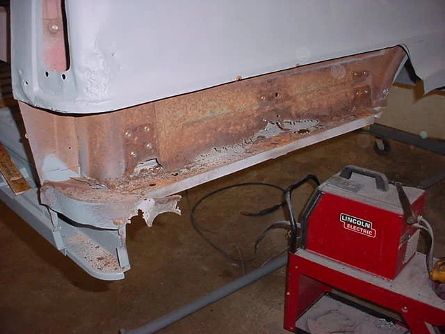

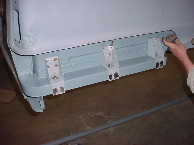

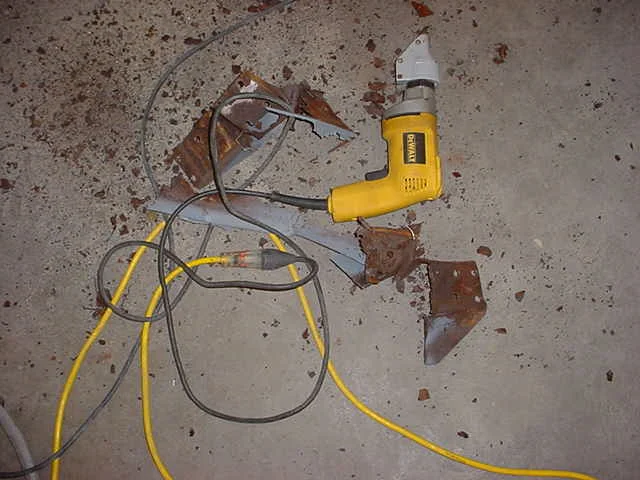

Little out of sequence, because I will hopefully have more pics of yesterdays progress and tonights progress posted this evening.
I went home at lunch, took about 45 min. to bend these up and get them welded together. There were 3 on the right side after we remove the quarter that were totally rotted out except for the one you see in the pic. It will be more obvious after I post pics of that tonight.
Figured I would get this done, so tonight I can stay ahead of my buddy on that quarter, need to get the inner guts done first.
Matt

That's ok, thanks for looking! I think Toyota semi - idiot proofed it by having different bolt patterns for each individual hinge. They can only go in 1 spot and that's it.
Except for 7/8 and 3/4 Those have the same pattern, but are not the same as any of the others. I do believe that the 3/4 is the front lower hinge and the 7/8 is the rear lower just because of the pin location of 3/4 to 1/2 (are the same) and 7/8 to 5/6 (those are the same). Seems to make sense. Worse case I just have to take out a few bolts and switch them around now
Why treeroot had a 7/8 in the front lower spot If someone else pulls them out........... might confirm this or shed some more light on it?

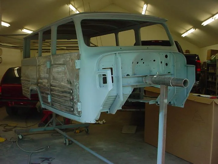

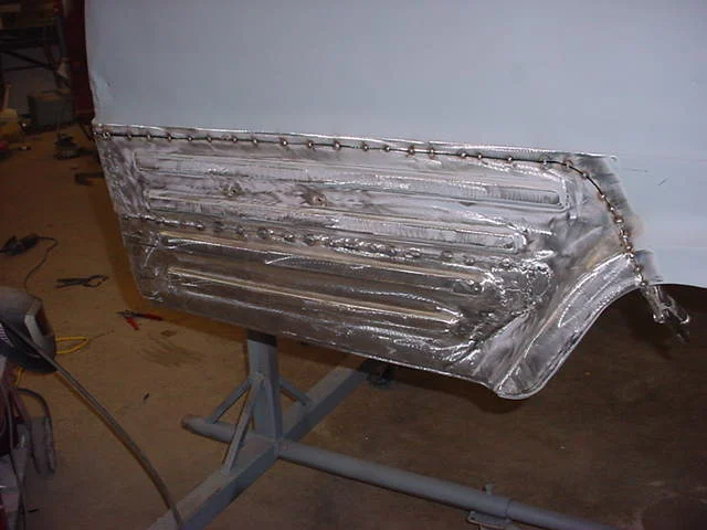

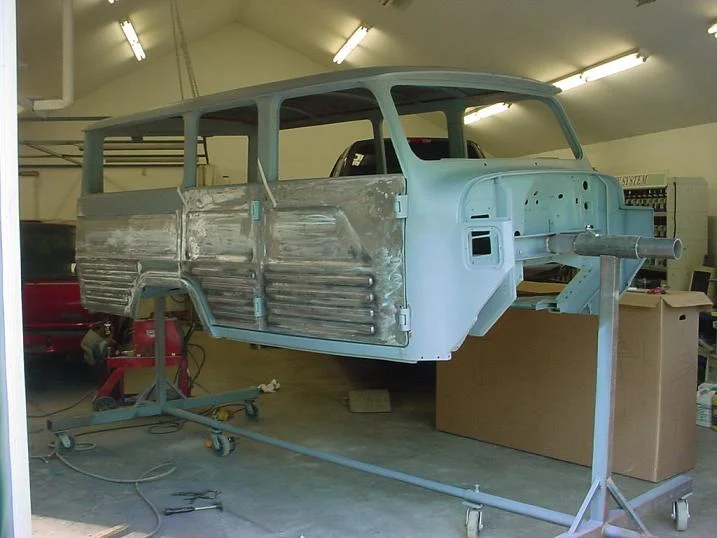

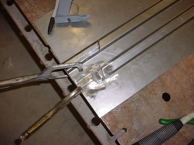

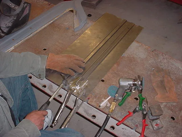

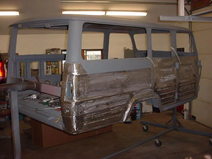

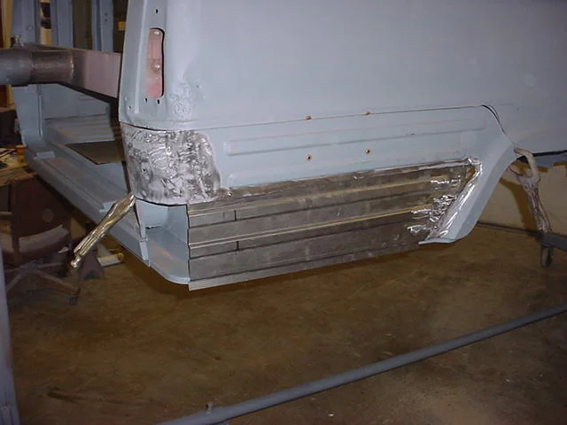

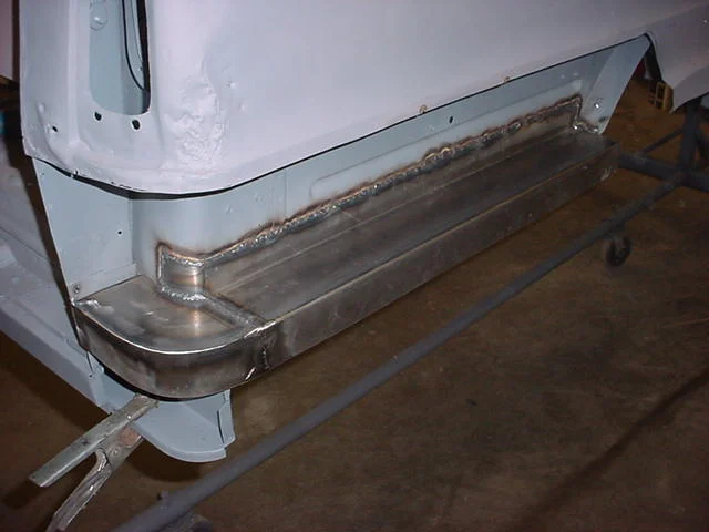

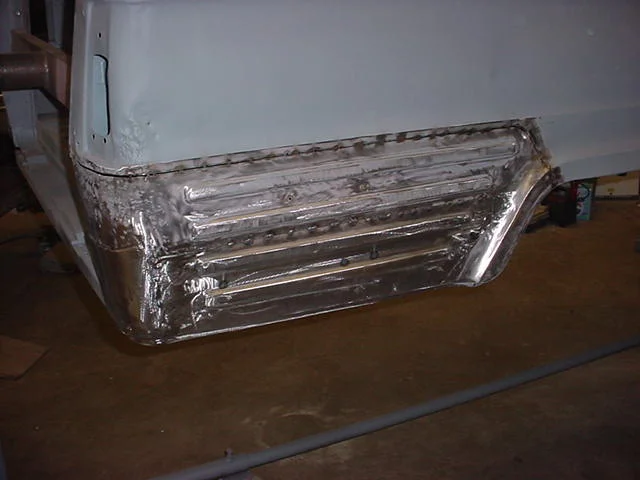

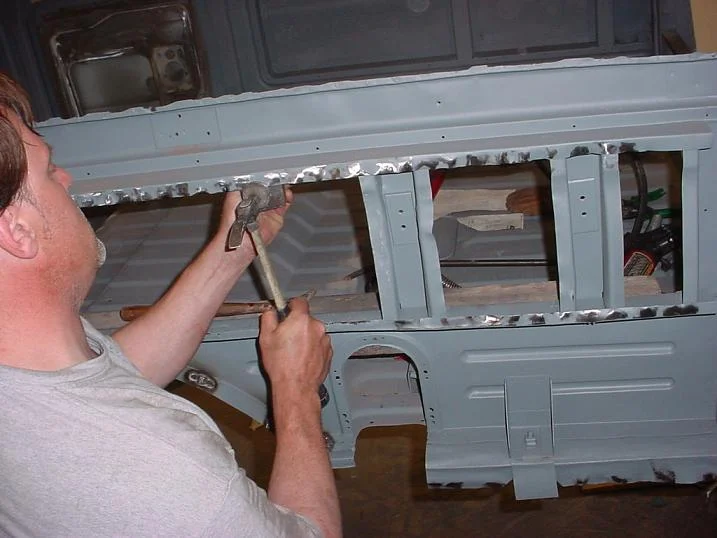

Just got back, brought the camera with me this time.

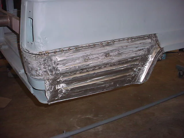

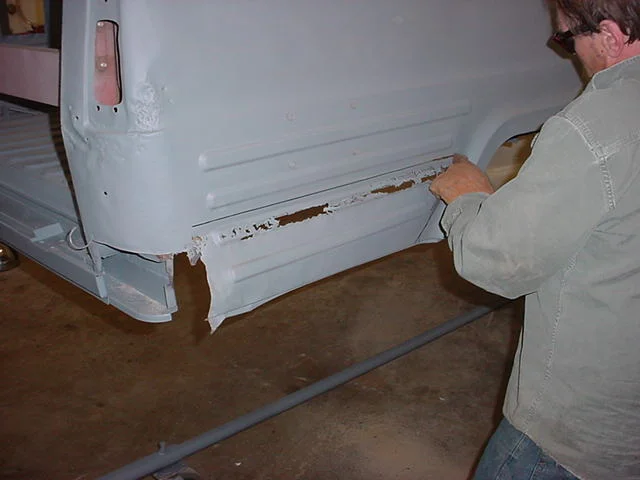

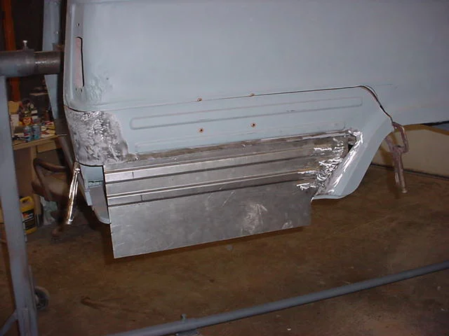

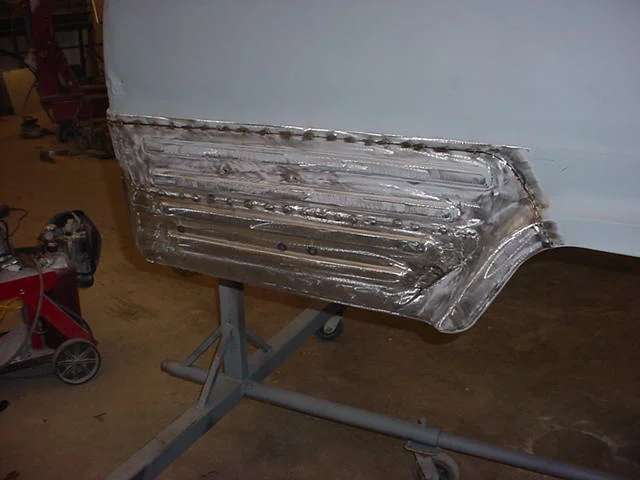

Pics are from 2 evenings of work now. My buddy pretty much worked on fabbing a rear quarter from thin air. While I spent time cutting out rusty metal, blasting, priming, welding in new metal, priming.....etc....you get the idea.
You saw the pics from earlier today of those triangle pieces, should be able to see them installed. Had to make some inner structure than curved around the back also.
Remember to share the vision here, nothing is primed yet, but there is a quarter panel tacked in now with ablsolutely no rust, primed inside and out with epoxy primer and ready to be fully welded in.
Another evening and we figure we will be wrapping up this quarter. Might fit the doors on this side next just for fun, something different before we move onto the other side.
Matt

3 more

1 more

Not a ton of pics tonight, but did a ton of work. Both me and body dude kicked ass tonight, wasn't much time for pics.
I spent a good portion of the even welding the quarter in. Took some time, lot's of welding. Lot of time grinding all the welds down, but turned out real nice.
My buddy got to try out those new hinges and bushings While I was welding he zip wheeled down both passenger side doors. We installed the rear door, which went amazingly well. Unbeliveable how a new set of bushings make it seem like a new vehicle, well almost. Before the doors were hanging on there and fell out of the jam when you open them. Now, tight and rotate nicely. The front door, not quite as easy. As soon as bolted it on and tried to close it my buddy new something was wrong. Since he does this for a living and is extremely good at it, some quick measuring on his part he determine that the A pillar was bent back, so the top hinge mounting point was pushed back also. From all the bondo in the front end, broken shock towers and everything else, it seemed to make sense that it took a hard hit in the front corner. Some quick straighting on his part with his tools.........perfect. Truley amazing watching someone who knows exactly where to push metal to make it fit. Anyway, both doors on that side closing nicely, no mechanism's, but well enough until it's back on the chassis.
Once we wrapped up the passenger side for the most part, at least for metal work we moved on the driverside. This is the side that had that severely bent up inner panel Not good, even my friend was shaking his head on how twisted it was. A good hour and half of jacking, heating, dollying, hammering, hammering, hammering, hammering, hammering................hammering...............a nd it's some what close.
Heading back up there Saturday morning, hoping with more hammering and jacking we can get it some what acceptable Then re-install the quarter, doors and with any luck might have the driver side metal work done by Saturday night.
Matt

1 more, more hammering......................
