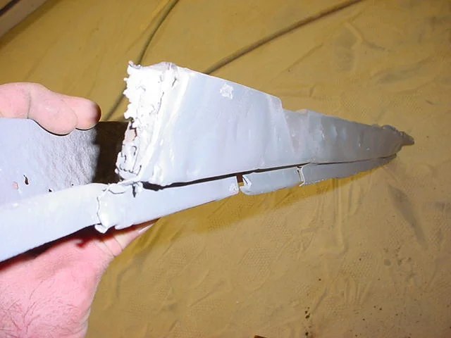

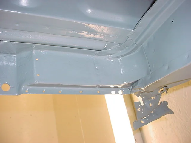

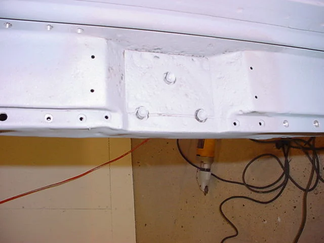

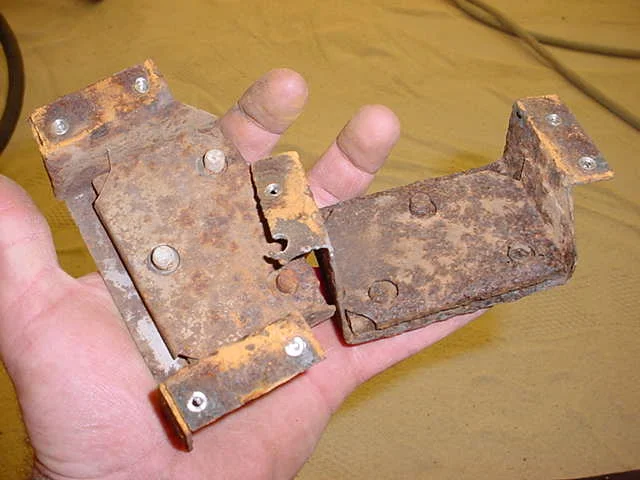

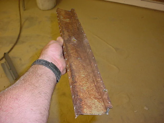

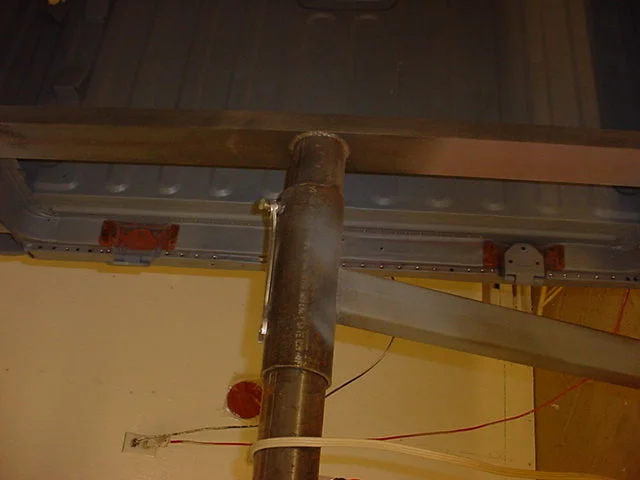

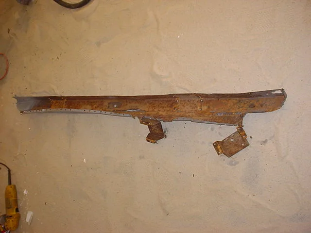

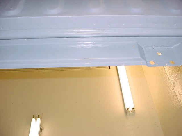

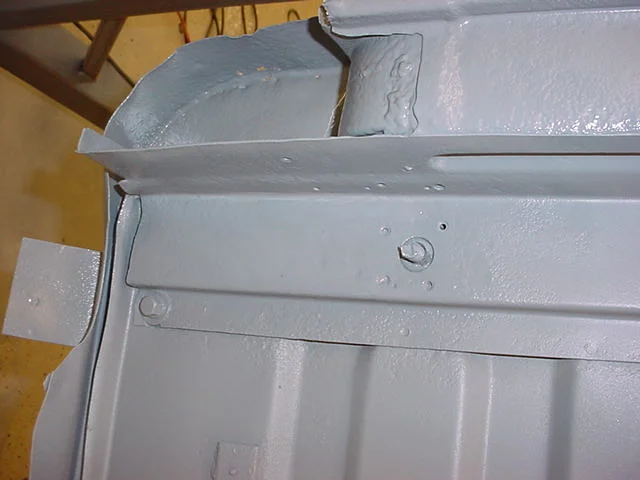

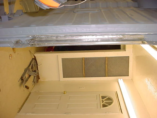

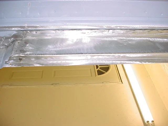

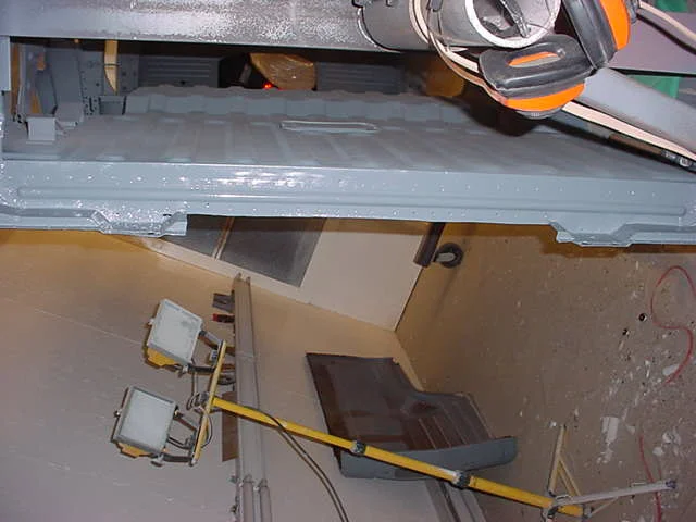

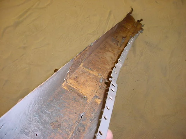

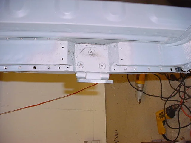

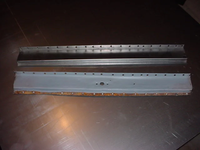

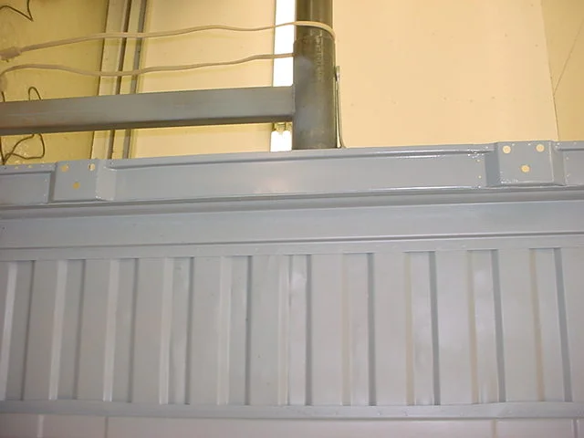

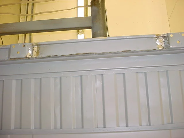

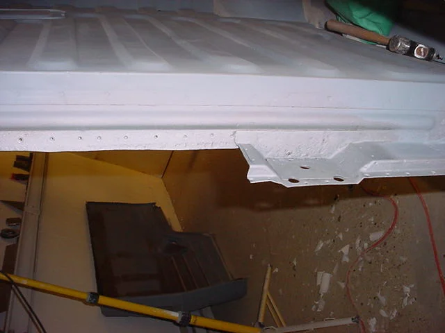

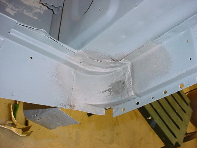

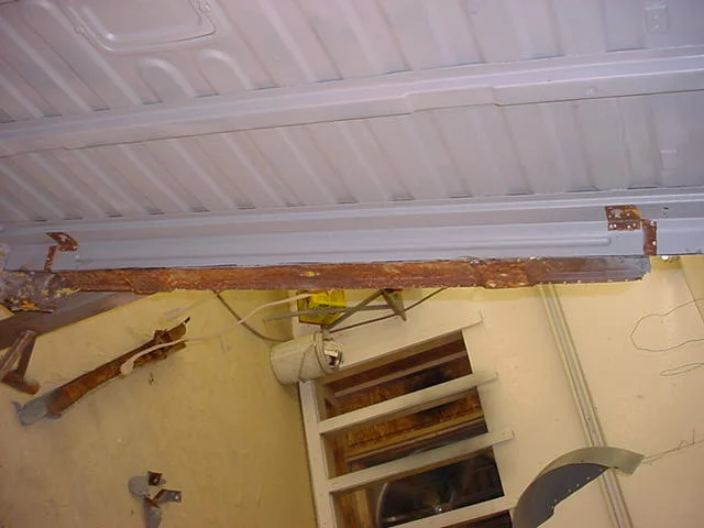

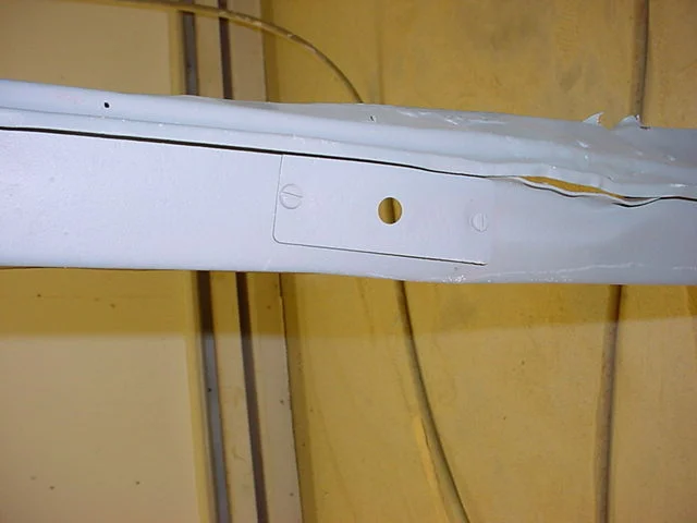

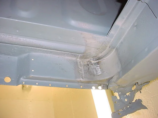

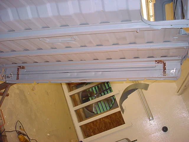

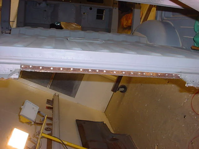

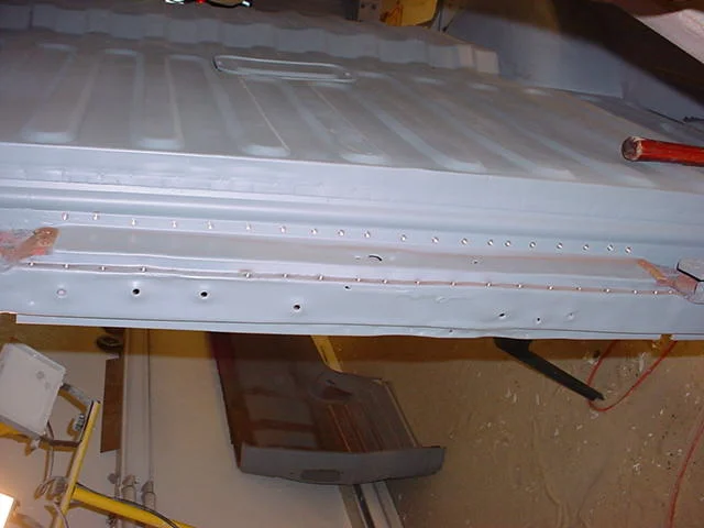

06/27/05
Got a couple hours out in the shop tonight. Figured I would tear into that rear sill that is all bent to hell.
I removed those covers that cover the rear hinges on the sill. I'm pretty sure this vehicle was orginally red on the lower half, always kinda suspected it, but confirmed once I removed those covers.
I blasted the tops of the philips head bolts to get a better bite with the impact driver. I busted the bit in one of them, absolutely rusted solid on all 6 of them. So, I drilled all of them out.
You can also see the spot welds I drilled out on the rear sill, and then cut into a portion of the upper sill on each side of the hinge mounts, it was bent pretty bad in between that area. Sheared along the back side, that was also bent pretty bad, so took all of that off. Figured I would go with all new straight stuff.
Got the rust stuff blasted and primed tonight, so next time I'm out there I can start fabbing and welding in sheet metal
Matt

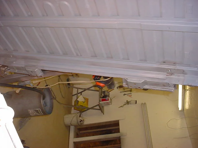

lot more to go

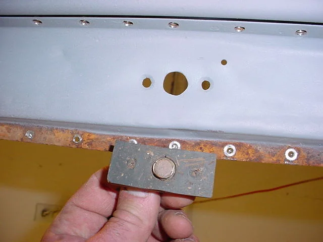

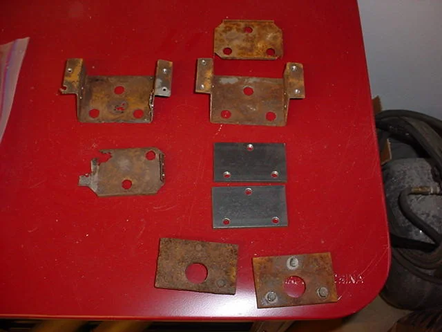

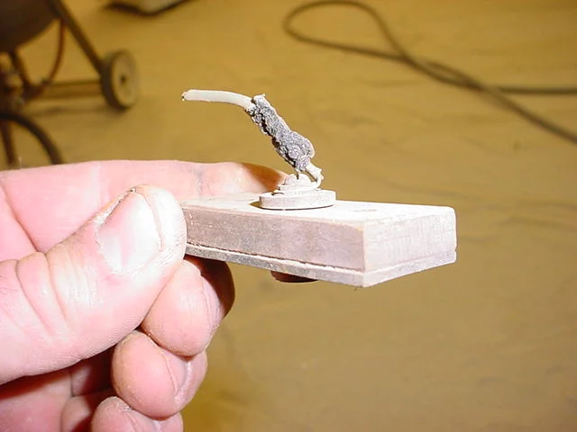

What is this little small part with the wire on it? It was floating around inside the boxed in area in the rear sill? I'm assuiming it bolted or screwed into that rear hole in the sill that I took a pic by a few photo's down????

the little box with the wires is the contact for the licnese plate light. Turns off when the tailgate is open, on when shut.

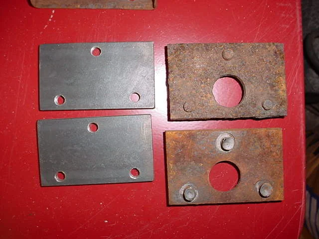

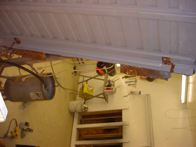

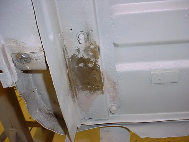

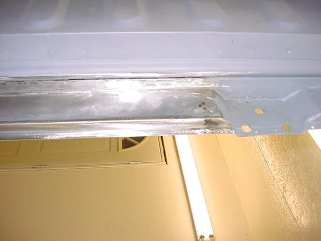

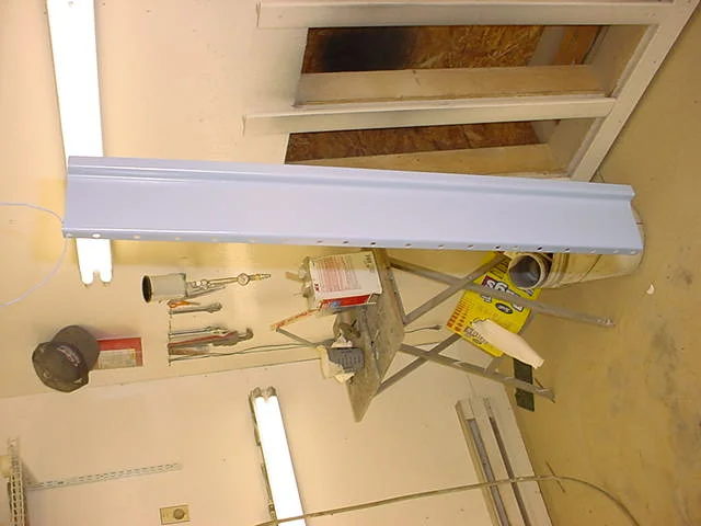

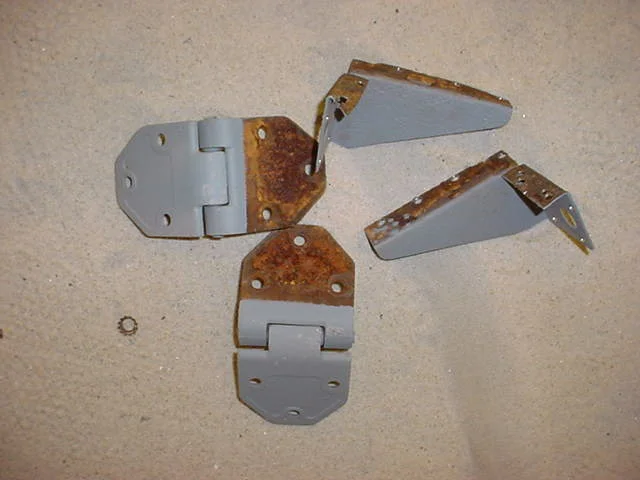

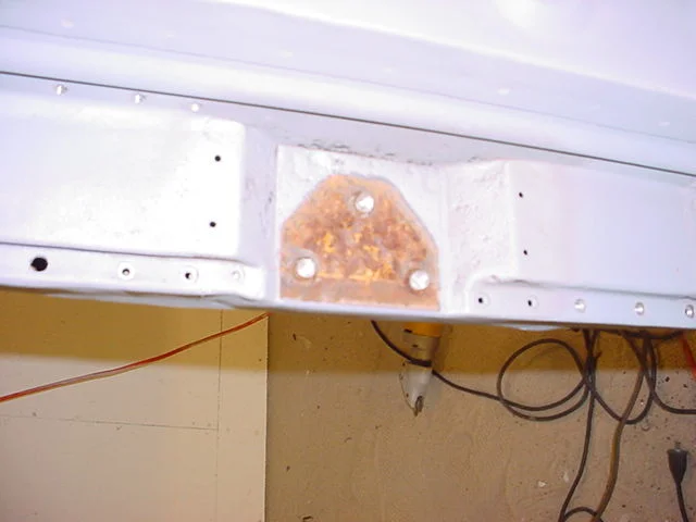

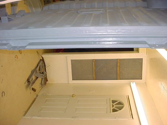

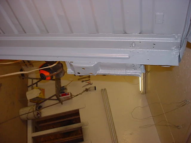

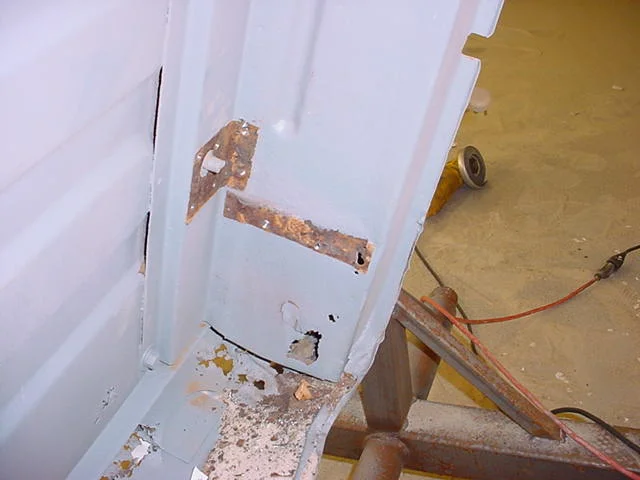

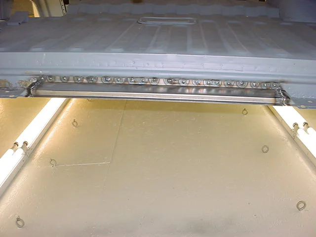

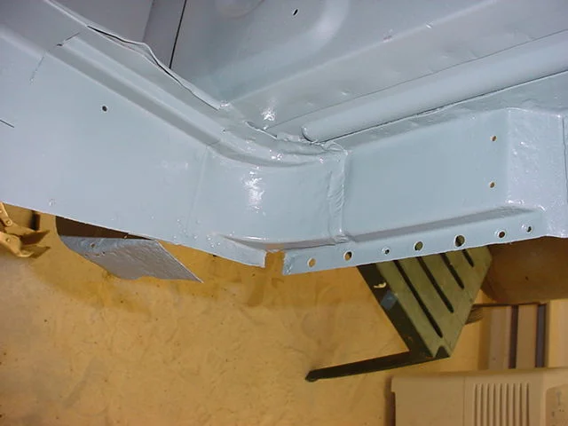

06/30/05
Got another couple hours out in the shop tonight.
Started by fabbing up part of the new rear sill piece I cut out between the hinge mounts. As I said before it was bent to hell pretty bad, not so much rusty, just bent up as it had been hit in the rear at some time.
Anyway, pics of the new part, welded in ground down and primed. I am very happy with it, after primer anyone would be hard pressed to see what I did
Also started taking apart the hinge mounting boxes that were inside below the sill. I think I will be using one of those mounting boxes and most of the other, just have to bend up a new piece of tin that holds the large plate with the threaded holes. I also cut up and tapped 2 new plates that will be going in there. Pretty basic, 1/4" thick steel, 2" wide, 3 3/8" long with 3 - 8mm x 1.25 holes.
Anyway, pics, Matt

some more

last 3 for today

That last pic matt... Those bolts are the SHIZAZ... I havent started torquing on mine yet (actually just a little)... but they are soaking in goo.... Is it real tough to get those plates out? and when the new plate is in ... are you going to fab your own screws or do you have a source?
LOOKING FREEKING AWESOME!!!

Quote:
Mikesta
Getting the plates out of those boxes or holders is fairly easy. Getting those complete boxes/holders for the plate assemblys out is fairly hard. You have to get into the rear end in that complete boxed in area. For me because that are was SOOOO....bent up anyway, I had to cut it out and I was able to get in there. If your rear end is not bent up and ful of rust, I would highly doubt you will be tearing that apart. If they don't want to come, drill the heads off, drill through the bolt with a 1/8" bit first then a 17/64, then tap with a 8mm x 1.25.
I haven't looked for those phillips head bolts yet in that dia. and pitch, but someone must make them.
Matt

Got a couple more hours out in the shop tonight. A bunch of little stuff I had to touch up with the welder, grind down and prime. Doesn't look like much, but took some time.
I also fabbed up a new part for those hinge boxes that are inside the rear sill. I blasted the remaining parts I was going to re-use and primed them all. So next time I'm out there I can start welding those back together, shouldn't take more than an hour.
I plan on taking the entire day off of work tomorrow to work on the LV. I would love to fab those 2 remaining sill pieces and get everything primed and welded in. We'll see I guess?
Only thing that might stop me is that I've been waiting about a year now for the concrete guys to come out and pour my apron in front of my garages. I had spoke to the main dude a couple days ago and he said possibly this week. If that happens, I'm sure I'll be out there all day........
Matt

3 more
