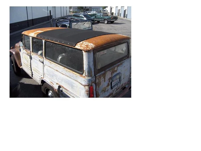

Quote:
Originally Posted by cruiser ken

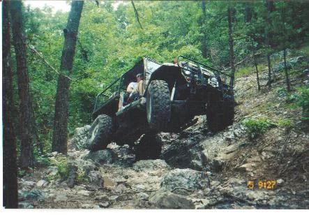

My '82 FJ45, currently stock, I've got a fiberglass top for it as well as the factory soft top bows and a new softop. Has the large drum brakes all the way around, the 16" wheels barely clear the drums. I haven't decided what my plans are for it yet.
Hey, I recognize that driver's seat!

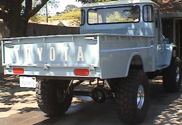

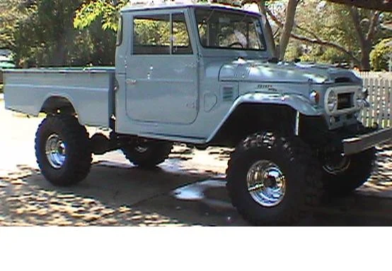

Project finished 67 FJ45LWB
OK, 6 weeks later and I'm done. Here's what was accomplished.
New clutch, rebuilt SM420, mated to a 4 to 1 Orion case via Extreme bends adapter plate, with a disc parking brake. Completely rebuilt 79 FJ40 front axle complete from hub to hub with 4.11 gears and Longfield's. Completely rebuilt 78 1 ton full floater FJ45 rear end with disc brakes, 4.11 gears, and an Aussie locker. Went spring over, shackle reverse using OEM perches. OEM FJ45 springs. I had the front re-arched +2 inches, to level out the truck. The rear is a 7 leaf FJ45 truck pack. Did a Saginaw PS, and boxed and capped the front of the frame (very clean, looks OEM). Using Luke's Hi-crossover steering (4x4 Labs). I kept the OEM column in it. Fabbed up a custom cable shifter for the front diff engagement, to keep everything off of the floor, without using the vaccum shifter. Bilstein 5100's all the way around. I mated a Toyota minitruck brake booster, to a 97 Landcruiser master cylinder to push all 4 calipers.
Just took it up to the Sierra's to test it out in the snow, and flexed it out, in some terrain to make sure everything works as desired.
I couldn't be happier with the outcome and perfomance of this newly renovated rig.
Next on the list is custom front / reaf bumpers, and rock sliders (all bolt on).
I'm still keeping an eye out for some OEM wheels that are widened to 15x8.
This is the only picture that I have, I'll get some really good ones up soon.

OK yeah, for the technical people, I turned the pinion angle up 8 degrees, cut and rotated the axle housing +5 / +5.5 degrees to account for the new pinion angle along with running 35" BFG Krawlers.

BDP,
Very nice!!!

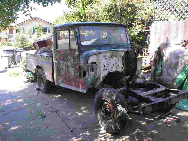

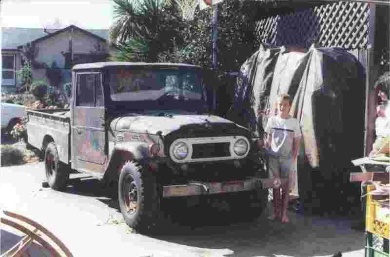

My 1966 FJ 45
Howdy, I'm still figuring out this photo posting stuff, hope it turns out right.
Here's my little project the day after I got her:
http://forum.ih8mud.com/attachment.p...id=19497&stc=1
Here is my progress to present. I wish I had a nice 3 or 4 car garage to keep it in, but this is currently outside and a fair weather project. http://forum.ih8mud.com/attachment.p...id=19498&stc=1
