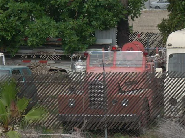

Hey I found a new project for you and Getto Let me know where you want this ? In the driveway or on the street I will try to get some beter pics

My wife would kill me, she is tolerant of the all the old helmets but an engine might send her over the edge.

Ya Gotta admit its COOL !!!!!!!!!!!

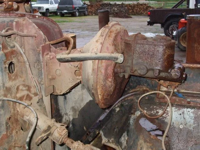

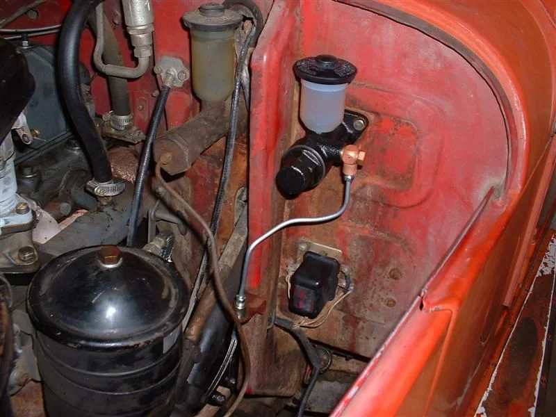

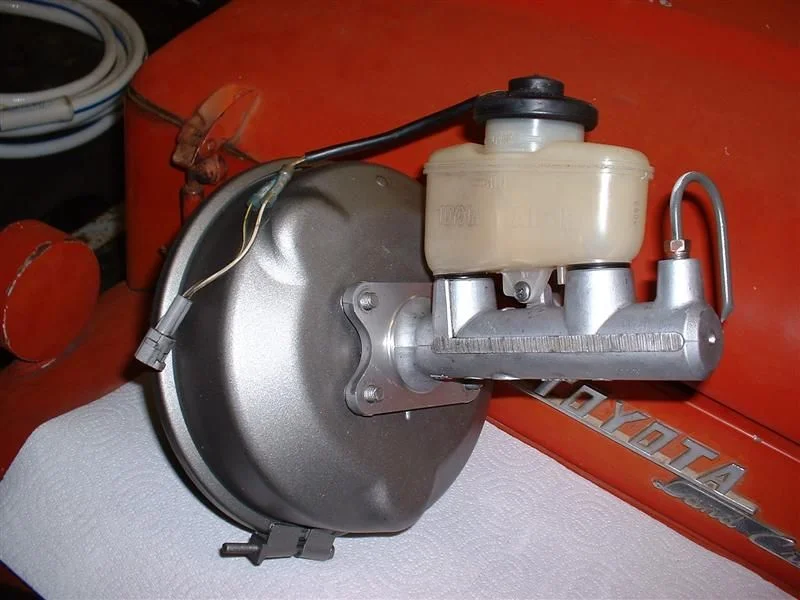

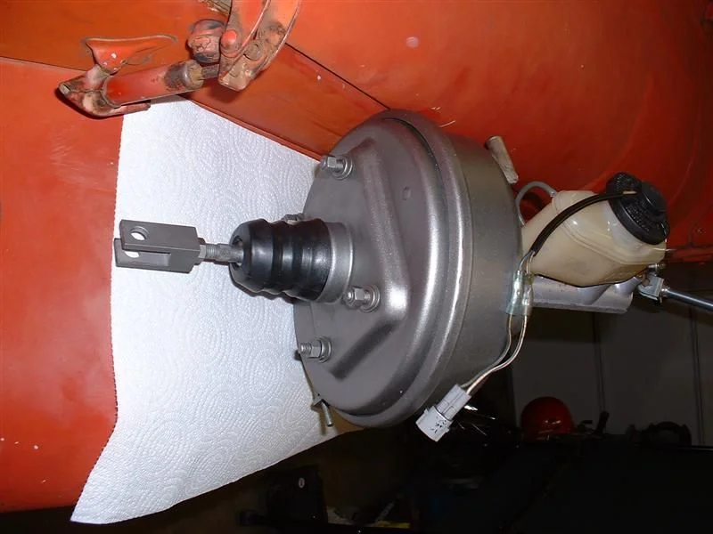

Installed a few parts yesterday and this morning. The clutch master has been leaking on the inside of the firewall and knew it had just a few pedal pushes left, so it was replaced with a new master, slave, hard line and steel braided line. It made a huge difference in the feel of the pedal. I have been a little leery about driving around with the factory steel fan, too many horror stories. It was replaced with a factory 6 blade plastic fan (non fan clutch type) and fan spacer to keep it away from the pulleys and belt. This new fan moves a lot of air compared to the stock steel one.

Better get to a dual brake master cylinder soon, so you dont have any "issues"

Rob,
Power 4 wheel disc is in the works and is next on the list

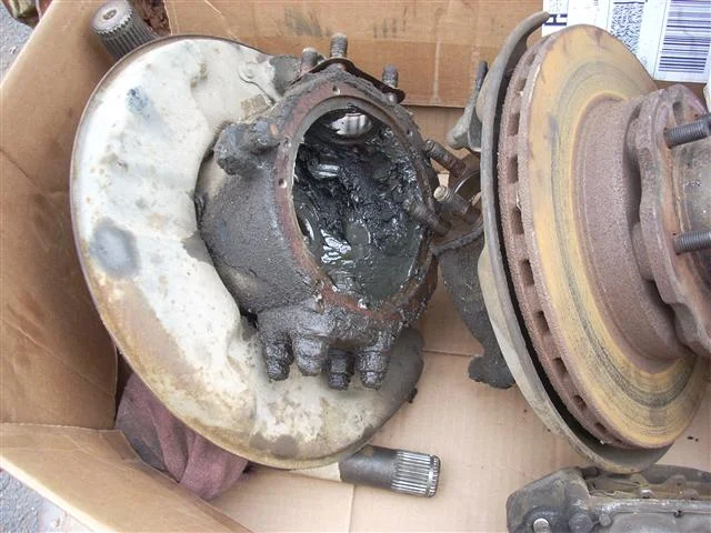

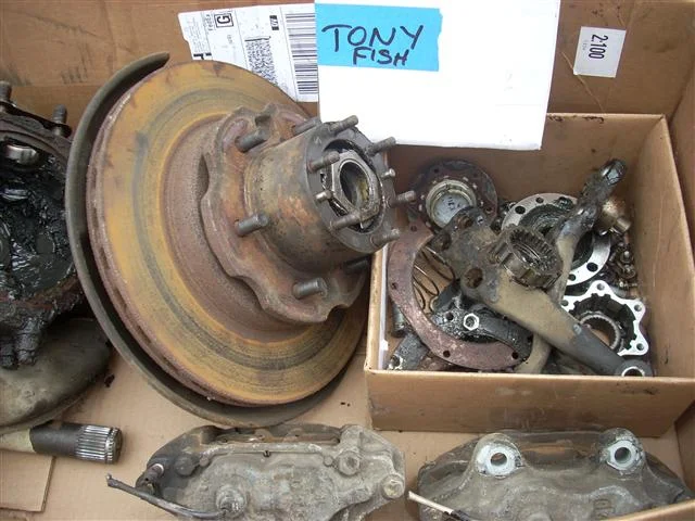

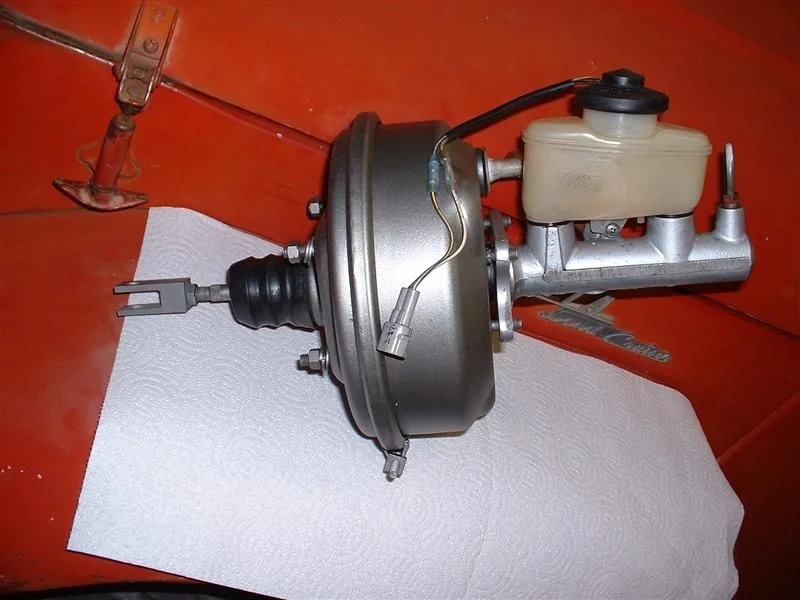

My brake parts are almost together, rear rotors and brackets from Poser, front outers from Orangefj45 and being mud-shipped via D"Animal, brake booster from Landcrusher909. I just picked up the booster this afternoon, ABS Brake in Orange rebuilt it for me, 1 day turn around $85.00. Picked up my master cylinder ('92 Toyota Supra) at the local pick a part, $20.00. Almost time to start wrenchin'.

Tony thats awsome !!! it does not even look like the one I droped off. Thats very cool and what a great price.

How is that brake booster going to fit with the rib on the firewall?

Quote:
Maybe like this:

Mike has it right. I ordered a spacer and is in the mail.

Glad to hear.
I was hoping you were not going to do this.

Disk
Oh Man !!!! Here's another projecr for you I know your dying to get your hands on these

Eric,
Yep, that was me. I was on my way to pick up the booster, that was the first time I took it on the freeway. It rode pretty nice, but I was not quite able to keep of with the flow of traffic.
I just received these beauties in the mail today (Thanks, you know who you are ). I will run these as is for awhile, but will get them refinished.

Quote:
Originally Posted by rockcod View Post
Eric,
Drool
