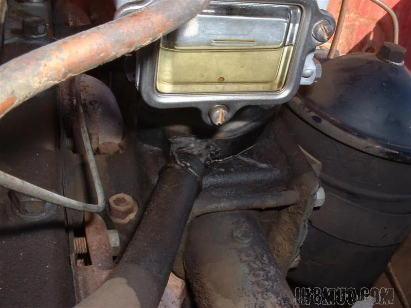

I rebuilt the carb., freed up the stuck throttle cable (dash pull), lubed choke cable and filled up with fresh gas.

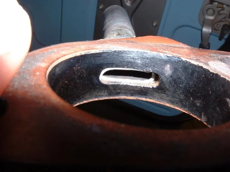

Now, I find out the carburetor insulator is leaking where the pcv tube inserts. Has anyone repaired theirs with an epoxy or do I need a new one?

TLCA# 14995
Posts: 2,240
Quote:
I put some high temp silicone in and around mine and it works fine

Well I think that was done to repair it by the PO.
YUCK !!!!

Thanks Rob. You wouldn't happen to have a good pass. side front fender would ya'
I removed it from the truck, the insulator is not cracked, so I think I will be alright with some JB Weld or epoxy to hold the tube in place. I will have 2 days to mess with it, as I am at work for the next 48 hrs.

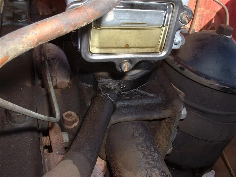

I got the tube pulled from the insulator, cleaned out all the oil, silicone and dirt from both pieces, mixed up some JB Weld and re-inserted the tube. Now the wait until it fully cures and I can run the motor and adjust the timing and carb.

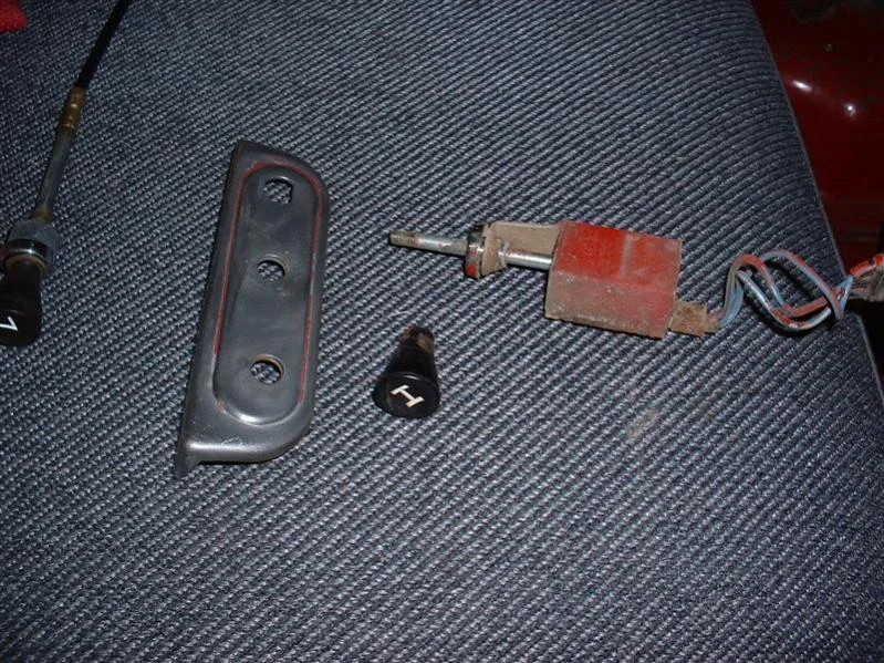

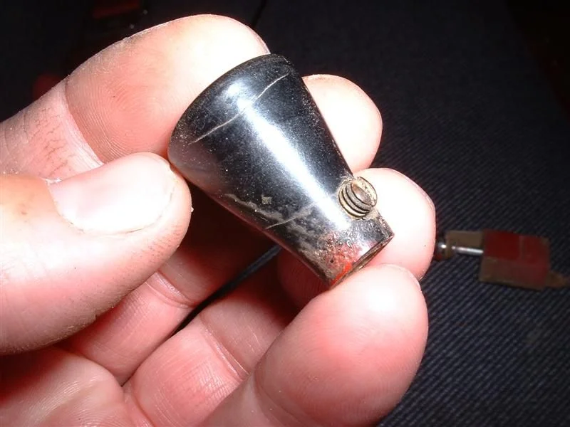

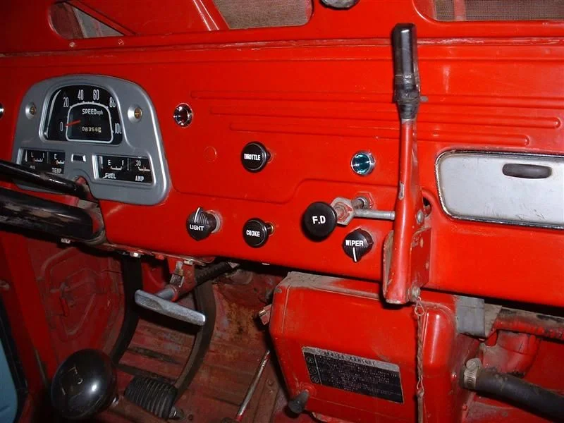

I followed the "How-to" by Dom, and polished/painted the dash knobs. The "Vent" knob and control cable have been cleaned, polished and painted, I still have to finish sanding and paint the small panel for the "vent, heater" controls. The "Heater" control knob is cracked all the way around, I am hoping the "heater" knob on the LV I picked up a few weeks ago (Thanks Whitey!) is in good usable condition.

Wow thats Looking Great. I really need to clean mine up if I am going to Cruisin with you guys.

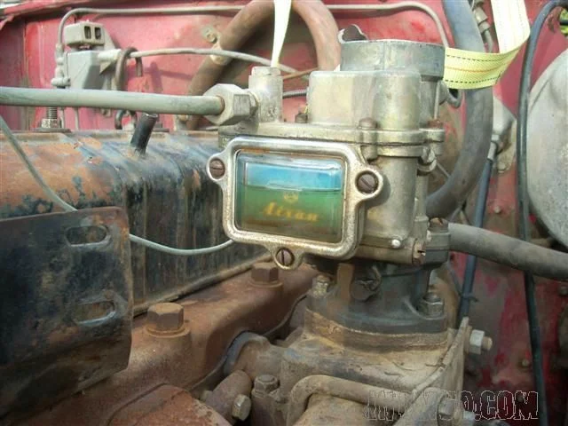

What is with the blue Aisan sight glass. My carburetor has a clear sight glass, has it been replaced with something else or is it a model year thing?

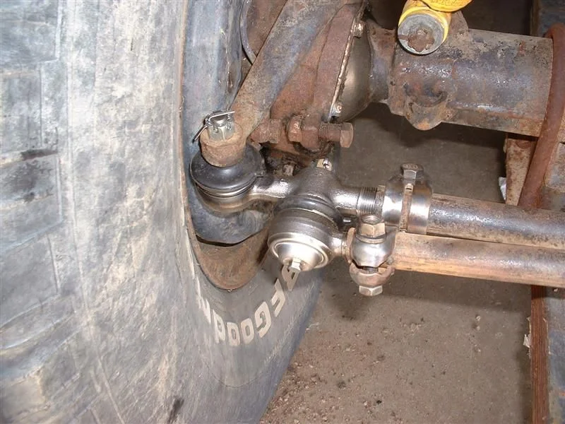

Today, I got around to installing my new tie rod ends (Thanks Kurt!), pretty painless, finished it up in about an hour, now I need to buy zerk fittings. The ones I removed appeared to be original and I am hoping to get 40+ years out of the new ones as well . I have only driven this thing around the neighborhood but it is the smoothest and quietest cruiser I have driven.
